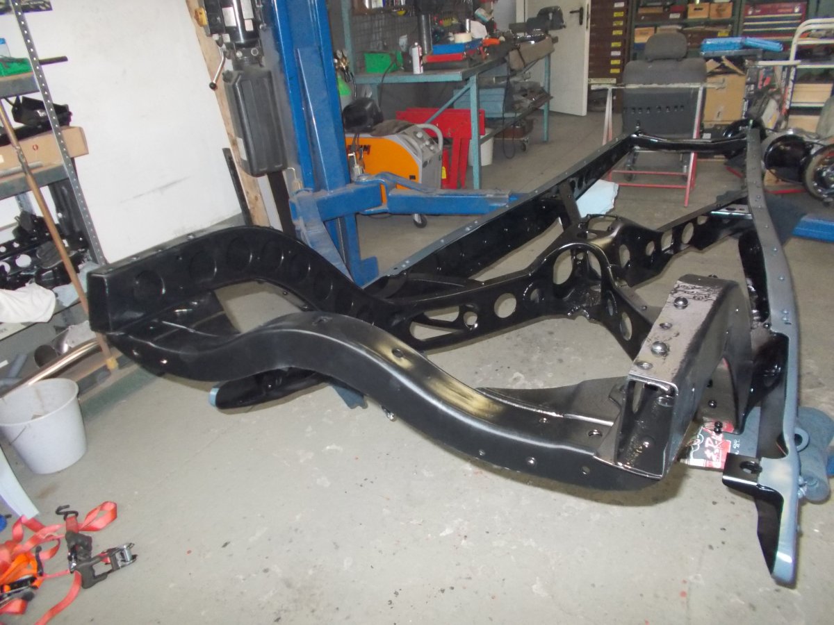

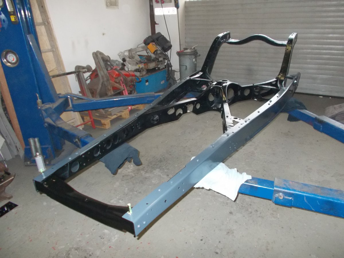

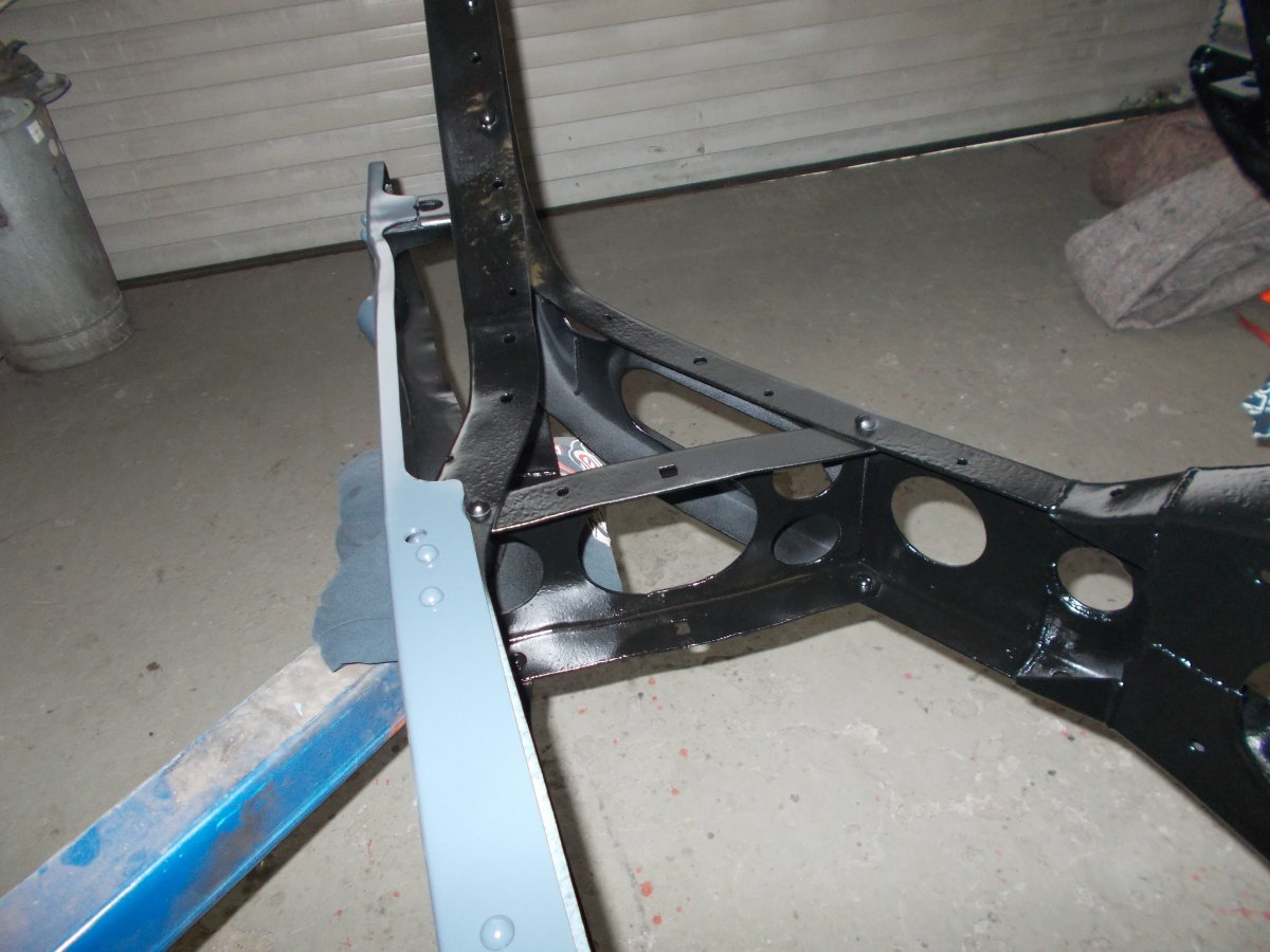

    Over the last year I've been building a 1927 T roadster with a difference. Now finally all the parts have come back from the paint shop so the final ***embly began today.
    Why's it called the Babushka T ? Well it's a reference to the Russian dolls which stack inside each other. The smallest going inside the next larger one and so forth. This Model-T however is like Babushka dolls only the other way round. It's a small '27 roadster body sitting on a 1947 Mercury ch***is with a 1957 Buick Nailhead engine and a Chevy aluminium Powerglide transmission. It all fits though.
    So here's the frame. It's a shortened and narrowed 1947 Mercury frame. The outside rails have large lightening holes cut in them and they're sandwiched inside the 1932 Ford outer rails which have also been shortened. The rear crossmember is Model-T. The front crossmember is from Shadow rods. The center box section has been reversed to move the wishbone cup to the rear. You'll see why later.
    There are 102 rivets holding the frame together and it was painted before and after riveting to ensure rust doesn't eat away at the sandwiched sections.

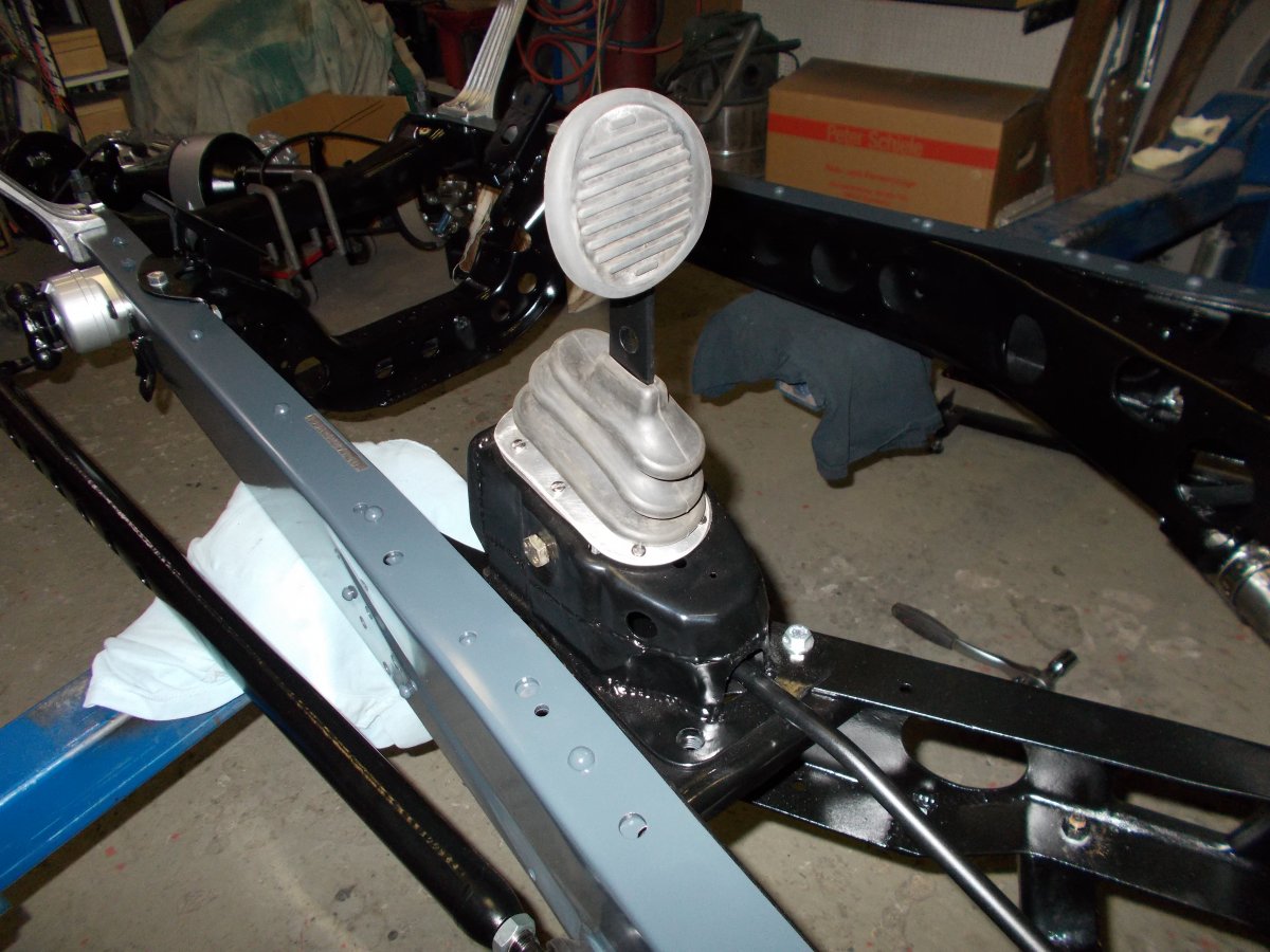

    This is the transmission mount which mounts below the Mercury center box.

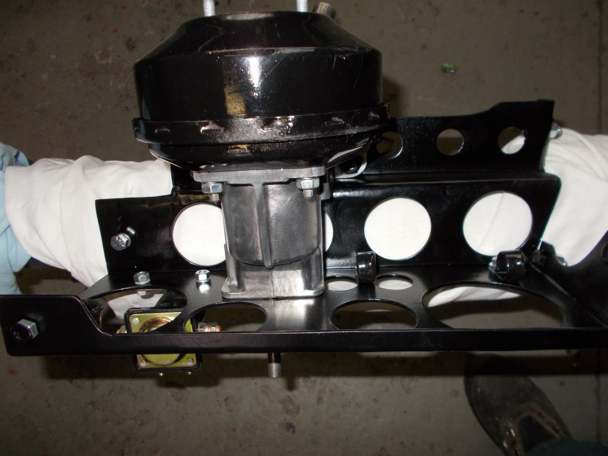

    Next up is the side crossmember which mounts the brake servo and master cylinder. These are from a tiny Smart car made by Bosch and there's small and light.

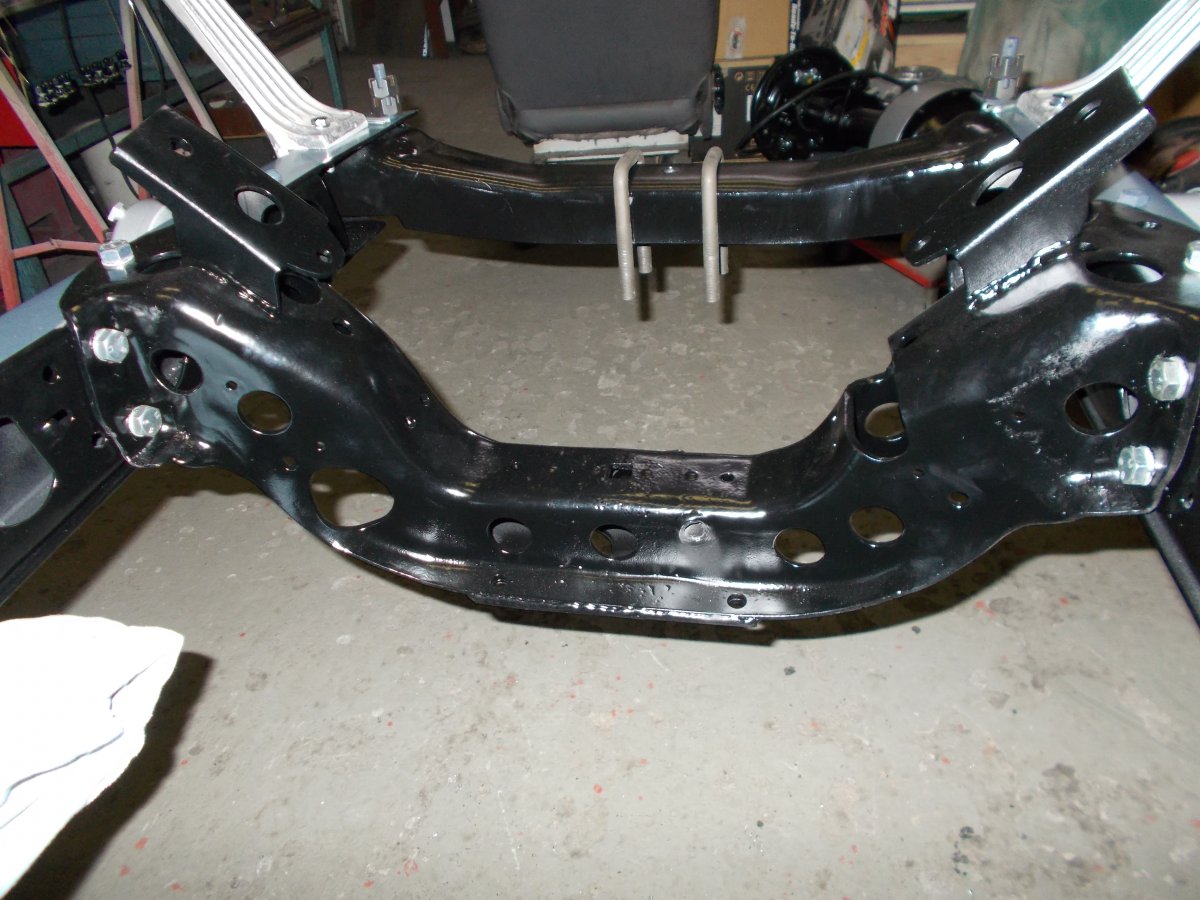

    Now it'd be a shame to throw out that lovely '47 front crossmember so I didn't. It makes a great OEM looking engine mount. It also mounts the Panhard bar and the steering box. I'll add those items next week. (Still waiting on the Panhard bar.) The crossmember was narrowed a bit and a few holes were cut to lighten it a bit.

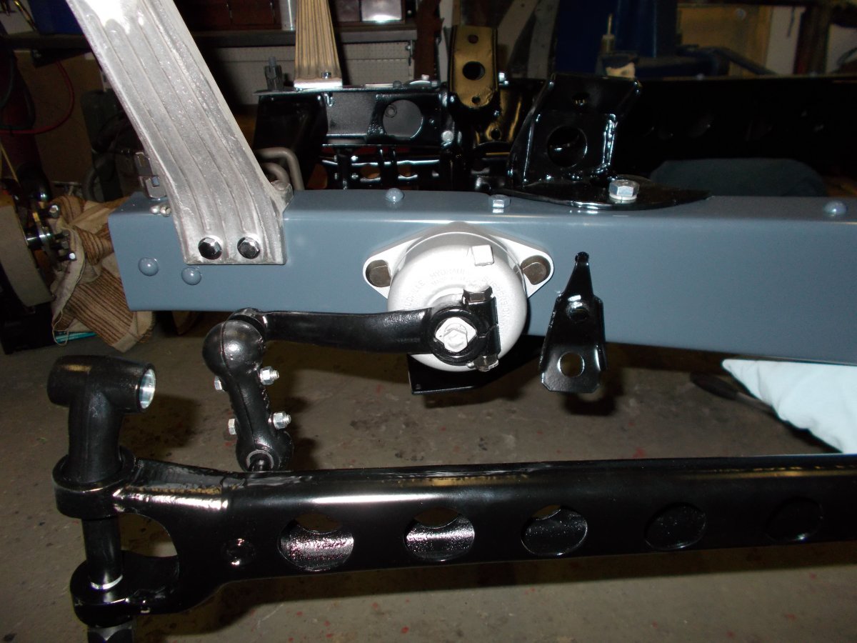

    The front wishbones are from Speedway and came with the holes already cut. They mount to bosses welded into the outer frame rails.

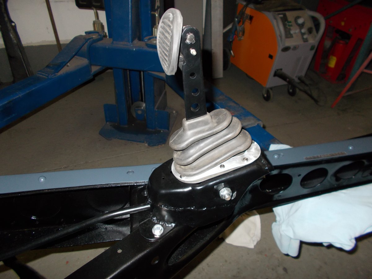

    Remember I said the brake servo came from a Smart! Well so did the brake pedal. The Smart has a floor mounted pedal with a very Early-Ford like round pedal pad, making it ideal for this application. The whole ***embly is available from junkyards for a lot less than a of the shelf solution and is made in Germany not China. Nuf said.

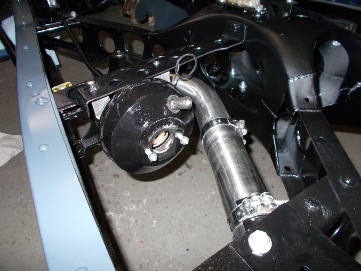

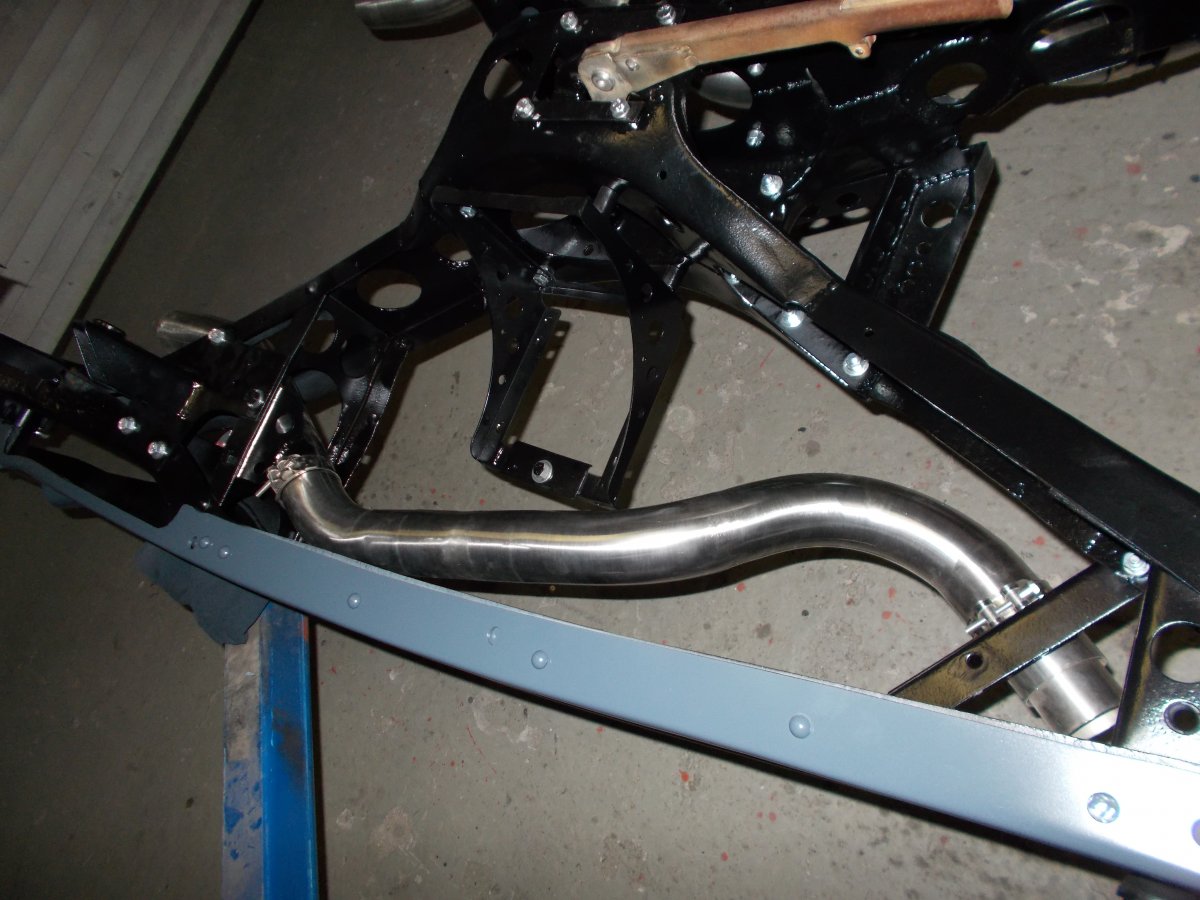

    The exhaust is hard mounted and runs through the ch***is. The exhaust is connected to the headers with 2 foot lengths of flex pipe like 1920s race cars. This makes hard mounting the rest of the system possible.
    This was the first time I'd welded stainless steel and I was surprised how easy it is. I was expecting a learning curve but it's easier than steel! Just bought a roll of stainless wire and a bottle of pure argon. I used pre bent sections which are bent better than I can do it on our exhaust machine. So each pipe is welded up out of loads of pieces to get the end result. The stainless welds grind down really smooth and then the pipes were polished a bit.

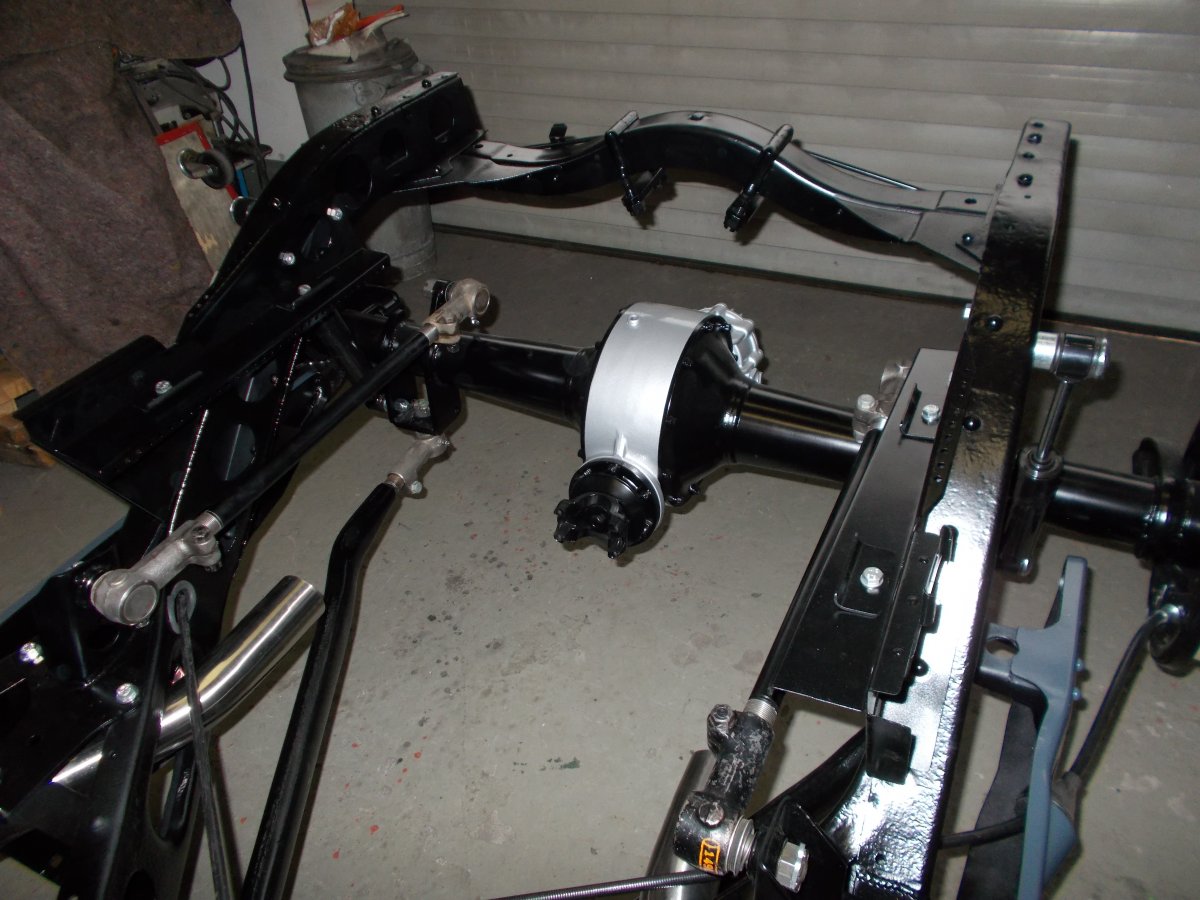

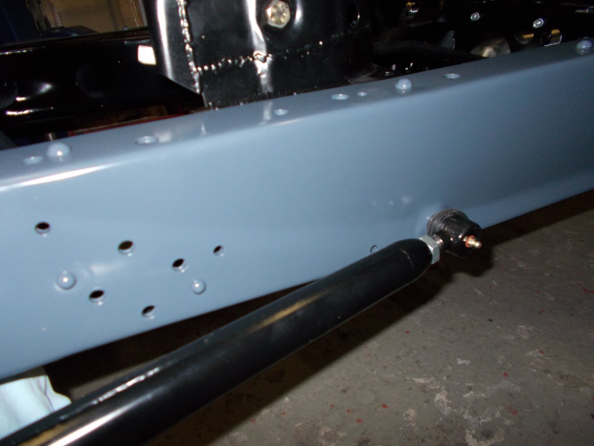

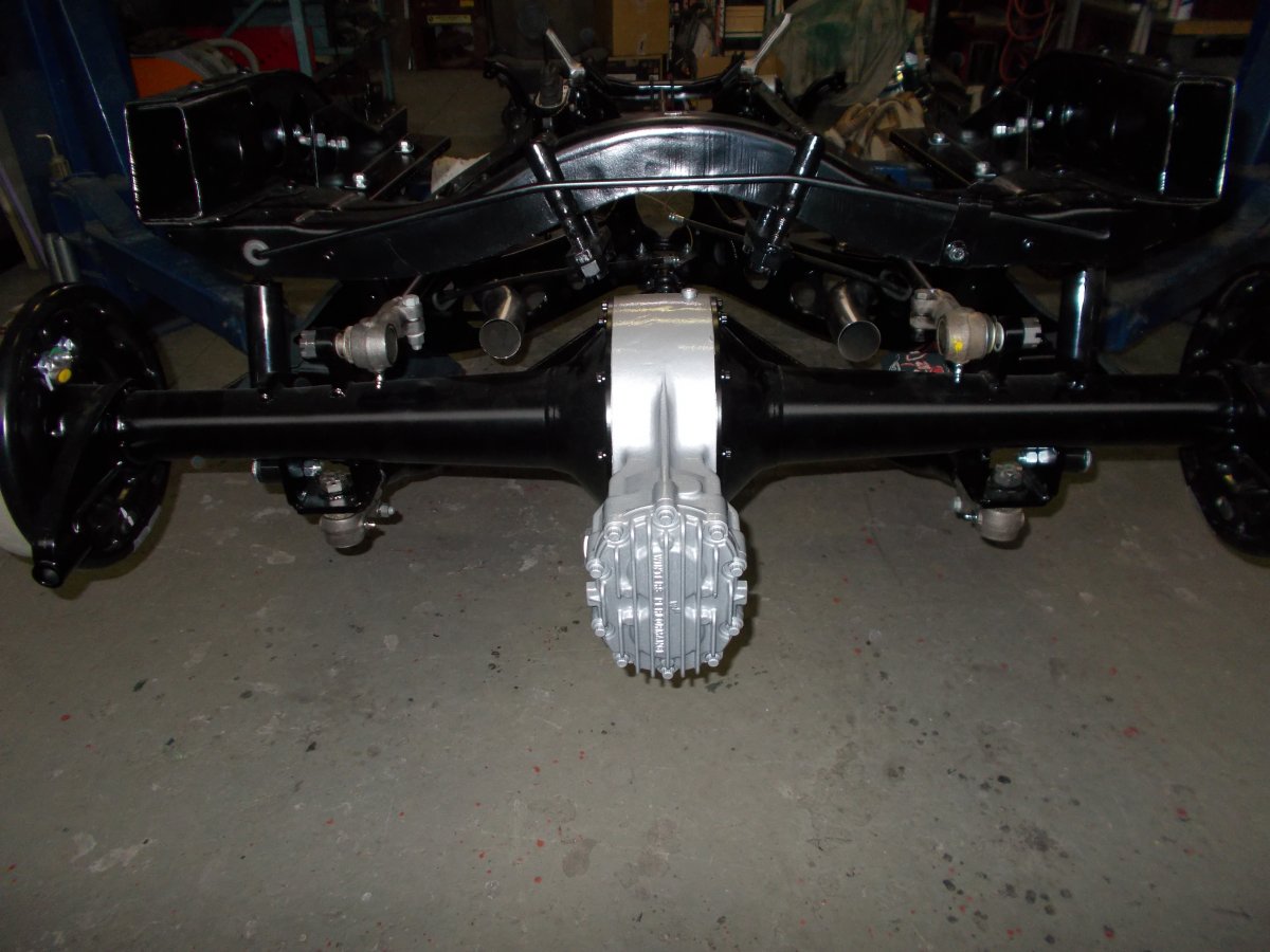

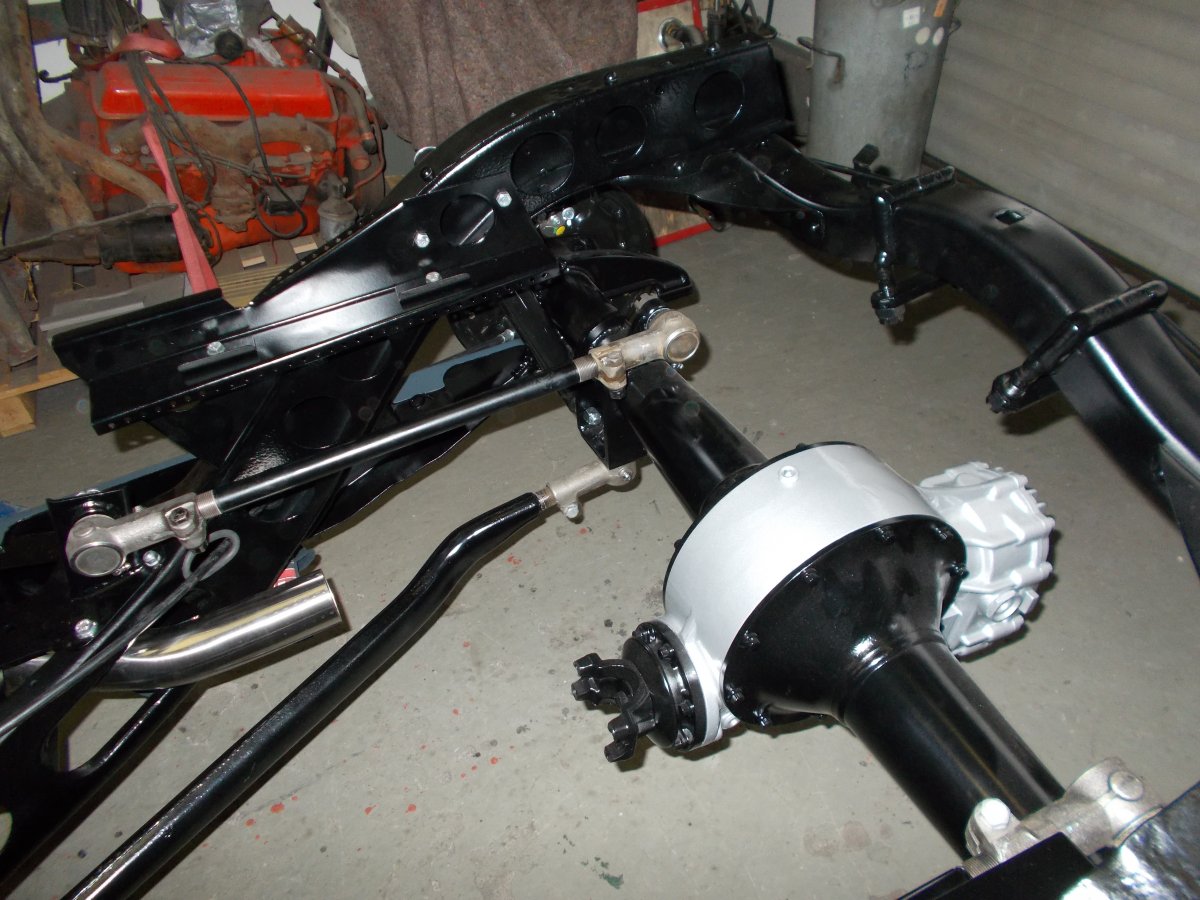

    I only got to work on it 4 hours today so didn't get much done. This is the rear axle going in. It's a Winters quickchange fitted with Torino rear brakes (new from Speedway as are the drums too). T
    he lower triangular link is a modified 1940s Ford/Merc front wishbone fitted with gigantic tie rod ends. Ford F5 or something like that. These are also used on the top links, so six of them in total. The front of the wishbone sits in the stock Ford mounting on the center box which is reversed.
    The spring hangers on the axle are from So-Cal.

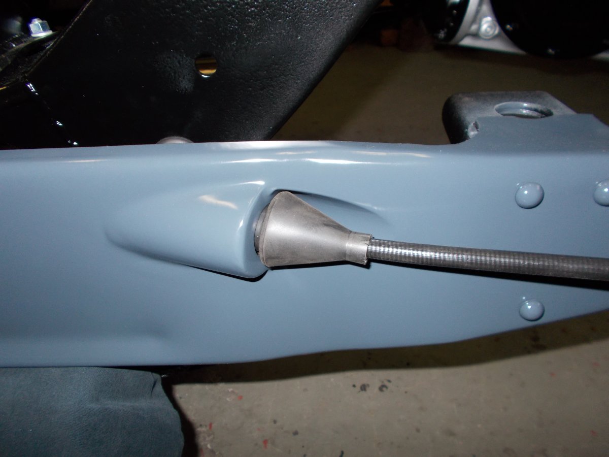

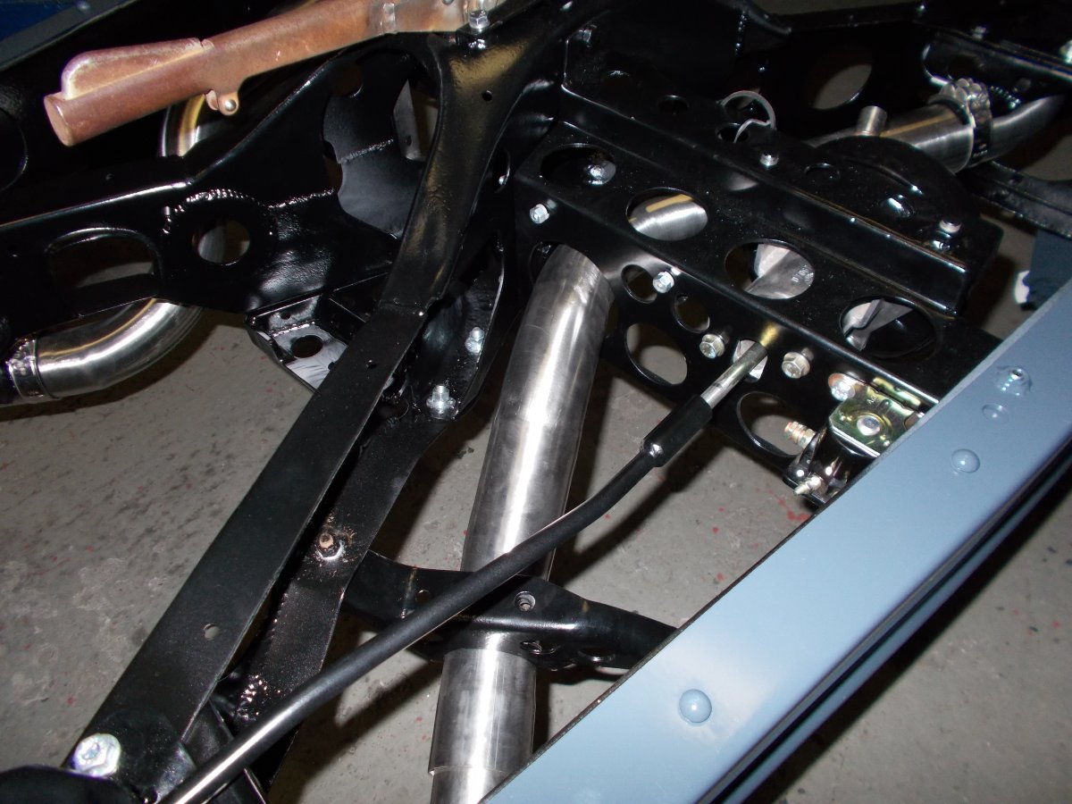

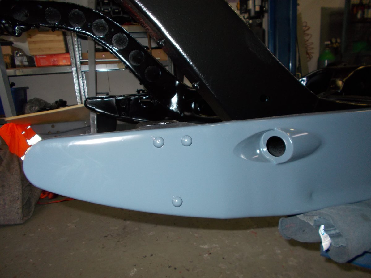

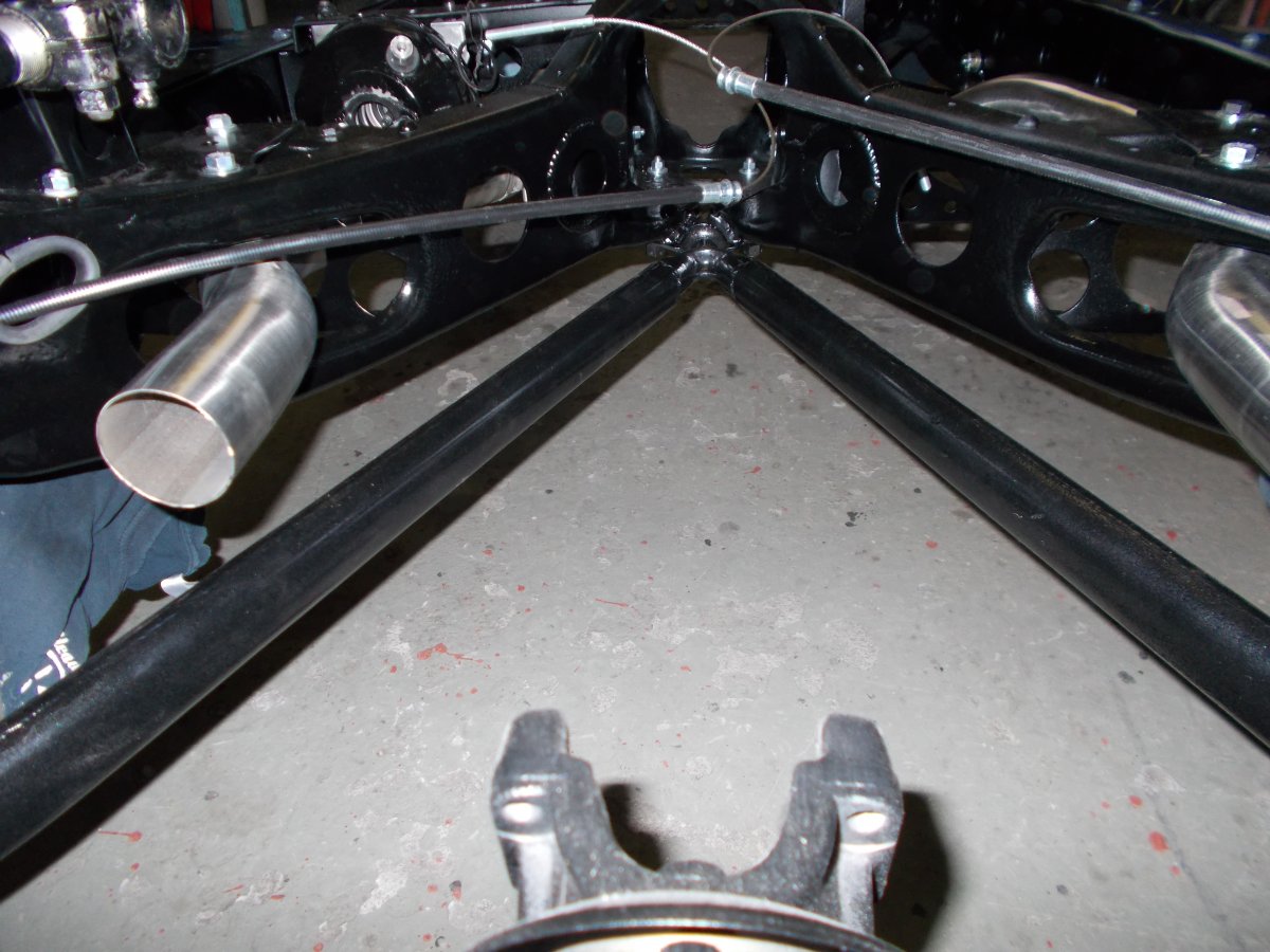

    The car sits quite low so the parking brake cables had to go through the frame at a rather obtuse angle. I didn't want to cut a long hole in the outer frame rails so I made this feature.
    The Morris Oxford parking brake lever is the type with the cross rod to serve independent cables so I found, with a little trial and error that two 1957 Ford convertible front cables worked best. The front cables have the long threaded rod at one end and the ball at the other. The only thing is, they don't have a return spring so you have to twist one on. The rubber boots where the cable goes into the frame rails are 1950 Ford firewall grommets.
