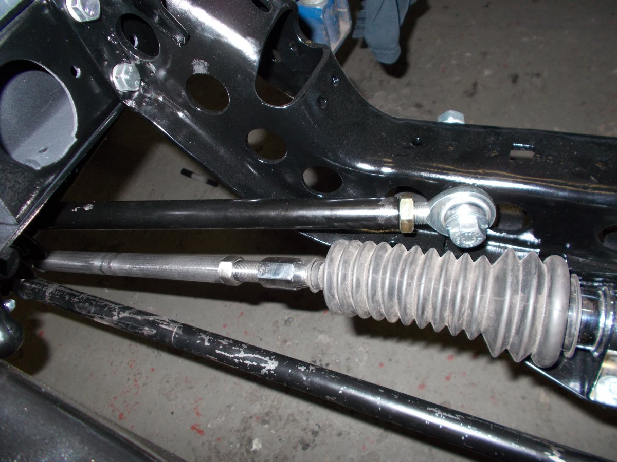

    Today I finished the front axle and the spindles and brakes. The front brakes are repro Lincoln Bendix drums. One of the top bolts has been replaced by a threaded boss which will be used to mount cycle fenders. Because this means there's a big nut on the inside I had to modify the grease baffles to provide clearance. There's plenty of space inside those big Lincoln brakes though.
    When dropping 37-41 spindle steering arms a lot the problem is that they get in effect a lot shorter bringing the tie rod too close to the axle and also short steering arms aren't a good idea. This gave me some sleepless nights until I came up with the idea of using a right hand spindle from a LHD car and the left hand one from a RHD car. This gave me longer steering arms on both sides. Luckily both Speedway and So-cal stock special tie rod ends which have an extra hole in them to mount the steering tie rod too.
    The steering rack is a Uni-Steer which was just about all I had space for.

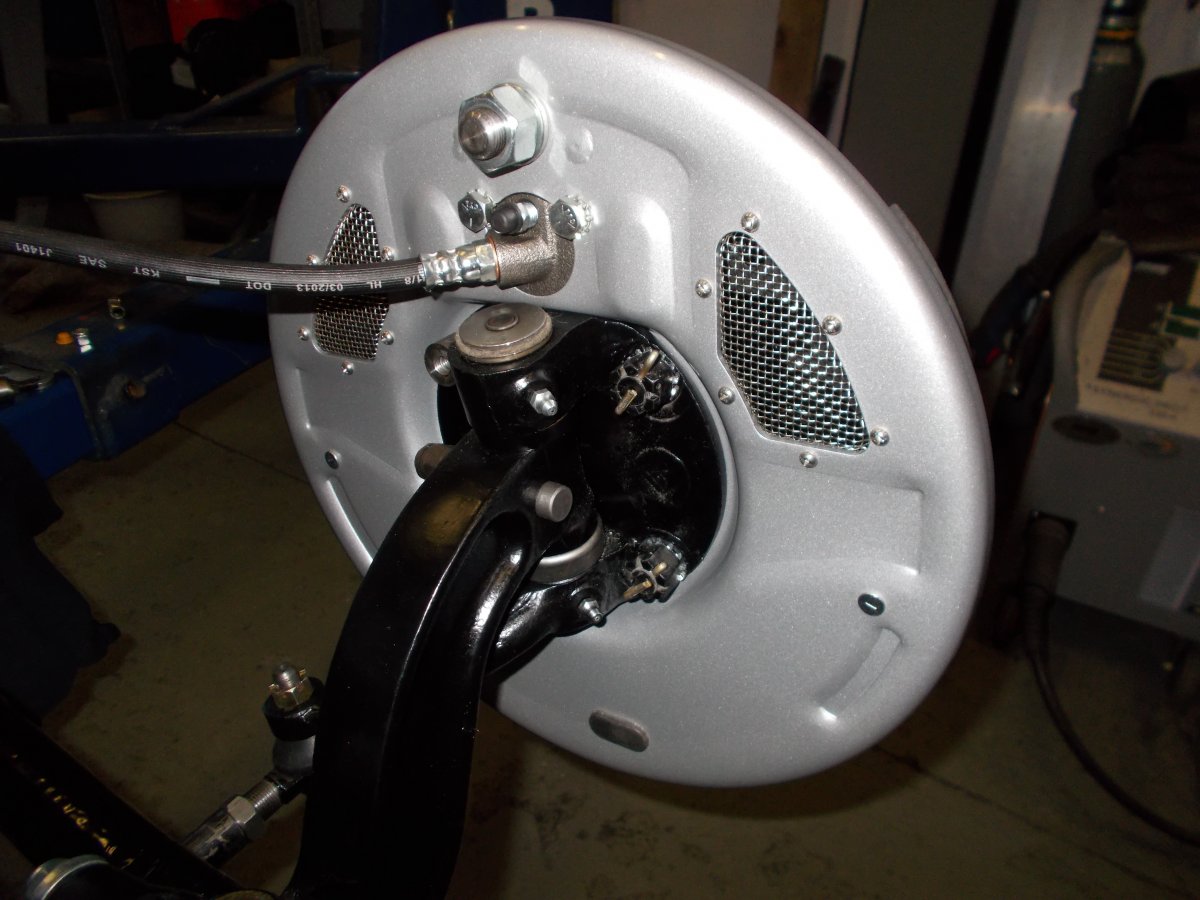

    When using Lincoln bendix brakes on Ford spindles you have to modify the top of the spindles like this.

    The brake hose mounts in the tab like this. I don't use the standard 1940 Ford front hoses which come in the brake cylinder sets because I find they're too short for early cars with narrow frames up front. But the truck front hoses 01T-2078 are a bit longer and work a treat.

    Joined: Apr 26, 2005
    Posts: 19,045
    Squablow
    Thanks for the extra pic of the brake hose tabs with the line installed, just what I was looking for.

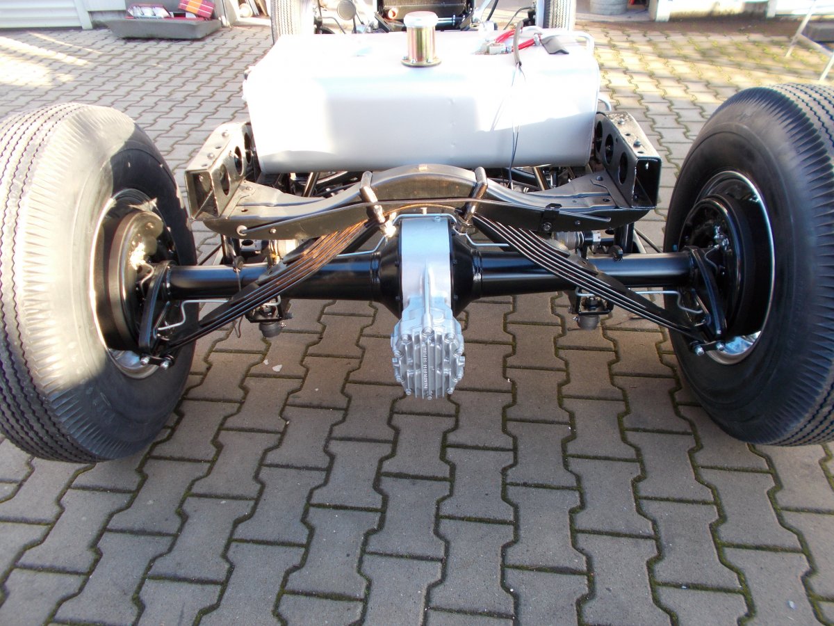

    These are the wheels.
    I used Firestone tires, 8.20 15" rears and 5.25 - 5.50 17" fronts.
    Tires are balanced with 10 ounces of Dyna-beads in each tube.
    Front wheels are Ford 1933-34 17" spoked bought here on the Hamb and they're beautiful. My painter took loads of time to get them perfect. They're painted silver.
    Rears are 1950's Packard Caribbean 15" chromed spoked wheels in original chrome. They have a 5 on 5 bolt pattern.
    Front drums are reproduction Lincoln painted with heat proof silver paint and baked in an oven for an hour.
    I'll be fitting 1933 Ford V8 hupcaps all round. DSCN0139.JPG DSCN0141.JPG DSCN0145.JPG DSCN0147.JPG DSCN0155.JPG

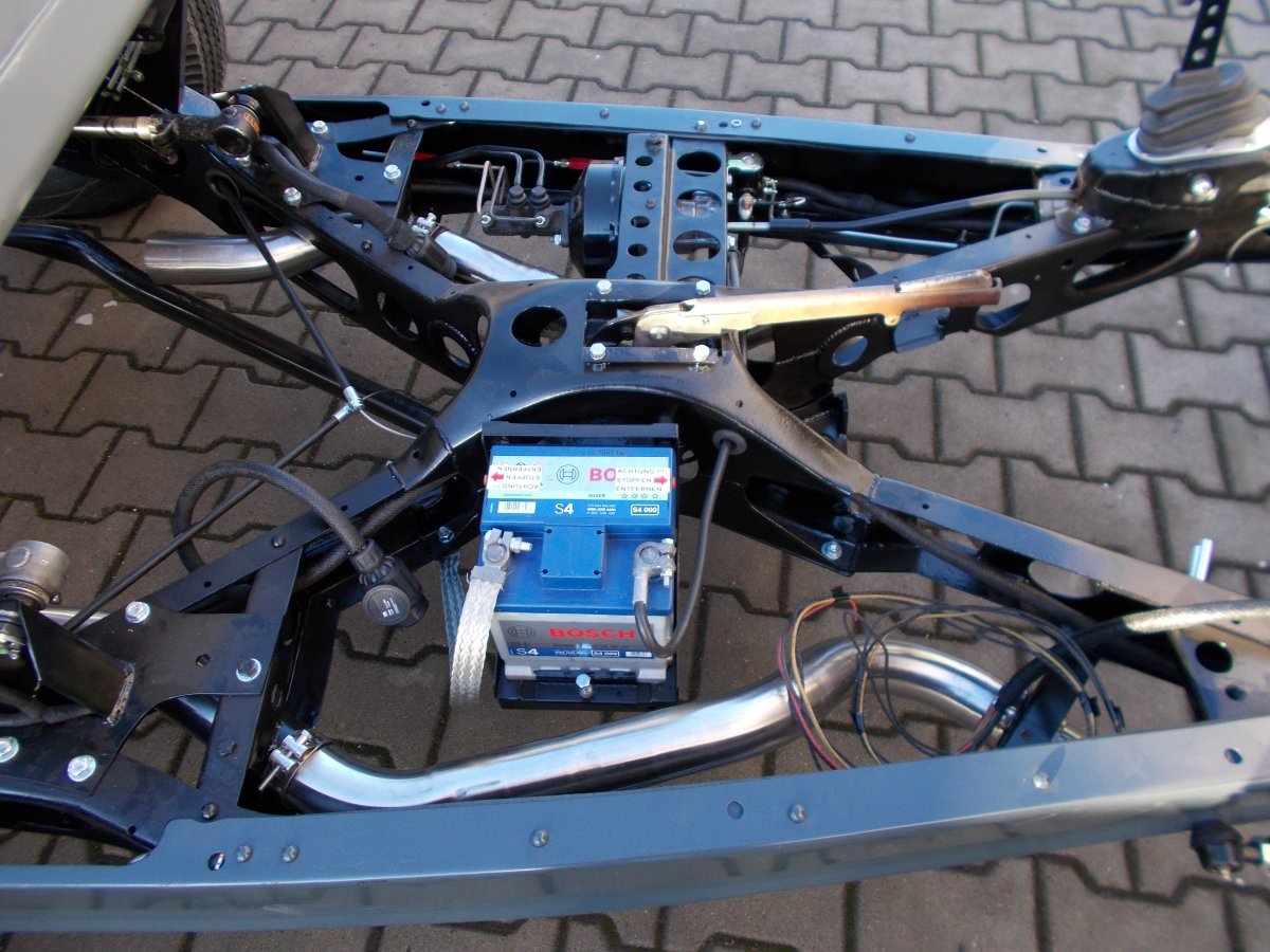

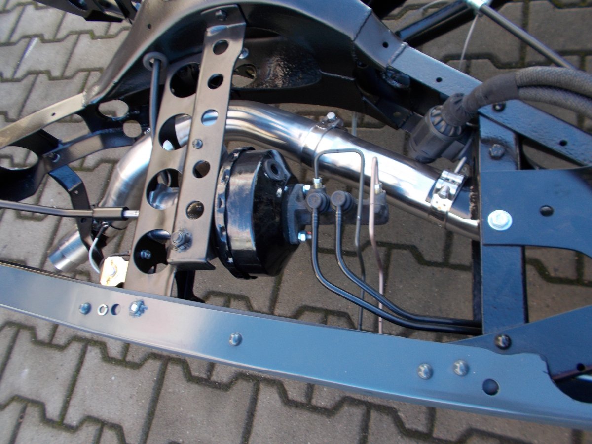

    The rolling ch***is is basically complete. Just waiting for the powerglide to come back from Mc Driveline in Schweinfurt. All lines are laid and the ch***is wiring loom installed. I've tried to keep must of the weight below the axle line to improve the handling.
    The battery and master cylinder will be accessed by lifting the seat base.
