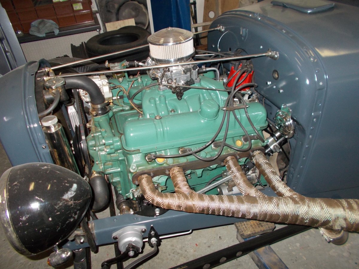

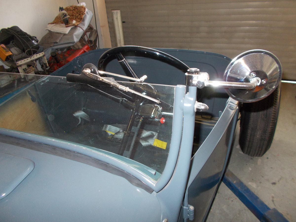

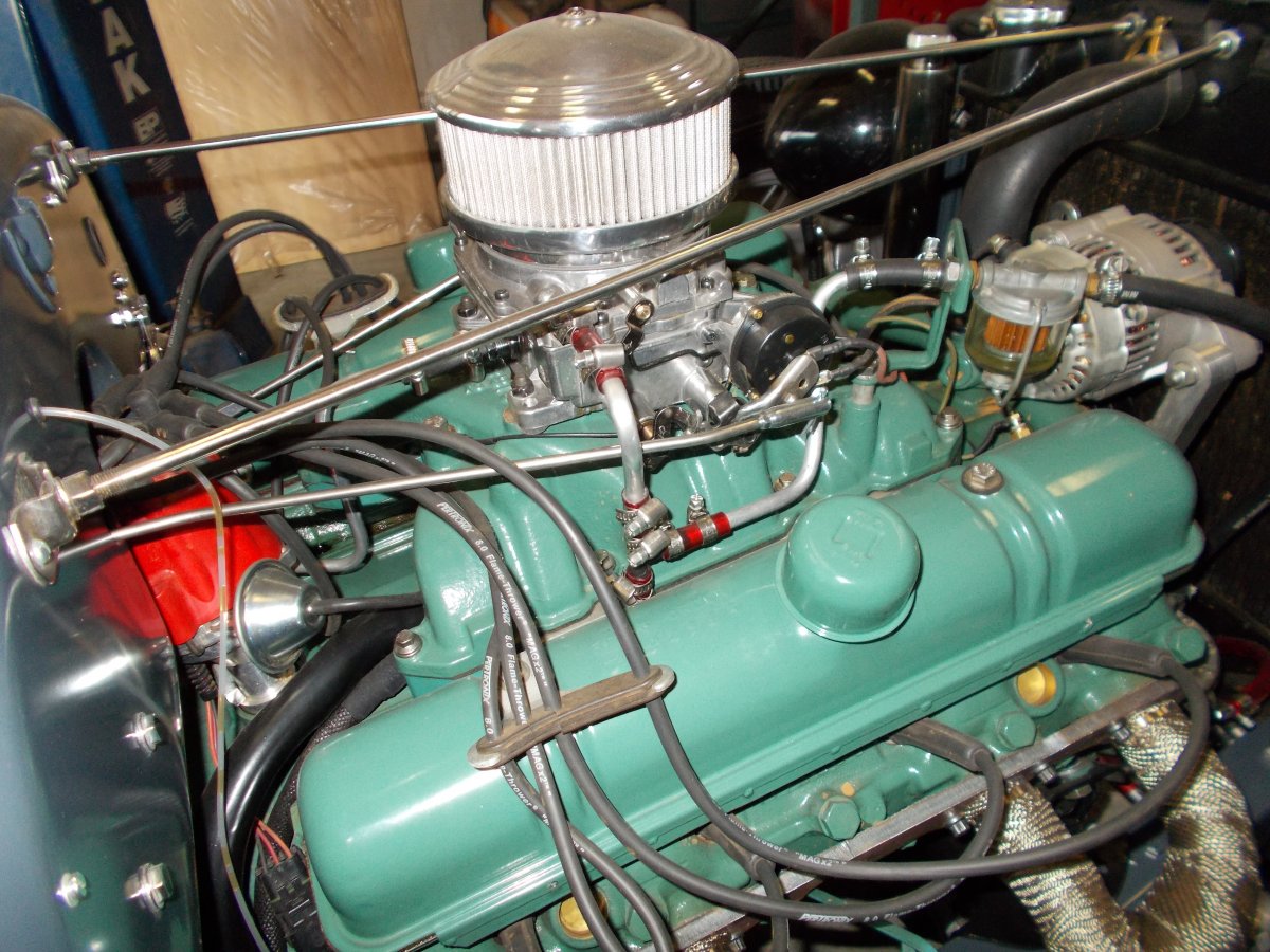

    Getting closer to a finished car now. Yesterday the mechanical fuel pump failed but I got many of the little problems resolved. I swapped out the 1 1/8" front brake cylinders with 1" cylinders and that almost doubled the front braking power, but it still isn't enough so I'm going to try fitting a master cylinder with a larger bore.
    New additions are the gas tank cover and the windshield wiper mount.

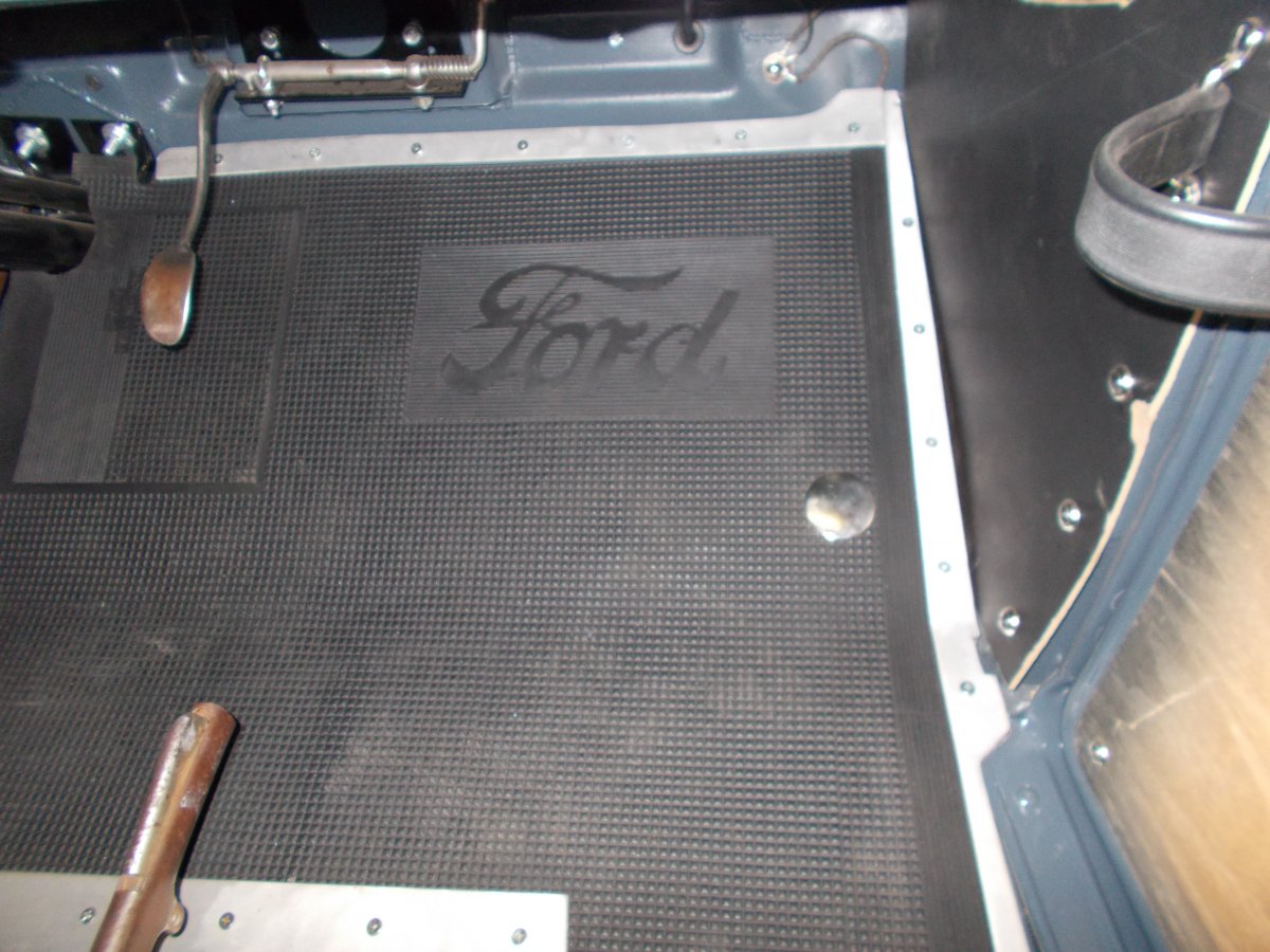

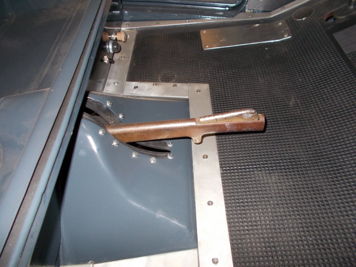

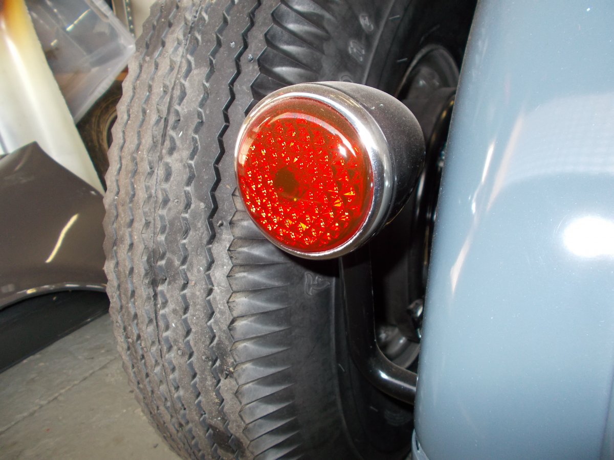

    License plate light is from a '49 Chevy. The parking brake is from an early 50s Morris Oxford. The taillights are reproduction '37 Ford. The rubber floor covering is Model-T Ford. The gas pedal is '32 Ford.

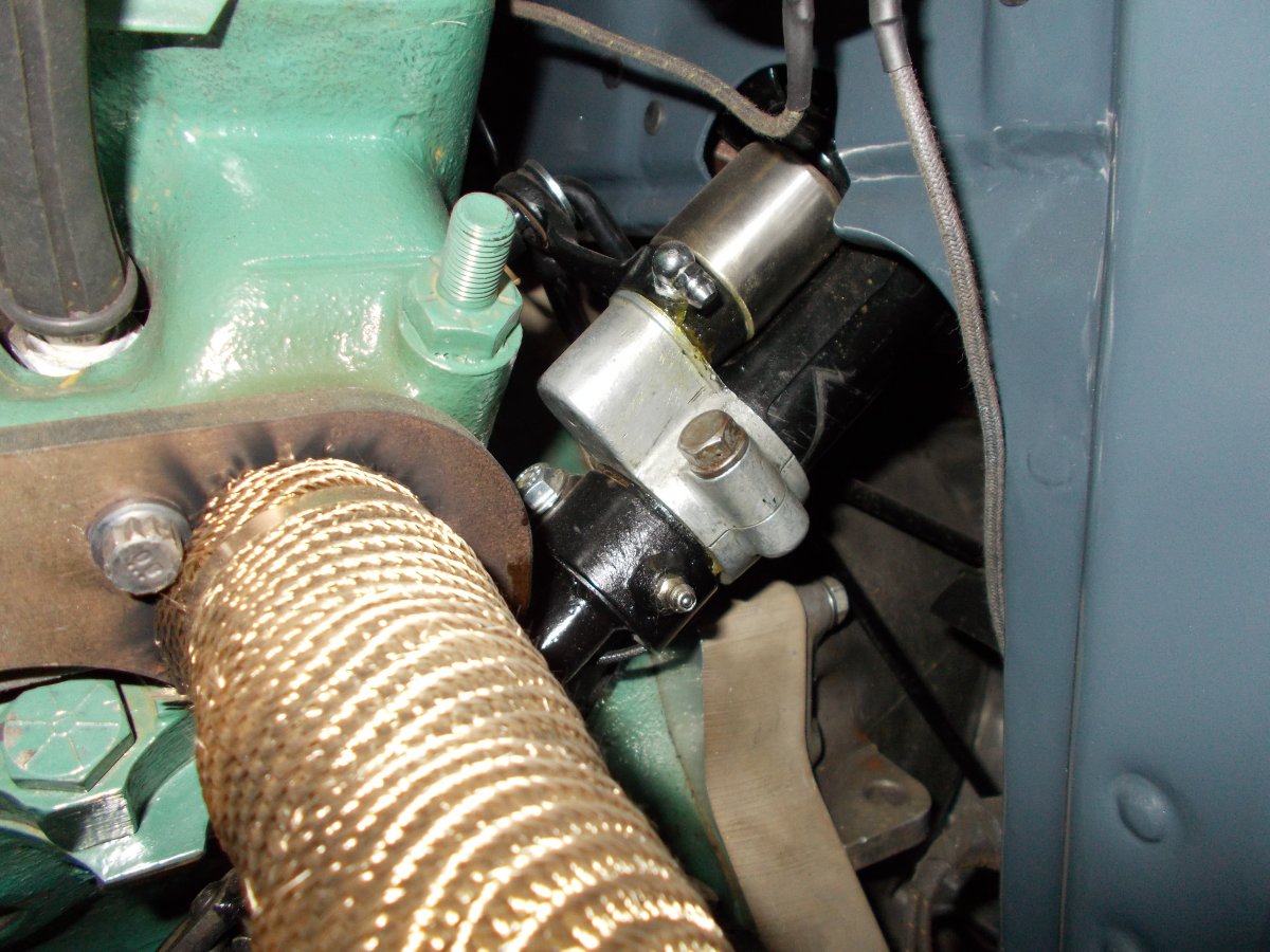

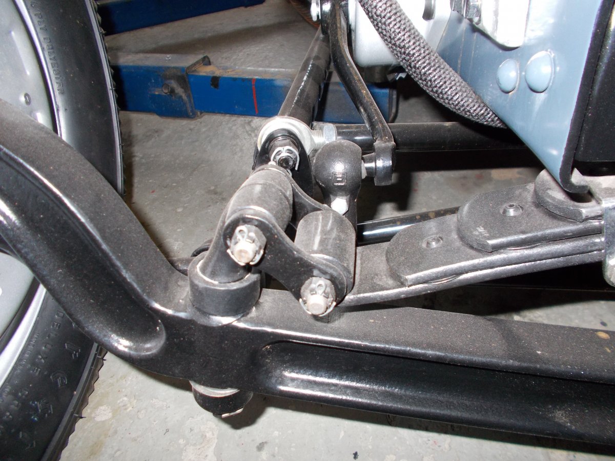

    I replaced those cheesy self locking chromed nuts which come with the '32 shackle kits with castle nuts and cotter pins.
    Also pictured here is the modified '40-'48 column gear change which now operates the automatic transmission.

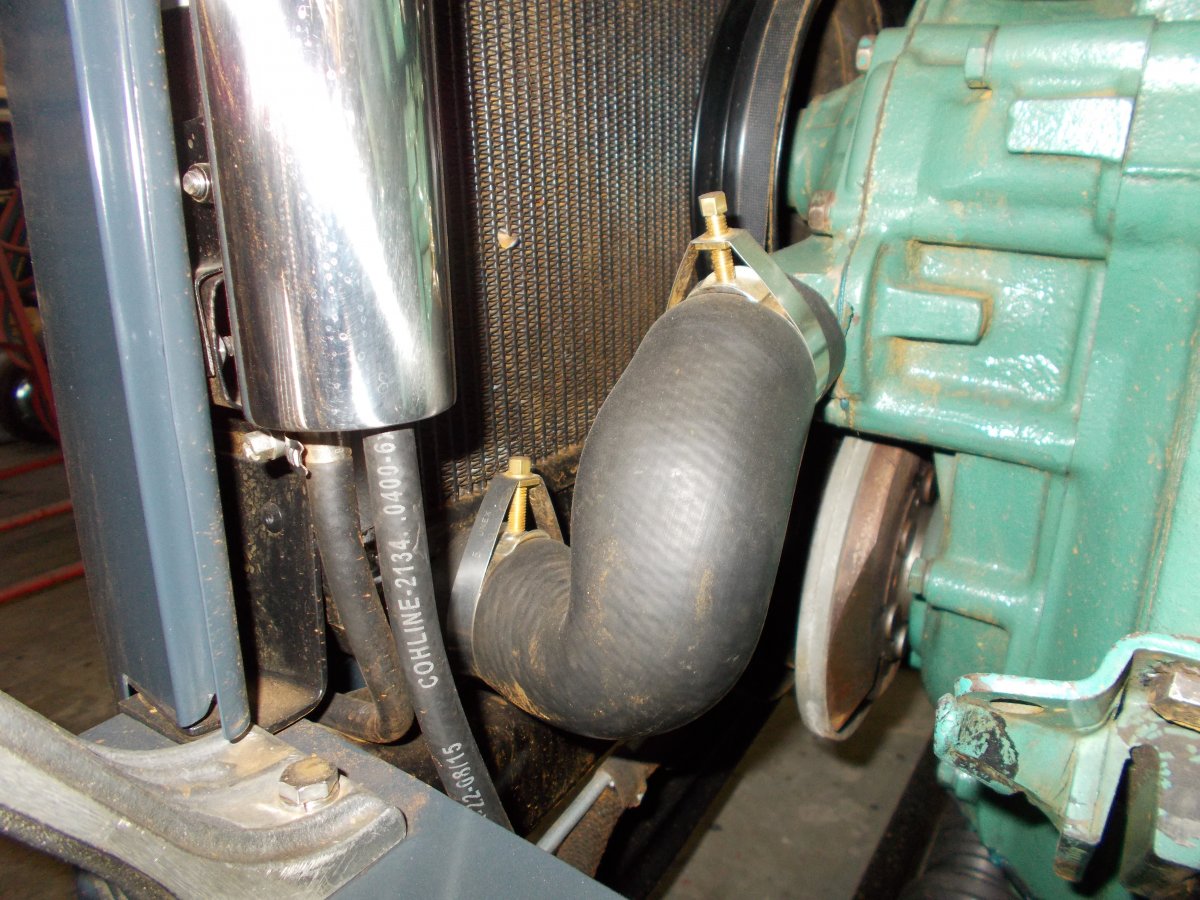

    That lower water hose took some finding too! It is very tight down there and I needed a double bend in the lower hose. I struck lucky and found a 1938 Chevy truck lower hose which fitted after cutting down a bit.

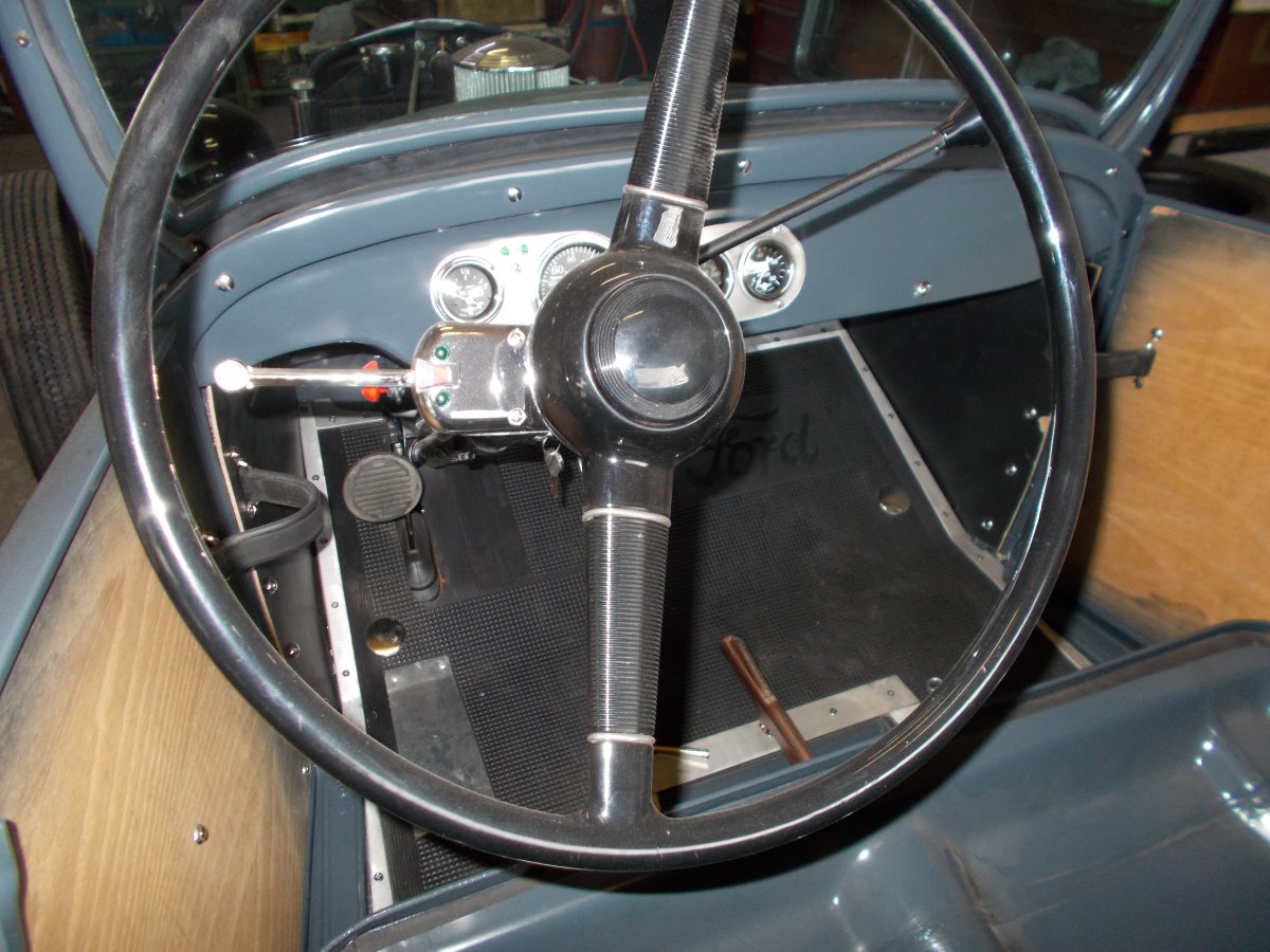

  18. Gotta ask a question: The steering wheel sure looks like it it really back close to the drive . . . have you noticed that as an issue and would you have preferred to have it further away? (closer to the dash). Just wondering . . .

    The driver is very tall (6'6") and needs the space behind the wheel for his knees. The car was built to fit one person. All components, brake pedal, gas pedal, steering wheel and shifter were mocked up first and built around the driver. However I'm quite fat and a little under 6' and still have plenty of space behind the wheel. The wheel is quite high up. When driving you look through the wheel not over it. It's not a cut down, '40 wheel, it's a full size one. This makes for quite an exciting pre-war race car feeling when sitting in it. However there's still plenty of room between your body and the wheel to cross your hand to the other side. The seat back will only be thinly upholstered. It's actually surprisingly comfortable just the bare metal seat back.
