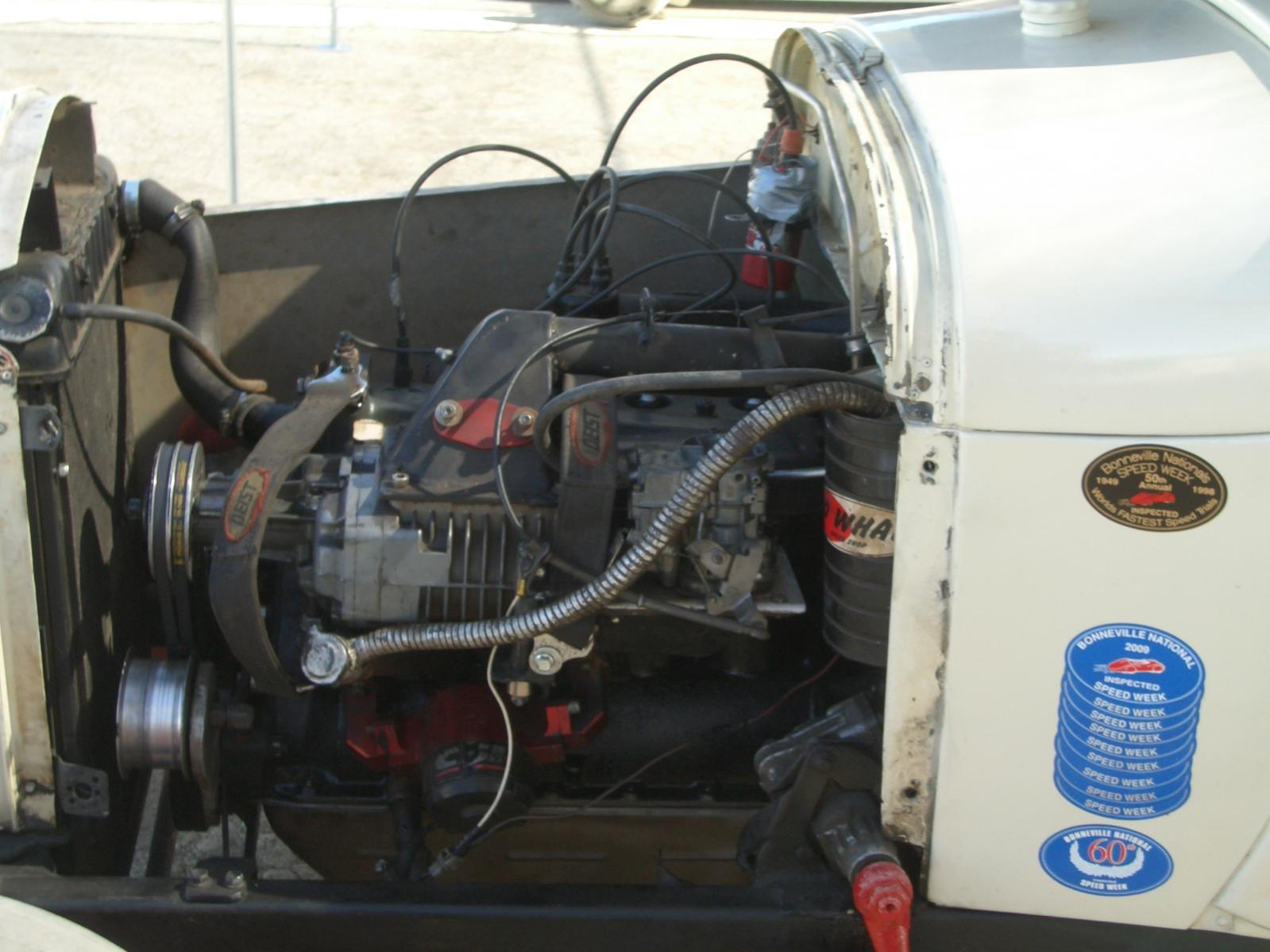

    Here are a couple shots of a really cool roadster we saw at El Mirage last year that featured an awesome blown banger. Sorry I don't have better pictures than these two - Terry

    Yeah owned by Shug and Irene Hanshard from the "So -What Speed Shop" .
    up until last speed week Irene and the roadster owned a lot of the records , I think only BFMR now, Shug has a bunch of records too with a different engine.

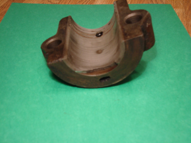

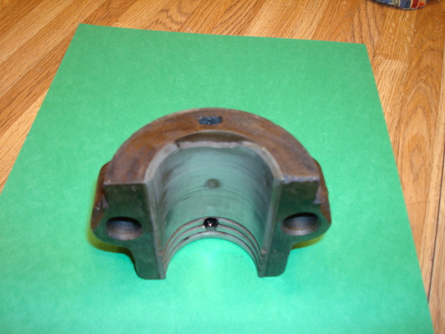

  12. Have a babbit question for you-
    This is the rear main from my '28 Chevrolet block... is the babbit still usable (if I chamfer the edge of the break) or not?

  14. V4F
    Joined: Aug 8, 2008
    Posts: 4,391
    V4F
    from middle ca.
    mac , the piece that broke off is a thrust part . i WOULD NOT run it . it will continue to fall off , then the crank will float front to rear ............ steve

    Is that part of the cap thrust? I doesn't look like it to me But I can't see the pic. all that well. What are your planes for the engine?
  16. Thanks for the input guys! This was the spare engine that I was going to start to rebuild/hop up, but it looked so good inside that I thought about buttoning it back up and getting it running.
    However, I don't want to ruin a good engine with a bad decision, so I'll hold off until I can replace the babbit.

    4 cylinder Chevys (which that cap is from), have the thrust taken on the center main
    Herb Kephart
  25. So Herb,
    If I round/chamfer the edges of the crack, will that help?
    Thanks again, Bill
