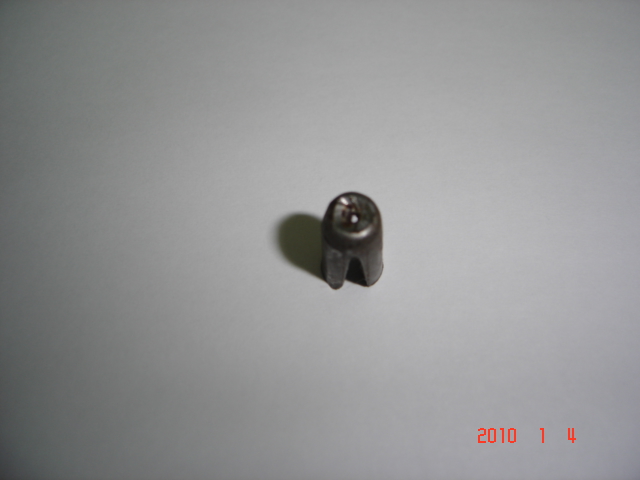

  20. This is the first thread I look for each new month, a wealth of information, will try and contribute in the future but have a couple of questions for now.
    While inspecting the valve galleyon my A banger engine I noticed a obstruction in the center oil supply tube and removed this. Does anybody have a clue why it would be there? It is steel 5/8" long x 1/4"in dia with a .040 hole in the top. Possible oil restrictor?
    One other question on the Ford rearend I have, the cover suggest a 8.8" but the tag says its a 7.5" 2.73 ratio model year 87, could Ford have put 7.5" gears in 8.8" housings? Thanks for the assistance.
    Thanks Mike
