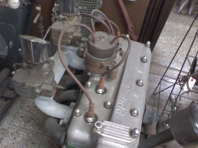

  22. Stovebolt
    Joined: May 2, 2001
    Posts: 3,660
    Stovebolt
    I managed to get the pictures I took at Antique Auto in Rosemead from my cell phone:-

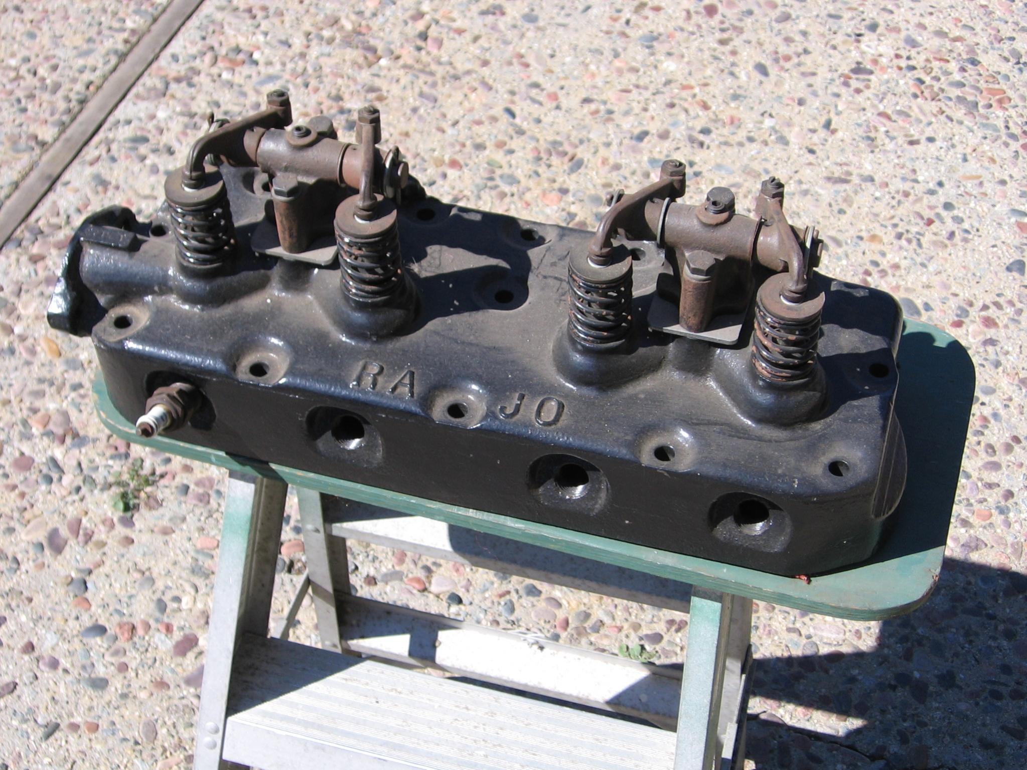

  23. Airborne34
    Joined: Dec 4, 2007
    Posts: 662
    Airborne34
    from Texas
    Do the T-Banger's count? This is for my next project, slowly collecting parts.

  26. Crazydaddyo
    Joined: Apr 6, 2008
    Posts: 3,372
    Crazydaddyo
    T's are more then welcome. Please keep us posted
