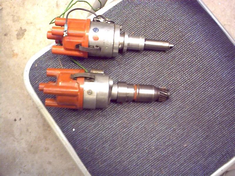

    Somebody on here was asking me about modifing a Pinto/VW distributer to fit a Plymouth PA/PB motor. I found these pictures of the distributer with the new bottom unit to fit the Plymouth. It's the one with the tang drive. The one with the gear is to fit a Dodge Bros four. The other picture is a stock VW dist. and machined to go into the Dodge lower.
  13. Rich,
    I understand that some of the VW distibutors have a delay for one part of the firing order... does the pinto suffer the same problem?
    The VW was recommended to me for my '28, but to be aware of that delay...

    I am not aware of any delay in the Pinto distibutor. When I had a Pinto in my roadster it would happly turn over 8000 rpm. So with the Plymouth in it that rarely saw 5000 I thought it would be allright. And I got the SCTA record certs to show it worked fine. I can't eyeball any offset on the VW dist. cam. Can't think of any other way to build in a delay and never heard of such a thing myself. Points and cap and all are the same between them. I guess if it turned out to be true I would have to scare up another Pinto part.

    I'll have to look at my notes, but certain years of the VW distributor have the daley- will let you know tonight!

    There were years I believe in the mid to late sixties that VW's had problems with one cylinder over heating. The fix was to retard one cylinder. This was done in the distributer at the point cam. Sorry, I don't know what years.

    Thanks for the info. Never having been a VW owner I never heard of such a thing. I will have to see whats going on when I get the Dodge running. I guess if you have a VW and put the distributer in at a different location than factory, you would really screw things up.

    If I remember corrrectly, it's the post-38HP engine (which means that the only good distributors are the early ones)... but there's just too much info crammed into my feeble brain at the moment!

    I did find that the VW rotor has a built in resister. Looks like Pinto parts are a better choice. Harder to find.
