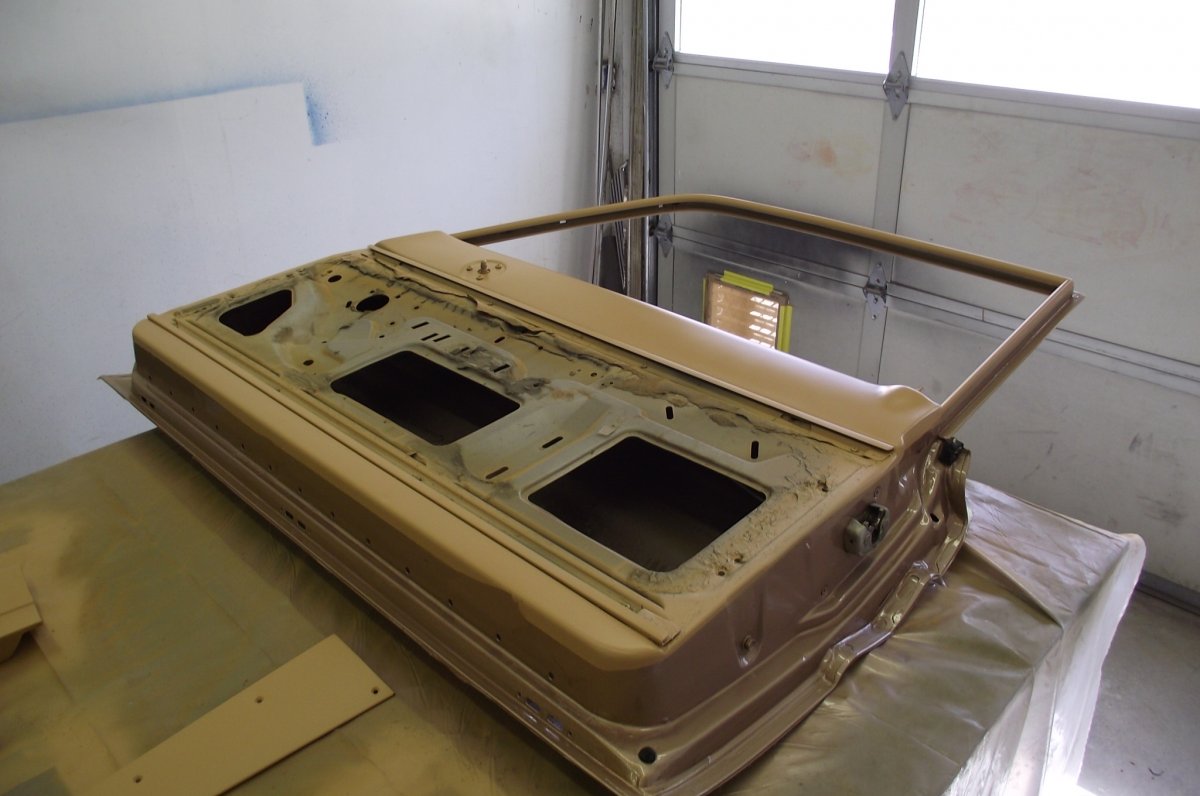

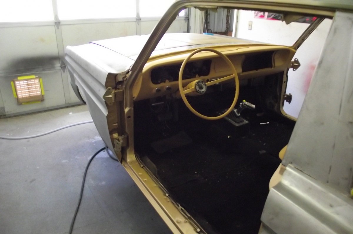

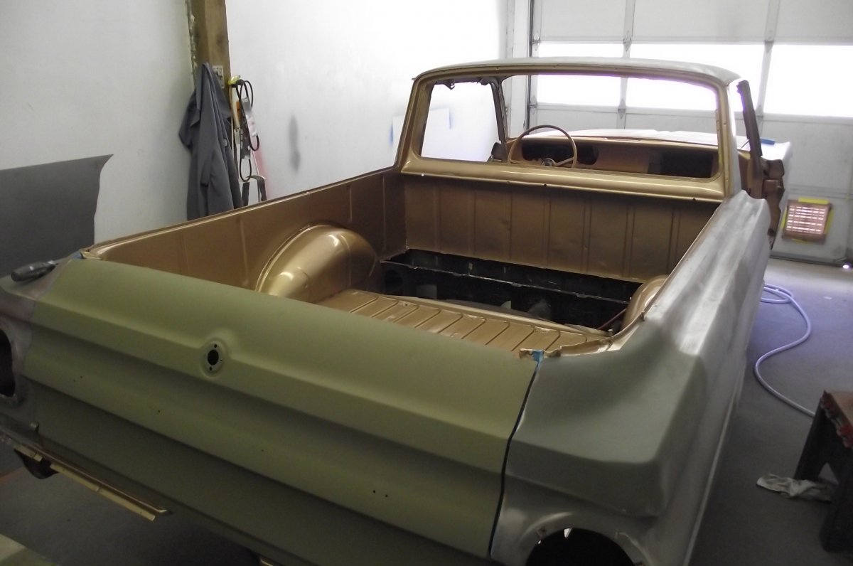

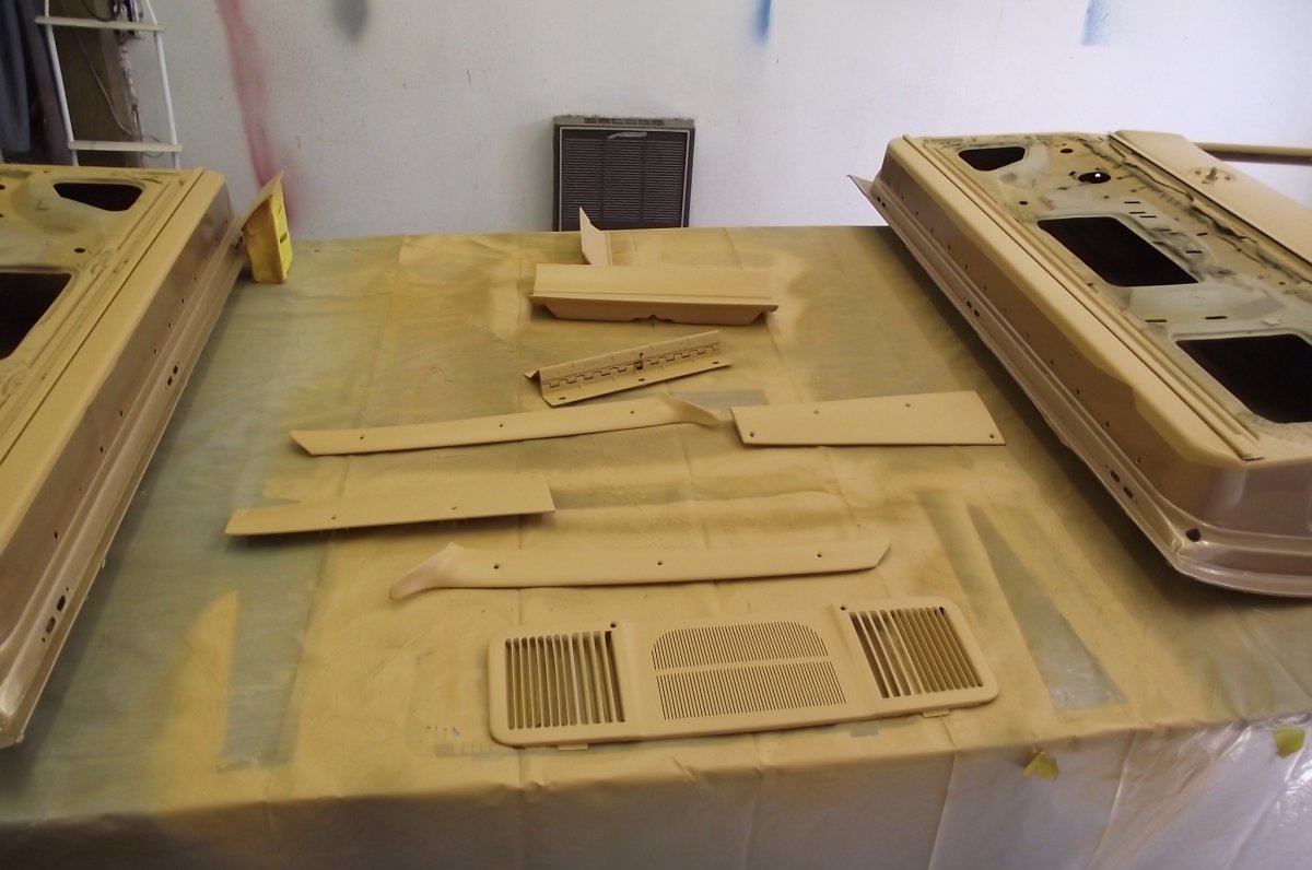

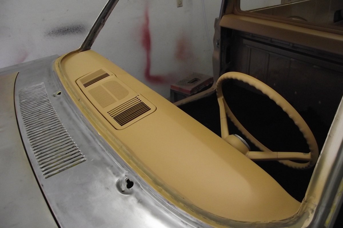

    Mine is the stripped down never had a radio, no trim model that sold new for less than $2,000. My goal is for it to look like the ones pictured above. Some pictures of todays progress, shooting the interior color,. I was a little apprehensive about how much flattener to mix in the paint to get it between semi gloss and a satin finish, after a few tries I'm happy with the result.
    The florescent lights don't show the sheen or the true color, in real life it looks like tanned and polished leather.

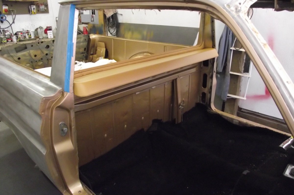

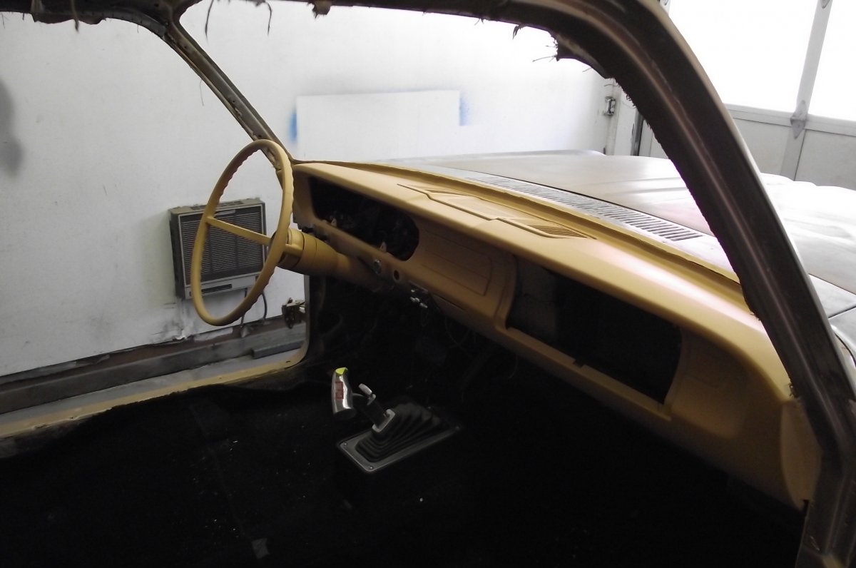

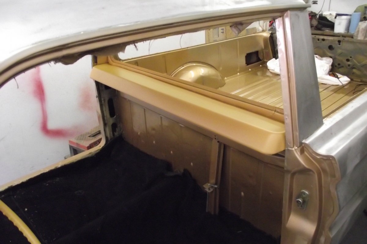

    A little more progress, shot the interior, door jambs and the bed. This was all done in acrylic enamel, very forgiving and controllable. The exterior will be done in a urethane base/clear. The weather has not been cooperating this week so the exterior will have to wait for warmer dryer days.

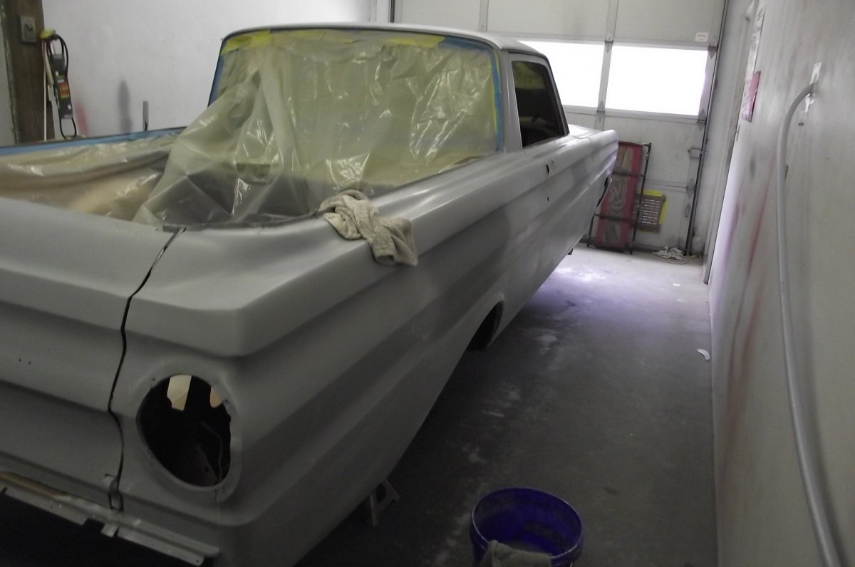

    A little progress, just a little more sanding to go.

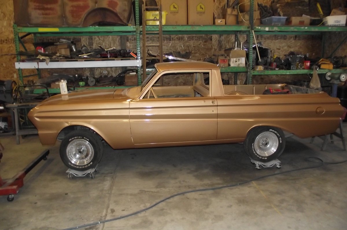

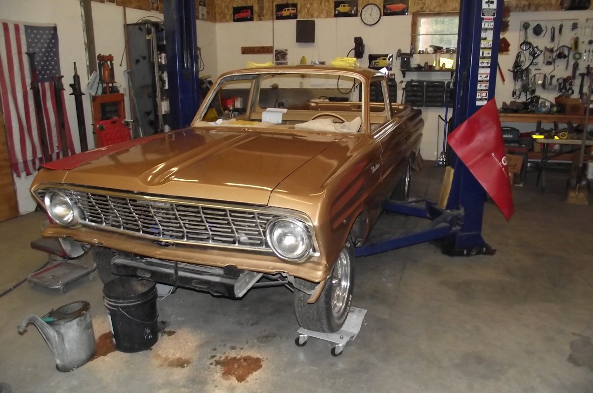

    Got it painted, I'll have pictures later. Scored a nice set of factory bucket seats out of a 67 Fairlane today, I'm wondering if they are the same as the falcons.
  15. Mike Miller
    Joined: Oct 13, 2008
    Posts: 4,560
    Mike Miller
    The seats sit flat on the floor like the falcon bench did so I'm hoping I can make them work.
    It's cramped in my paint room and the florescent lights make new paint look like ****, there are some dry spots in the clear so I'll have to sand and buff it.

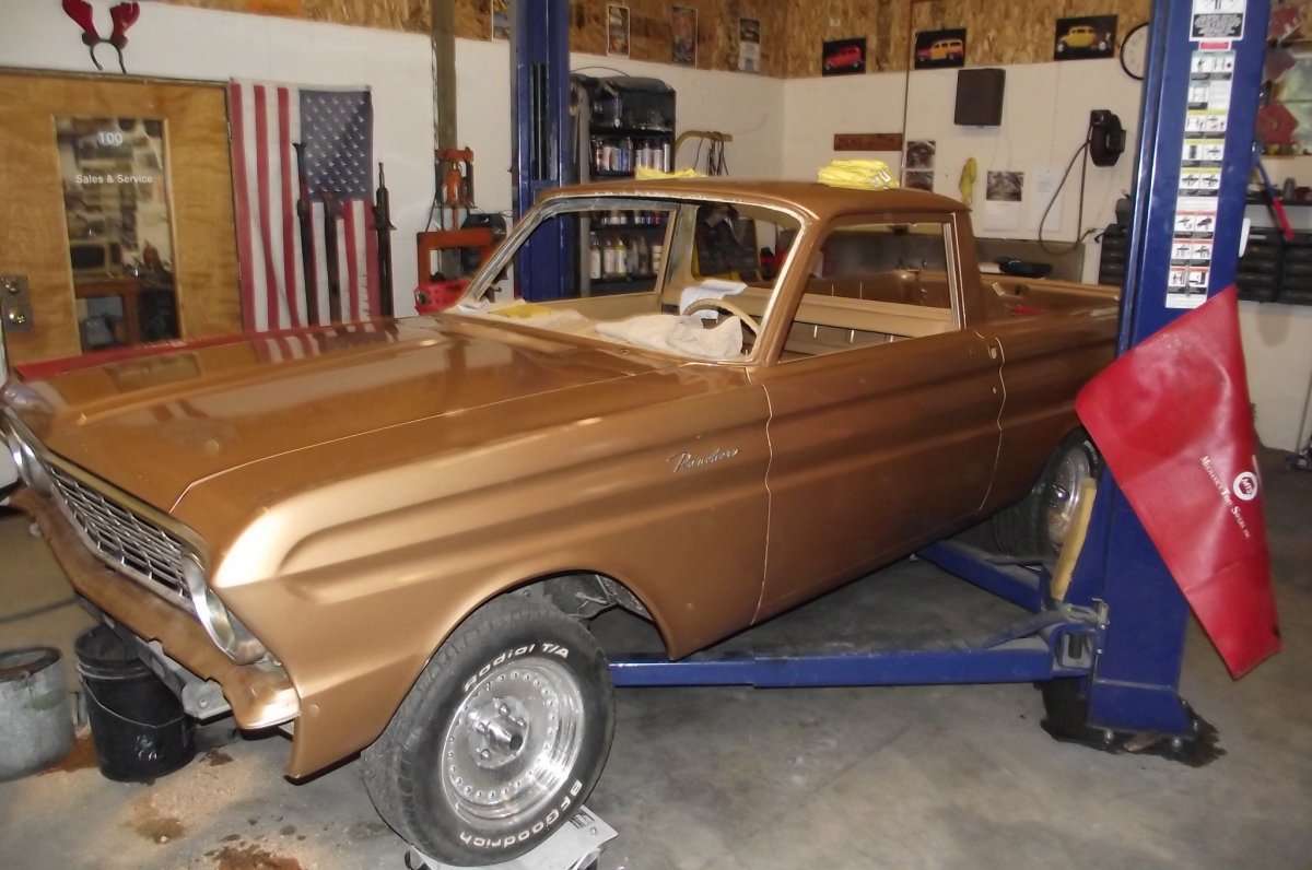

    A little update, brought it down to the shop to be cut and buffed.

    Finished up a F1 engine swap project for a friend so back to work on the Ranchero. Sanding out the dry spots and touch ups on the clear coat and buffing.

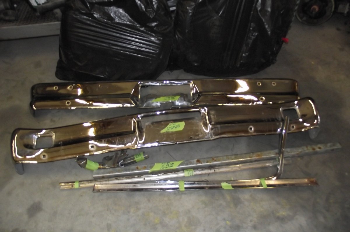

    Almost have the paint buffed out and starting to clean up and install the bright work. The bumpers and bed trim have some rust so I bundled them up to go to the plating shop. One of the down sides of living in the sticks is I have to send them to a shop 200 miles away.

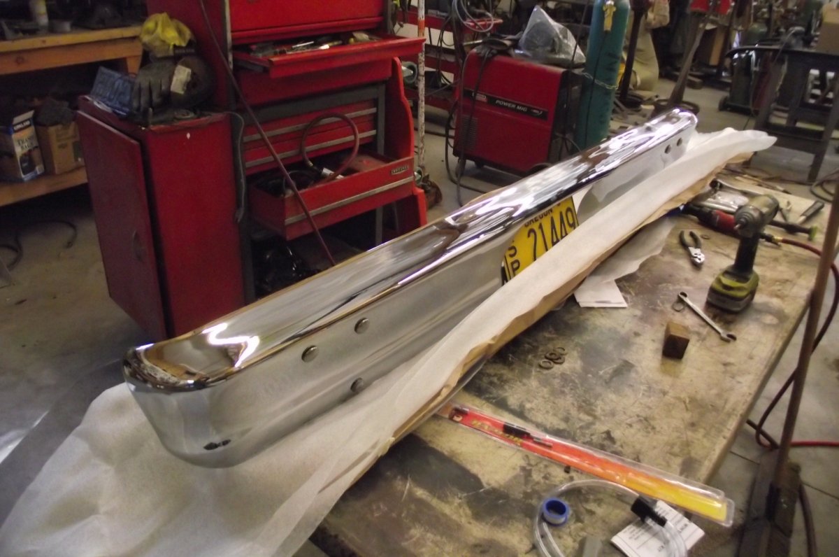

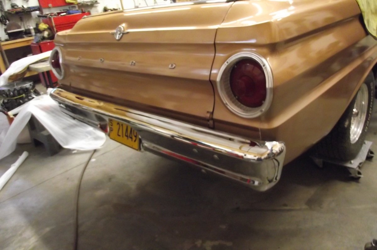

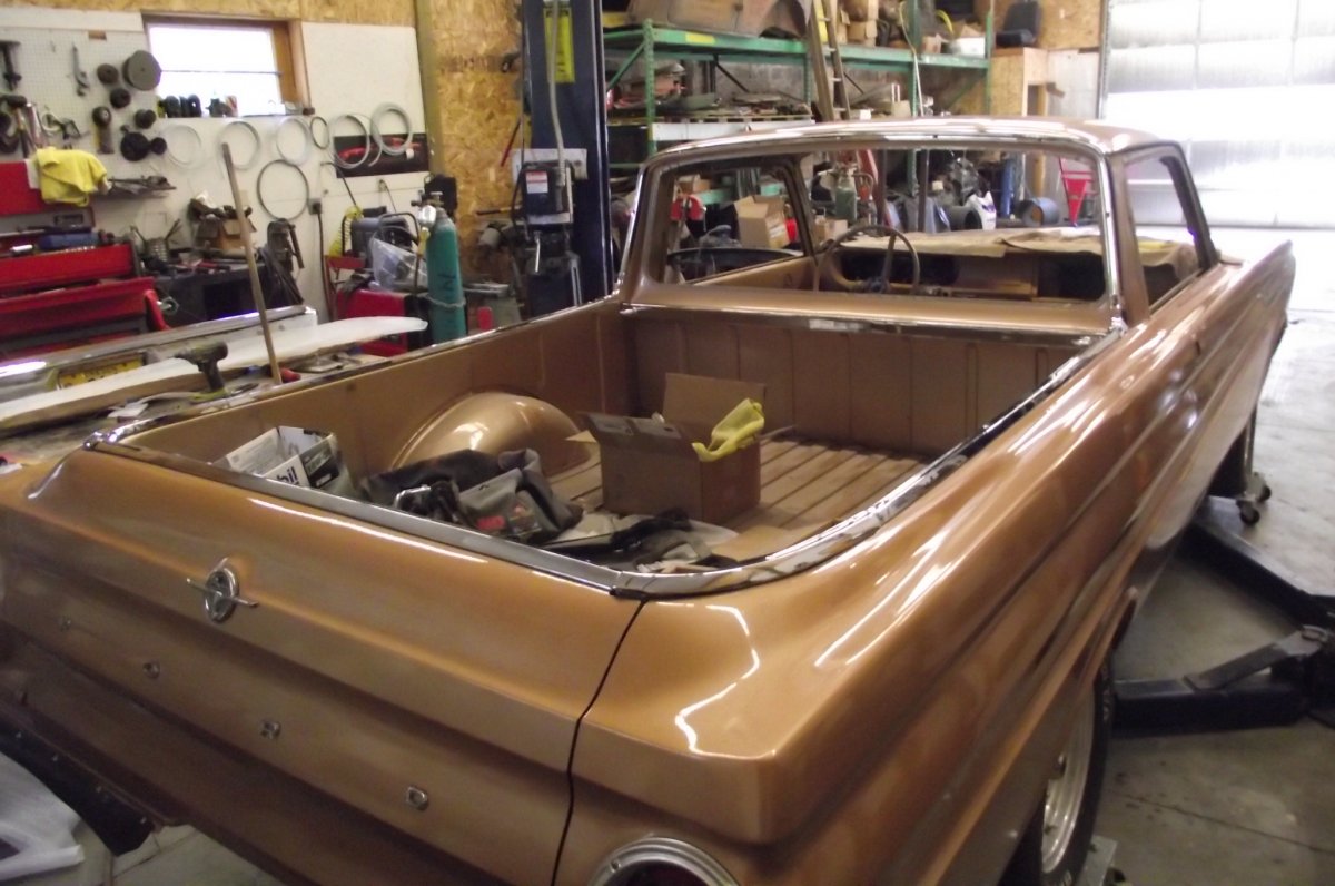

    Got the chrome trim back, they did a great job. Started fitting it up on the back of the car.

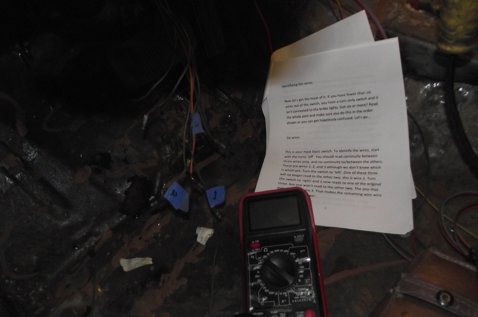

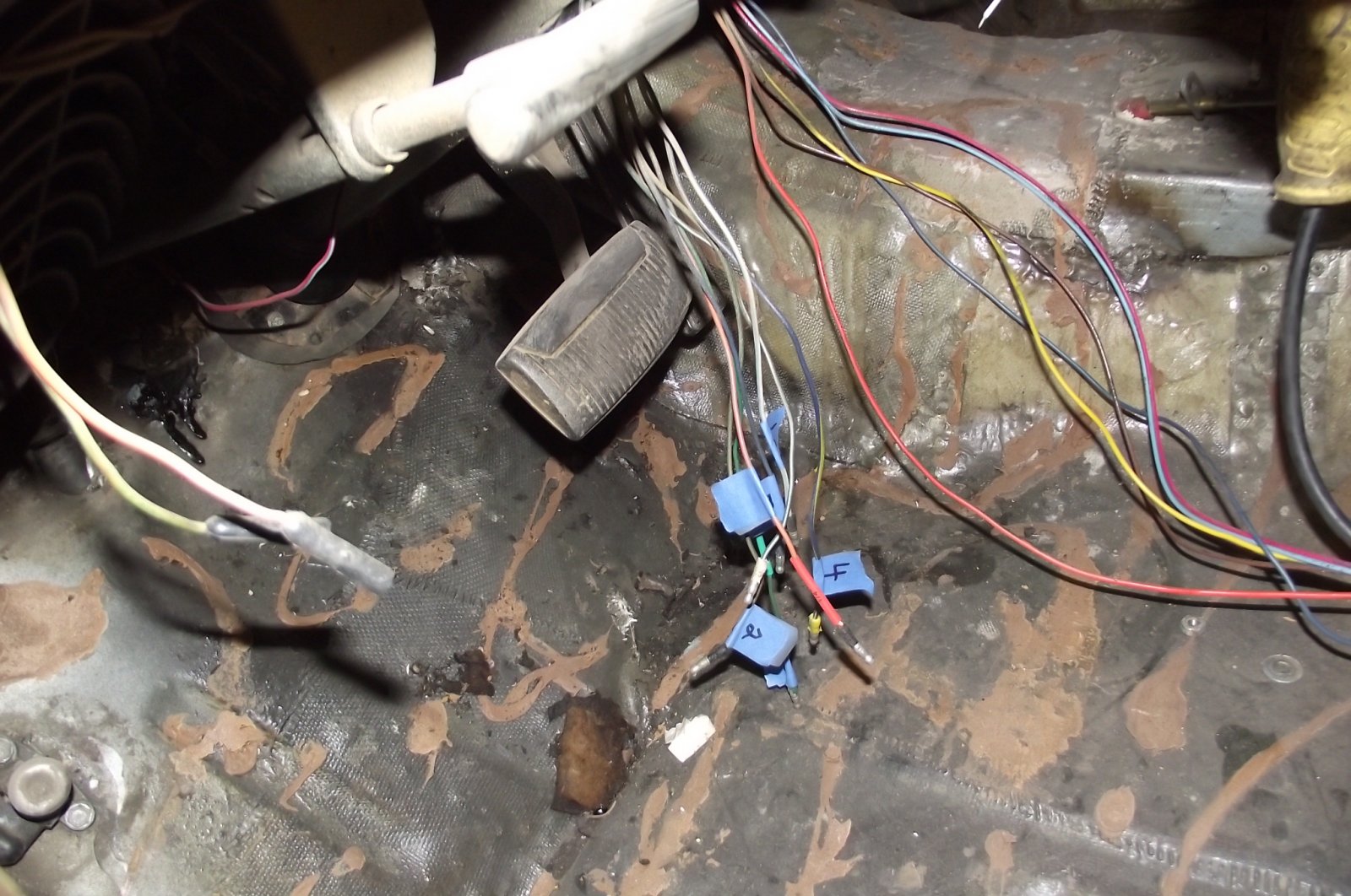

    Armed with a multimeter and a print out of Crazy Steve's post I ventured under the dash to figure out the steering column wires. They sound like a real mind bender but done step by step it works out. DSCF5414.JPG DSCF5413.JPG DSCF5415.JPG

    Got the wiring figured out thanks to @Crazy Steve's how to but now have run into a problem with clearance fore the exhaust manifolds I want to use which are the High performance 289 manifolds, so do I beat up a set of headers, find a set of less sesirable manifolds that might fit and live with the tight clearances or cut the towers out and install a Mustang II type front suspension? Looking for pro's and cons.
