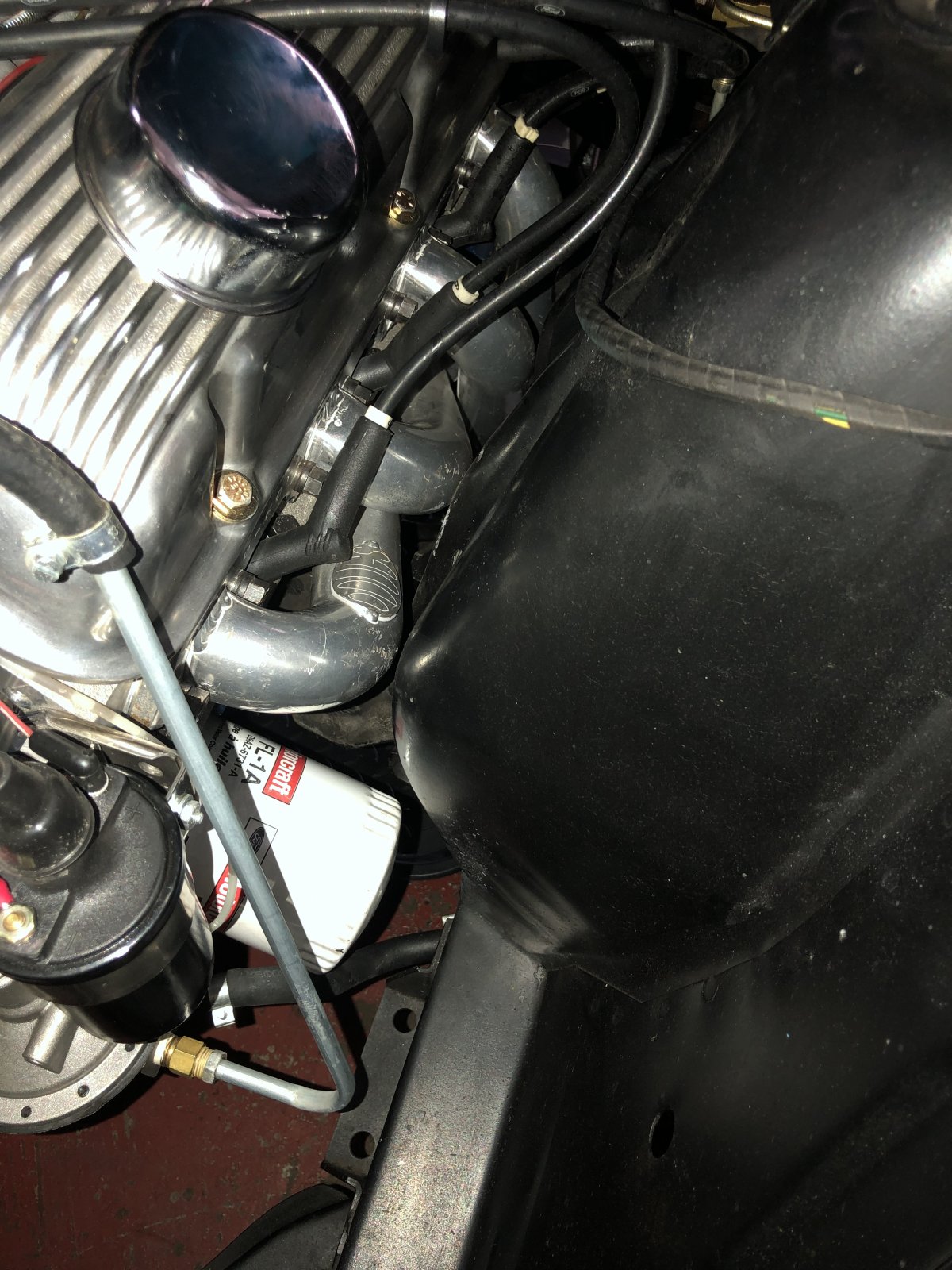

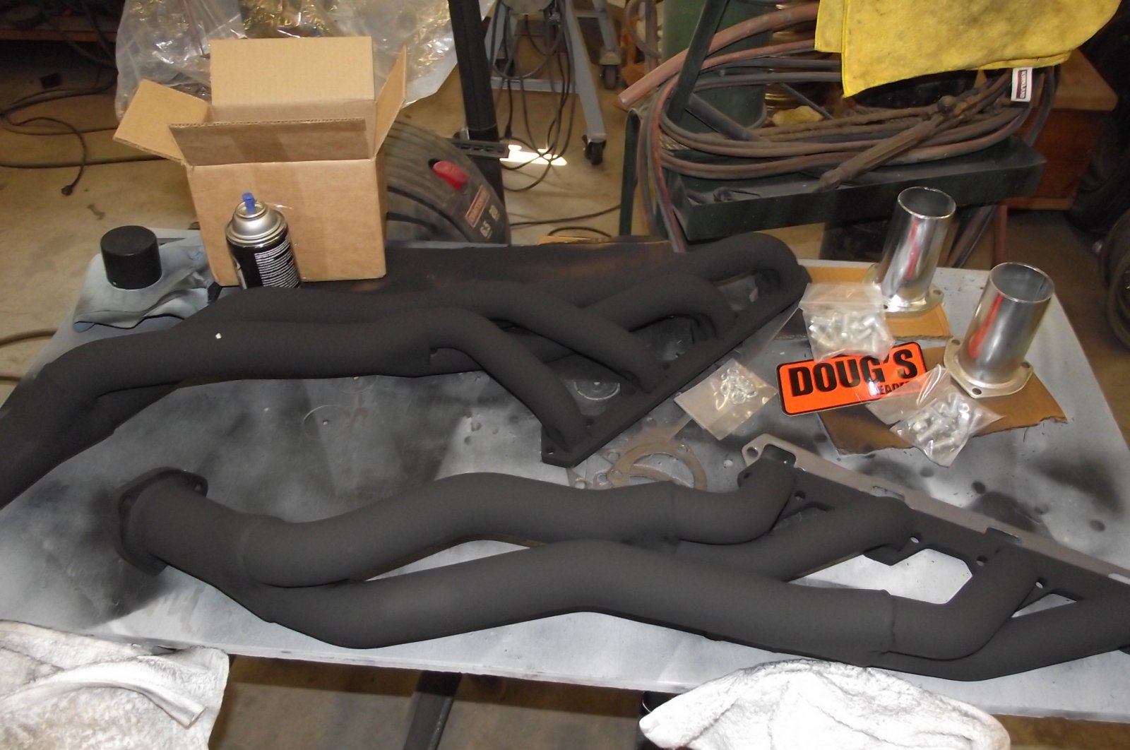

    Was in the right place at the right time…FB marketplace..and scored these never mounted, 660YA for an auto trans, Ceramic coated, Dougs Headers for my 65 Falcon for $300.00 I couldn’t get the money out of my pocket fast enough..they are still a tight fit! I bought the small bolts, and made a “custom” wrench, bit those shock towers make anything a challenge..
    Your Ranchero looks killer…I wish I wouldn’t have p***ed on one a few months ago… 1DF35FCD-160A-4BDB-8A72-759C0947A10E.jpeg 6A3E175E-DB5B-4A75-B0A8-8DF1704A97C0.jpeg 14D65A5B-3EBE-482F-AE90-BB1724699182.jpeg

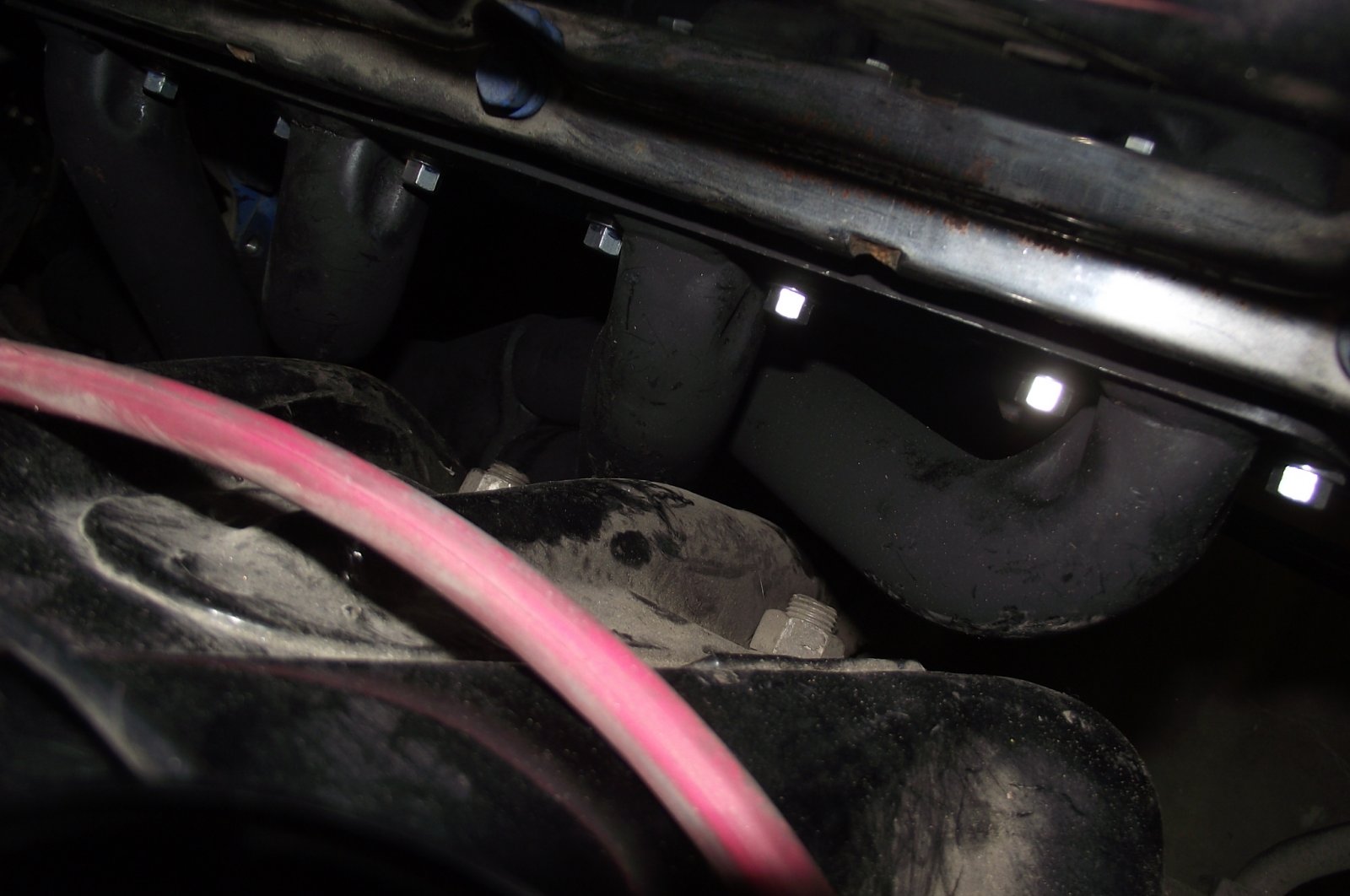

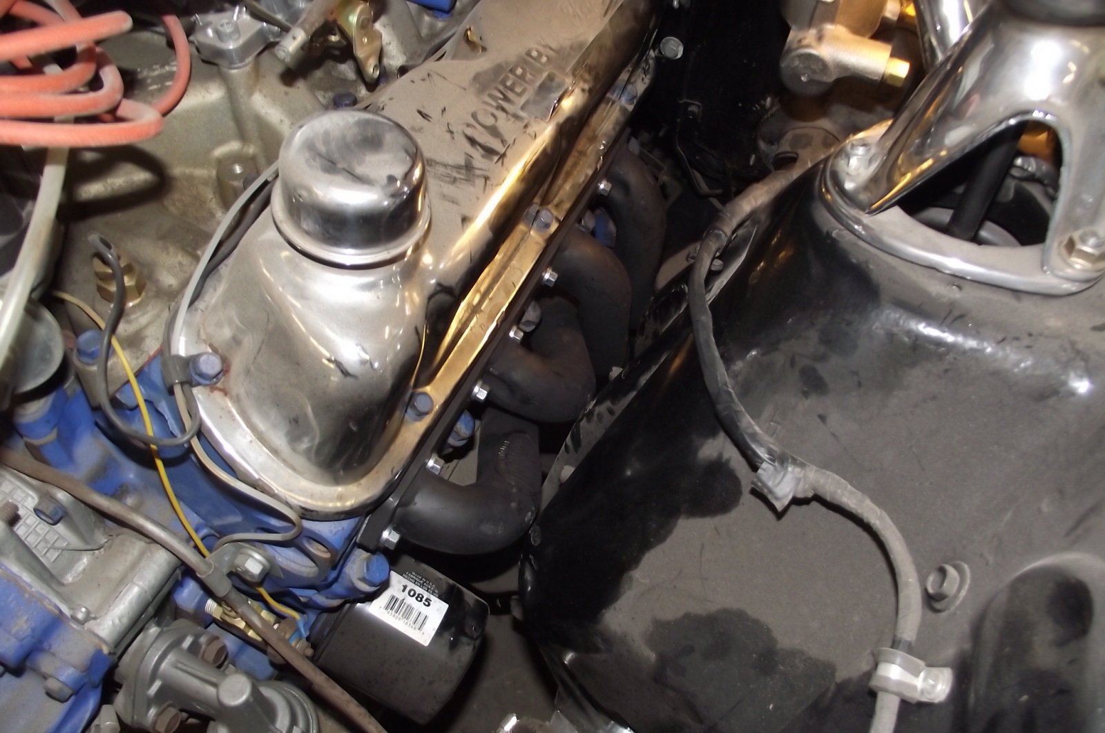

    Well they fit, but DSCF5424.JPG DSCF5425.JPG you have to get every thing right for that to happen. Worked all day today to get the left side in, had to re-work some floor board issues the P/O created .

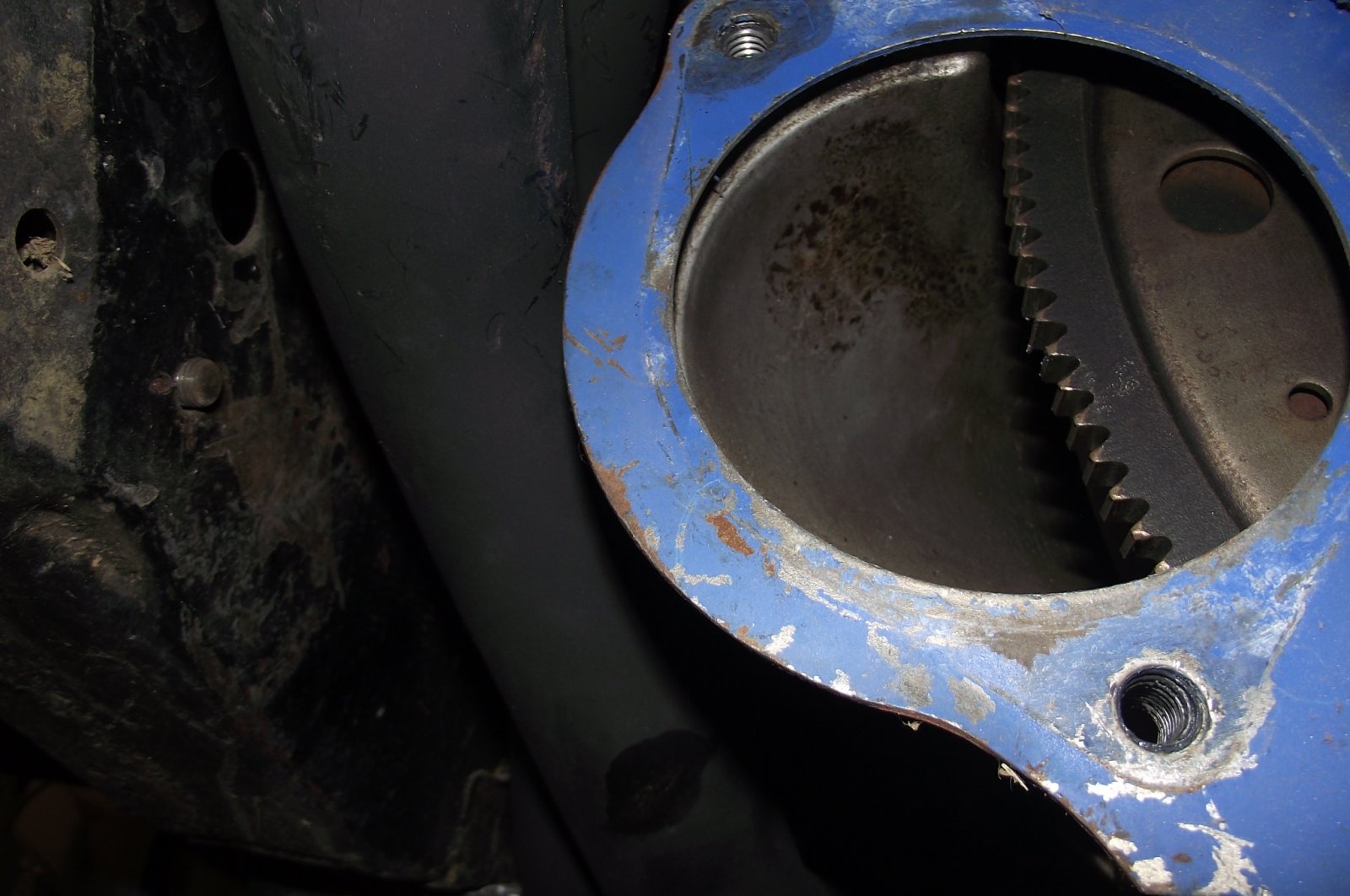

    A real tight fit, but got both sides in. the right side barely touches the stock starter post so I ordered a compact starter.

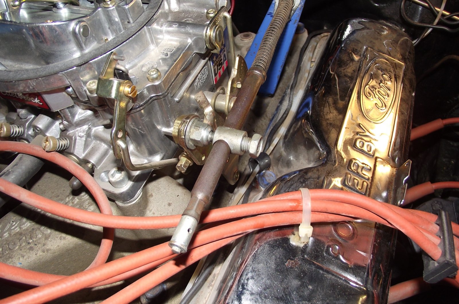

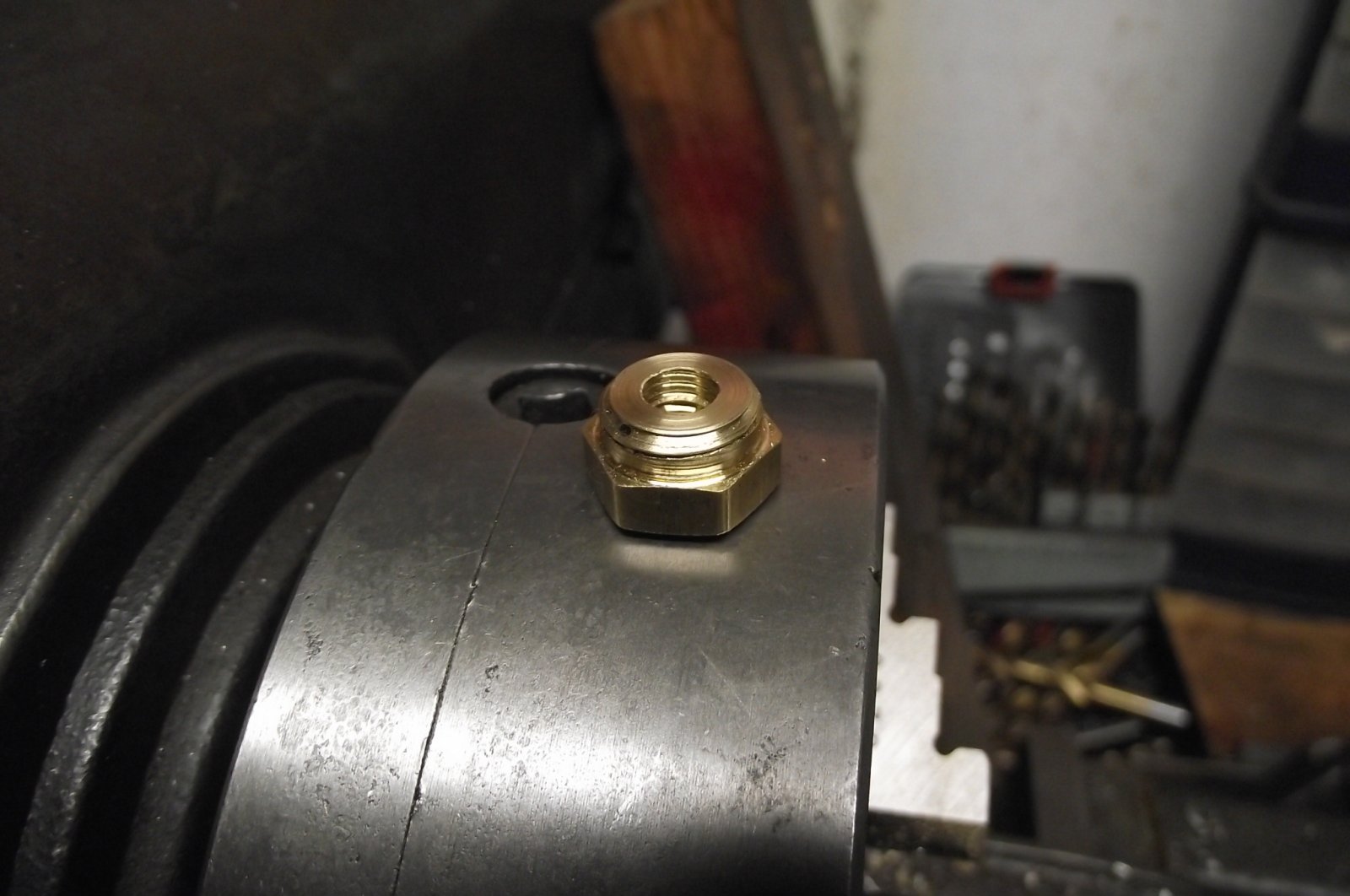

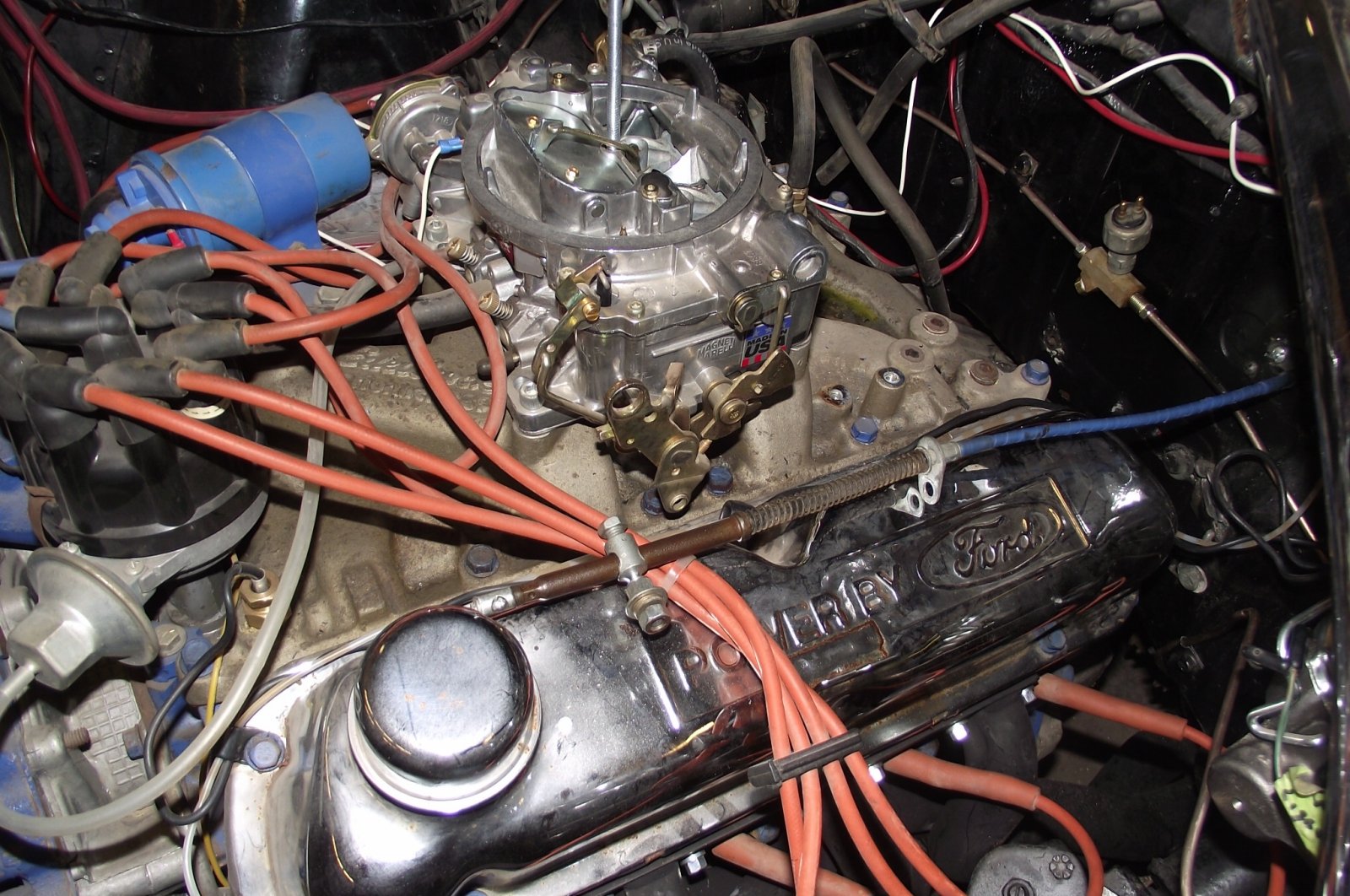

    Been fixing some substandard fabrications, the previous owner used many things from the Grenada donor car when he did the engine swap and left some of it half done. thr throttle linkage was attached to the carburetor with a nifty swivel that sandwiched the large hole at the top of the arm between two 1/4 inch washers and was not secured to the firewall at all. I patched the spot on the firewall with a sheet metal plate and built a bushing for the swivel to thread in to.

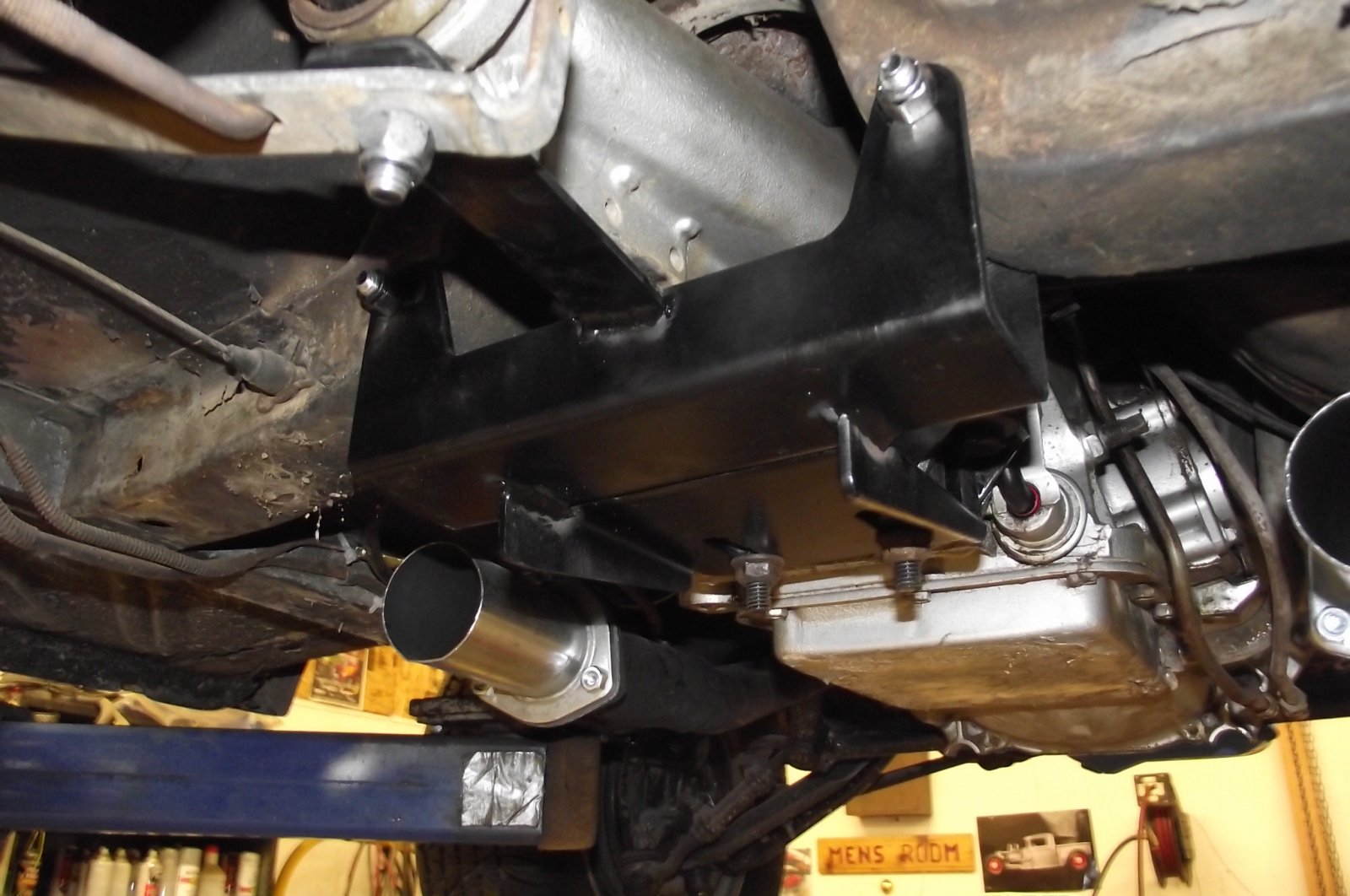

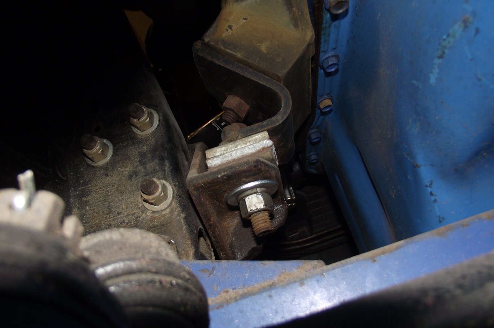

    Then moved on to the engine and trans mounts. He built his own trans. rear mount which at first glance looked good but after the headers were installed the left side was hitting the floor and caused the back if the engine to sit too high, to compensate for this he added a stack of shims under the front mounts which caused the whole ***embly to sit an inch higher than it should, I suppose he did what he could with what he had at the time. There is an adapter crossmember and rear mount available to install a c4 in the 61 thru 65 falcons which will set things straight and I can lower the ***emble back down to where it should sit.

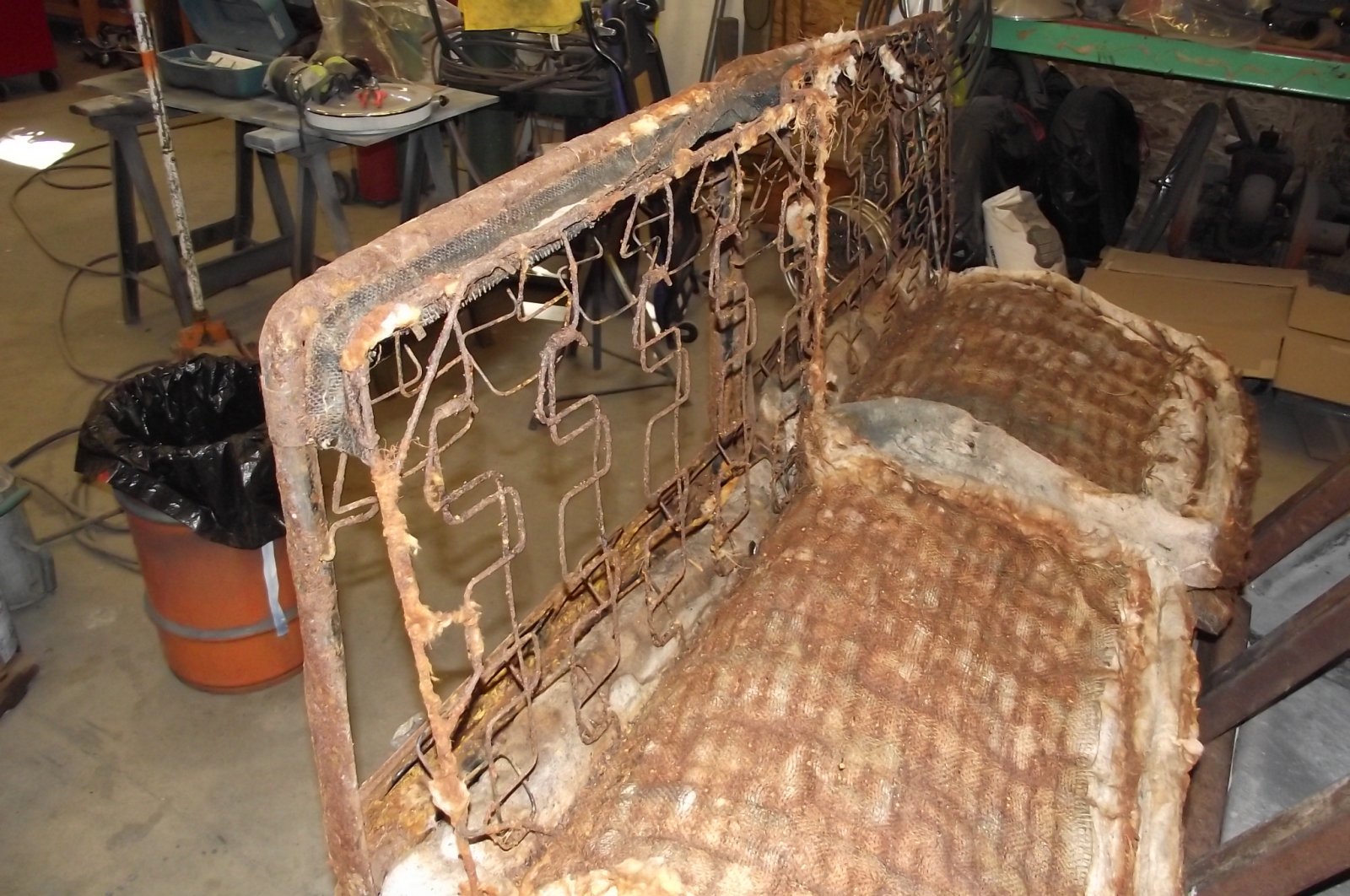

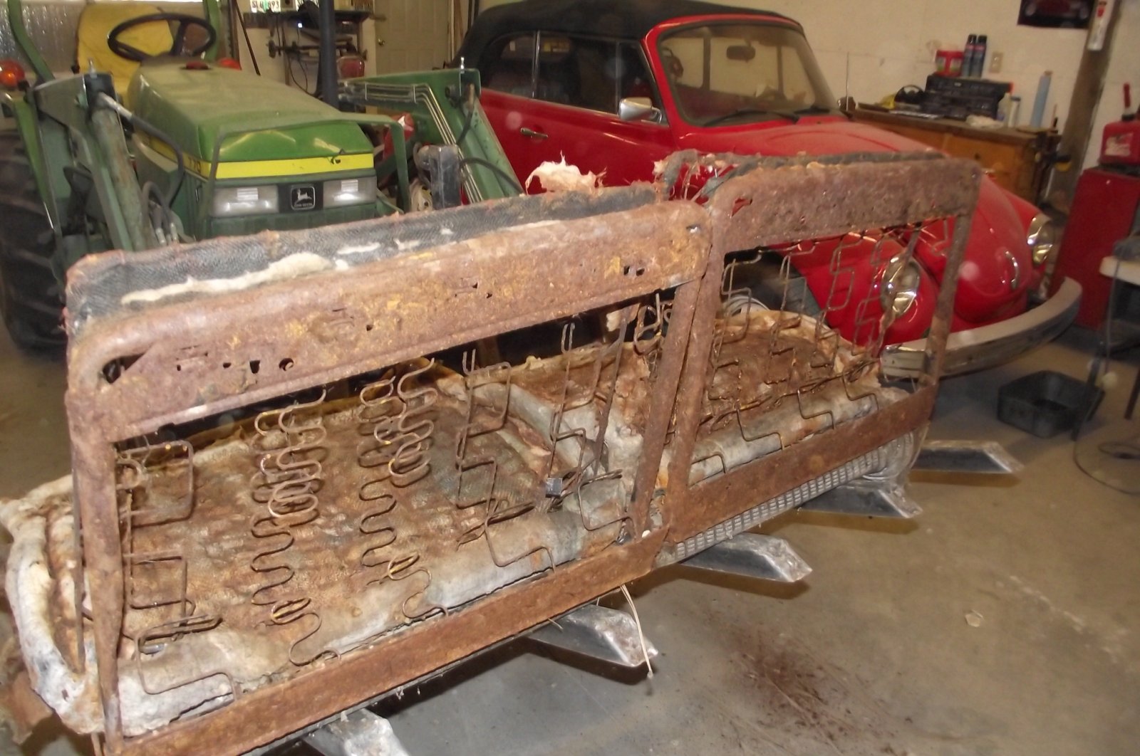

    This bench seat is pretty crunchy but I think I can save it, so into the mol***es vat it goes then I'll replace a few broken springs. I have a couple of buckets out of a 67 Fairlane but would rather have the original bench, That's what the car came with originally .

    Fixing the engine mounts, the way the previous owner had them crunched the collectors up against the floor so I ordered a rear mount to replace the concoction he had cobbled up, and removed the spacers he installed under the front mounts for heaven knows what reason. Had to re do the throttle linkage and the throttle pressure rod to the transmission.
    Been putting a lot of time and effort into my beater with a heater project but the 56 wagon
    but that will be another build thread.

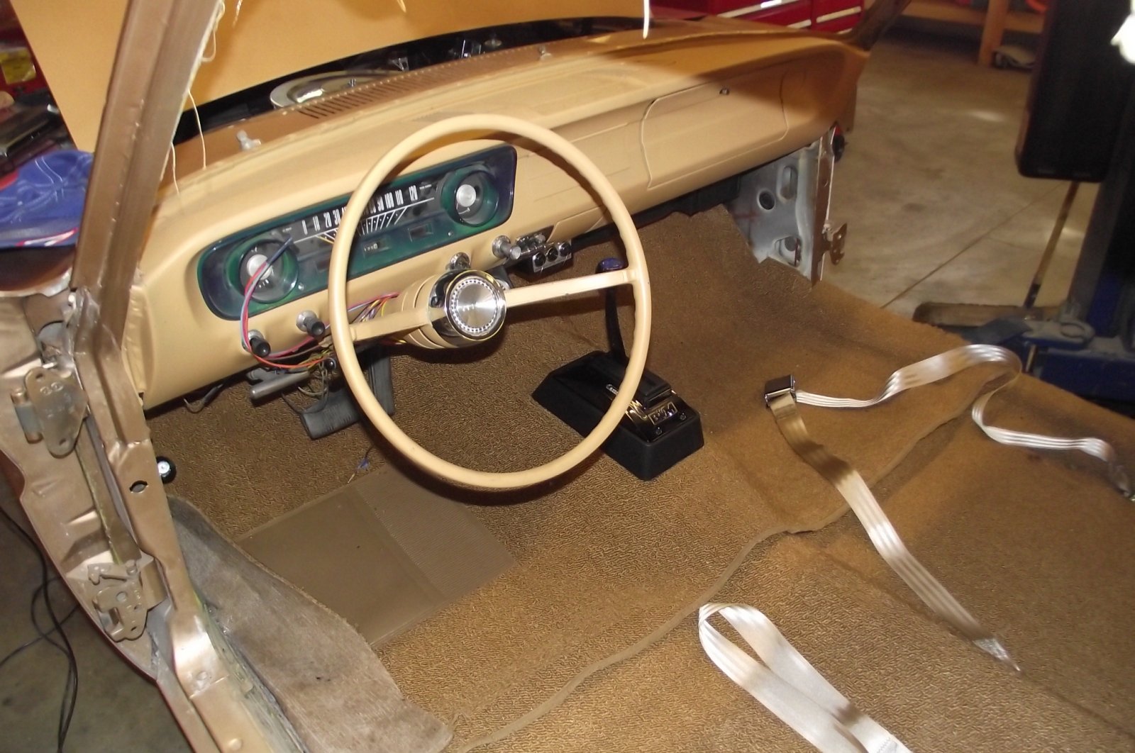

    Starting to work on the interior, installed seat belts, new carpet and glove box liner. Ordered and recieved new seat upholstery and a headliner, think I'll hire someone that knows what they are doing to install that stuff. A man has got to know his limitations:D

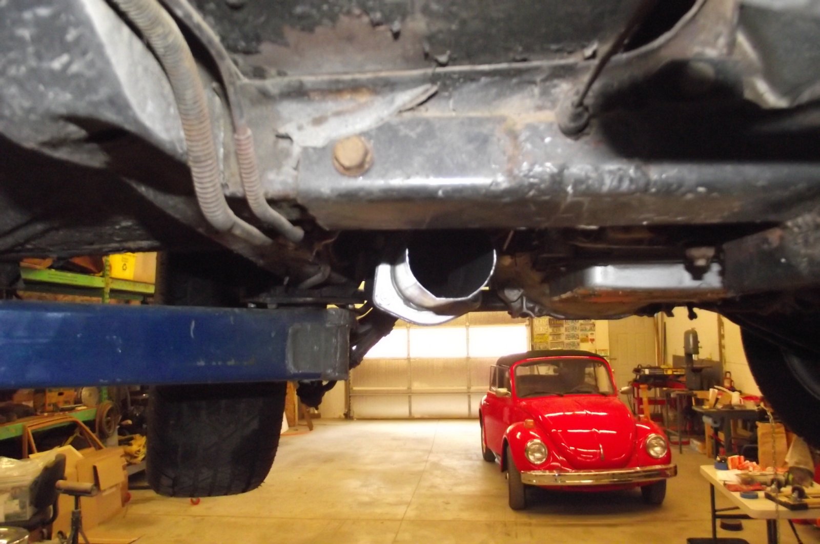

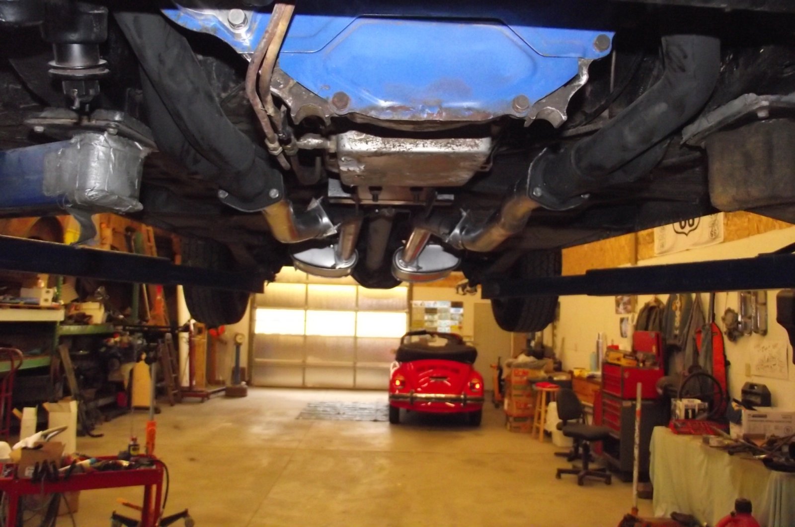

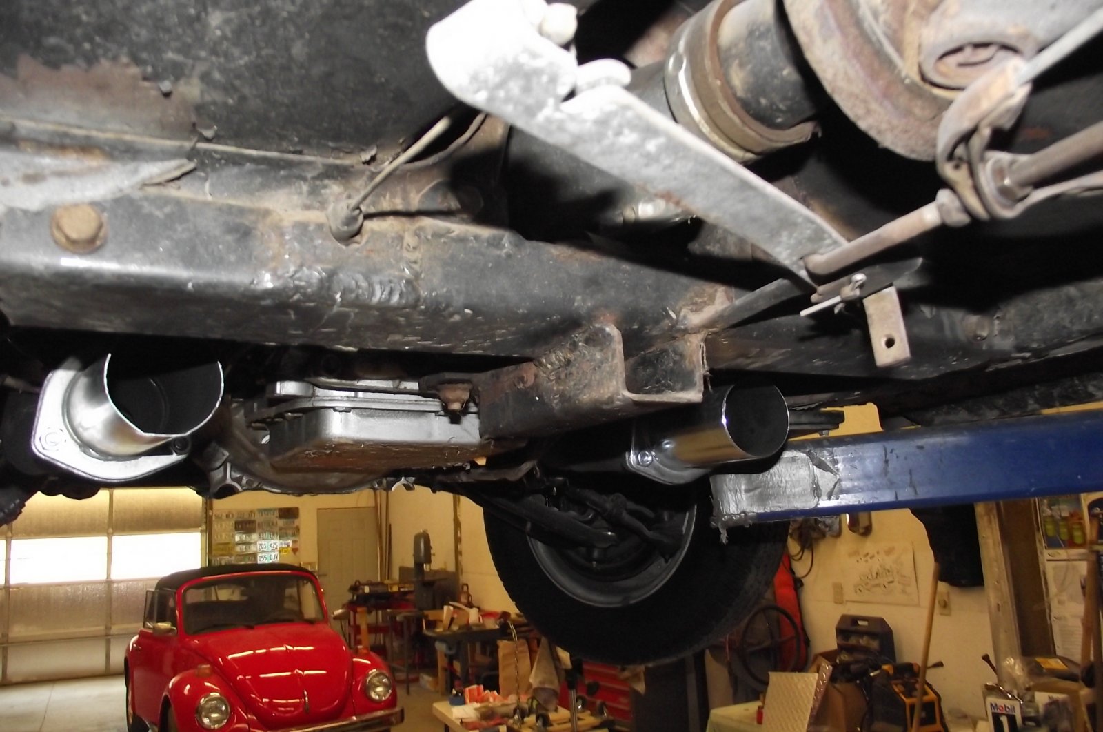

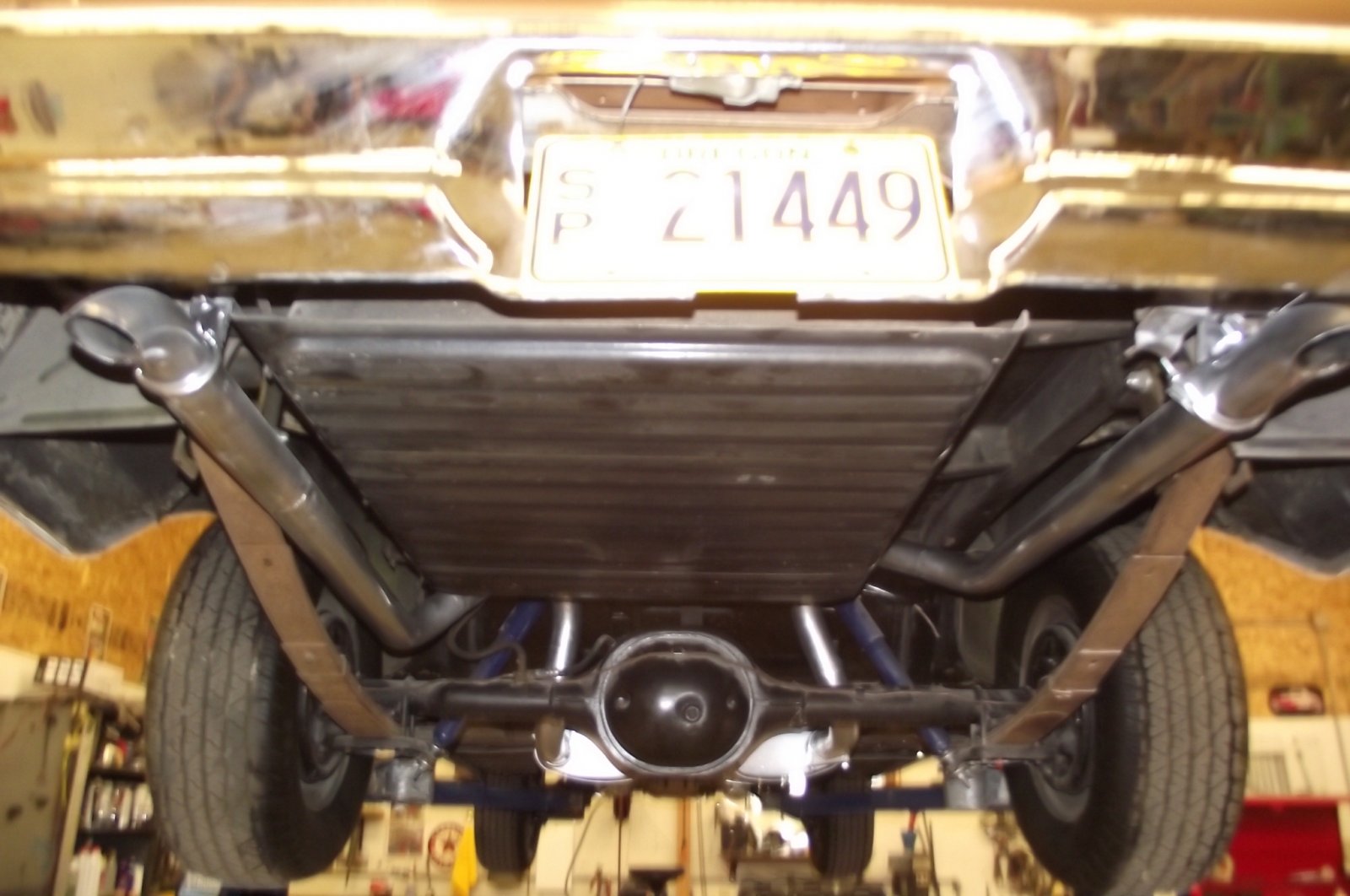

    Got busy last week and pieced together an exhaust system.

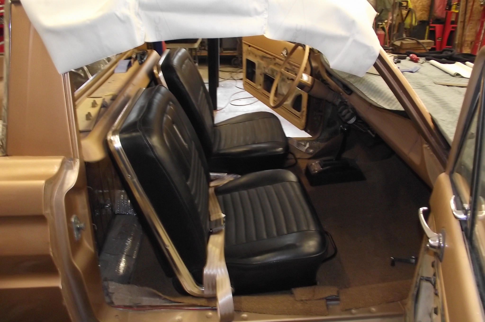

    These are some seats from a 67 Fairlane that I acquired a while back, I mentioned them a few pages back. My original seat is beyond repair so I'm going to make these work. Here they are mocked up and I can fit my six foot 210 pound frame in them comfortably , so off they go to the upholstery shop to be recovered in the right colored vinyl.

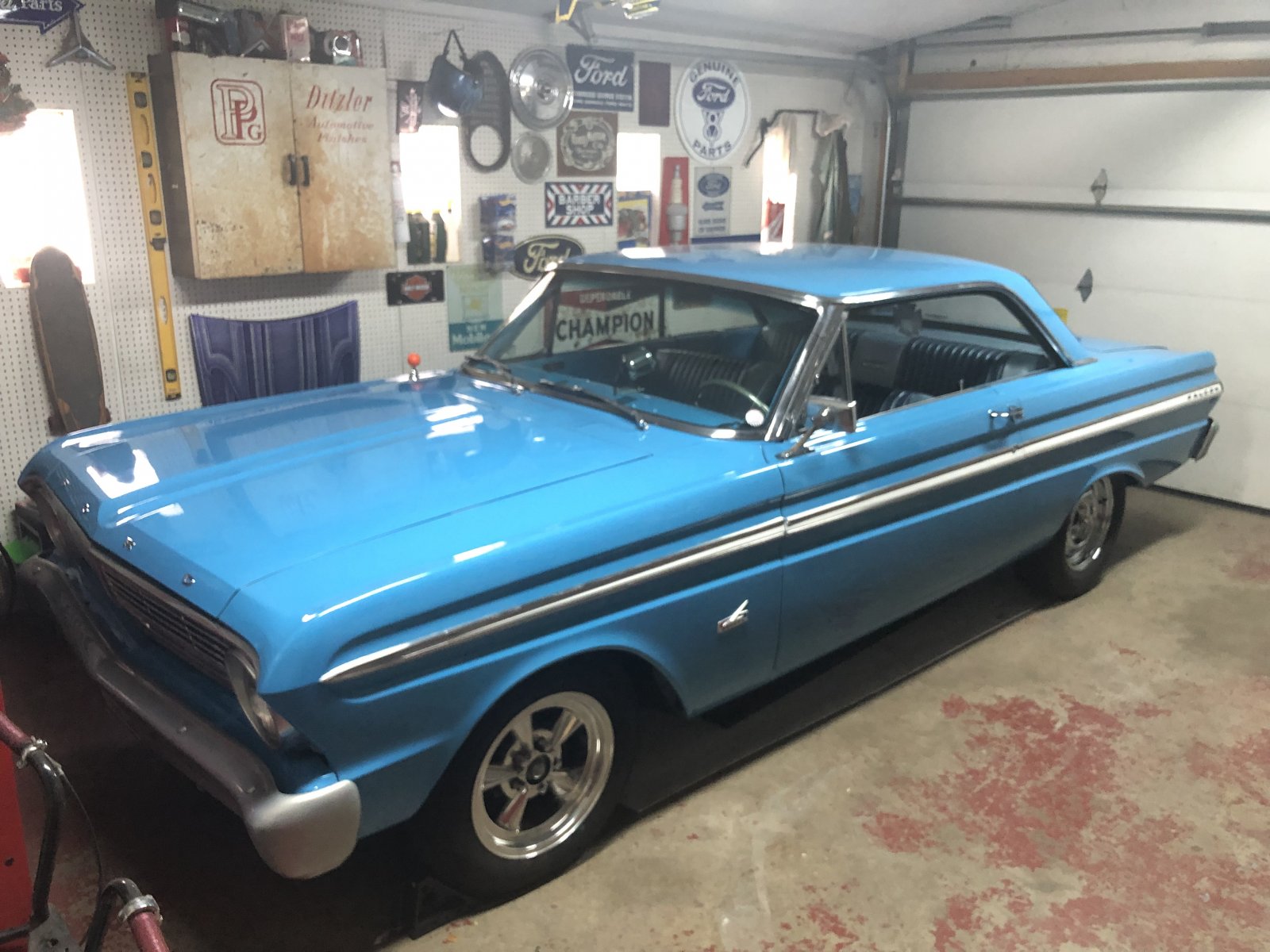

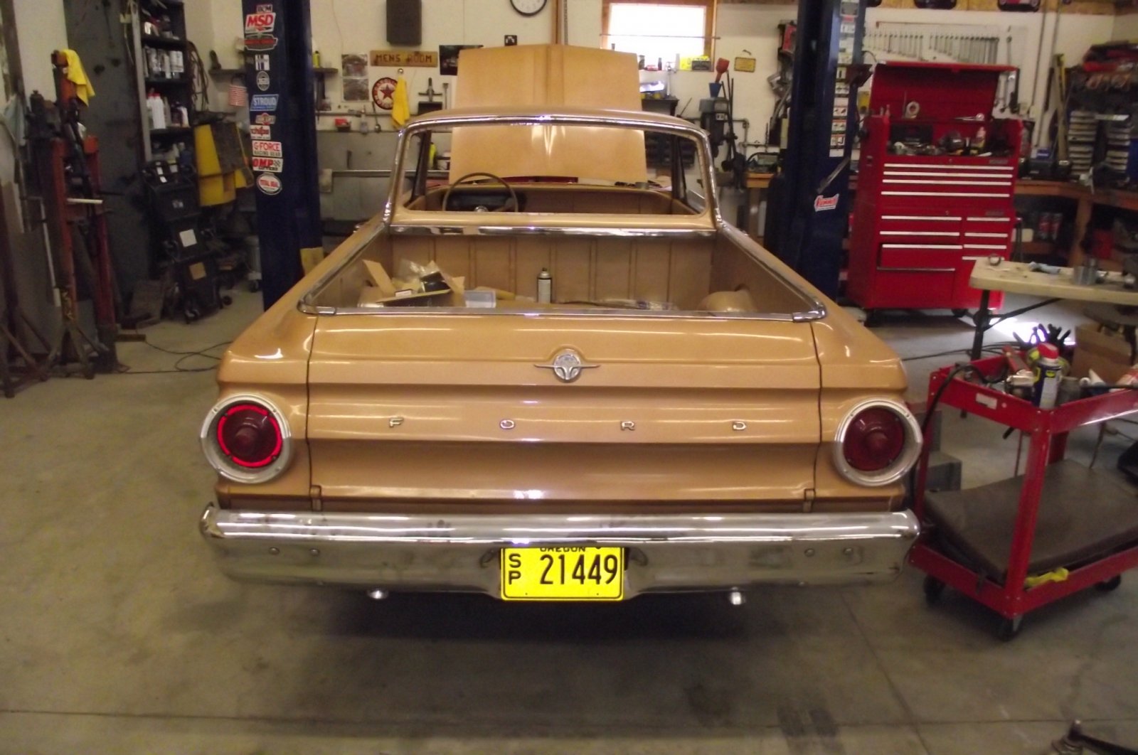

    It has been many years since I got the wild hair to re-create my favorite car of all times, this Ranchero is a close copy of the car I bought new in 1965 when I was 19 and drove for 5 years, I've always regretted selling that one but after the children came along we needed something with a back seat.
    All that's left to do is smooth out the wrinklies in the head liner and install the windows, then one time over it to check for anything left loose. It will be my summer driver and taken care of a lot better than my original.
    DSCF4633.JPG DSCF5891.JPG DSCF5892.JPG DSCF5893.JPG DSCF5894.JPG DSCF5895.JPG DSCF5896.JPG DSCF5897.JPG
