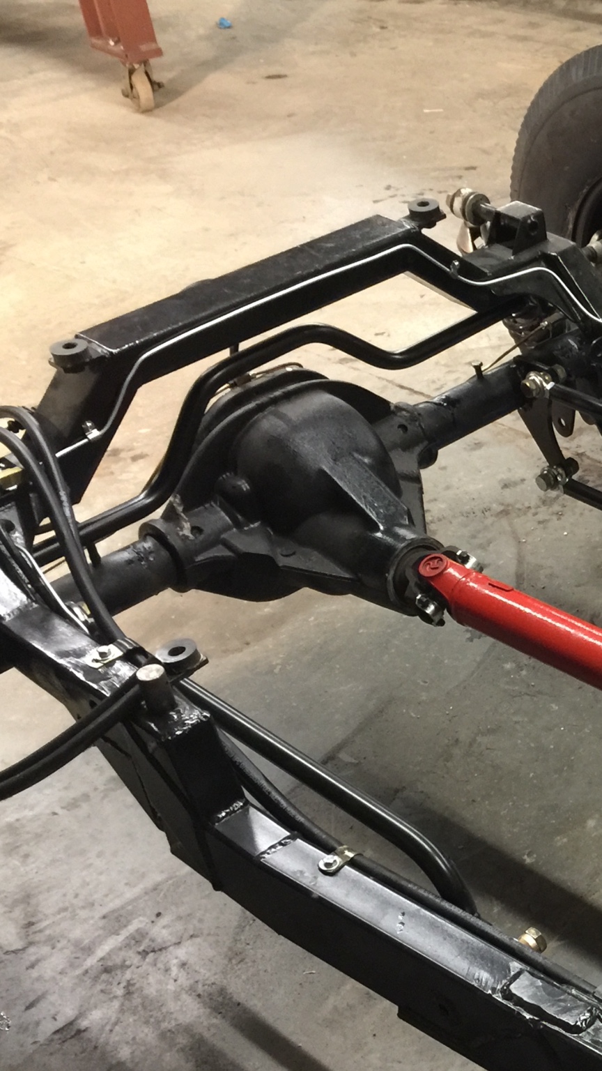

    Found this front mount setup. Clean and should fit in your space??. My original thought was to put horizontal on top of housing and not vertical but hopefully you get the idea. 0601sr_15_z+hot_rod_rearend+.jpg

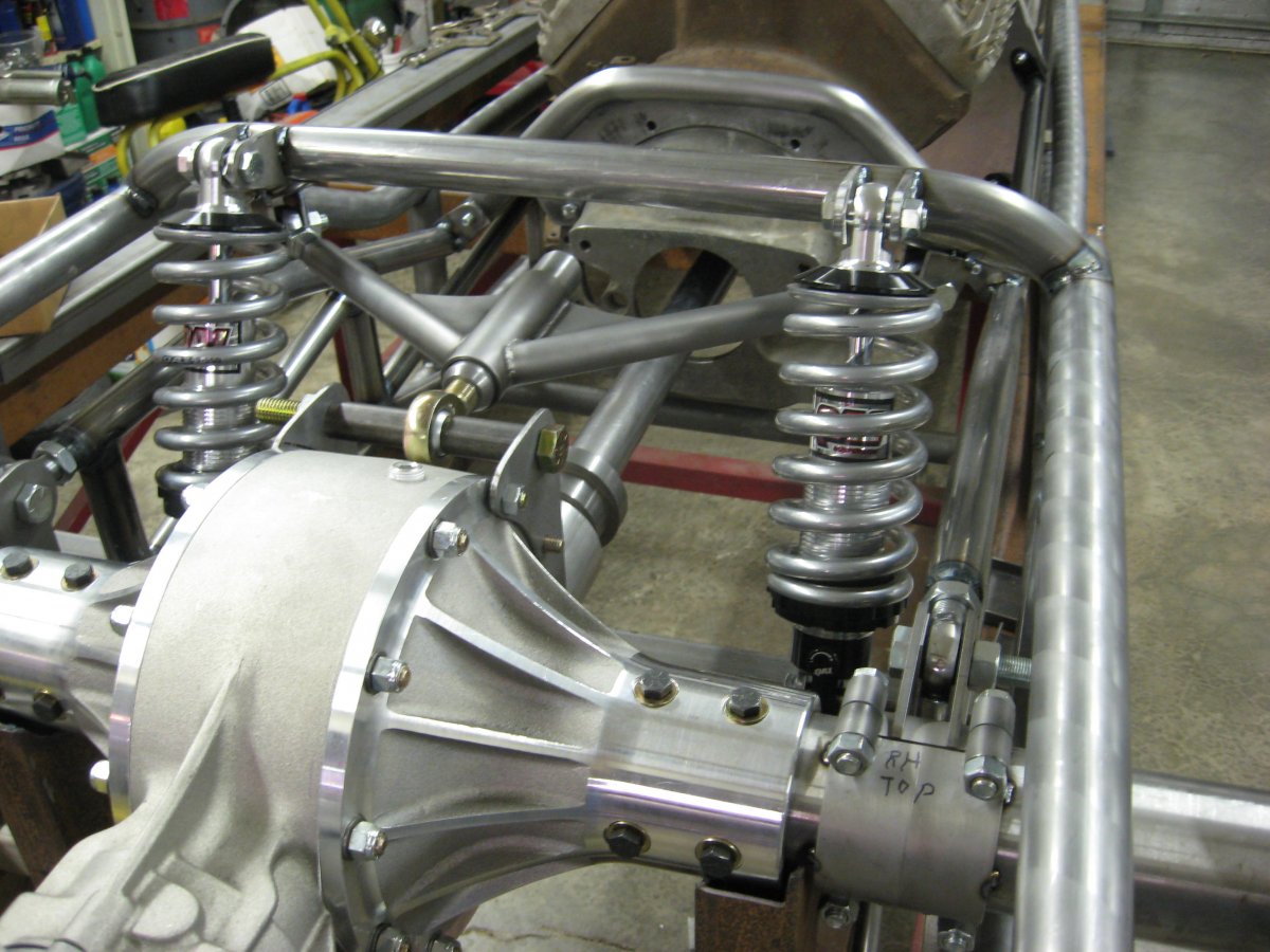

    Anyway...Tim...i wonder do you have room to use a low telescoping "Y" locator to the bottom of the pumpkin? That would keep the roll center low and would be much less involved if you have room for it.

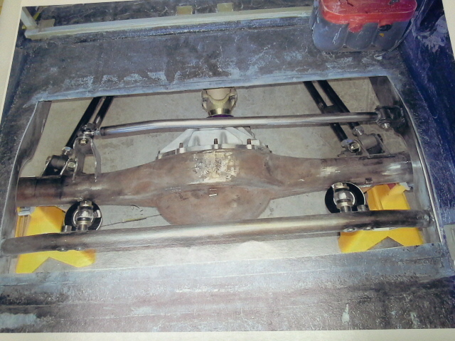

    Tim, do you have a pic from standing directly over the rear axle looking down? I am wanting to see how much space you have.
    What I am getting at is, the following pic of your set up where you had a panhard rod mocked up could work by getting to two pivot points level with each other.
    It's kinda tough to explain from my phone without a sketch but I will try if I see a pic from above.
    Of course it will not be nearly as wide(long) as an ideal set up, but it could certainly work.

    Okay, from what I can see you could easily make a drop bracket for the underside of driver side rear kick up. That would give you an additional 6-8" length. Your mounting point on the axle could be scooted a couple inches towards p***enger side as well. You'd have plenty of length and it would perform absolutely as it's supposed to.

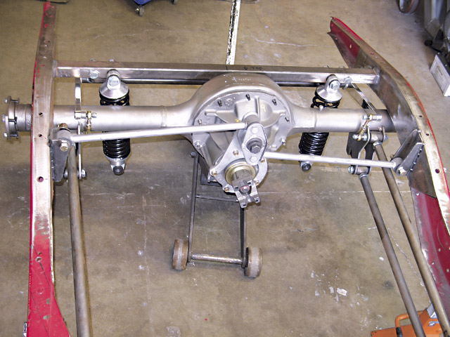

    I had to install this Y locator on top, being a Bonneville car, hopefully the driver won't be making high speed turns ! IMG_3876.JPG

    Marty,
    Can you post some pics of this from a couple different angles or if you have let me know where I can view them at? I'd like to archive this for future reference.
    Thanks.

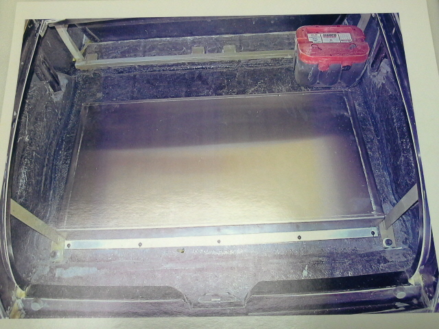

  16. DDDenny
    Posts: 23,424
    You want overhead.
    Trunk clearance issues solved.

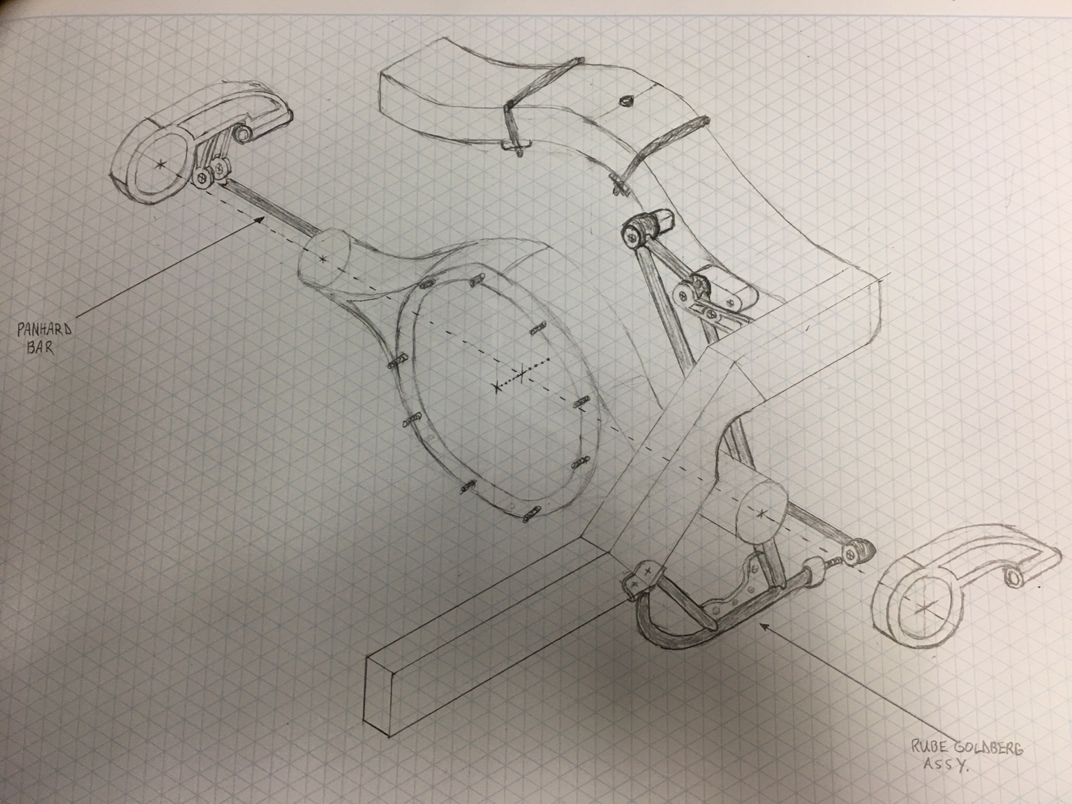

    You couldn't see how it positioned the axle because I hadn't finished the sketch. After I got done "Rube Goldberging" it, here you go. I'm not feeling too excited about this after finishing the sketch, but I wanted to show what I was attempting to do.
    I get what you're saying, but if the bend goes away from the pumpkin toward the rear of the car it will hit the rear crossmember, so the bend needs to go vertical, like I had it in Rev. bb. The axle mount can't go towards p***. side any further because it will interfere with shock travel. The drivers side mount can't go under the kickup because then the panhard bar would have to go through the shock on that side.

    Denny, that's slick - and I like it a lot - but I don't have any room to go forward of the axle on top due to seating area. I like your idea to visit Mr. Strode as I have some wide 5 stuff I'd like to discuss at some point..... Sometime after the swap meet perhaps...

    Maybe??? Better than the other sketches I think. It would need roughly a 2" drop in the middle to clear the 3rd member. Roughly 34" long. Would be far less noticeable in front of the axle down low. I would have to run it through the ladder bar tubes, but with the different mounting holes as shown, I don't see this being too big of an issue.

    Hey, Tim;
    So far, the under pumpkin/u-joint bar is the best version yet, & should work the best n cause the least problems.
    One other possibility, *might* be to use/create a "dead perch" for the rear. They make them for the front springs, but should work on the rear also - as long as they 'pivot' from the same side of the ch***is. Same idea for panhard bars. You'd get a bit of side-movement but it'd be controlled, & considtant. I'm sure it's been done before, & am curious to see what was the problem(s), if any. & why it won't work.. Granted, it wouldn't be as good as a panhard bar, but I can't see it being worse than nothing.
    FWIW.
    Marcus...
