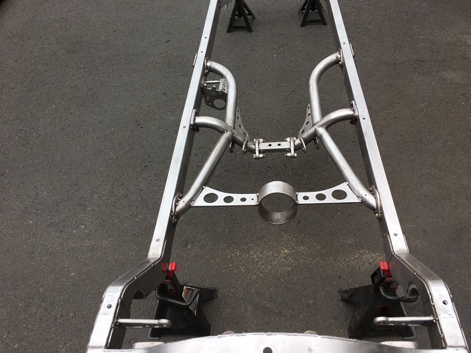

  19. Tim_with_a_T
    Joined: Apr 30, 2011
    Posts: 1,816
    Tim_with_a_T

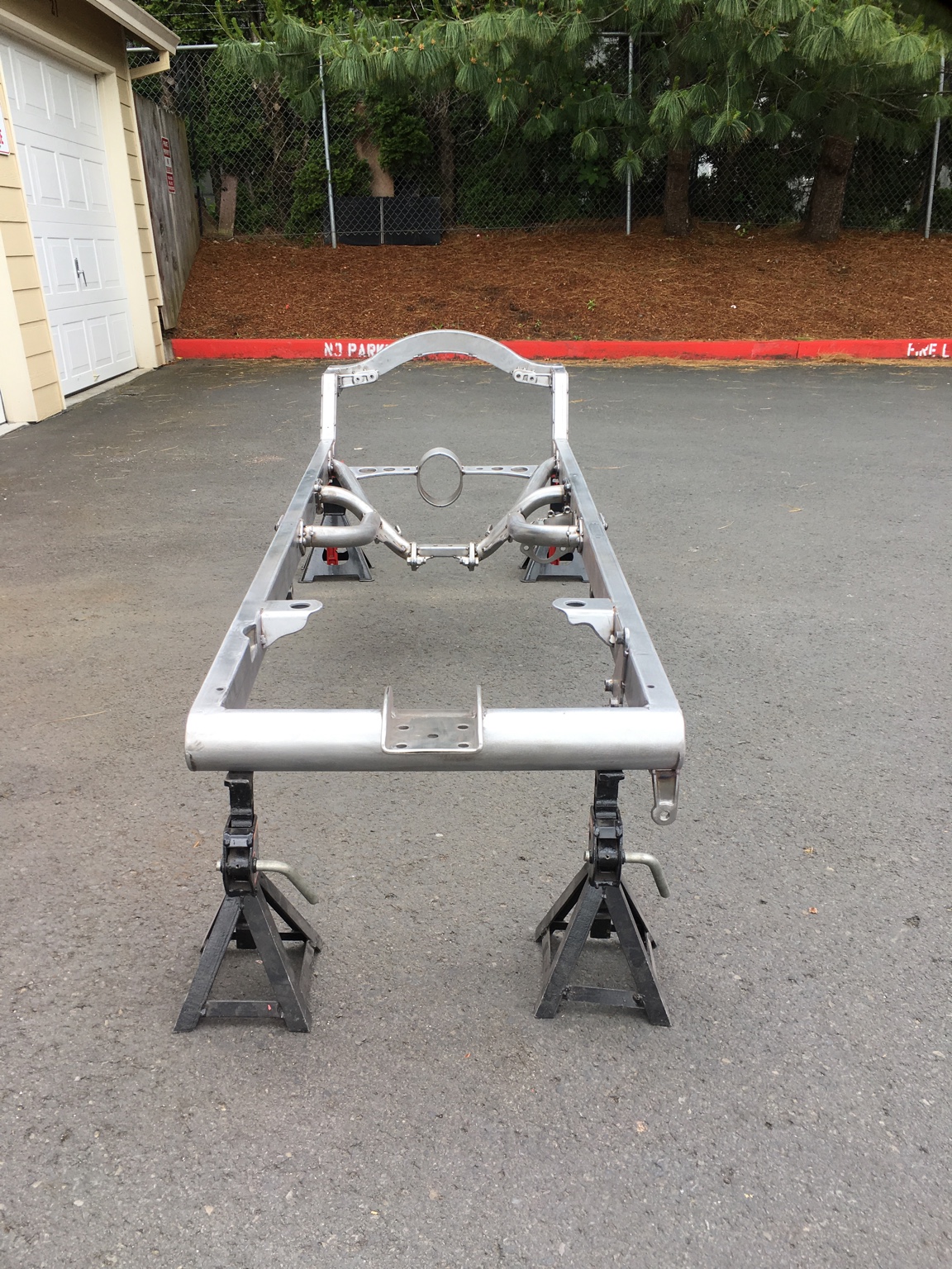

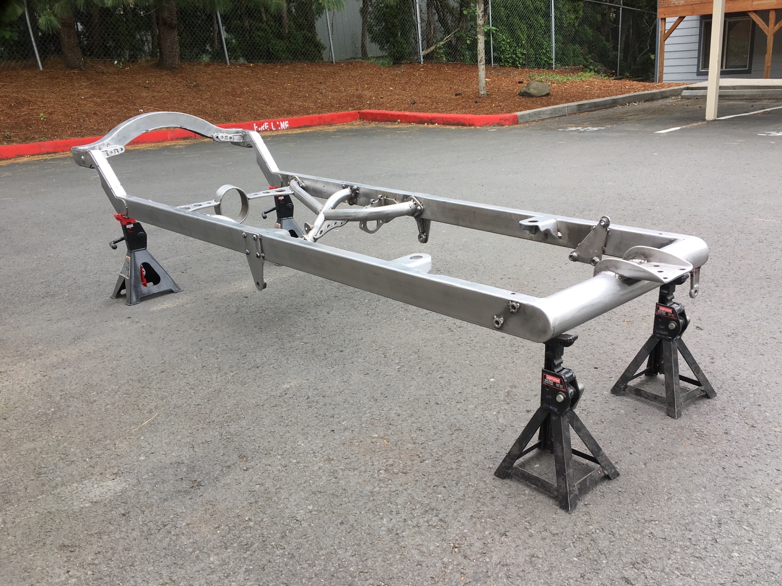

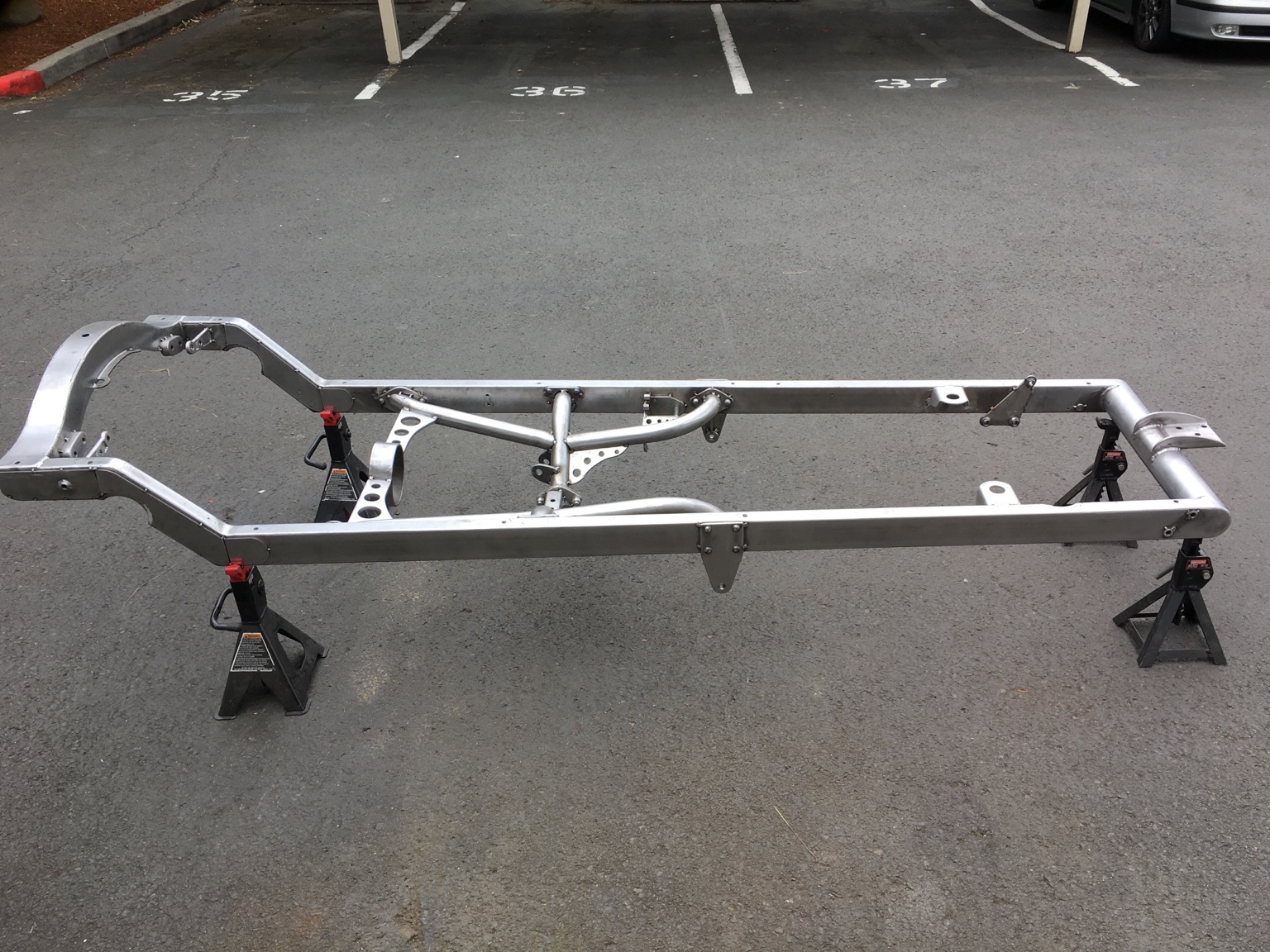

    Bird-Poo tack welds aside, I'm pretty proud of this thing. I made a giant mess, but it's in the queue to be welded by a professional.
    AHotRod, OFT, slv63 and 8 others like this.
  20. Baumi
    Joined: Jan 28, 2003
    Posts: 3,478
    Baumi
    Holy s**t, this thing is way too beautiful to be hidden under a body.... awesome job, dude!
    loudbang, brEad and Tim_with_a_T like this.

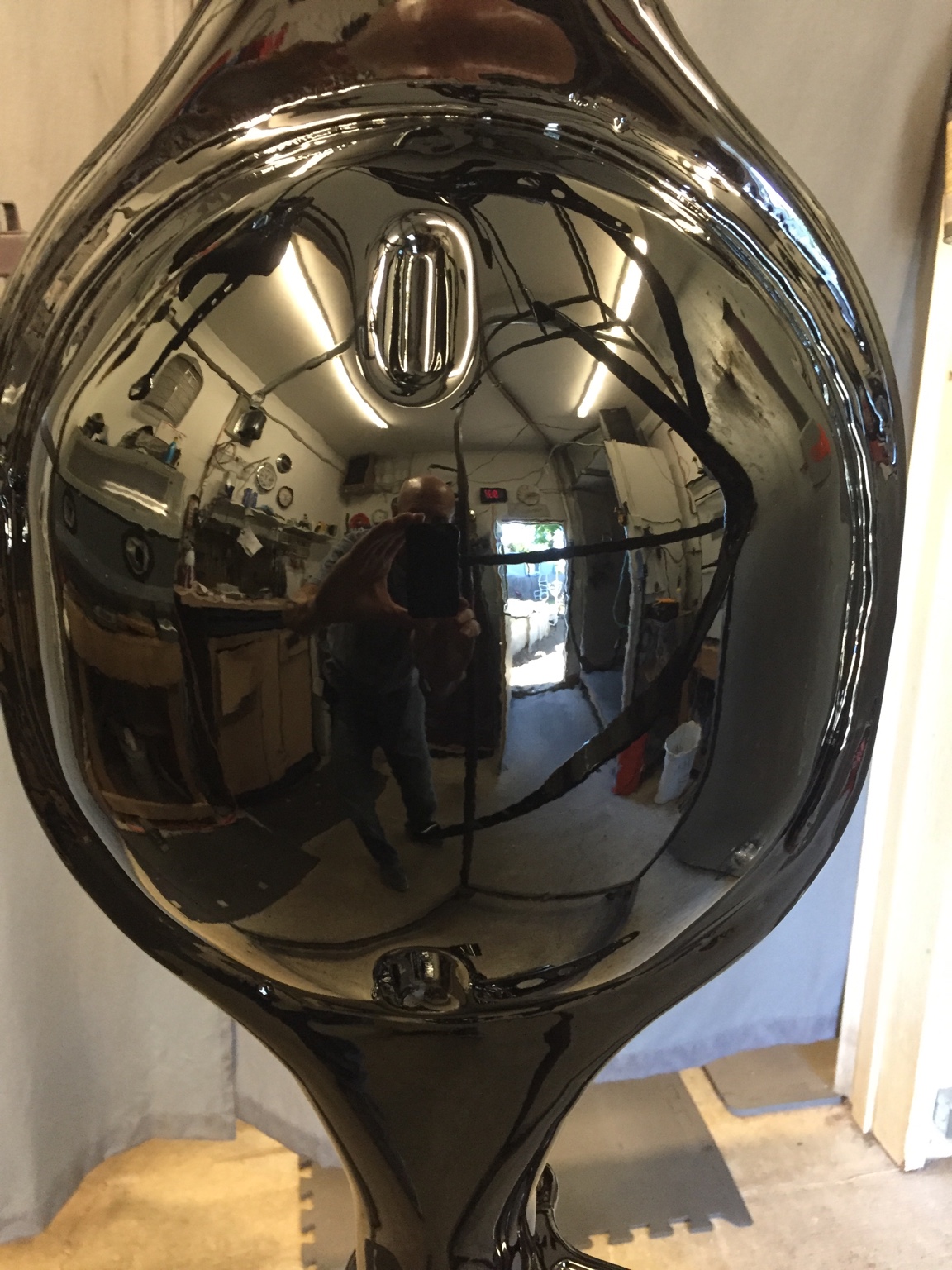

  26. Blue One
    Joined: Feb 6, 2010
    Posts: 11,578
    Blue One
    from Alberta
    Yes, it looks nice. It's powder coat which technically is paint I suppose, just applied and then melted :) :cool:
    brEad, loudbang and Tim_with_a_T like this.
  27. Tim_with_a_T
    Posts: 1,816
    Tim_with_a_T
    Russel the powdercoater sent those pictures yesterday before lunch, and I couldn't help but let out a yell of disbelief. We were on our way to the family cabin on Cascade Lake in Idaho, so my brother and cousin thought I had lost my mind for a second. I showed them the photos, then we about ran off the road for not paying attention lol.

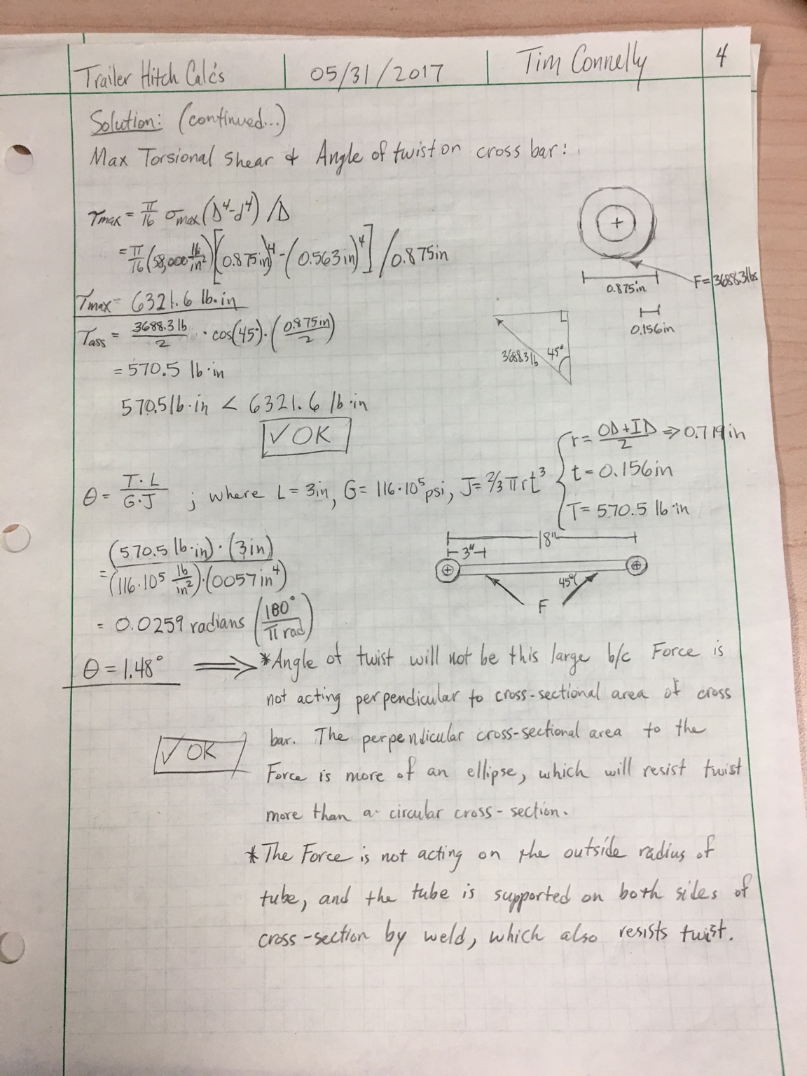

  28. Tim_with_a_T
    Posts: 1,816
    Tim_with_a_T

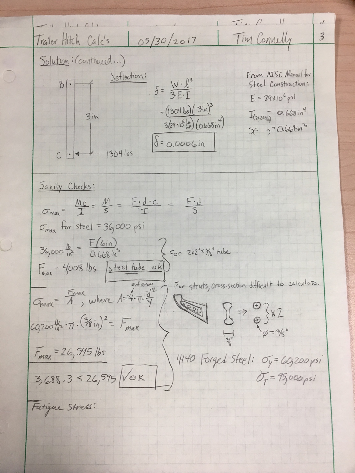

    Trailer Hitch Design: Part Two
    If you thought Part One's math was bad, you probably won't like this.... It's still very straightforward, though. Let's get started. The page below is the hand copy of calculations from the other day. As I said, my initial calc's were some form of hieroglyphics on illegible paper that got tossed, so I re-did them. You can see the applied Force, and the Deflection of the tube with no strut support.
    These next two pages show the same thing found two different ways. If you picture a side view of the trailer hitch, you end up with a basic picture as shown below. Dimensions are approximate but within reason. These calculations are what you learn in a beginner's engineering cl*** called Statics - in other words, every problem you tackle in that cl*** is ***umed to be in static equilibrium until proven otherwise.
    What I calculated is what's called reaction forces. If the trailer is pushing on the bottom of the tube, what's happening at the top of the tube and in the strut to keep the trailer hitch ***embly from moving? (or in other words, to keep things in "static equilibrium")
    This first method of finding the reaction forces is called the Three Force Principle. Basically you draw your known forces and angles to scale, then draw a triangle with the known forces and angles and calculate the rest. In this case, I knew some dimensions, some angles, and the 1304 lbs we calculated from the other day. I then broke the Force at point A into x and y components, which comes into play a couple pages later.
    This next page shows how you can find the same thing as above using "moments". Moments are weird. They are described like so: "the sum of the moments about point A is..." Their units have force AND dimension (i.e. foot pounds, like torque)
    The easiest way for a car guy to wrap his head around these next few topics, including moments, is the example of using a breaker bar to free some frozen bolts. You already tried to use your small ratchet and that didn't work... Your ratchet handle is, say 12" long. You gave it everything you had and the bolts didn't budge. You applied a "moment about the bolt", but it didn't move, so it remained in "static equilibrium". So, you get out your 36" breaker bar. You give it everything you've got again and the bolt starts to spin. In this case, your "moment about the bolt" overcame the forces keeping it in "static equilibrium", now making the bolt "dynamic" by the torque, or "moment", you've applied. Now, we're car guys, and we know that bolt isn't just gonna back out like that, so here's a more realistic example... Your 12" ratchet didn't work, so you break out the 36" breaker bar, eat a bowl of Wheaties, put on the Rocky soundtrack, lay hands on that thing and... SNAP!!! the bolt breaks off. In this case, the "moment" you applied, or torque, was greater than the shear strength of that bolt. The obvious reason being you have 3x the leverage with a 36" breaker that you have with a 12" ratchet.
    Ok, I think that kinda explains moments... One thing you always want to do with moments is check your work at the end. If the sum, or total, of your forces doesn't equal zero at each point, you've got problems...
    Now that we have some numbers to work with, we can break the trailer hitch into components. Each component can be ****yzed for strength and suitability based on the forces calculated. First up is the 2" x 2" x 3/16" steel tube beam deflection, this time braced halfway down. The other numbers you see here are various properties of steel, which are usually in the back of your textbook. They are also online if you ever need to look something up.
    After the deflection calculation, I moved to another moment calculation. In this one, I want to see what is the maximum moment that the drop tube can take and still be ok.
    All materials have two values for their strength, and these two values are "yield" and "ultimate".
    Anything less than or equal to the yield strength is considered to be in the "elastic region" - in other words, after the load is relaxed, the material will return to it's previous shape (like a rubber band).
    Anything greater than the yield strength but less than the ultimate strength will permanently deform the material.
    Anything greater than or equal to the ultimate strength will break the material.
    So with that in mind, we want to know what's the most load you can apply to the steel drop tube without it deforming or breaking. To do that, you look up the yield strength for steel in a table (eventually you have all these memorized and people think you're crazy), then calculate the maximum moment, and finally solve for the maximum force. Next, you compare the maximum force to the force you calculated. I calculated this without the strut present just to show the steel can take a whole lot of force before it will deform.
    Next, I took a look at the forged steel strut(s). Since the struts don't have a uniform cross-section, it is difficult to calculate their cross-sectional area, especially after I drilled holes in the webs of the brackets! In this case, the force is traveling perpendicular to the cross-section, so it's easy to calculate if you ***ume some things... What I did was measure the thick parts to the outside of the web, which were right at 3/8". Since there are 2 of these per strut bracket, and 2 strut brackets in total, I ****yzed the tensile/compressive force of 4 3/8" rods made of forged steel.
    I meant to calculate the fatigue stress of the struts, but I don't think I have a textbook anymore with the tables needed to calculate this. Fatigue stress will show you how many cycles your part can take before it fails. For example, if you had a connecting rod made of ___steel running at ___ rpm, which is in both tension and compression, you can calculate how long that connecting rod will last. Kinda neat. Usually they are in the trillions of cycles or greater before failure.
    Next, I looked at the 7/8" DOM 0.156" wall cross bar. I calculated torsional shear, which is exactly what happened to the frozen bolt example above: it sheared due to twist/torsion/torque.
    After that, I calculated the angle of twist on the cross bar due to the torsional force applied by the forged steel struts. This is NOT an accurate model/calculation of the angle of twist for a variety of reasons, some explained below. Basically, to calculate angle of twist, you have to ***ume a two-dimensional problem where you have a torque, or torsional force, going perpendicular to the cross section, which is not an accurate representation of my design. Nevertheless, the 1* of rotation is negligible, especially considering I suspect the actual angular rotation will be far less.
    The last few things I calculated are below. First up is the shear strength of the 1/4" x 2.25" steel plate that bolts underneath the leaf spring. For shear strength, the only thing different you do is use the ultimate strength of the material instead of the yield strength (because you want to know when it fails due to shear).
    After checking that out, I looked at the tensile and shear stresses of the fasteners, which were well within acceptable values.
    So, I hope that explains the design a little bit. Using a safety factor of 2 (a trailer double the weight I intend to build), the trailer hitch ***embly is in static equilibrium, and each component in the ***embly is strong enough for the forces applied on the component.

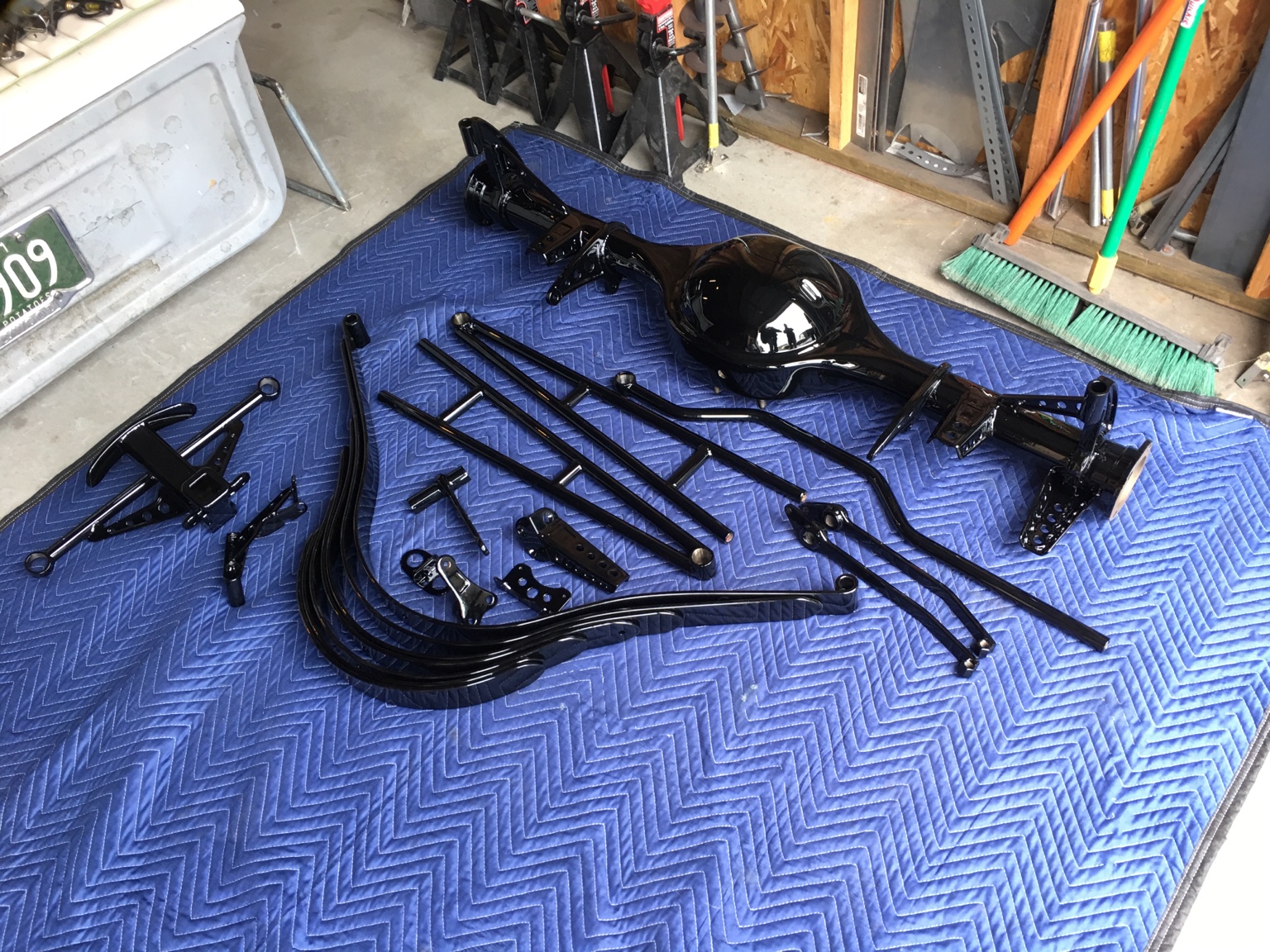

  30. Tim_with_a_T
    Posts: 1,816
    Tim_with_a_T

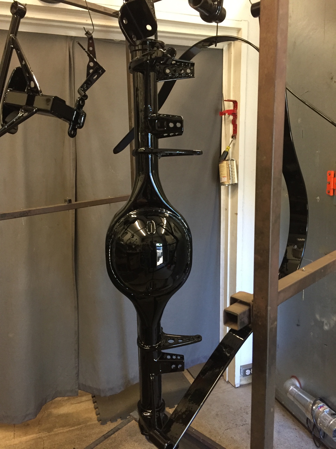

    Since you had to sit through that, here is a pic of the powdercoated parts I picked up Saturday morning. I also got the frame over to the welder. I have moved onto the body, figuring I could tackle the windshield/windshield posts this weekend. Well, that's gonna take awhile because the windshield posts are fairly intricate and I don't have the best tools to mitre the joints for the windshield frame. I'll figure it out, though!
    slv63, patmanta, loudbang and 3 others like this.
