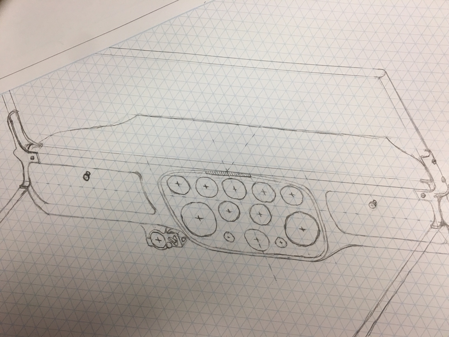

    Dash sketch...not the best but gets the point across...

    Have you been spending time in a Cessna lately?

    Are you really going to have 2 "Jockey Boxes" ?
    porkshop, loudbang and Tim_with_a_T like this.

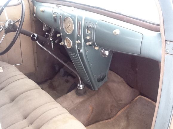

    Yes, 2 boxes since there is minimal room elsewhere. Originally I wanted to shrink down a Lincoln Zephyr dash, or at least mimic one, but I don't have the real estate down by my feet to do that. So this is kind of a rough draft concept.

    Tim, I've been watching this thread since the beginning. and have always had nothing to say till the triangle graph paper in that sketch, made me think my brain had malfunctioned.....Lol.... Keep up the great build...

    Keep posting the "mind-numbing" tech. I *LIKE* it, as it's a very nice break from a lot of mindless threads here. Nice dash idea, btw. Same on your build - including it's proportions.

    I, too, have really enjoyed your thread. I like that 3D paper, too. Never seen that before.

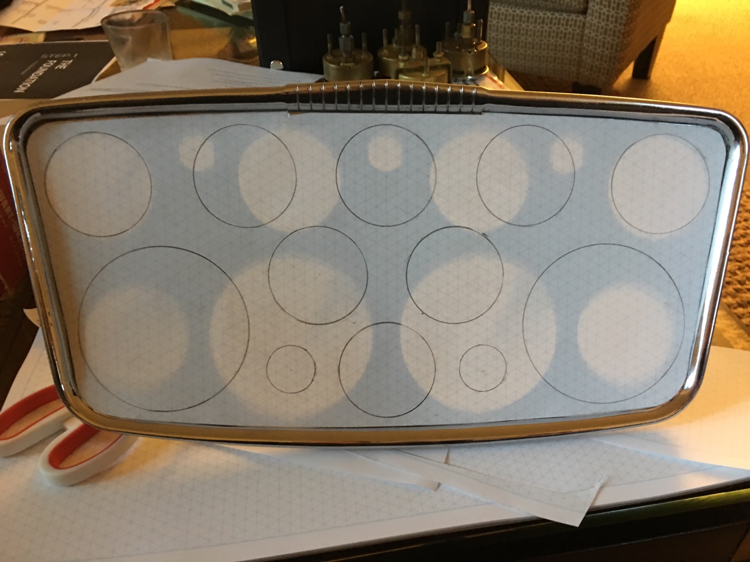

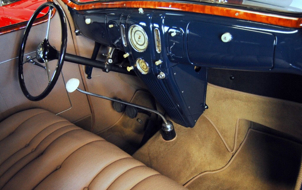

    It's called isometric paper if you want to go hunting. Each line is one unit in x,y,z coordinates, so it is a little easier to bring a 3D object into proportion from an isometric view. That didn't really work for the dash sketch, though lol.

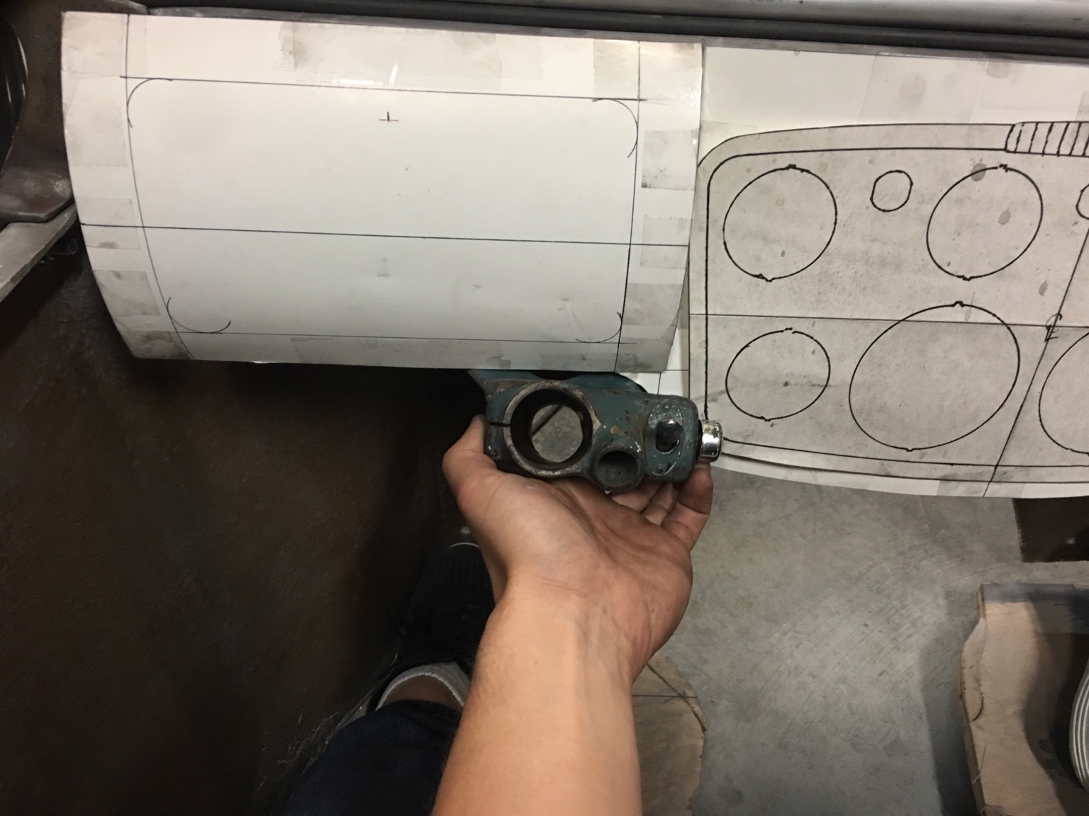

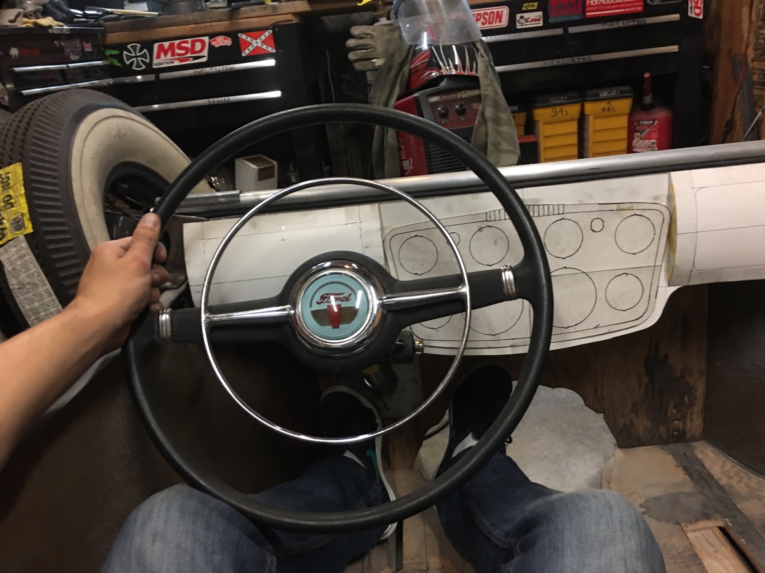

    I got brave and hacked out my existing dash earlier today, then after I couldn't sleep tonight, came out to make a cardboard template. It's not exactly what I want yet, but it's better than the sketch. The glove boxes need to be a bit smaller or moved outboard or both. I envisioned the center part to "waterfall" into the instrument cluster, which I'm not sure how to do yet. The glove boxes need to be filleted to blend in with the rest of the dash. Also, I may need to adjust the instrument panel height as my rev. B steering wheel blocks some of the gauges.... which I may have to live with. Getting there, though.
    @upspirate - you're finally gonna see that speedometer getting put to use! Keeping that part of the build under wraps has been difficult to say the least. I can't wait until I'm far enough along to show that portion of this build. Anyway, photos...

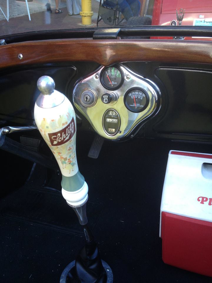

    Also, I saw this on a thread of LARS.... isn't it *****in? Whoever built this- I love it!
    brad2v, loudbang, cretin and 6 others like this.

    Yup,me too on liking that little flathead V8 T on the trailer,awsome rod !!,
    Like any rod I see though,I see things I'd do my way,like paint shiny,but looks like its on the way to that,an I really hate ever seeing cowel steering on any street driven hotrod=they nearly are always layed out bad as that one is. So better just to engineer steering right to start with,with as littler bump as canbe.
    Loven your dash ideas!

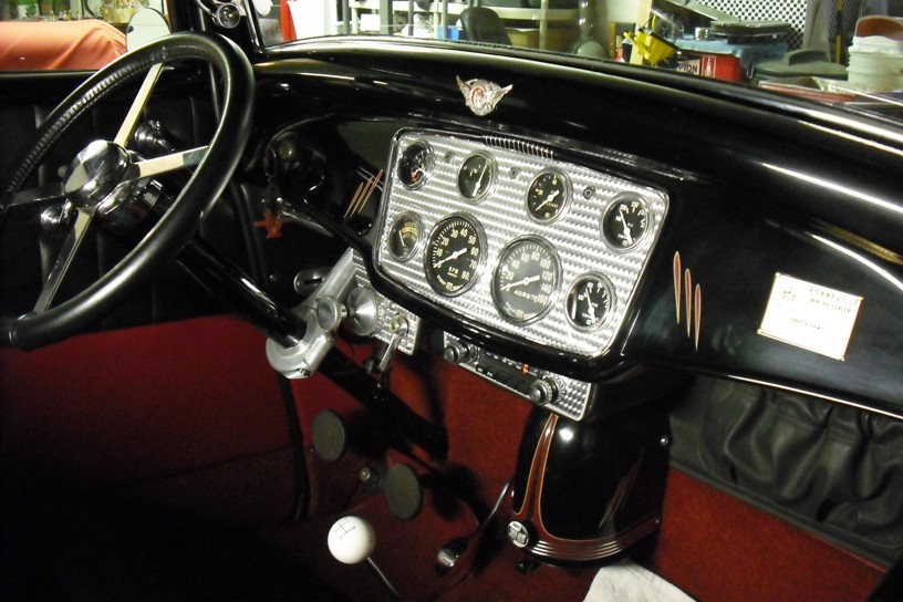

    Tim, looks like your Hollywood Panel is laid out the same as mine.
    You'r car is coming along nicely, great work!
    Mick

    So many gages,Wow!,only rich guys could fill all those holes up. I was lucky just to add a tach latter on,too my oil n temp. LOL Actully love all those dashs.

    Thanks, Mick! Your Hollywood panel looks great! I think Stewart Warner gauges and panels are the business! It's one of my favorite things to see on a car.

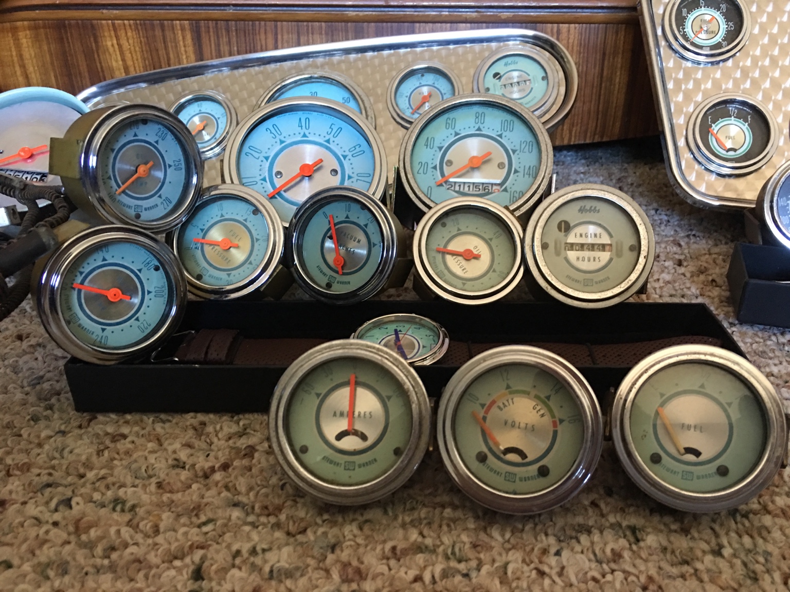

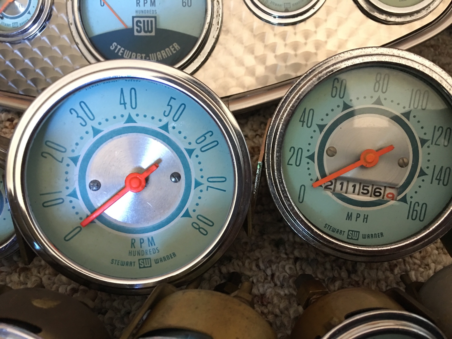

    Dana, your dash looks great. I also love the wood rail you made. As for being rich, I am far from it! I have a decent job that pays for my car hobby, but my apartment is comparable to living standards in a 3rd world country LOL. Someday I hope that will change.... Ha!
    The gauges can be expensive for sure, but the way I have been able to afford them is patience. It has taken me 10 years to complete my set of Greenlines, which I was going to use for this project, until I found out they are kind of a later '60s thing. So, they are staged for the next build. Notice the Manifold Pressure one? The next build is not gonna be a cheap one, but it will be a fun one!
    After I found out about the timeline of my gauges, I got ahold of some literature to help guide me.
    That 1964 book has Greenlines, but I think that was their first year introduced. It also has Twin Blues, and I later learned they were made 1958-1966. So I began searching for them a few years ago. I finally got a panel of 3 little ones and fell in love. They are pretty rare to come up for sale, so every day I searched the cl***ifieds here, local Craigslist, and eBay. EVERY DAY A FEW TIMES A DAY. I got to the point where I figured the only way I would get a speedometer that wasn't out of a boat was to clone one, so I started figuring out how I would go about that. This was a really faded Deluxe series speedometer, so I sanded the display off, and used a modified reproduction Wings needle to mimic the Twin Blue.
    Then @upspirate (Warren) was kind enough to trade me his speedometer out of his pickup for a Greenline plus some cash. Without that deal, I would still be on the hunt for one. Thanks, Warren!
    I eventually got a whole set of them, too. Enough so, that they won't all fit in a Hollywood panel. I figured I would run some in the firewall or something, then I stumbled across a pic on here of this 10 gauge panel Stewart Warner made.

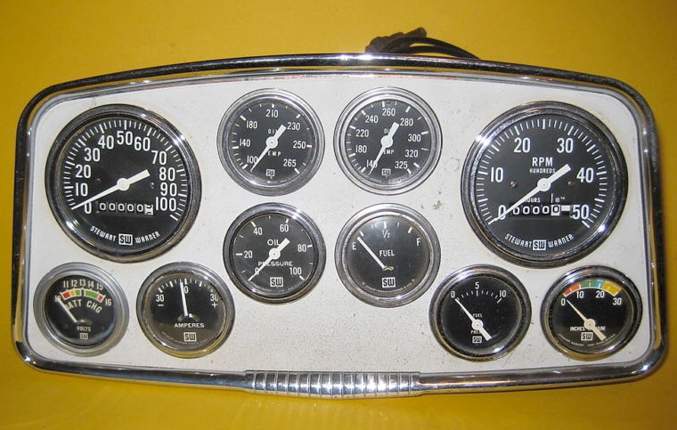

    I don't really like the layout, but I kept looking at it thinking it was really close to a Hollywood panel. So I dragged out my trusty engineering paper and started drawing circles. Sure enough, it's a Hollywood panel they drilled differently from the factory. I decided maybe I could mimic one, but change the layout to something I liked a little better. My girlfriend Kim helped me with that, and I'm pretty excited for this!
    Haneline reproduces the Hollywood panel, so I called them on Friday to see if I can order one blank. He wasn't in the office, but I think we'll be able to iron something out next week!

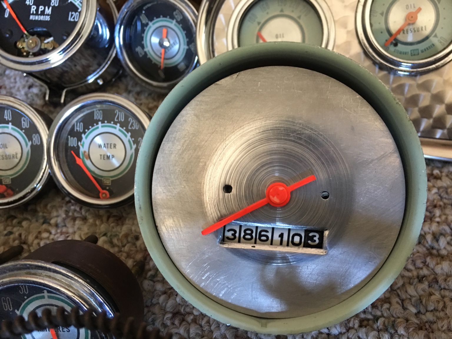

    Yes. Initially I had an electric water temp, then I eventually got ahold of a mechanical water temp with the sender cut off, figuring I can repair it. Very recently I found a mechanical water temp with the capillary tube still intact. On my Greenline, the water temp is sensitive enough that if you hold the bulb in the palm of your hand, the needle will move from room temperature to palm temperature, and it is dead on in boiling water. I was pleasantly surprised to find this Twin Blue is the same way!
    Another recent find is a mechanical oil temp. I had an electric one, then found a better electric one, then a mechanical oil temp came up on eBay along with another gauge in a set. I figured it was my only chance to get one, so I bid accordingly. It wasn't cheap, but now I can unload the spares. That's how I do it. One at a time or in small sets, then when I get enough for a 3 gauge panel or 5 gauge panel, I unload the spares. In a way it equals out and sometimes they pay for themselves.
    When the time comes, I will cover pulling apart, cleaning, color matching, and small repairs. My way is barbaric, but it works.
