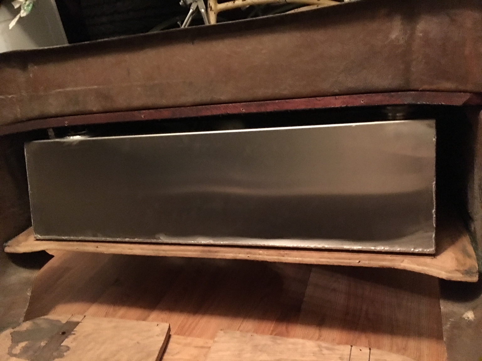

    More exciting news on the belly ****on home-front : my fuel tank is done, courtesy of @Kiwi Tinbender . It fits better than the cardboard template I made for him to copy, and should hold fuel slightly better too!

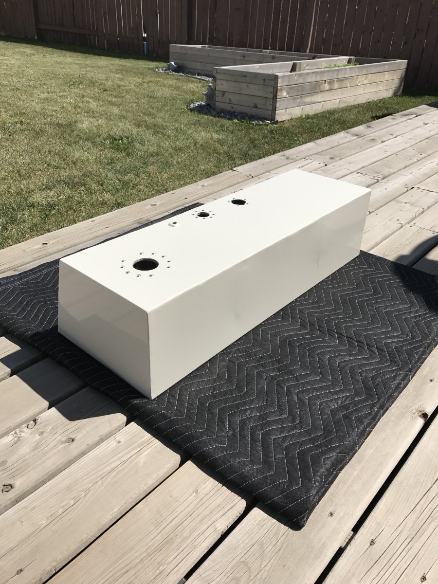

    The tank looks similar in shape to the one I built for my RPU.
    Hopefully it was pressure tested.
    You should probably pressure test it again if you decide to pretty up the welds before you finish it.

    Pressure test is on the to do list! I'm not sure how I will finish the tank out yet- it's gonna get banged up from me throwing my skateboard back there and what not so I may take a minimalist approach on this. Your tank came out great!

    I would not mess with the welds at all. If they hold pressure the. You are good. I made my own as well and pressure tested it a lot before all the pinholes were gone. I’m guessing the welder also did this before you got it back. Just call him.

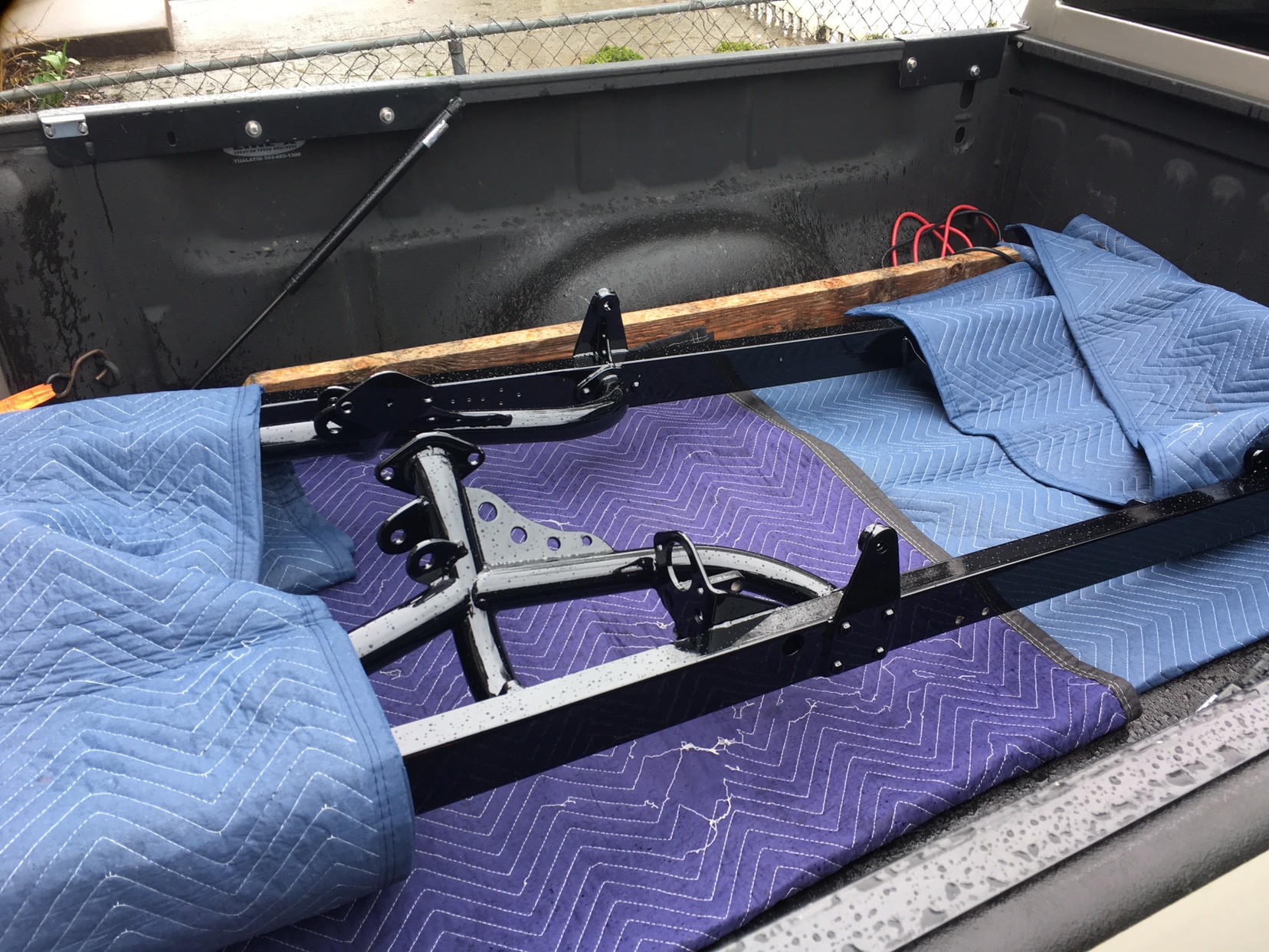

    Somewhat exciting news: the frame went off to powdercoat a couple days ago. I had already spent some time getting things smoothed over before being welded, but one major thing I saw was the manufacturing weld seam on the tubing - on my frame, one rail has the seam inside (not too worried about that), and the other on the outside.
    I wasn't sure how much of that would show through on powdercoat, so when I had the trailer hitch bracket coated, I didn't spend much time on that tube weld seam. It is visible through powdercoat, but it is not noticeable to the touch.... perhaps because my fingers are permanently damaged from sanding too much already, but I suppose that's an entirely different issue.
    Anyway, I spent some time blocking that exposed seam frame rail and kinda left everything else alone, other than a quick scuff on the tops of the frame back to the firewall and down the good frame rail to make sure there wasn't anything major. Powdercoat guy is going to blast it first anyway. By the way, even though my new-to-me garage is still a complete disaster, it is so much better than renting a storage unit! Mandatory pictures:
    Admiring the welds.... they really impress me with their work every single time.

    Gah! Sorry for the delay! I have no real update- I picked up the frame from powdercoat and got it home. Overall I am happy with the results, but it is not on the same level of Russel's work. I dropped the engine off at the machine shop and reviewed the plan, or lack there of haha. So hopefully I can get going on ***embling the rolling ch***is and work on finishing the engine and trans in the next few months.

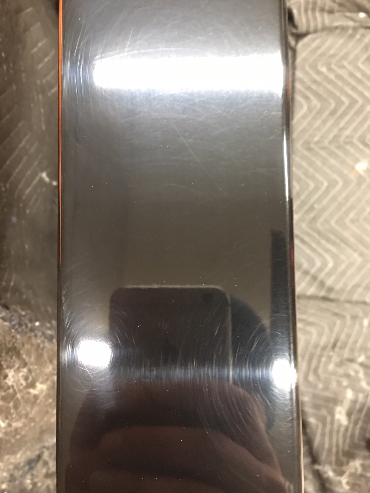

    I'll be hopping down the rabbit hole with the pre-determined understanding that I'm not gonna spend a lot of time on it. Just a quick cut and buff, then live with it. There's too much orange peel to let it go as-is. Had I not been spoiled by Russel's work prior to this, I wouldn't think anything of it as most powdercoat I've seen has a certain level of orange peel to it...... but Russel's stuff is top, top notch, and bolting that to something noticeably less than that bothers me enough to try the wet sand/cut/buff approach. Within reason. Famous last words.... LOL

    Tim, please start with a SMALL section of the top of the frame (where the body sits) to try working it out.
    I once tried to C&B a small, easy part once that was coated in Imron (many years ago). Paint was 6 months old.
    Clogged sandpaper, nasty scratches and soreness was the best I could do...
    The thing ended up being blasted and reshot!
    Tim_with_a_T likes this.

    I'm going slow. I think you can see what I'm talking about in this picture:
    Here is at the back after some tinkering - it's hard to capture the finish - still some orange peel but much better and a much more depth/clarity. I wet sanded with a block and soapy water with 1200 and 2000, then machine buffed with Meguiar's #1, switched pads, #2, switched pads, #3, then hand rubbed their #6 cleaner wax. This is roughly about what Russel's work looks like now. I think I'll move forward and do one frame rail side tonight, then see if I can do the top from the firewall forward and the opposite frame side tomorrow. It's not too nerve racking as the coating appears to be thick enough to not burn through. Easy does it!
    ^^^ those nicks are grinder marks btw. Everything is amplified with powdercoat lol. Can't hide anything!

    That's an improvement that appears to be worth the effort!

    You guys might not know this, but just looking at black scratches the $#!+ !!! out of it lol. But we are getting somewhere!
