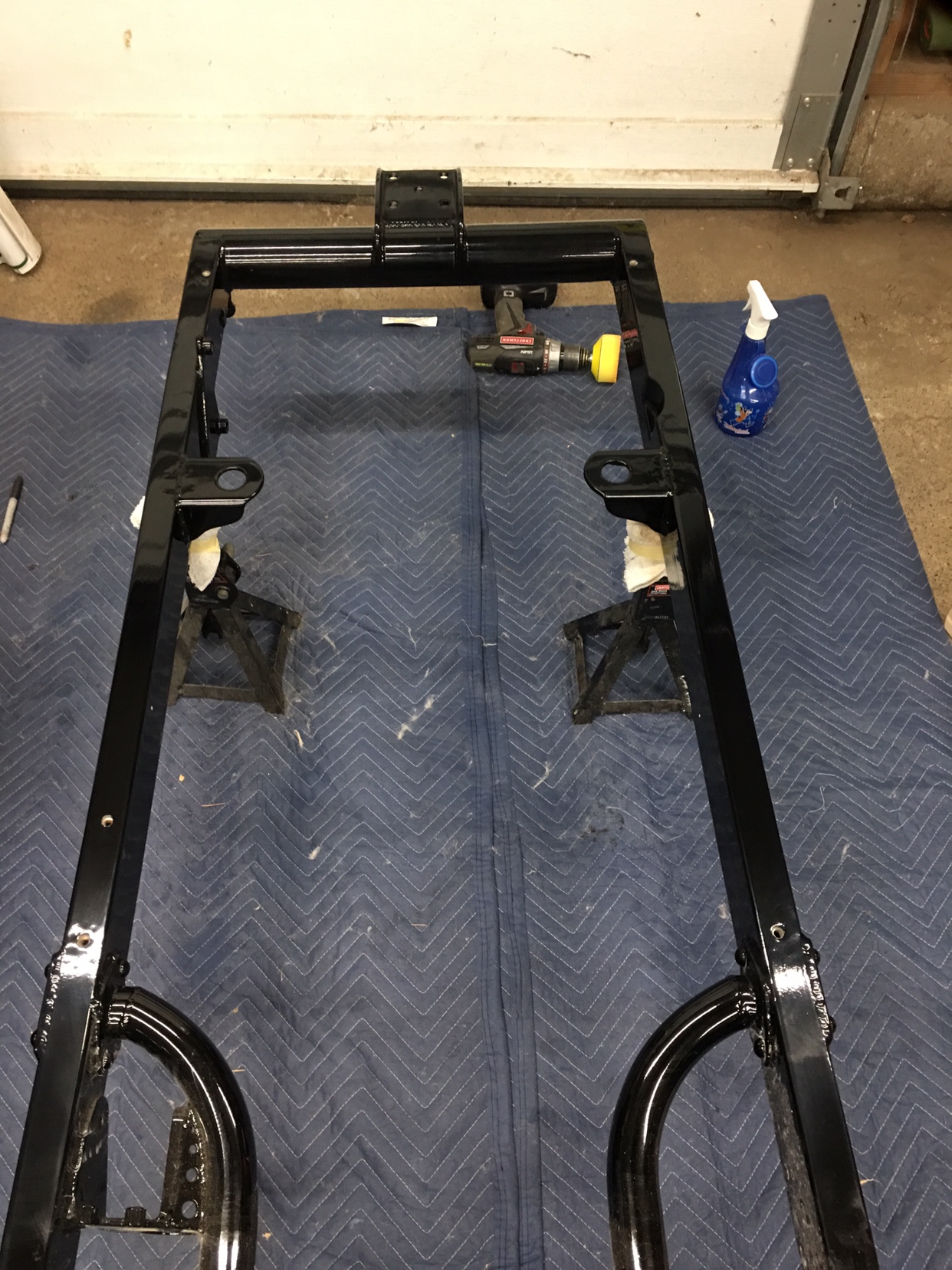

    Before and after. Got one frame rail done. I spent more time blocking the frame rails - the gussets in the kicking is where I started and didn't take those down really far. So far I'm happy with the effort.

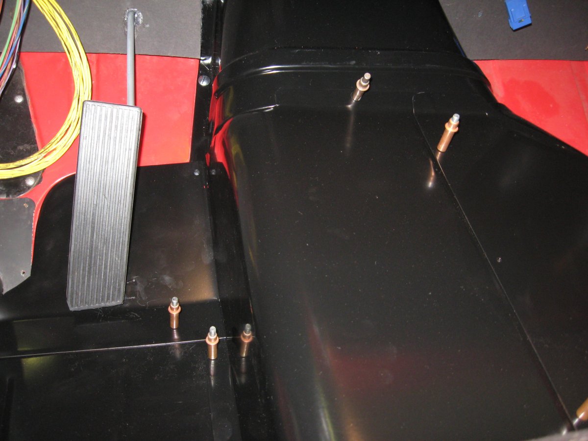

    Top and insides done from firewall forward- I only wet sanded the top.

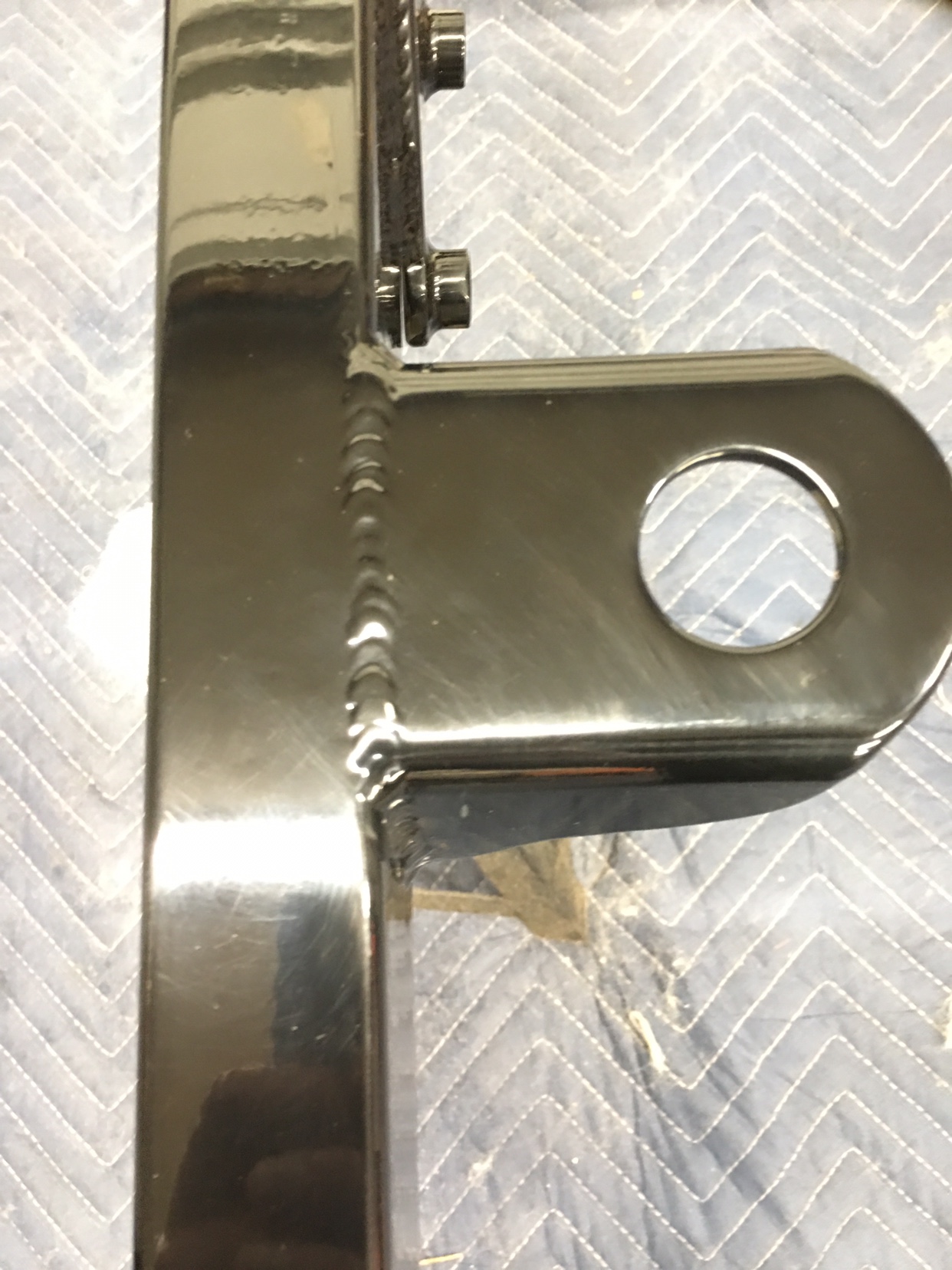

    I did some reading on the links above, and if I understand the generic wiki link correctly, my frame powder was either thinner or cured colder than what Russel does, which caused the orange peel. There are many other variables involved, but maybe a request could be made to have your frame (Doug) coated thick, with max curing temp/time? That should eliminate orange peel if I understand it correctly.
    The weather was wayyyyyy too nice to spend the remainder of the weekend wet sanding and buffing parts, so I'll get the rest of the frame done in a few days once my weekend starts!

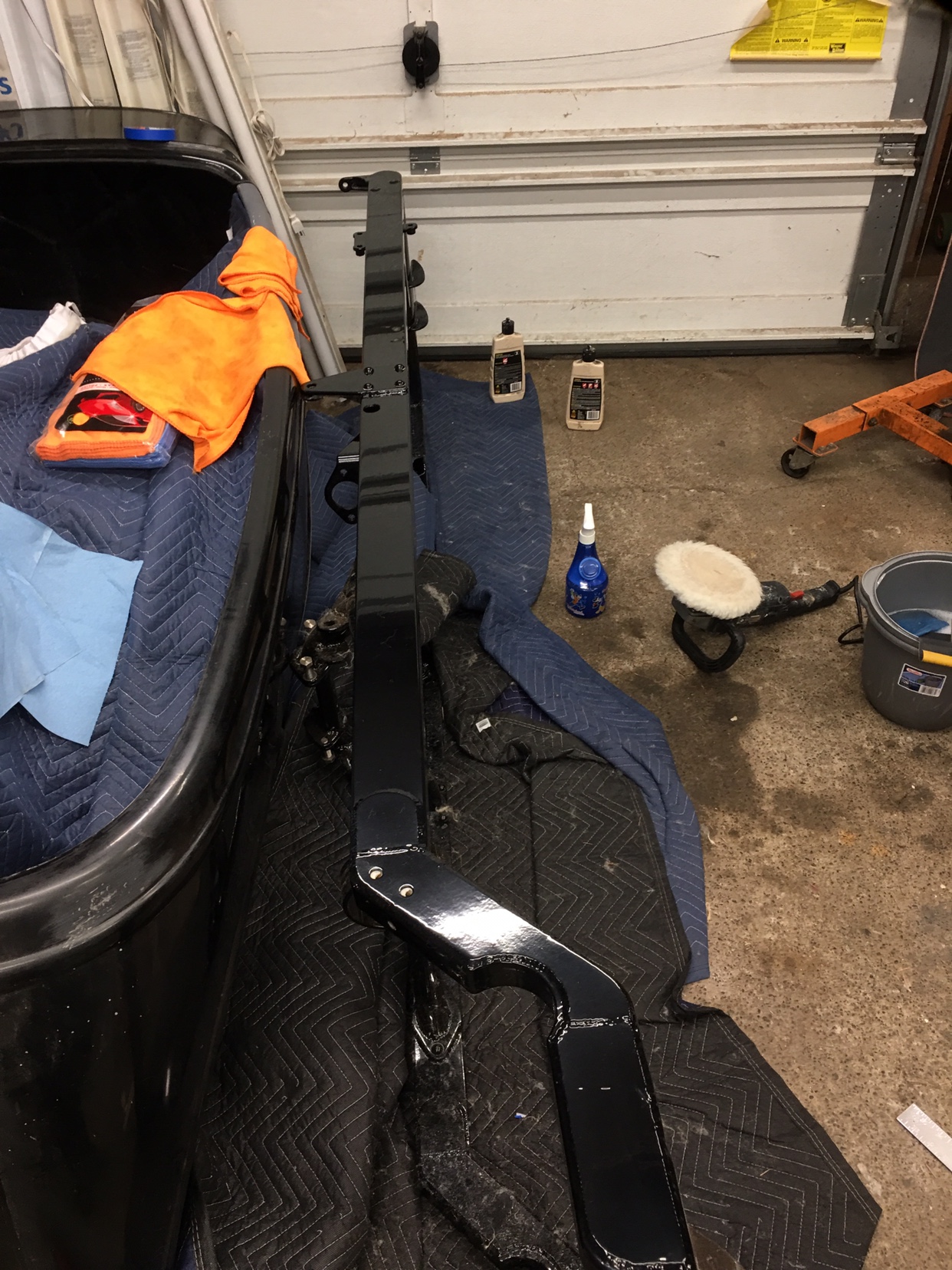

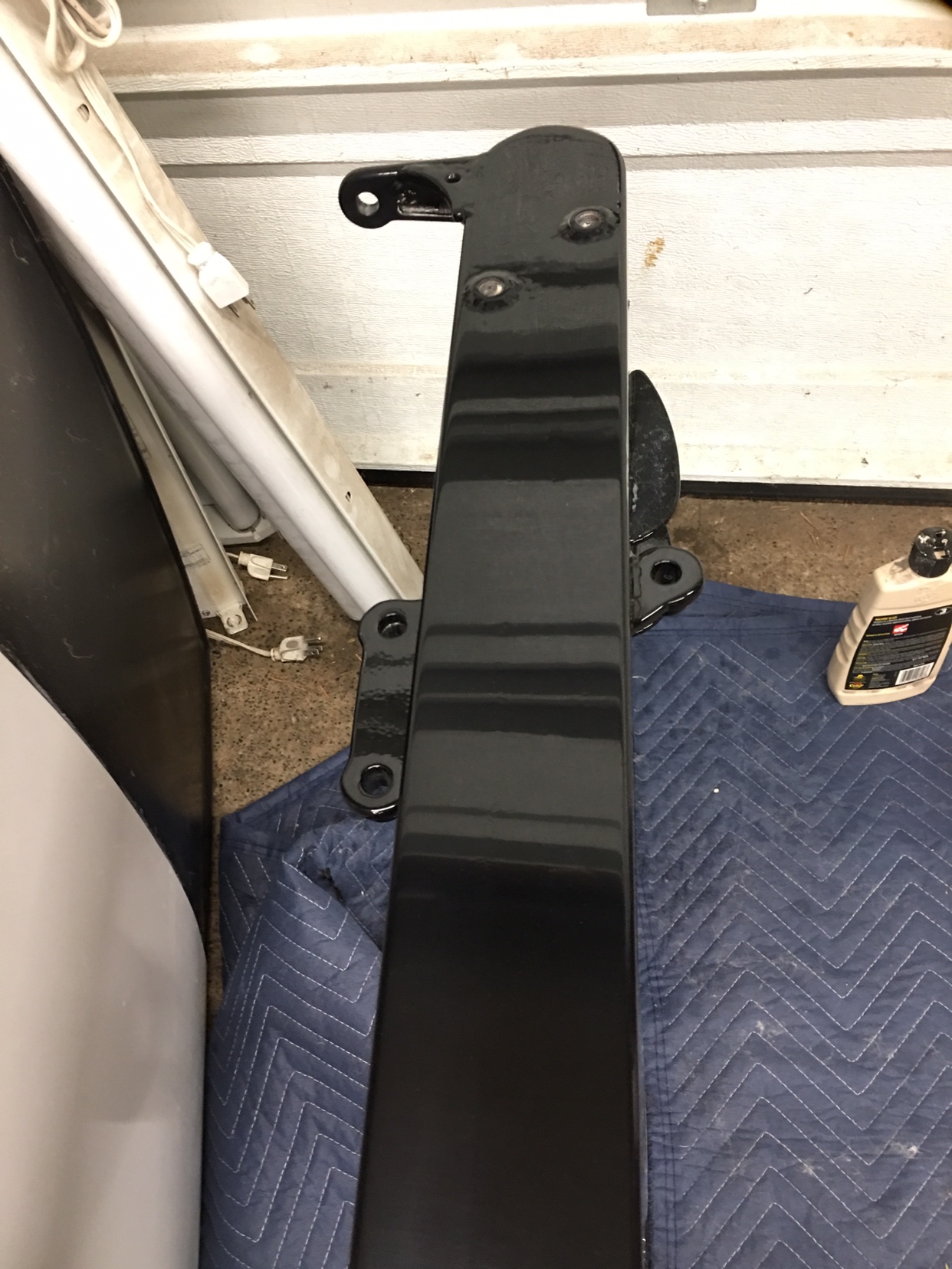

    Well, I have successfully made a giant mess, but I also got the last part of the frame wet sanded, cut and buffed. It came out really good. Gonna take the rest of the night off, and I will start cleaning and ***embly tomorrow morning.
    I'm missing the 3rd member to ***emble the rear suspension, and I'm sure several nuts and bolts I will want to change out, but it feels pretty nice to make progress like this!

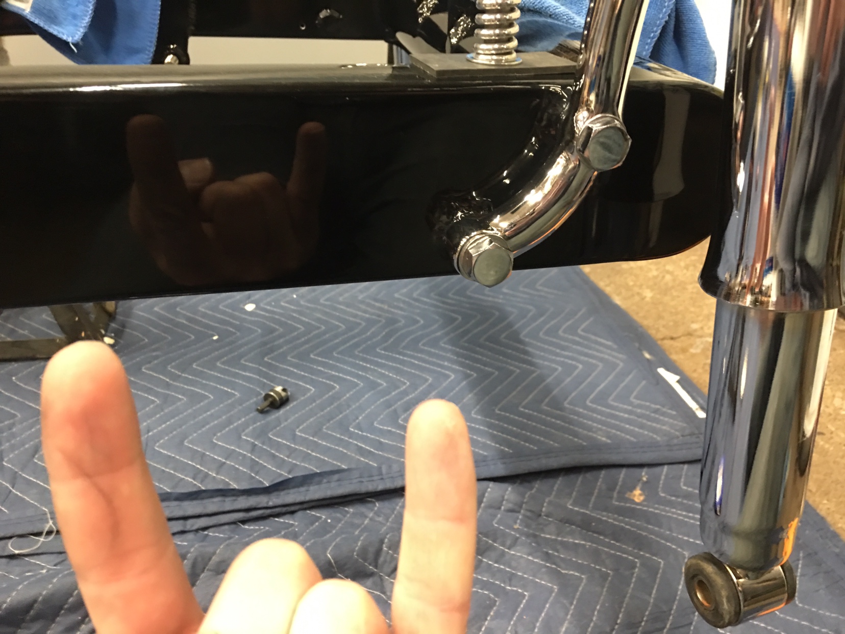

    This is taking longer than I thought LOL. But the results are beyond what I thought I could achieve.
