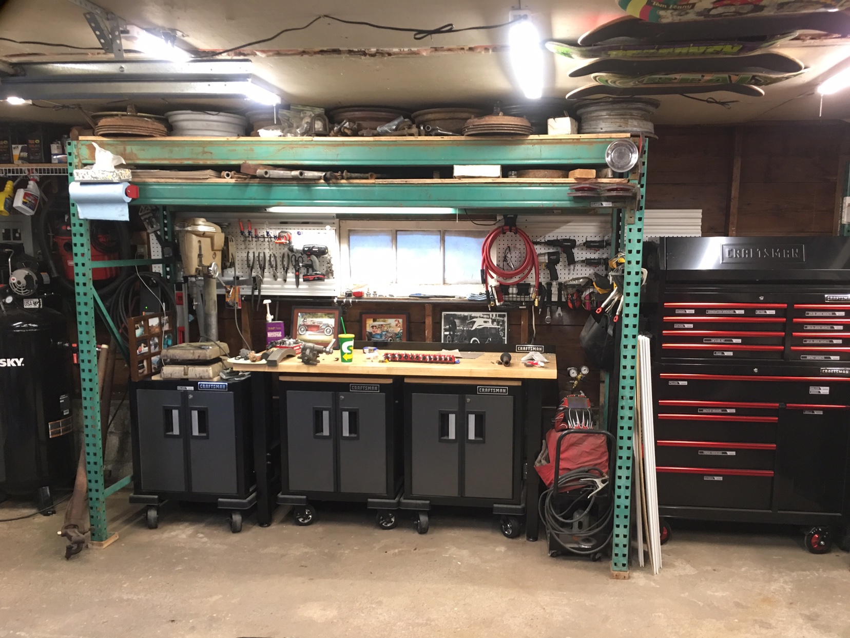

    Well I didn't get completely organized, but it is clean enough to get some work done at least.
    Here's some pics of the general layout. It's 18' x 18', so pretty small but bigger than I've had previously. There's also a glimpse of the '32 Vicky/Phaeton thing with all the fenders, running boards, hood and grill shell stuffed inside..... and of course the rails up on the shelf patiently waiting!

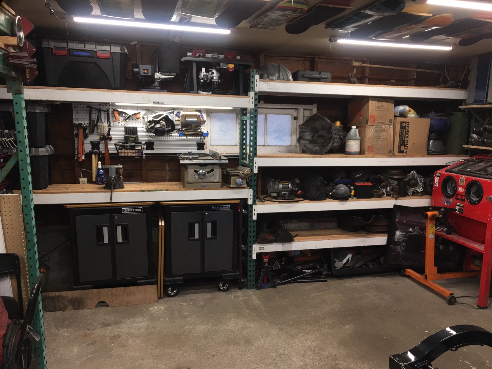

    Not to pick on you, just suggesting improvements to a sweet situation...

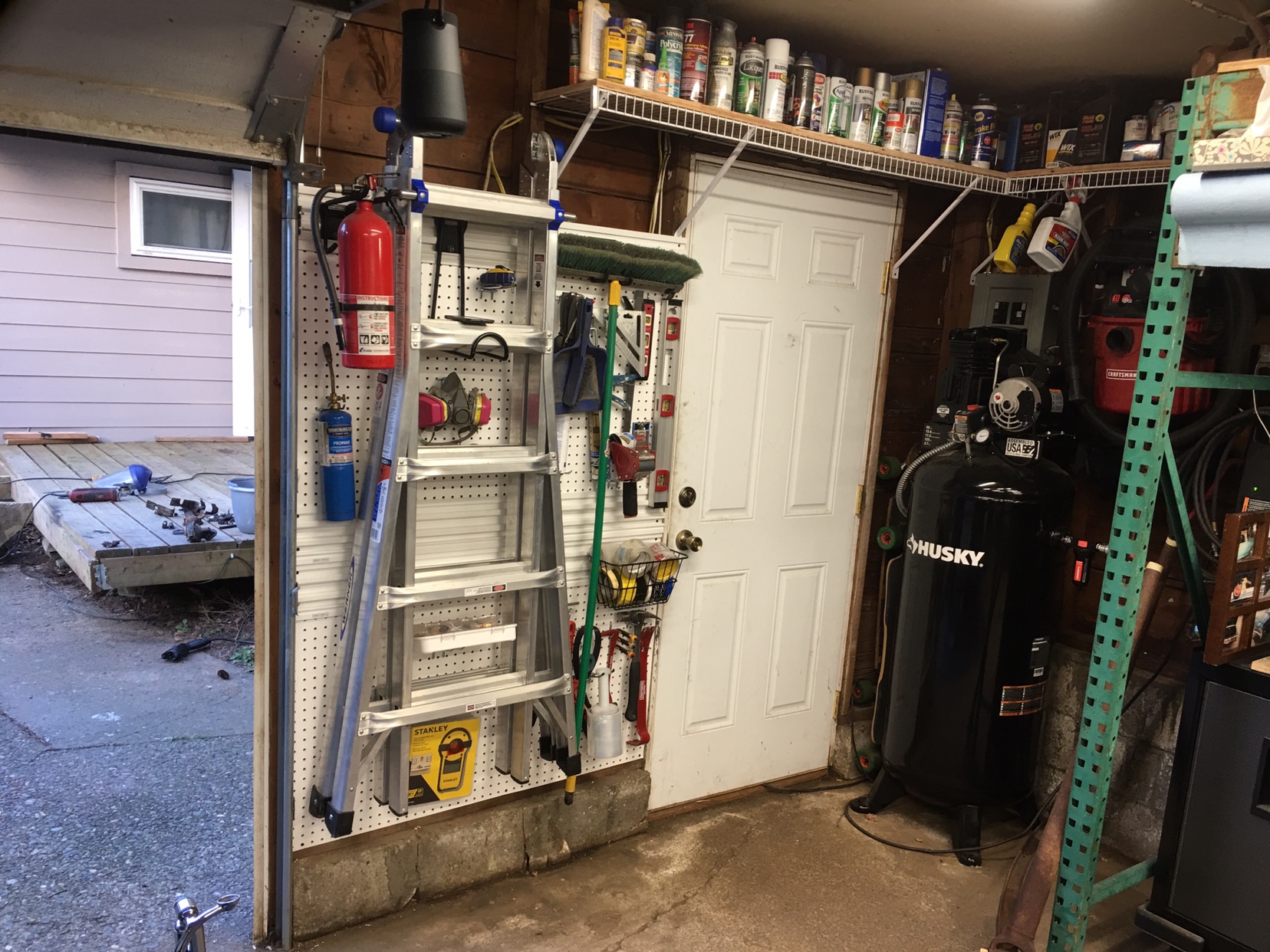

    Put all the spray cans in boxes. That way you can grab the box and look through all of them, without trying to grab just one off the shelf. Knocking a can off at that height WILL cause it to rupture and spray it's contents all over. Clear plastic for even better storage...
    If at all possible, build a small shed/lean-to outside the garage and tuck the air compressor in that.
    https://www.garagejournal.com/forum/showthread.php?t=178362
    extra points if there is enough room for the blaster too. They throw out so much dust inside...

    I hadn't thought of the spray cans in boxes..... that's a pretty good idea. I'll have to revisit that soon. Maybe milk crates will fit up there, who knows?
    I indeed plan to put the compressor behind the garage at some point.... I need to level out the ground back there and pour a small pad for it. I was planning to make the lean-to large enough for my yard tools as well. Part of me wants to eventually tear this garage down to build an apartment above garage (and rent out my house), but I would need to scoot the garage over to meet current setbacks, and likely take down a 100' + tall fir tree, none of which I'm sure about, so I didn't get all gun-ho pouring pads just yet.
    Since it rains 98% of the time here, I'll probably keep the blasting cabinet inside the garage. I have run piping around the perimeter with air connections every 4' or so, so my air is available on 3 sides of the garage. When I move the compressor, I will just tap into the piping on the opposite side of the garage when moving it out back. It was just very convenient to put the compressor right there as that's where the electrical sub-panel is located.
    Similar to the air supply being piped around the perimeter of the garage, I plan to do a similar vacuum supply. That way, when using a bench grinder or chop saw or blasting cabinet, I can just plug into that piping and turn on the shop vac... it even has a Bluetooth controller so I don't have to walk over there to switch it on LOL. I had started laying that out when I ran out of motivation for the time being..... partially because of the amount of time spent organizing and partially because I realized they wired the garage with wiring rated for 15 amps being fed by 20 amp breakers.... SO I get to re-do that soon as well (the vacuum piping will follow the air piping and electrical conduit, so I'll just tackle them together). The vacuum nearly eliminates the dust of the blasting cabinet, or at least it's done a good job so far.
    A few other organization projects include finishing my storage bins I made slide-out drawers for above the blasting cabinet, going through the 3 or 4 remaining cardboard boxes, and making a giant pile of stuff to sell off. THEN, I should have things under control for about 48 hours as @mountainman2 mentioned haha. Ch***is ***embly progress pictures should commence next weekend!

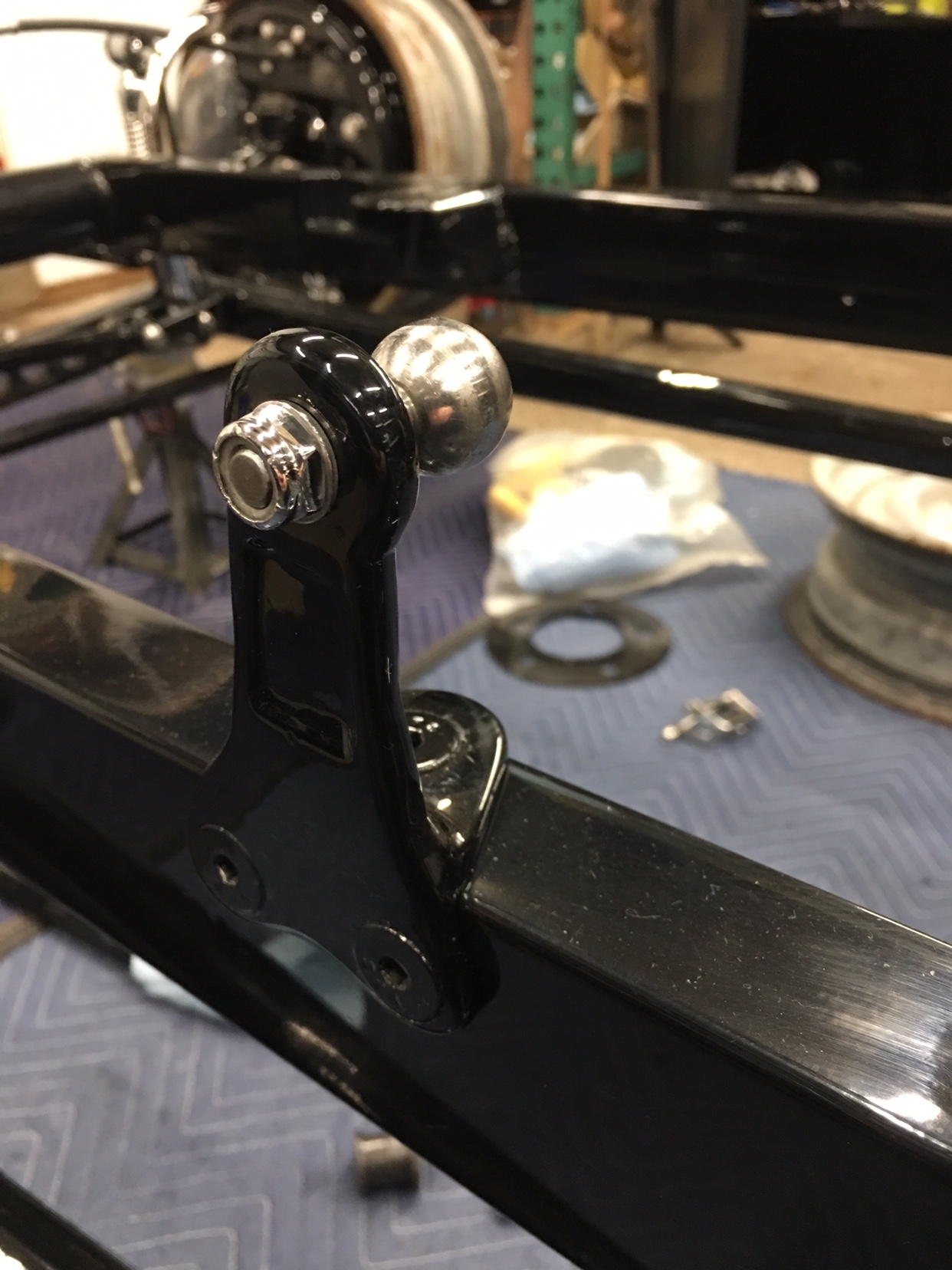

    Figured I would update because I said I would. It seems as though progress happens if I post, so I'll continue with my good luck charm. I got the front suspension completed, and I was able to mock up a couple ultra top secret changes while I was at it. So far so good.

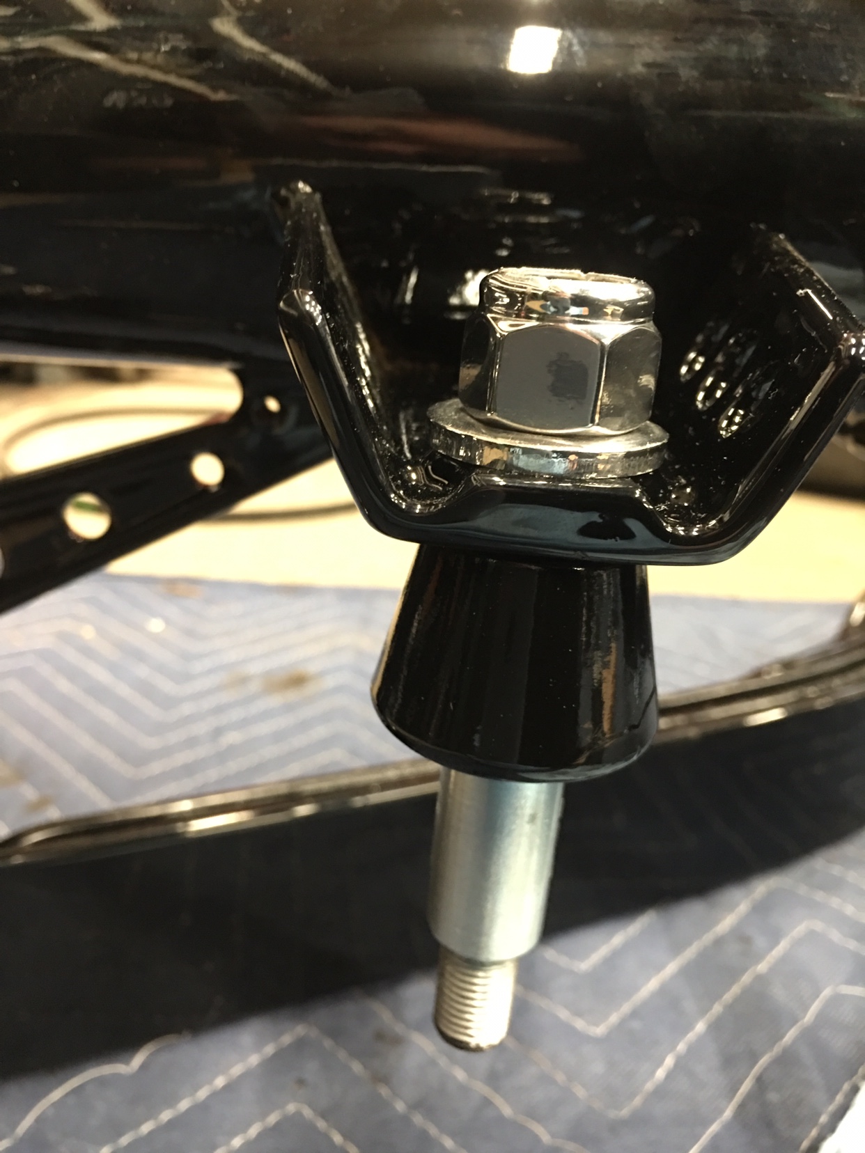

    I got the rear panhard bar bracket (frame side) bolted up, which I made to use flat head, counter-sunk cap screws. Well, when it was time to bolt up the clutch linkage cross shaft bracket (frame side), I realized I made that to use standard hex bolts.... I liked how the counter sunk cap screws blended in, so I drilled the freshly powdercoated cross shaft bracket for counter sunk cap screws to match the other bracket. That turned out surprisingly well, and I just painted the bare metal in the countersink appliance epoxy black with a model car paint brush, as well as sprayed the head and back side of the cap screws with the same paint.
    I also sanded most of the casting flash and pits off the master cylinder and painted it. I just rattle canned it with a few coats of primer, blocked it, a couple more coats of primer, blocked it again, and a couple coats of black appliance epoxy. Seems like that worked out pretty good. I need to do the steering box and pitman arm now, as well as a couple small pieces. I'm considering getting a paint gun for small parts, but I'm not sure really what I'm doing there. Seems like that would be better than rattle canning stuff, although rattle canning bolt heads and small stuff is quick and easy.
    Speaking of quick and easy, I started drilling some of the ARP stainless bolts for cotter pins...... Of course, by some of the bolts, I mean HALF of ONE.... and by quick and easy, I mean the OPPOSITE of that. Wow that ****ed. I broke 3 drill bits and 2 centering bits before I decided I was over it - those ARP fasteners are tough stuff LOL. I was unable to locate stover/metal lock nuts in stainless, so I am using nylocks. I gave the castle nuts a solid effort, but I am over it. I spent some time polishing the various stainless fasteners before coating them with ainti-seize and torquing them down. They look great on there, so I'm happy. If someone wants a great deal on some mock-up, small fortune, high strength castle nuts, let me know! Ha!

    I have completely underestimated the amount of time I would be spending polishing stainless steel bolt heads and nuts.... also, I completely forgot how much I love making gigantic messes and pretending to be a rac****. Progress has been slow, but I got the rear spring leaves all clamped down and married to the rear axle yesterday. That went well, and I remembered to slab some grease in between each leaf. I've probably changed my gloves about 40 times in the last 24 hours....

    Regarding the Nyloc nuts:
    I'm sure you know this but ideally there should be one full thread showing past the nylon.
    I'm a bit fussy myself on keeping the extra threads to a minimum for looks and they don't lend any more mechanical advantage.
    It's a pain hand selecting nuts, bolts, washers, etc. but having access to a lathe helps when the "stackup" of certain parts won't allow it.
    Just be sure to leave a radius under bolt heads if it's the only way to gain a thread or two especially on critical parts (suspension, brakes).

    You're right- I think I need to get some thinner washers to gain some more thread exposure - I apparently grabbed "thick" washers the other day, and between the powdercoated surface and the difference in thickness of the mock-up hardware, I am lacking in thread length! I was just at Parkrose hardware browsing.... unfortunately, the Vancouver store a couple miles from my house doesn't have near the selection of the one off Sandy in Portland. Guess I'll have to make a trip over there at some point!

    More polishing ensues.... I am about a half a bolt thread away from having the rear suspension back in. "Precision fit" is an understatement! This is attempt number 2 as I gave up and walked away from it the other day..... Draco the bearded dragon approves this message!

    The rear suspension is in finally- what a chore!
