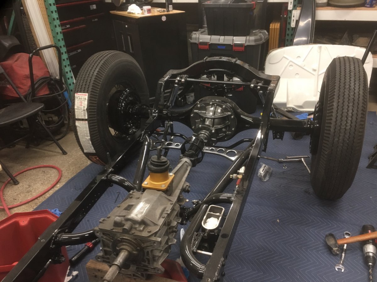

    Well, I went back through old posts - May 6th last year, I dropped this off to get powdercoated. There was some discussion about whether the pinion seal would disintegrate in the oven, so it was going to be pulled apart before coating. Well that never happened, so I went over there this weekend to pick it up. I had some flash rust to sand off, but since sanding is my favorite thing in the world, no big deal! I got it all slicked up yesterday with some 220grit, rattle canned about a can and a half of primer, let it sit overnight, scuffed it this morning with 400grit, gave it a bath, dried it off, and shot it with some cast iron color. I think it came out decent. I'll hopefully get the fasteners polished this weekend and perhaps.... there will be a rolling ch***is!

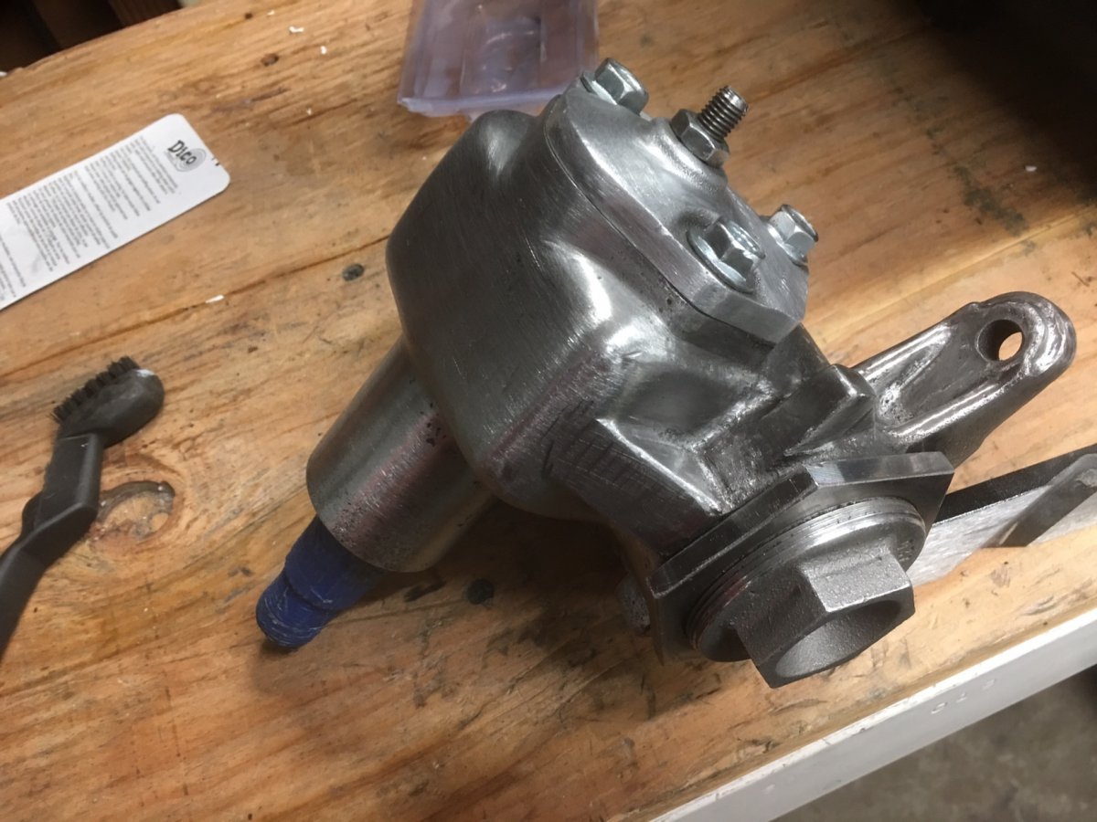

    Since I love sanding so much...

    Since I don’t love sanding so much you now know why there was no way I was going to do that to my steering box :D
    I cleaned it up really well and sprayed a nice coat of paint on it.

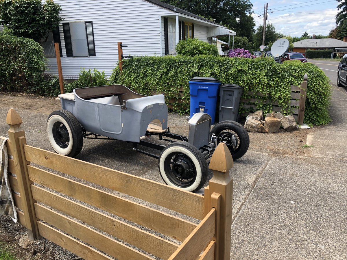

    Happy 4th of July everyone! Updates.... I wish I had some! I posted a little info on another thread, but I’m really tied up with my ultra low budget house remodel- the goal is to loosely put it back to the early 40s within reason. I have considered starting a thread on that in the antiquated section, but I’m not sure if it would be something people want to see... plus, I don’t have a lot of progress to show there yet. I really want to get back on the belly ****on this fall or winter, but for now I gotta take advantage of the sun while it’s out. Stay safe out there today!

    I had a m***ive post explaining a little about the house but my phone froze up when I tried to add images. Anyway, the abbreviated version- I did some digging at the local historical museum and found a picture of my house with a bad*** Chevy coupe parked in the yard.
    Then I was doing some literal digging in the yard and found an AC Delco starter tag. I looked up the number and it is most likely off that coupe. Made my day.
    Blah, blah, blah, you get the idea. The long story short is I have found some neat stuff on the history of the house, found some cool **** to put in it, and have many more leads to track down. I’m having a blast with it.

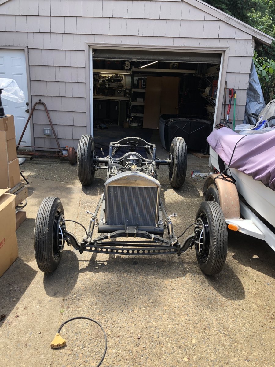

    About 12 months worth of dust on it despite being covered up lol. I almost forgot what it looked like haha.

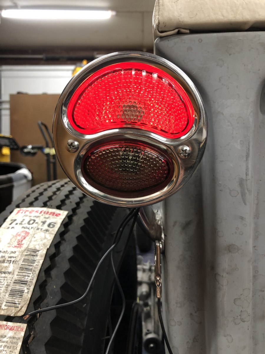

    Well it started ******* rain right in the middle of my “pocket planter” mortar project out in the yard, so I came into the complete mess that is now the garage to tinker on something. About a year ago I got this idea to Frankenstein some reproduction Model A taillight pieces to achieve a “modern bulb” configuration.
    I started with the Speedway Motors Model A taillight, dis***embled it, snagged some eBay LED Model A taillights with clear lenses and dis***embled them, then grabbed some LED retrofit bulbs and a pair of dual contact pigtails from the local auto parts store.
    The Speedway taillight ***embly has light sockets pressed into the rear of the housing, so I lightly tapped the upper one out for modification.
    The dual element LED bulb location pins are offset rather than straight across, so the socket needs some precision grinding.
    I re***embled the Speedway taillights with the retro-fit LED bulbs, new dual element socket, and eBay clear lenses. The results are pretty impressive in my opinion.
    Parking light:
    Brake and Parking lights (more obvious in person):
    Reverse bulb, Brake, and Parking bulbs:
    Now when I’m driving this teeny tiny car and go to back up or put on my turn signal, the modern day *****s behind the wheel should be able to see wtf I’m doing. I’m pretty pumped about this little project. Hopefully some small updates like this will trickle in here and there...

    Great Tim. What do they look like not lit up? Clear?
