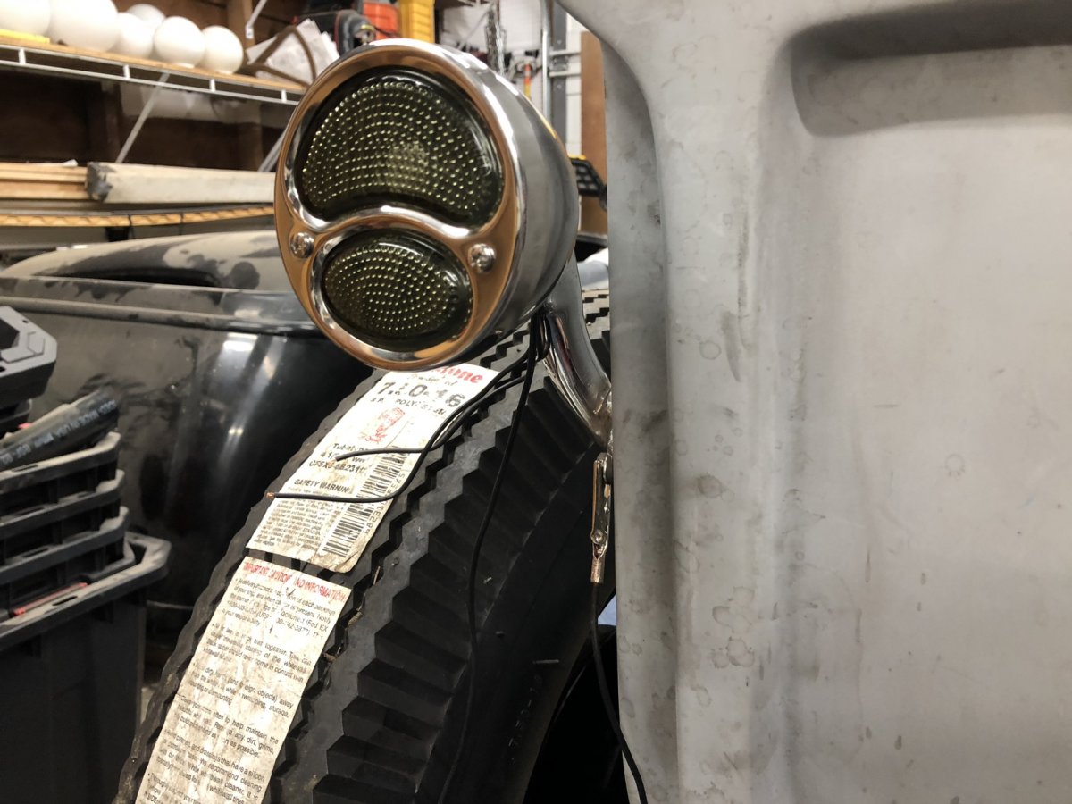

    Yes; like this. I will admit that clear lenses are not my favorite thing, but I will take them in a trade off to get reverse lights without having some afterthought bulbs hanging off the car somewhere (or not having reverse lights at all).
    I had considered possibly Frankensteining the lenses themselves and gluing up a red top/clear bottom, but the way the lenses are split with the gasket doesn’t line up with the way the housings are split with the divider of top/bottom bulbs. It could be done, but not without a lot of work. The way I have them now, the cast-off pieces will still make a complete taillight for someone to use.

    Hi Tim, job well done. Had you considered painting the inside of the top piece of the lens with a transparent red lens dye? We used to sell it in the speed shop where I used to work. It's a lot like nail polish.

    I hadn’t considered that because I didn’t know it existed! Do you have a link? I think for now I will leave it be to see if it grows on me, but the paint/dye is something I could do at anytime even once the car is done. Thanks for sharing!

    Is the lens gl*** or plastic? I suspect an old modeling technique would work in either case. What I learned, was when I wanted tinted windows for my model cars, to sand the *inside* of the "windshield/windows/backgl***" w/a fairly fine wet-or-dry sandpaper, (like say, 400-600 grit, wet, evenly, side to side, no swirls) & then lightly fog on whatever color you want, using "candy" colors. Different shades depended on number of coats. The sanded portion held the candy paint so you didn't get runs, + it gave a smoother, more even coverage, while the sanding scratches disappeared. + w/the color on the inside of the model, the paint didn't get scratched away when handled. I'd guess that gl***-beads would work on gl*** lenses. FWIW. Marcus...

    Sorry Tim, I don't have a link. I'm going back 30 odd years now. The dye was used to repair faded lenses, we used to have it in amber and red colors.

    Never even thought I’d the lower half as a back up light. Very clever. I do feel like I’ve seen lenses that have the bottom clear and top red since your talking about that idea
    if I find them before you I’ll share the info :)

    I like them. I'd just put red bulbs in them.

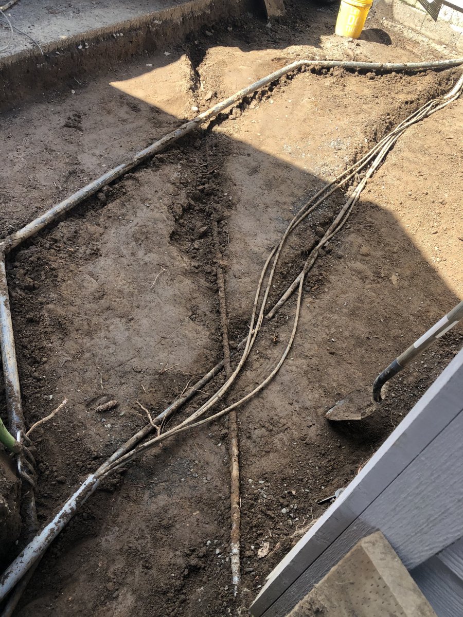

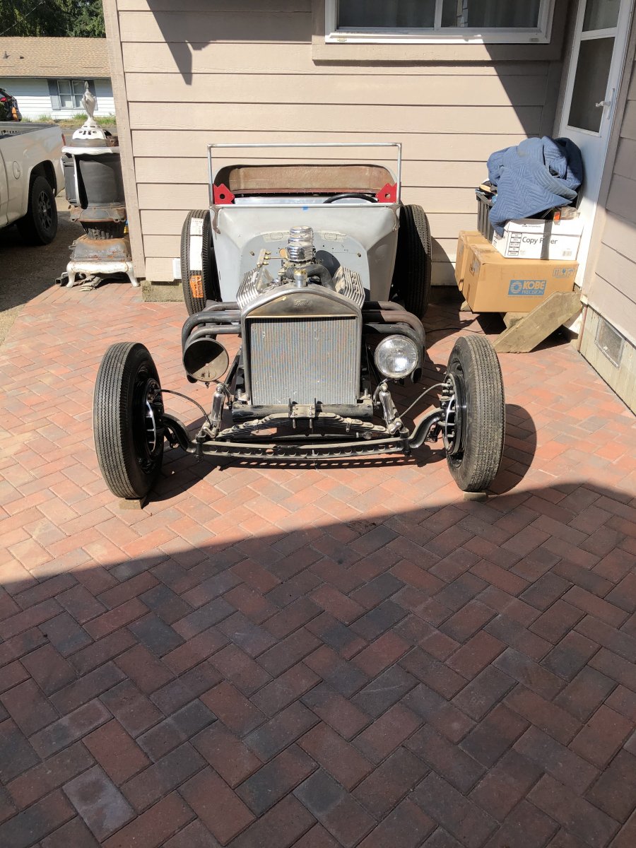

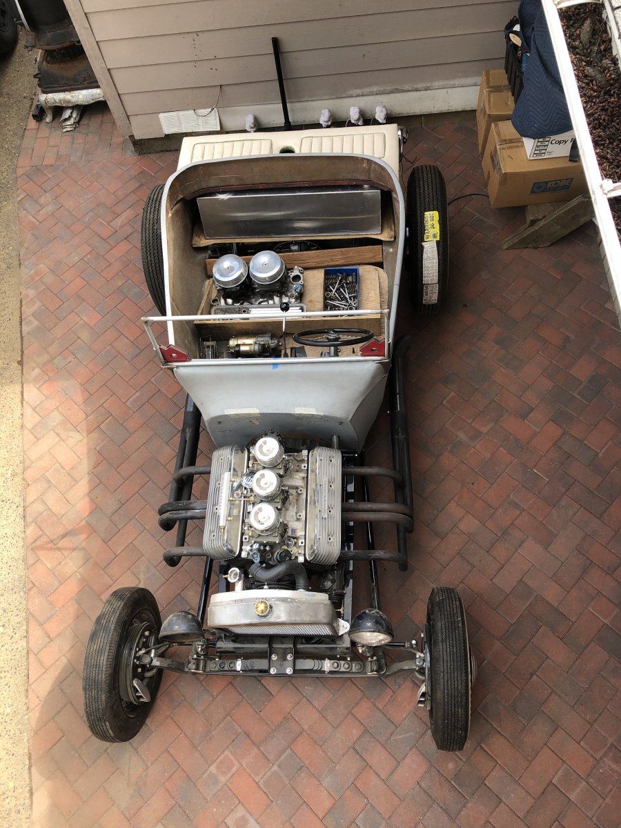

    Here’s a little glimpse of my living nightmare LOL. Every single project has turned out like this. I kid you not.
    The driveway leading to the detached garage became a pinch point behind the house because there was a rotting deck protruding into the driveway. I thought it would be nice to turn into pavers, with the idea I can push a car out of the garage and out of sight from the street. Well, like every single other project on the house, about 3 or 4 other “people” (use preferred expletive in place of people) have had their way with it first. So I tear off the deck, dig the area down (with a pick axe and spade shovel) about 18” to give the pavers plenty of foundation.... lo and behold I find 3 or 4 instances of power being run to the garage.... direct burial.... about 6” below grade..... no immediate indication if these are still live or not. Then I uncover a water line run with about 15 sections of hose clamped 5/8” heater hose.... also about 6” below grade.... Then I uncover some completely rigged drain line from when there was laundry in the garage out back..... let me tell you, cutting into that was a treat..... and lastly, there is an unknown metal pipe running under my driveway out into the back yard at a diagonal. I chose to leave that alone, and have since uncovered it in the back yard continuing its journey to God knows where doing God knows what. This was all orchards and farm land prior to WW2, so I am ***uming this is some kind of well water pipe or something.... Up against the house, and later found under the house as well, was a large pile of bones from an unknown species. I had the police out to investigate, who escalated to a detective, who escalated to a medical examiner, who said these are animal bones, you can keep digging.... so it seems at one point a wild animal was living under my deck and under the house.... crawling through the **** and piss and bones and dead rats under there to run power and water to the garage the proper way was a real joy, let me tell you. But it’s done, and it’s done to code, and the pavers turned out decent. Ignore the surface mount vinyl windows with ***** installed trim, the crooked siding, the haggard screen door..... The rest of the house lies in wait as I work my way around with a shovel in the dirt......

    Like the job you did on the pavers. Frank
