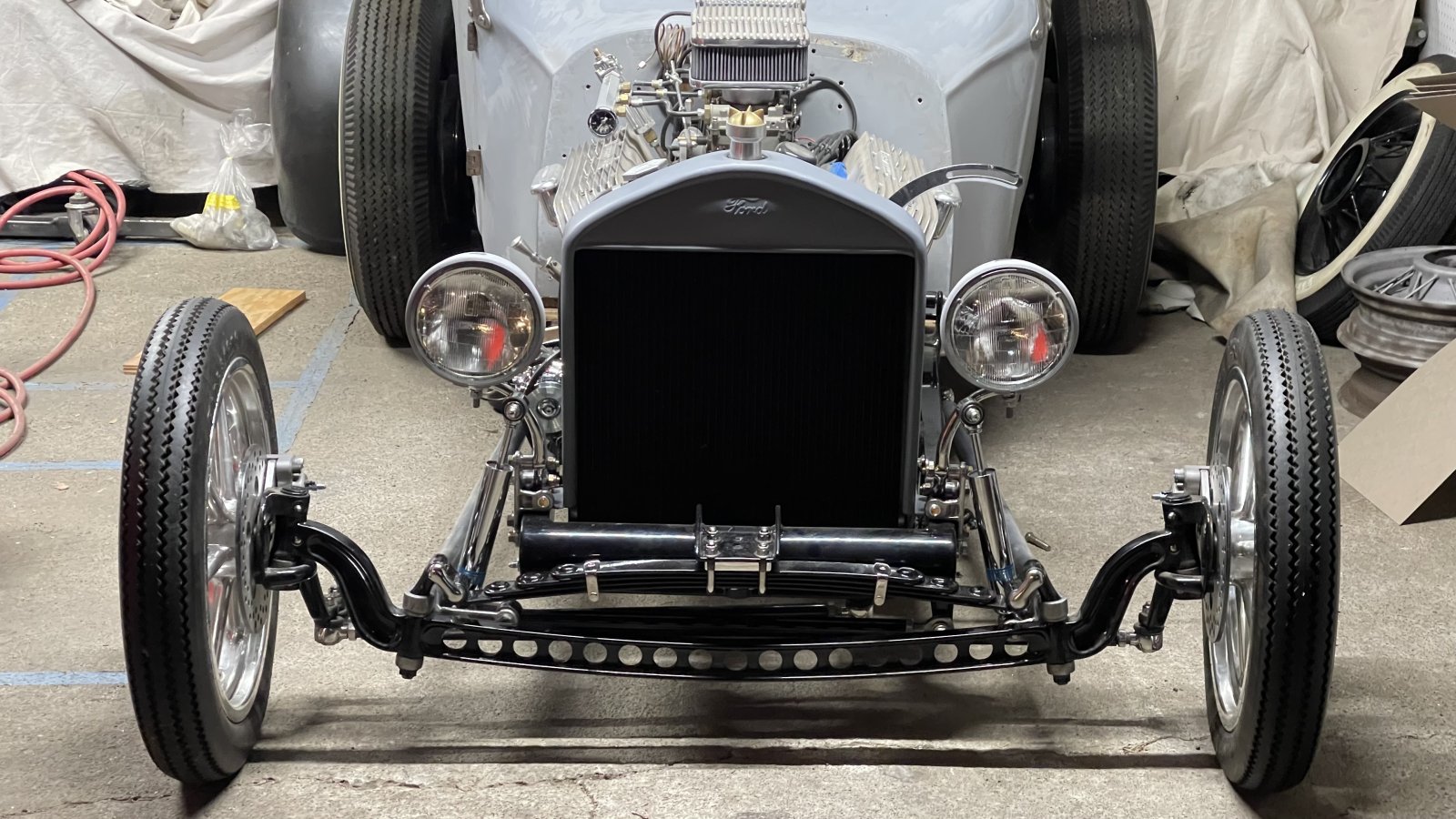

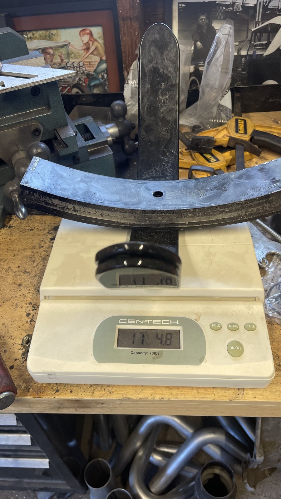

  9. Tim_with_a_T
    Joined: Apr 30, 2011
    Posts: 1,817
    Tim_with_a_T
    I’m happy to report I’ve been making some progress on the T. For mental health reasons, I’m putting the house nightmare aside for a bit to focus on getting the T on the road.

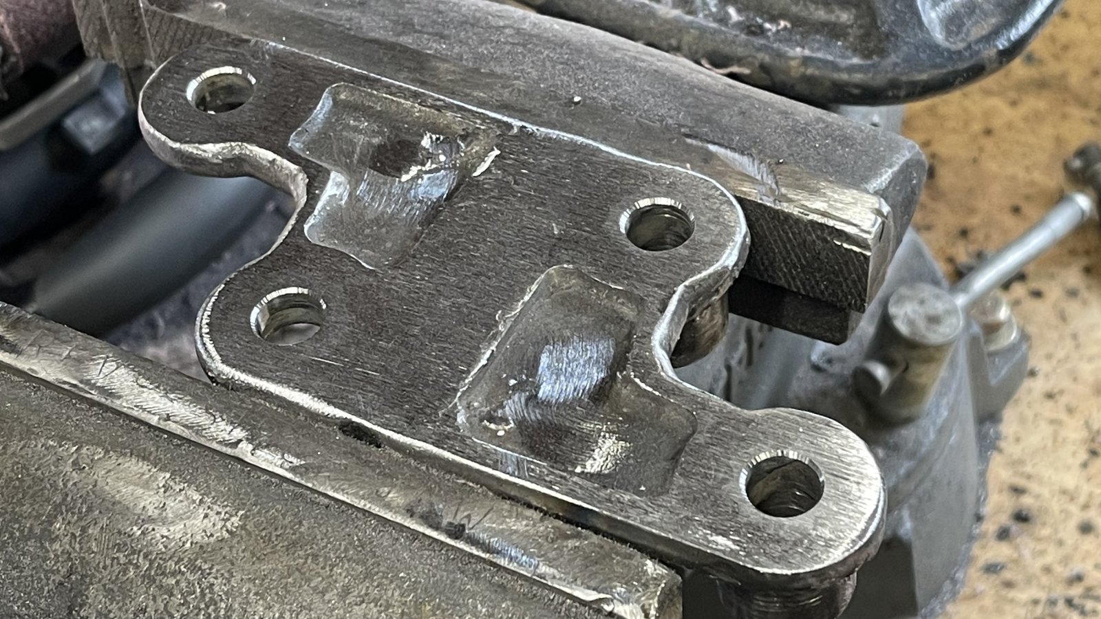

    One of the first things I needed to do, but didn’t want to do, was soften the ride a bit. Both front and rear springs were way too stiff, so I removed 3 leaves in the front spring and 2 in the rear. In the rear, I want to re-work the leaf spring spacer arrangement, but what is in there works for now…. I have no photos of this. Let’s just say it was a fight to get that thing wrangled in there solo.
    For the front, I had a cascading effect of basically gaining suspension travel at the cost of shorter shock mounting distance. Long story longer, I decided to use this as an opportunity to upgrade the shocks and spaced the upper shock mounts up to accommodate that. I didn’t want to mess with the powdercoated frame, so I made some brackets that use the original shock mount locations and radiator mount. I also used this opportunity to incorporate a small, but very bright LED turn signal. Pics below more or less explain the process. I also had to re-work the lower shock mounts, which I didn’t want to do, but I have suspension travel now and nice shocks, so it’s fine lol. Additionally, I polished the windshield frame and had gl*** made. I’ll update with another post when I get a little further.

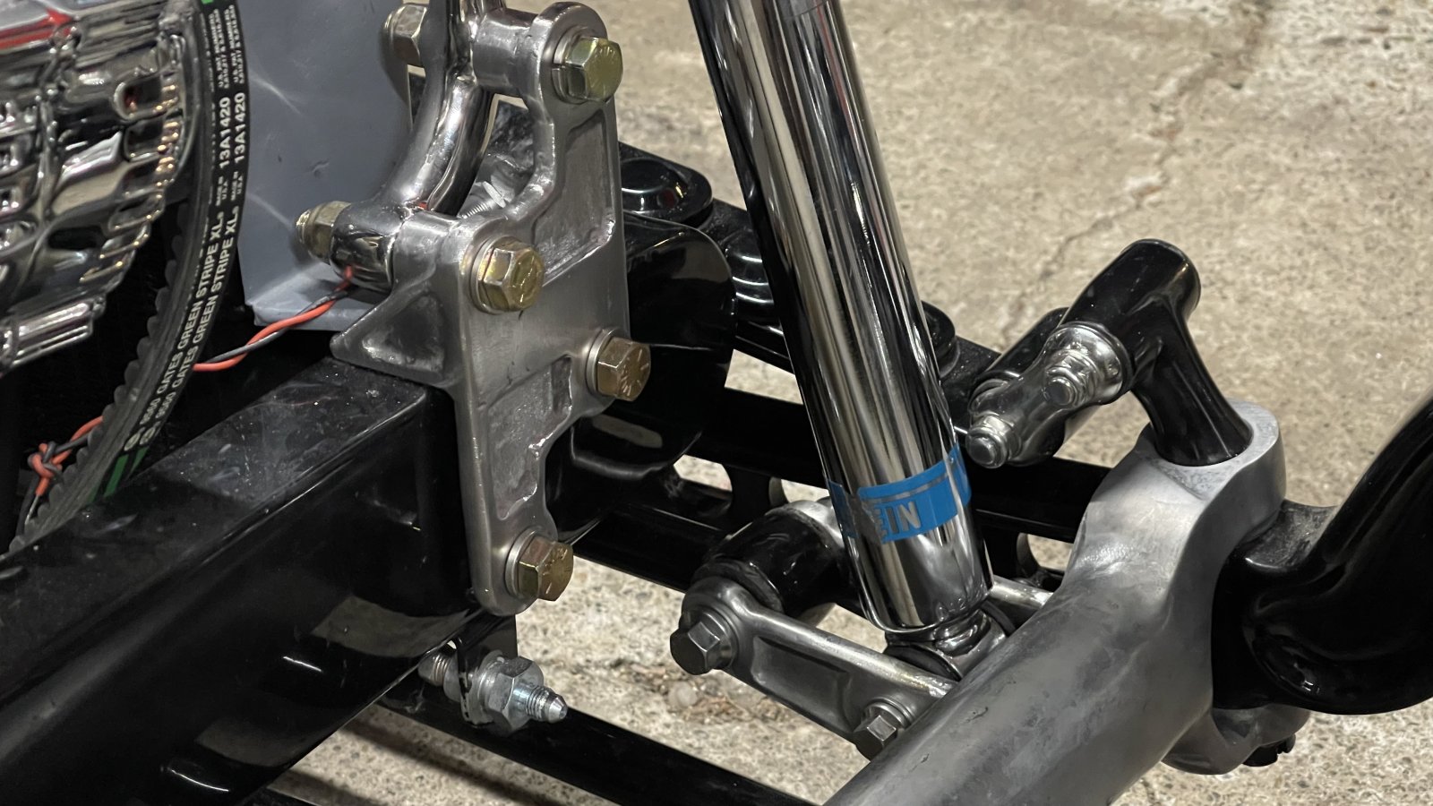

  14. Tim_with_a_T
    Posts: 1,817
    Tim_with_a_T

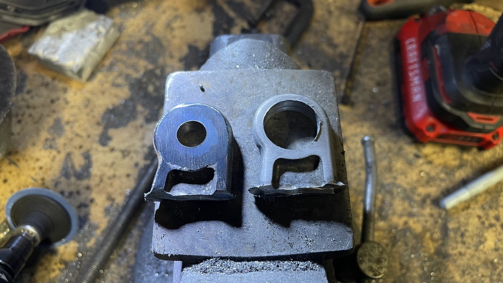

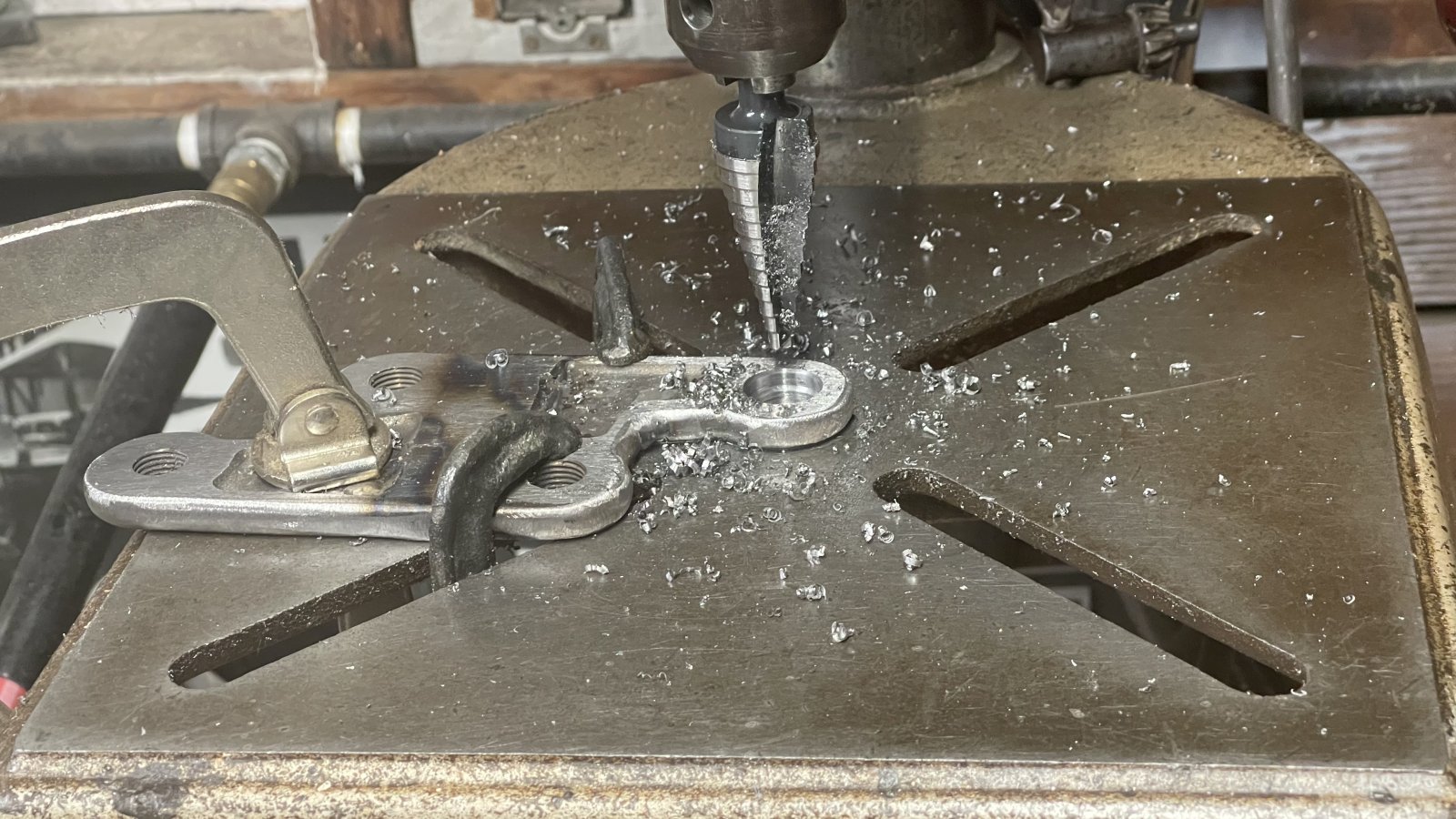

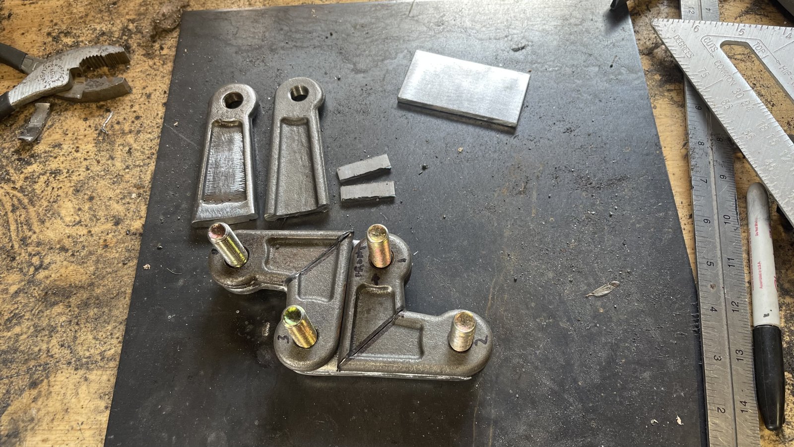

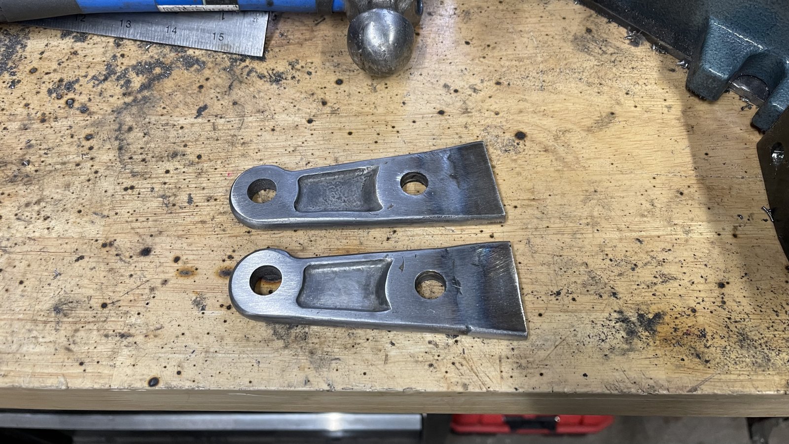

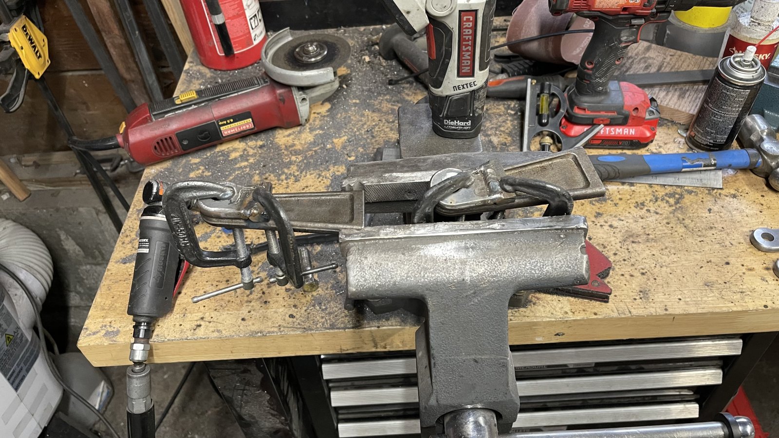

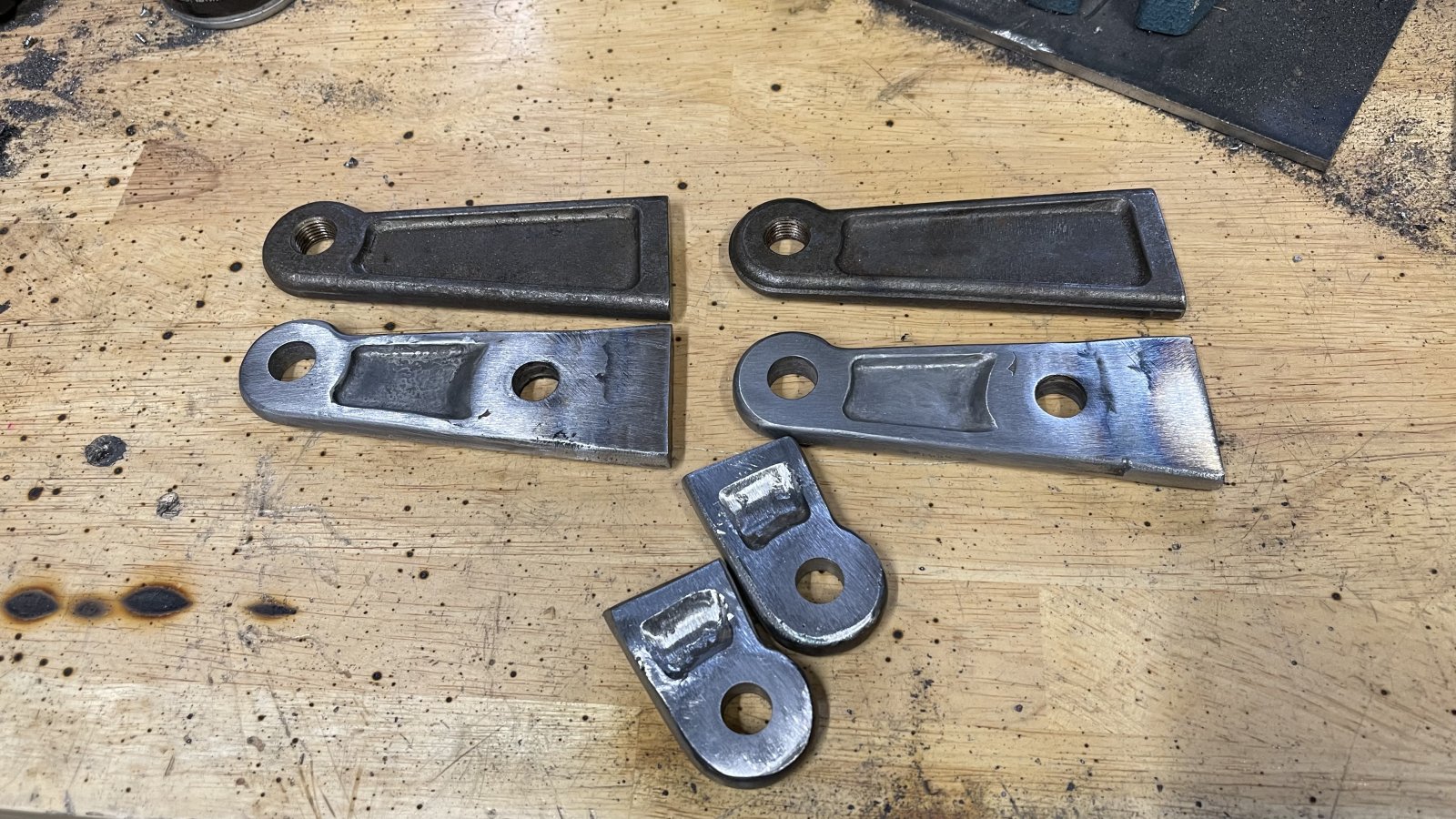

    Forgot to add the pictures of re-working the lower shock mounts, which needed to scoot down 1/2”, and I took the opportunity to make them stronger.
    OFT, brEad, RodStRace and 5 others like this.

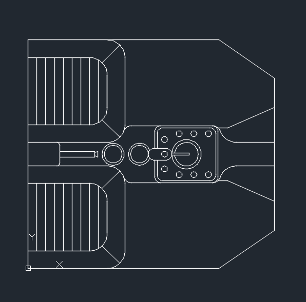

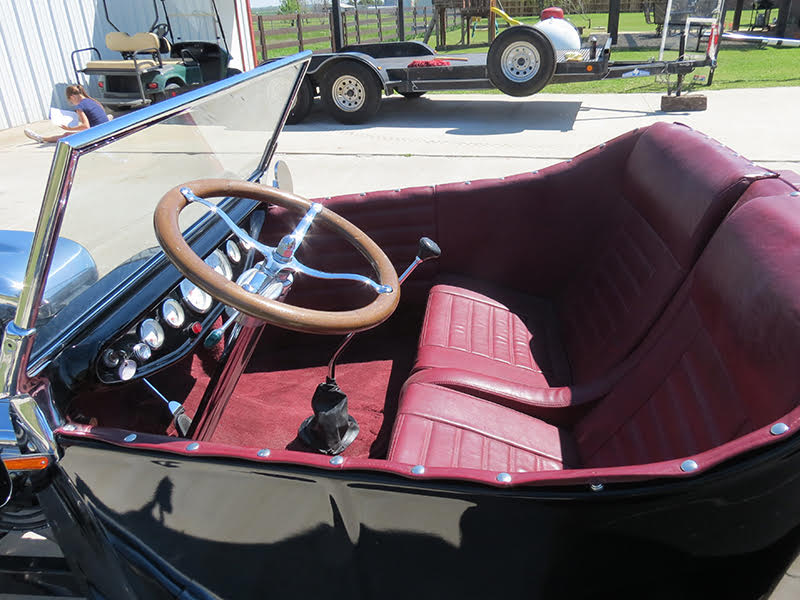

    Generally speaking, I wanna move towards a split bench situation, and I will hopefully have a post on that in the next few weeks. This is conceptually what I'm shooting for (CAD snip), pulling inspiration from these modern interiors, but with styling queues of C2 Corvette interior:
    OFT, porkshop, RodStRace and 2 others like this.
  17. Blue One
    Joined: Feb 6, 2010
    Posts: 11,578
    Blue One
    from Alberta
    Honestly Tim, I’ll wish you good luck with the interior concept you’re thinking about.
    If you think the interior of the T is cramped now just wait till you try that idea. :eek:

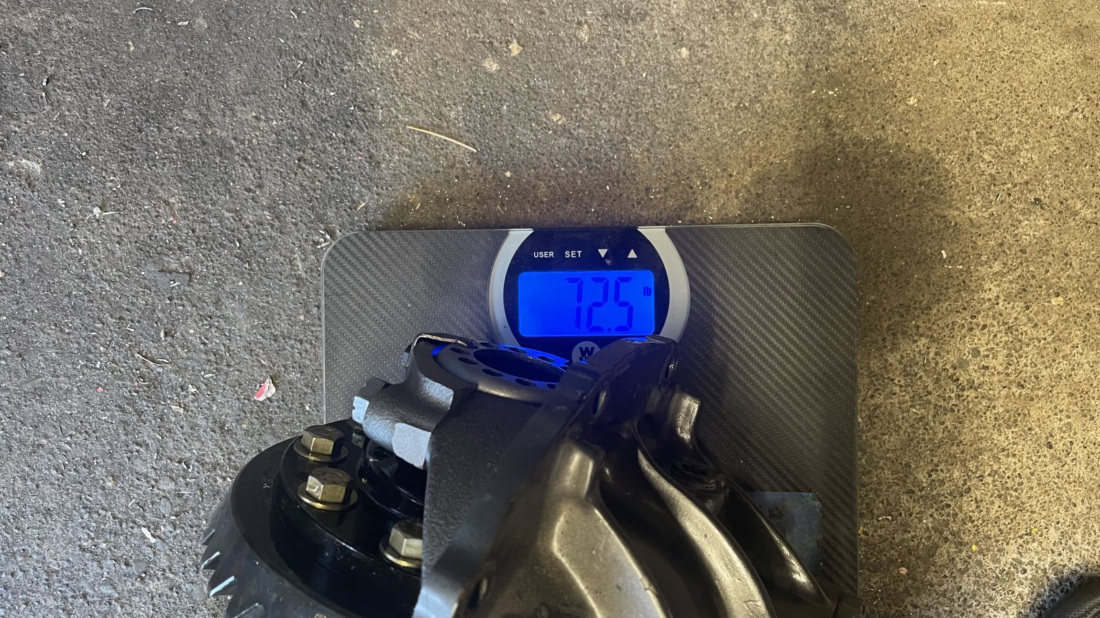

  29. Tim_with_a_T
    Posts: 1,817
    Tim_with_a_T

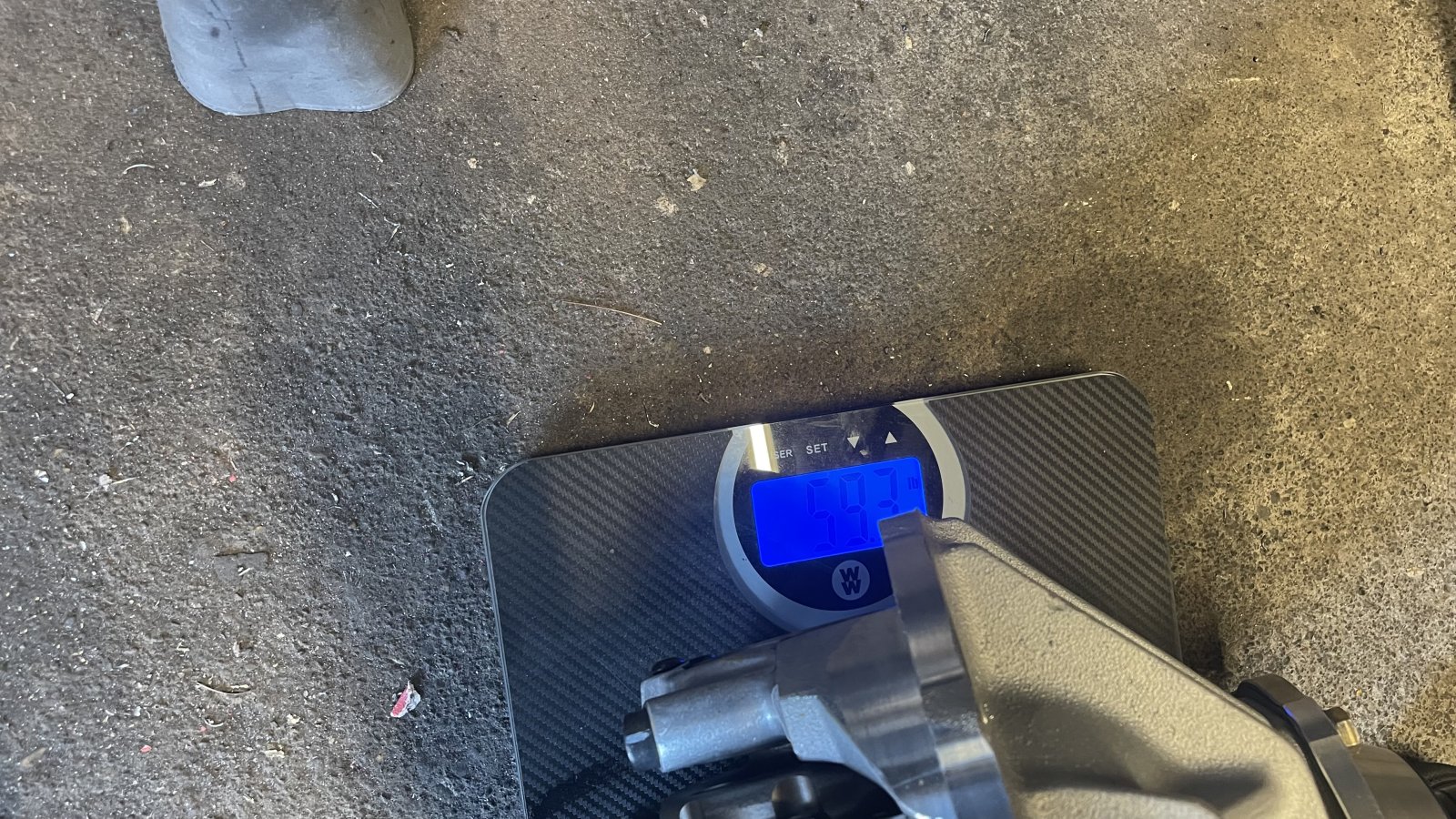

    I don’t remember if I captured this, but at one point I decided to weigh the car. I made a lever to be able to corner weigh one wheel at a time using a bathroom scale. After I leveled/weighed each corner and totaled, I decided that since I still needed to buy various things for the 32, I could just upgrade the parts on the T for lighter weight ones, one of which being the alternator, especially now that the car has a mid-late 60s vibe.
    OFT, brEad, Bandit Billy and 3 others like this.

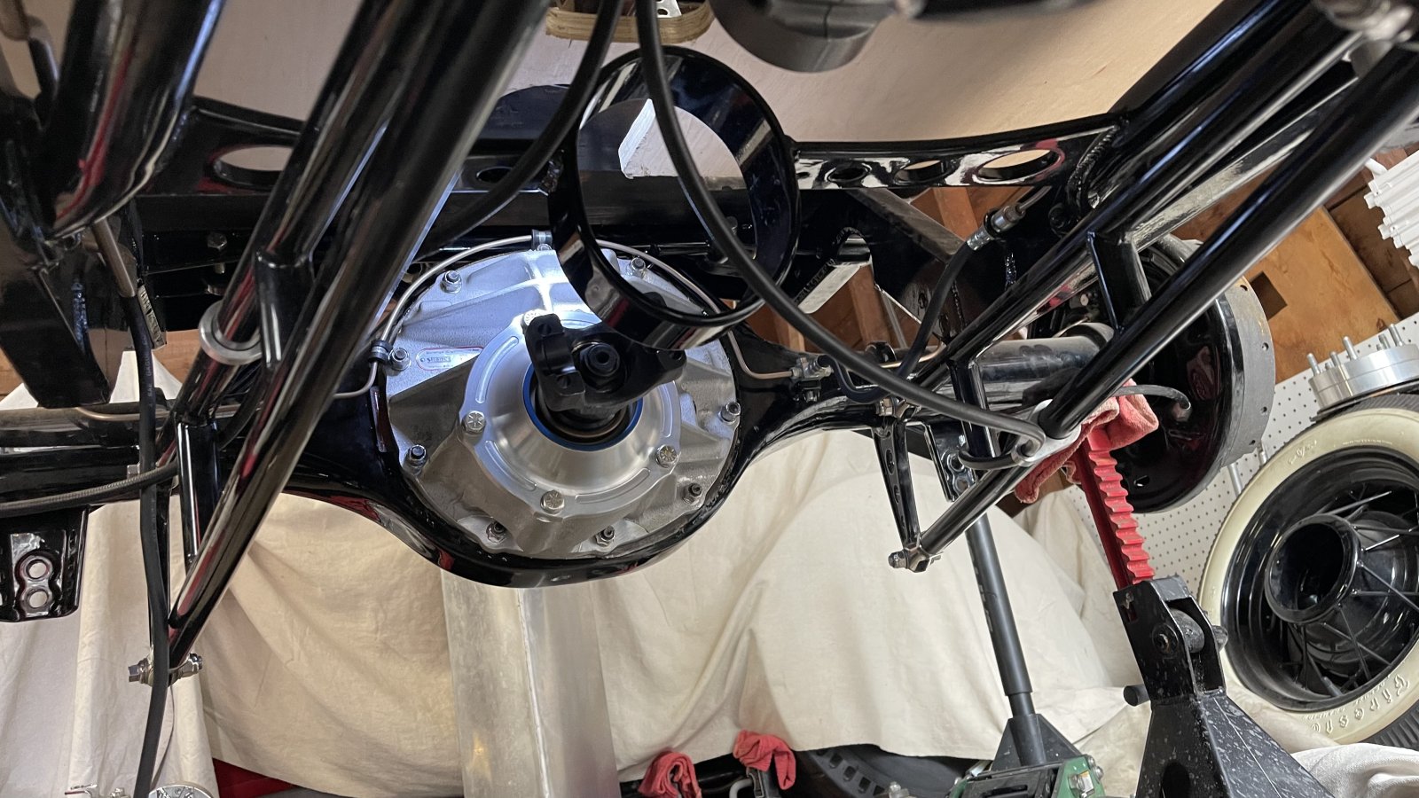

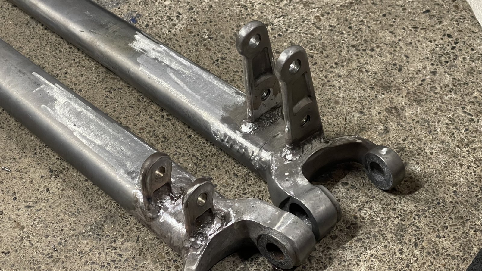

  30. Tim_with_a_T
    Posts: 1,817
    Tim_with_a_T
    Small update - I was able to get the wishbones and new upper shock mounts off to the powdercoater, and with the front end all apart, I decided to move to the rear end. I mentioned earlier I was unhappy with the rear leaf spring spacer arrangement, so I re-made that height necessary using a fabbed 1/4” plate tube spacer, which greatly simplified install and shaved 13lbs.
    Also, since I needed a 3rd member for the 32, I decided when I was in Boise earlier this spring to surprise my mom for her birthday, that I would stop in at Dutchman and order an aluminum 3rd member for the T.
    While swapping it in, I noticed a couple fails on my part- one, I had to lift the body off the frame to have enough clearance to sneak the old one out and new one in, so I think I will make some sort of access panel to get around that in the future. The second fail was I had the adjuster facing the wrong way on the p***enger side axle. Not sure what happened there lol. The good news is the aluminum 3rd member shaved another 13lbs.
    OFT, brEad, rjgideon and 5 others like this.
