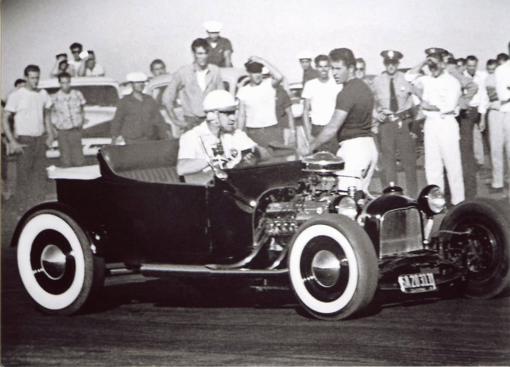

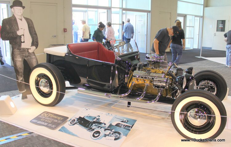

    You already know this, but for those that don't, that's "Lightning Bug", which Norm Grabowski built, then later turned into the "Kookie Kar". I would dare to say that you're right about that car pulling off wires and ww's.

  2. volvobrynk
    Joined: Jan 30, 2011
    Posts: 3,587
    volvobrynk
    from Denmark
    Yes and between you and me; I don't like the kookie Kar that much! :rolleyes:But love the lightning bug!
    Please don't tall anybody, they may dislike me for it :p;)
    Hackerbilt and Tim_with_a_T like this.
  3. Hackerbilt
    Joined: Aug 13, 2001
    Posts: 6,250
    Hackerbilt
    Funny you say that, because I feel the same way about the Lightning Bug over the Kookie Kar...although I certainly don't hate the latter version...just prefer the first!
    I think it comes down to Norm realizing that to make the car his ticket into the movies he needed to have something that stands out on a 2 dimensional movie screen, and that required some over the top changes to the original car.
    The Milner coupe being another example of over the top styling "working" on the screen, but maybe not so much in the flesh, as well as a good number of other cars in different movies!
    Sometimes the movie or the car becomes a major icon and as a result influences current real world design.
    There is no denying that the Kookie Kar version did exactly that and basicly created the fad T as a result!!!
    A hard act to follow for sure....;)
