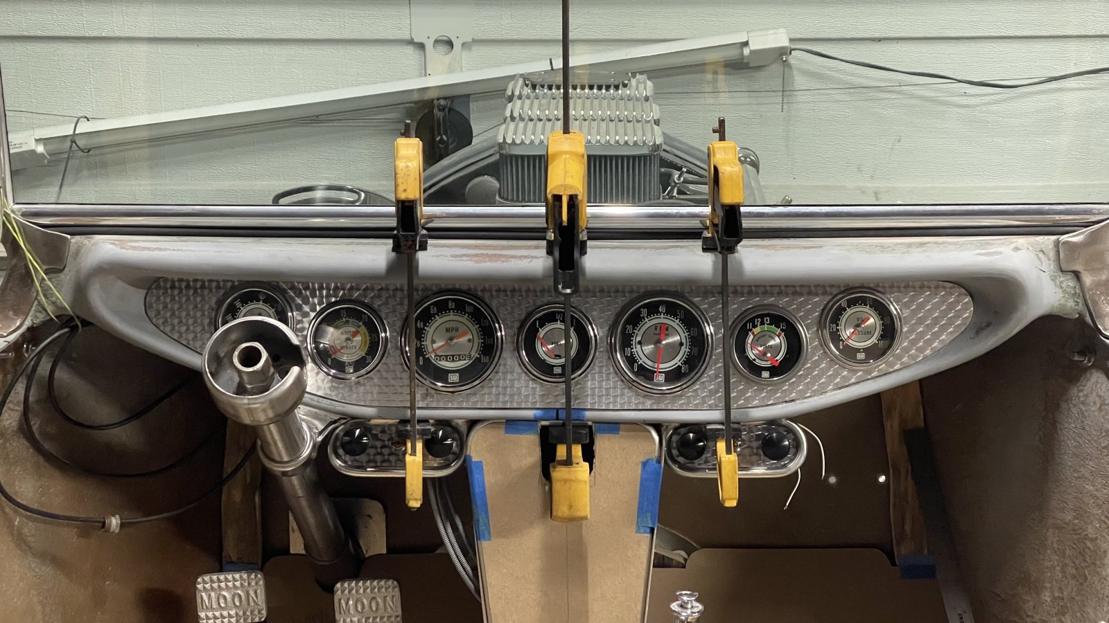

    Not much to show off- lots of scheming and staring, but last night I mocked up a few additions to the floor shifter console. I think it makes sense to finish this up once the remaining pieces arrive, since I am happy with how it’s turned out, then move onto the next thing.

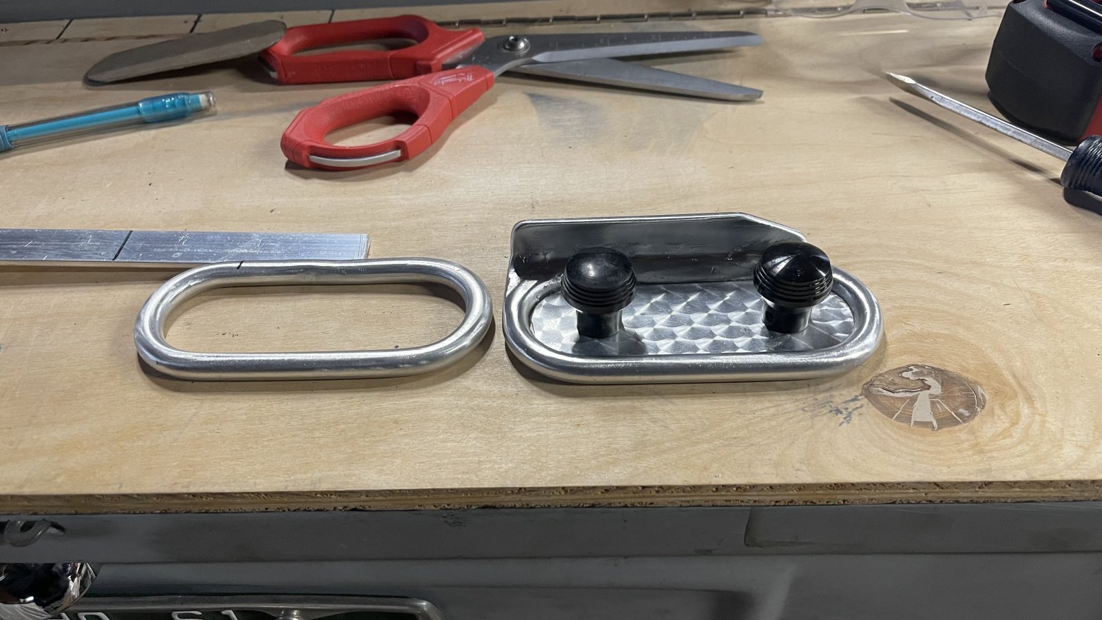

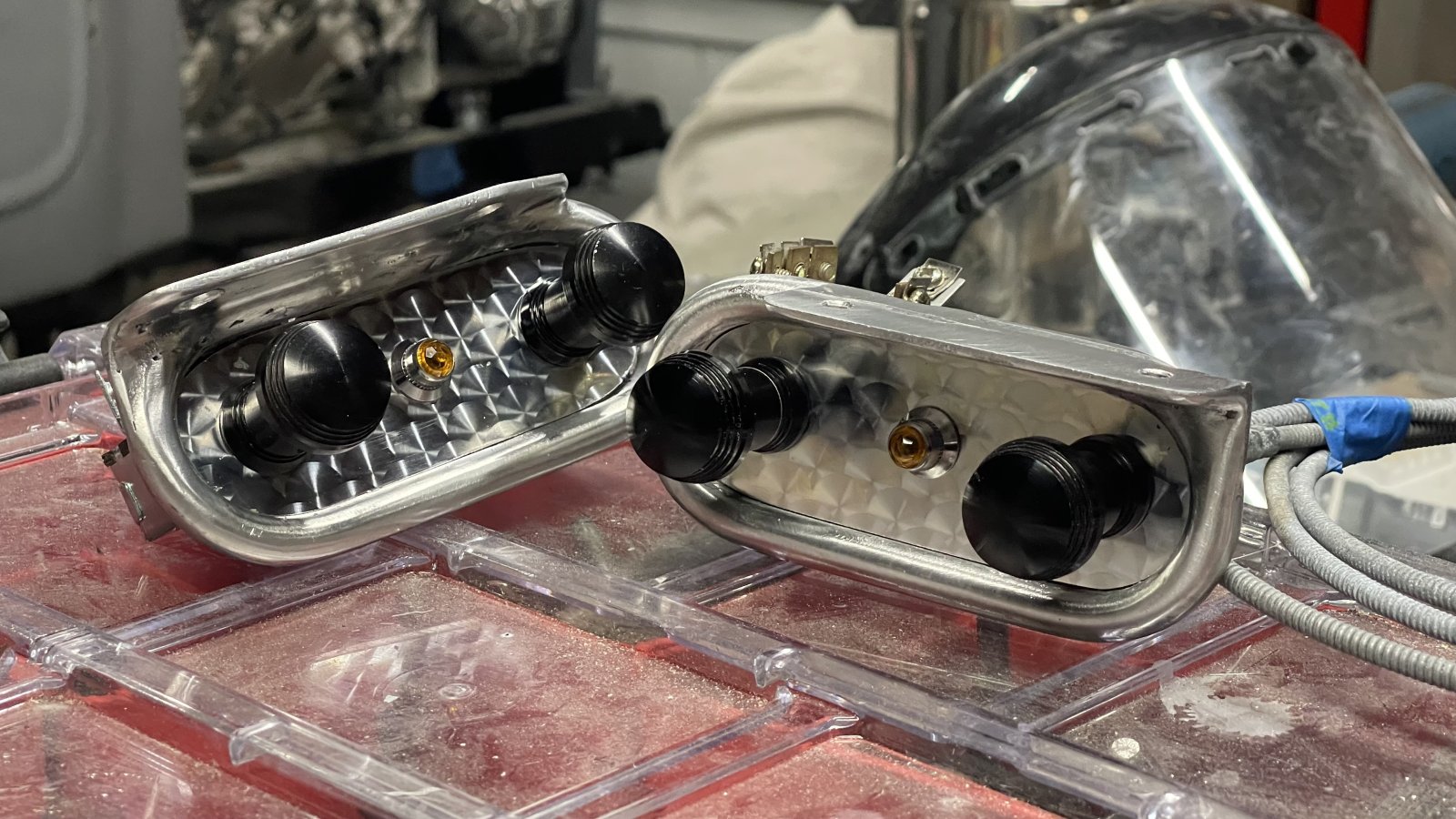

    Been waiting on some stuff to show up, but I managed to keep busy by making a pair of control pods to mount under the dash, using some 3/8” aluminum bar stock. They still need a little work, but I’m happy with how they are shaping up.

    Could you put those pods in the tapered vertical section of the center console? Cut down on the "busy"?

    I’ve got some stuff planned for the vertical areas of the center console - filling that in, the toe boards, and the waterfall, will probably be my next moves. Hoping to get parts and supplies in time to make some progress over the holidays. Got the pods mounted:

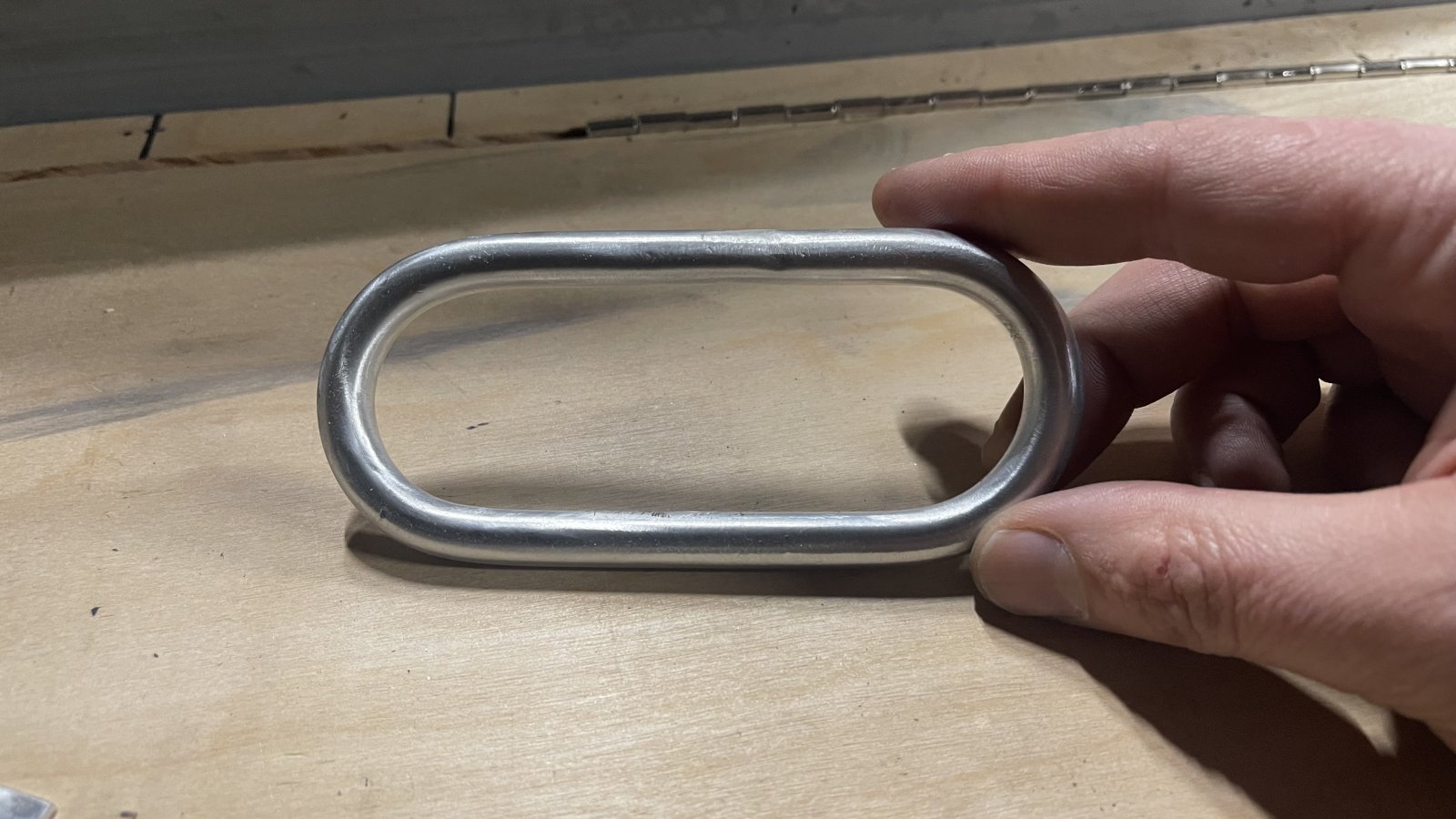

    how did you bend/ make the perimeter of the pods?
    porkshop and Tim_with_a_T like this.

    I bent 3/8” bar stock in a tubing bender meant for brake/fuel lines. The bender I have seemed to put up with 90* bends no problem, but on the last 180* bend for the switch pod, I broke the handle on the bender. I bought another one, to be able to keep moving, so we’ll see how it goes. I’d really like to find a Made in USA bender that isn’t a small fortune, but I’ve gotten a lot done over the years this Imperial one:
    https://www.amazon.com/Imperial-Tool-470FH-Triple-Degree/dp/B007J9FWSA

    Nice! And then is the turned insert welded to the back side of the tube?

    I had initially welded sheet aluminum to the tube frame, then fit the insert to drop in from the front, captured by the switches. The sheet is too thin- I got it done, but I will re-work with the 1/16” aluminum as the backer, which should work much better.
    I’ll take better pictures of this when I rework them- theoretically you could make whatever gauge panel you wanted to using this method, then you can polish the aluminum frame and with the insert of your choice, they can look like the various Stewart Warner panels made back in the day. I think using this method, I can get a close copy of the “Mate” panel, which seems to be difficult to find, and I’d like to possibly use one for the 32 if I am able to get to it later in life.
