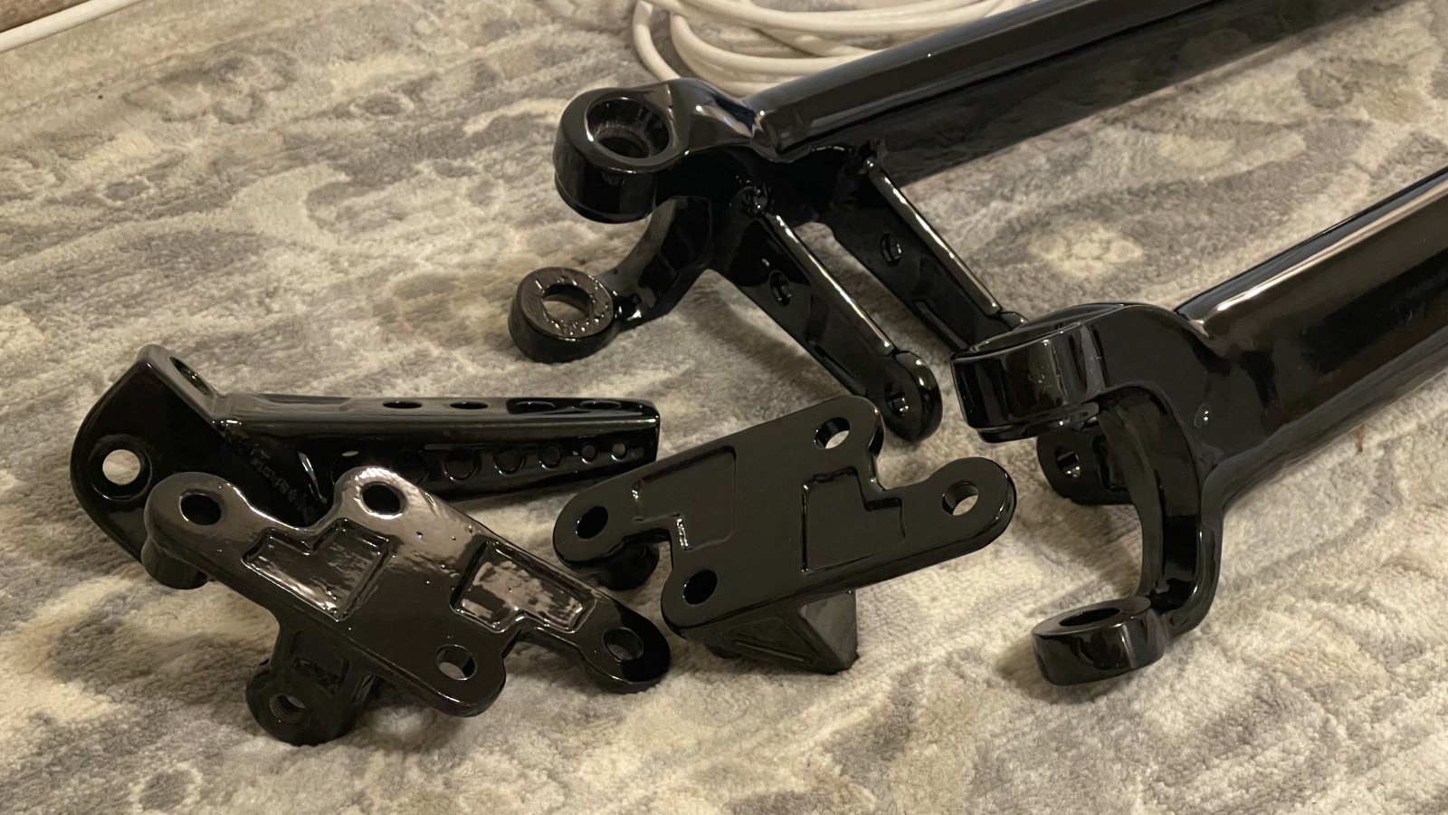

    I got the wishbones and shock mounts back from powder coat. Special thanks to Russel for taking me on in his busy schedule.

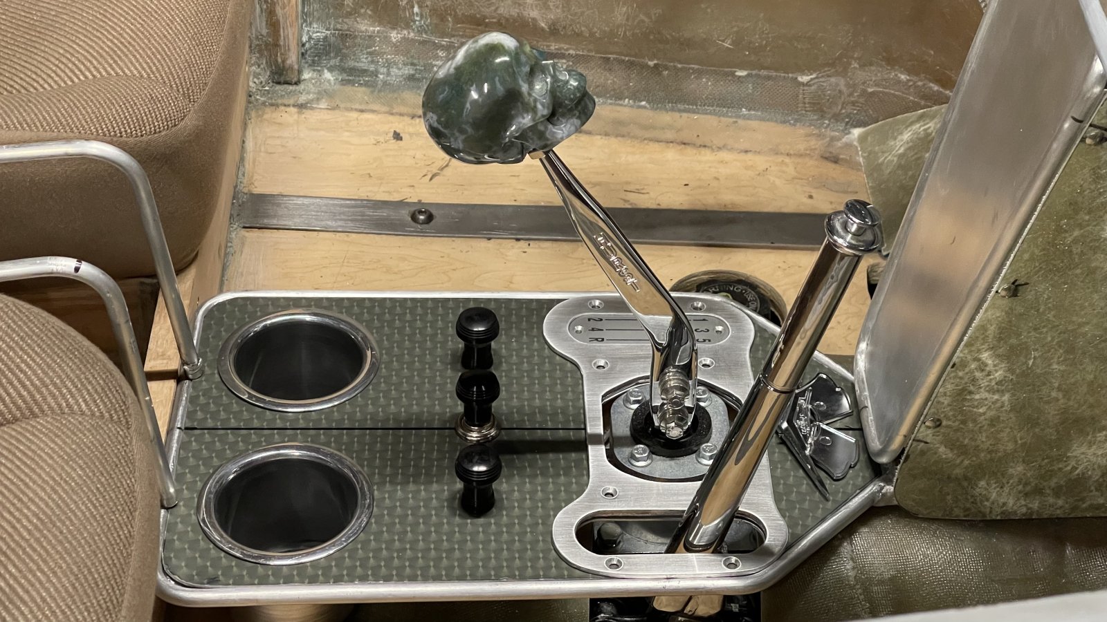

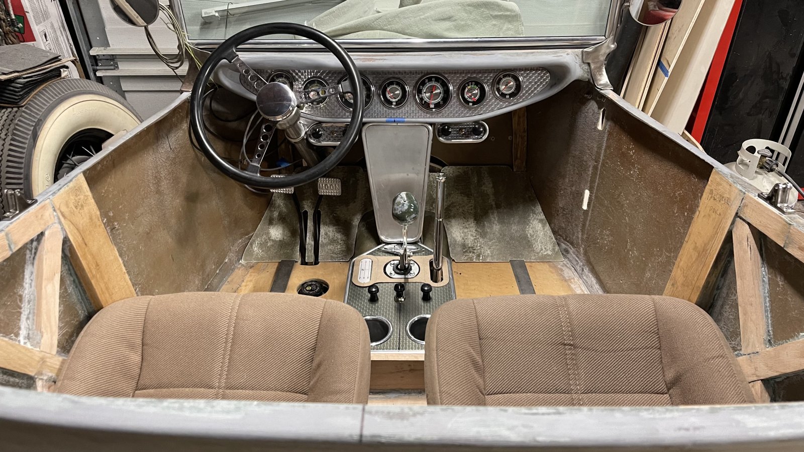

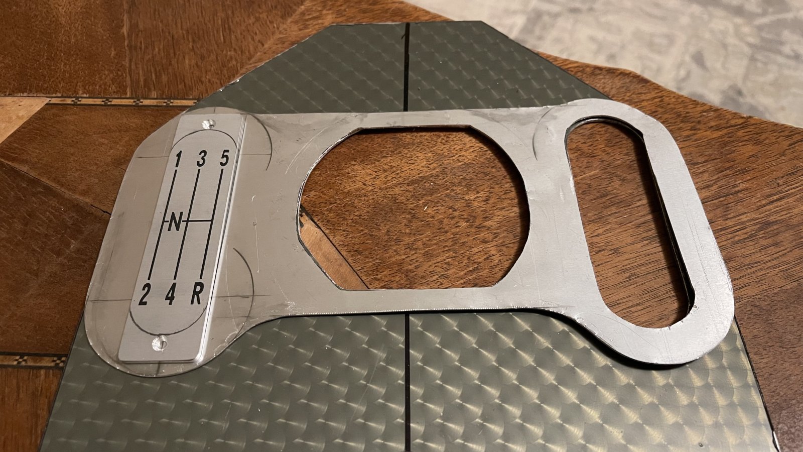

    Made some progress on the waterfall panel- got the 1/16” insert fit and welded to the frame, mounted the panel to the dash, welded some 1/8” side rails to the panel frame and used some riv-nuts to attach the side panels, then fit and mounted them. The gf and I hopped in for a test fit- the toe boards are a great addition for comfort, and the waterfall panel doesn’t cut into any foot room. I’ll probably work on the shifter panel next, as that seems to be the part I have all the pieces to finish.

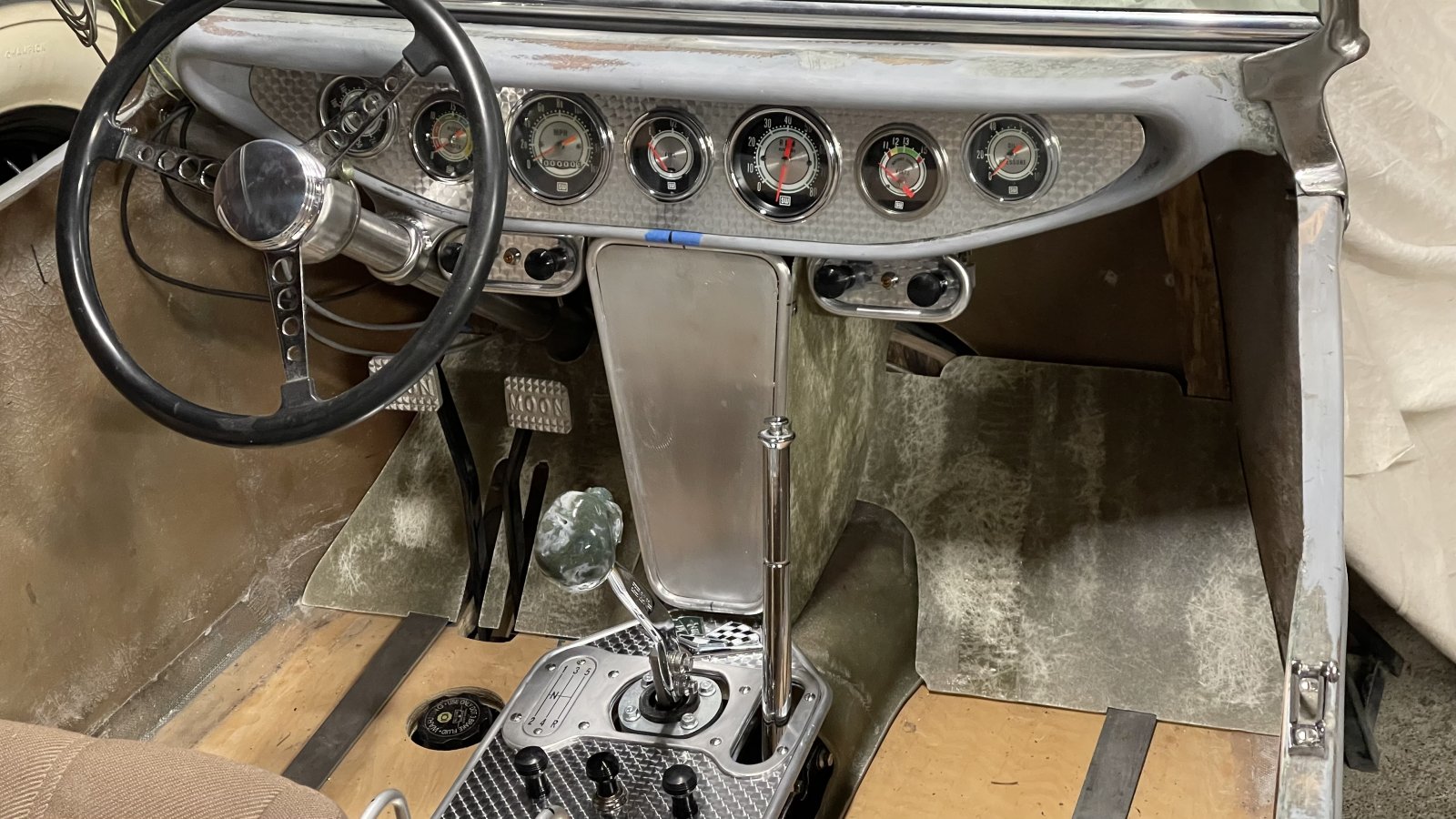

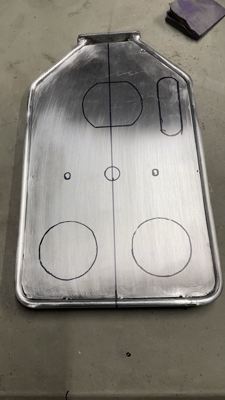

    Got the shifter panel insert fit and welded in. Tomorrow I’ll cut out the various holes.
    brEad, OFT, porkshop and 4 others like this.

    Looking like a car more than ever now! Appreciate that shot of the backside of the panel!

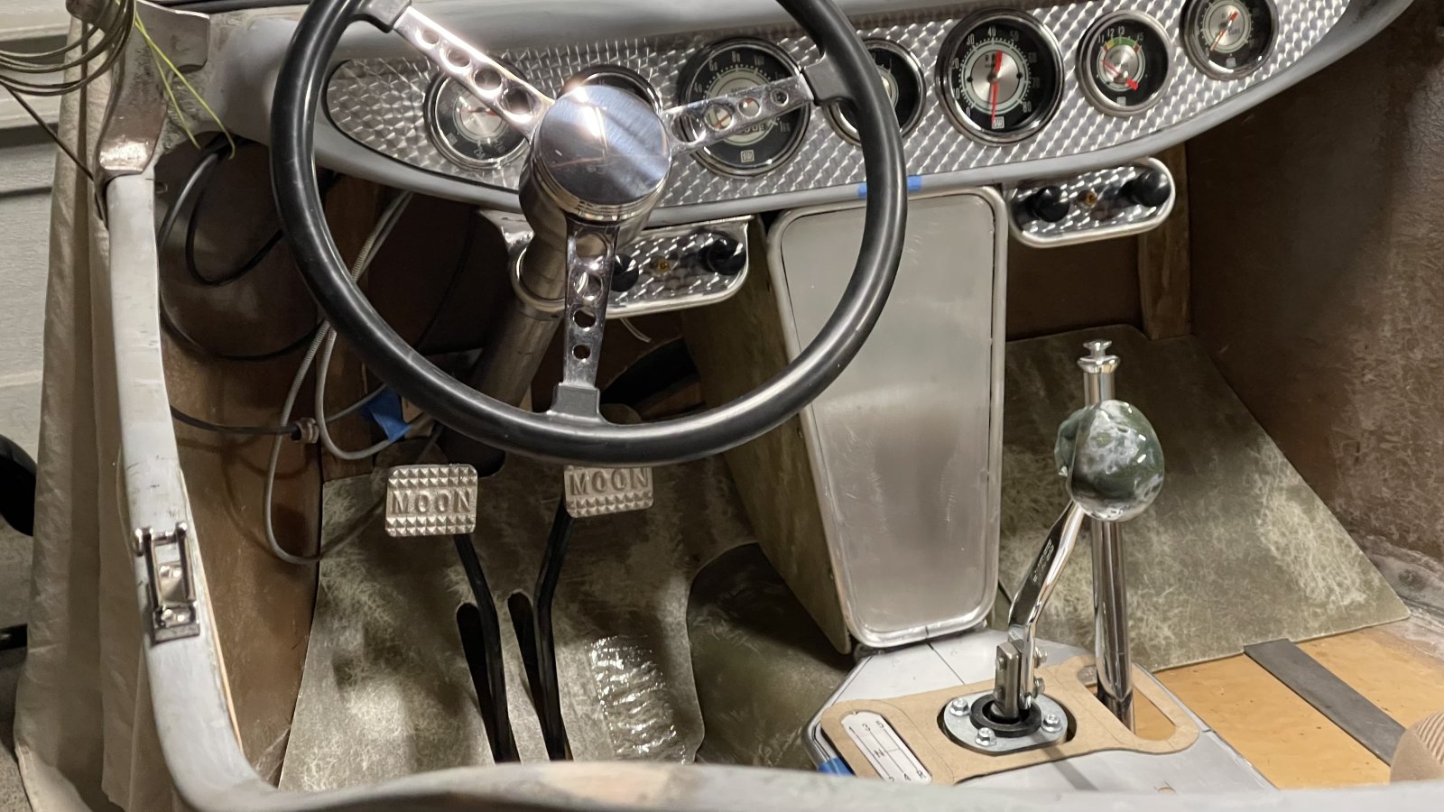

    Makin some more progress:

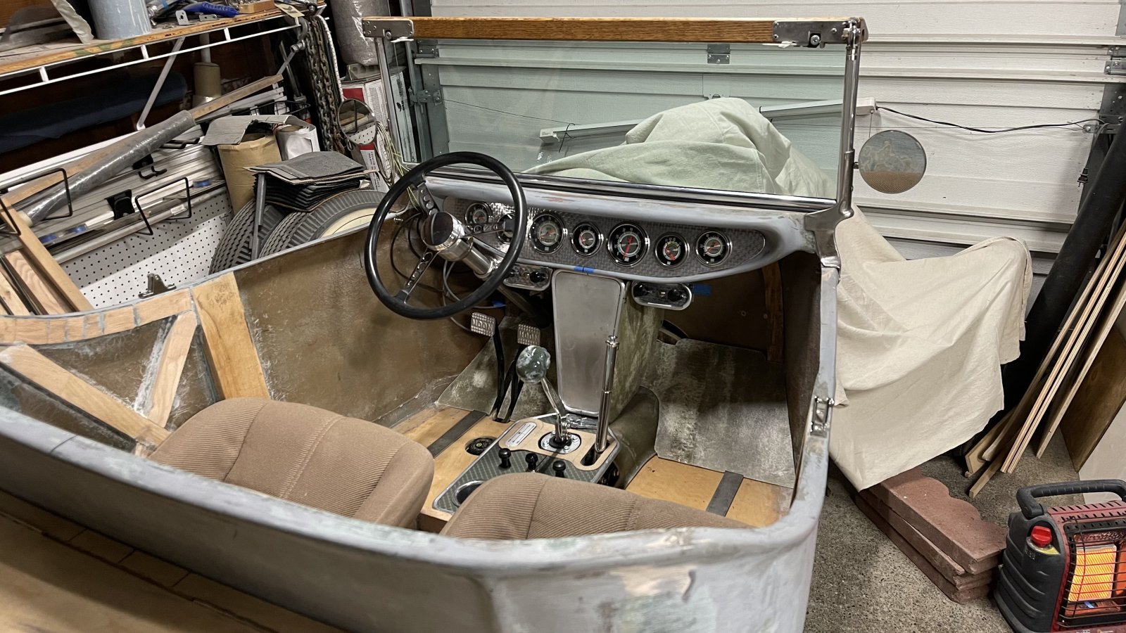

    The bends are not the same in the waterfall panel left to right- I needed to get something in there to see what it will look like so I just did the best I could, but it will probably be re-worked. After making it, my welds have improved enough that when I make it again, I will make the frame in two pieces, which will allow me to mirror them better left to right, then weld them together, and so on. But for now, I needed to see what it would be like with that space occupied, so consider it a placeholder until I can confirm all the other details planned will work out. Lots of things to hide still!

    I know you said this may just be a first draft but that is pretty cool Tim.
    I really regret posting the photos of those hideous shift boots, I envisioned that you were going to need to cover the shifter and e-brake handle as well as the open space next to the handle, seems you had a plan from the start.
    With a limited working space as you have, a packaging mindset needs to come before satisfying the "dreaming" stage, I still struggle with doing something over, I have learned to embrace the cardboard and scissor phase.

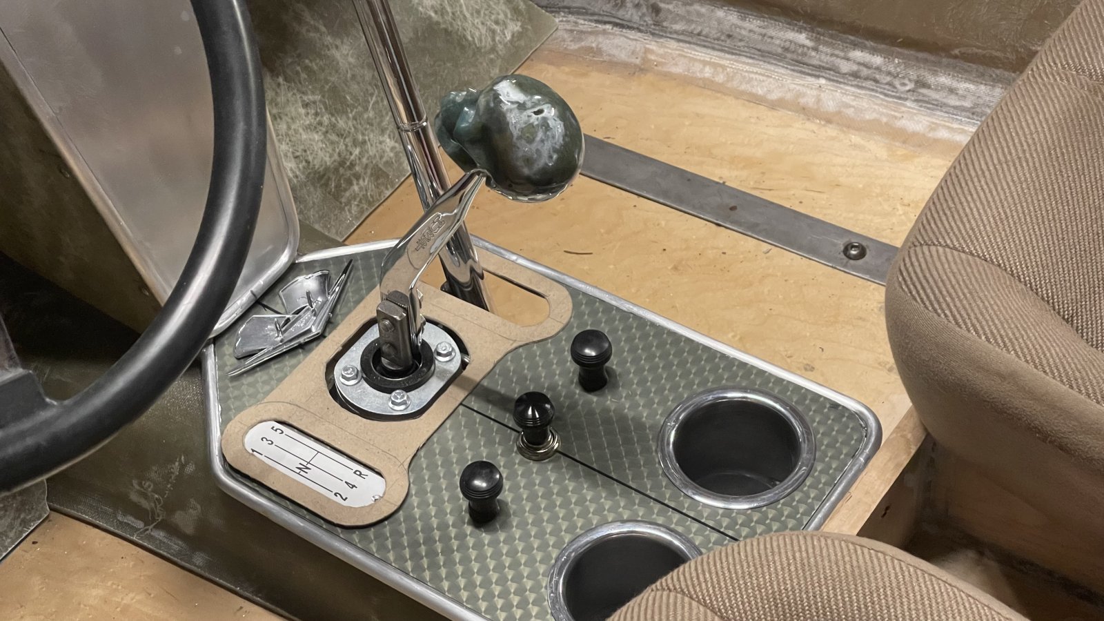

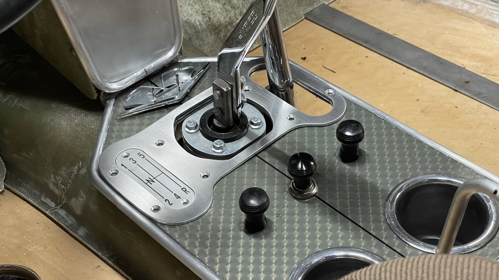

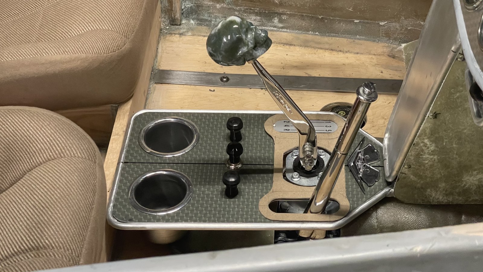

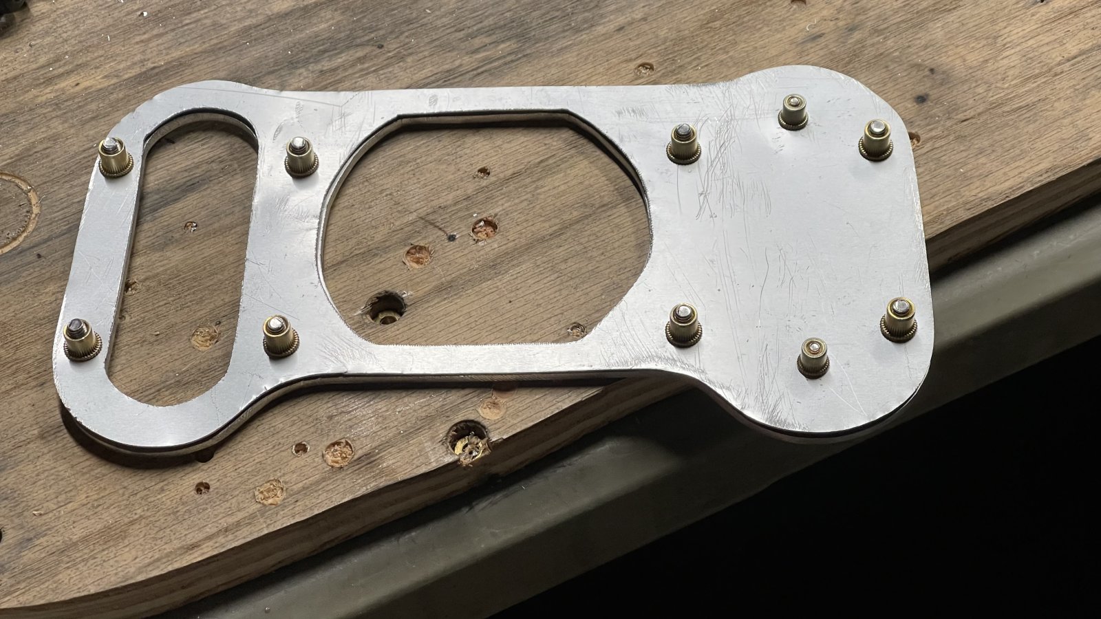

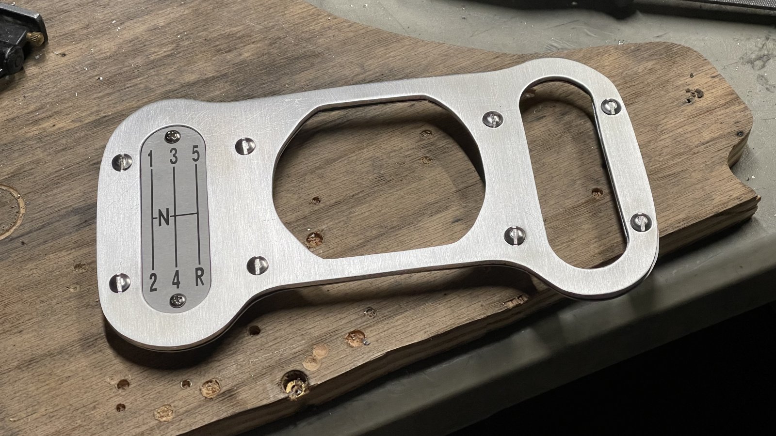

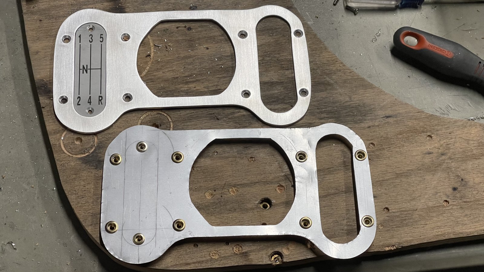

    Today I took the old insert panel and cut it down to put in riv-nuts. This will sandwich the shifter boot and emergency brake handle boot underneath the panel and help hold things together. I also cut a bezel out of 1/8” aluminum and fit the H-pattern tag. Once I have more time, I’ll drill the holes through, round all the edges on the bezel, and polish. The tag is 1/16” thick, so it will be recessed in the bezel and should look pretty cool.

    That is just plain beautiful, nice job.

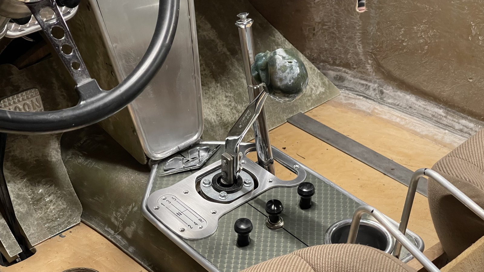

    Thanks. Made a little more progress today. Figuring I might as well keep working to finish up this section of the interior as best I can. Next is probably closing up the sides- I laid up some fibergl*** for that the other day, so I’ll work to shape those in this week.

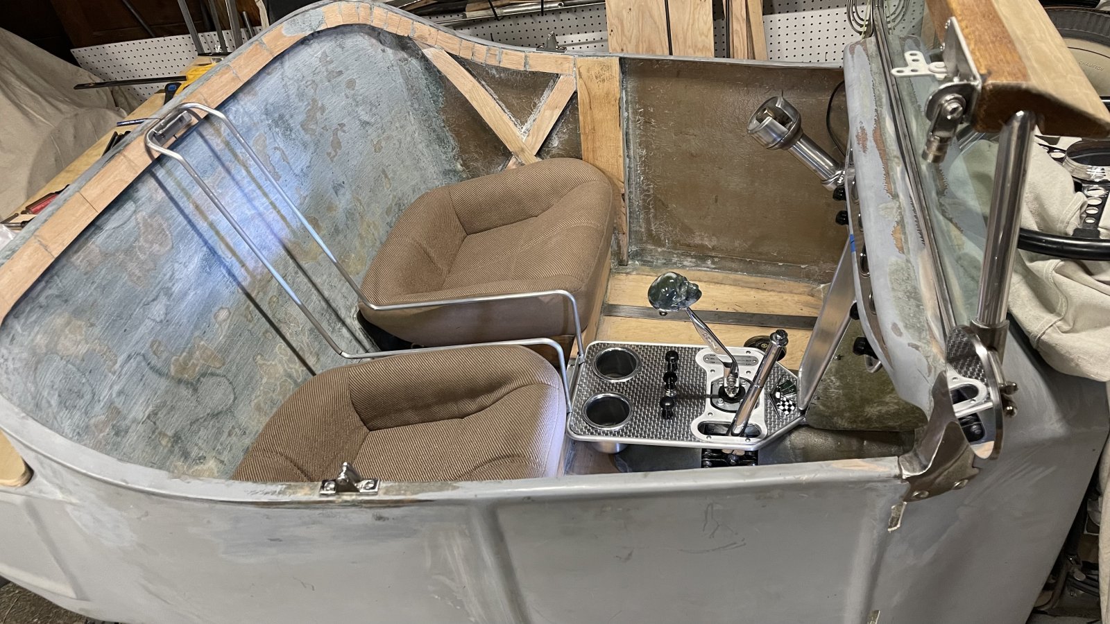

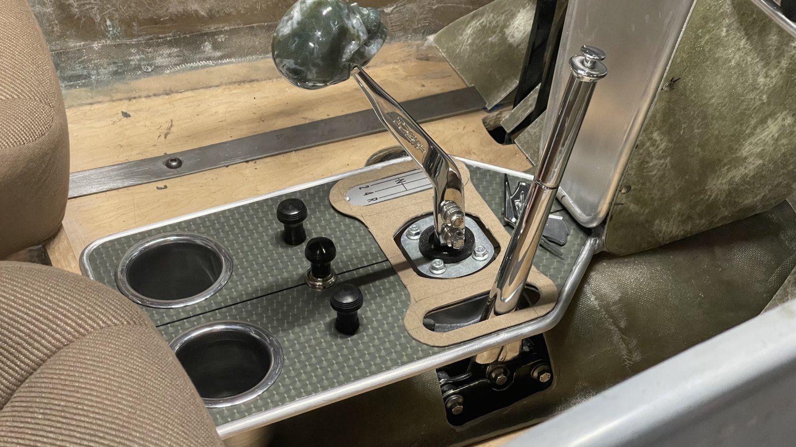

    Tonight/past couple days I’ve been staring at that waterfall console between the seats. I had a heck of a time getting the bars bent up roughly symmetrical and mounted in the car. I think now I have something to work with, but it obviously needs a lot of attention before it will look like something.
    My thinking here is to use the waterfall as a border to build the side bolstering of the seat back foam, optimistically mirroring that in the interior side panel against the body when the time comes. Hard to explain, mostly because I don’t have it figured out yet lol. Anyway, stay tuned for more madness.
