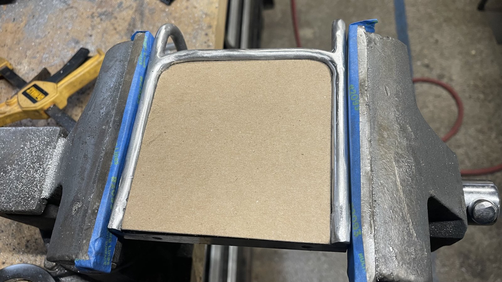

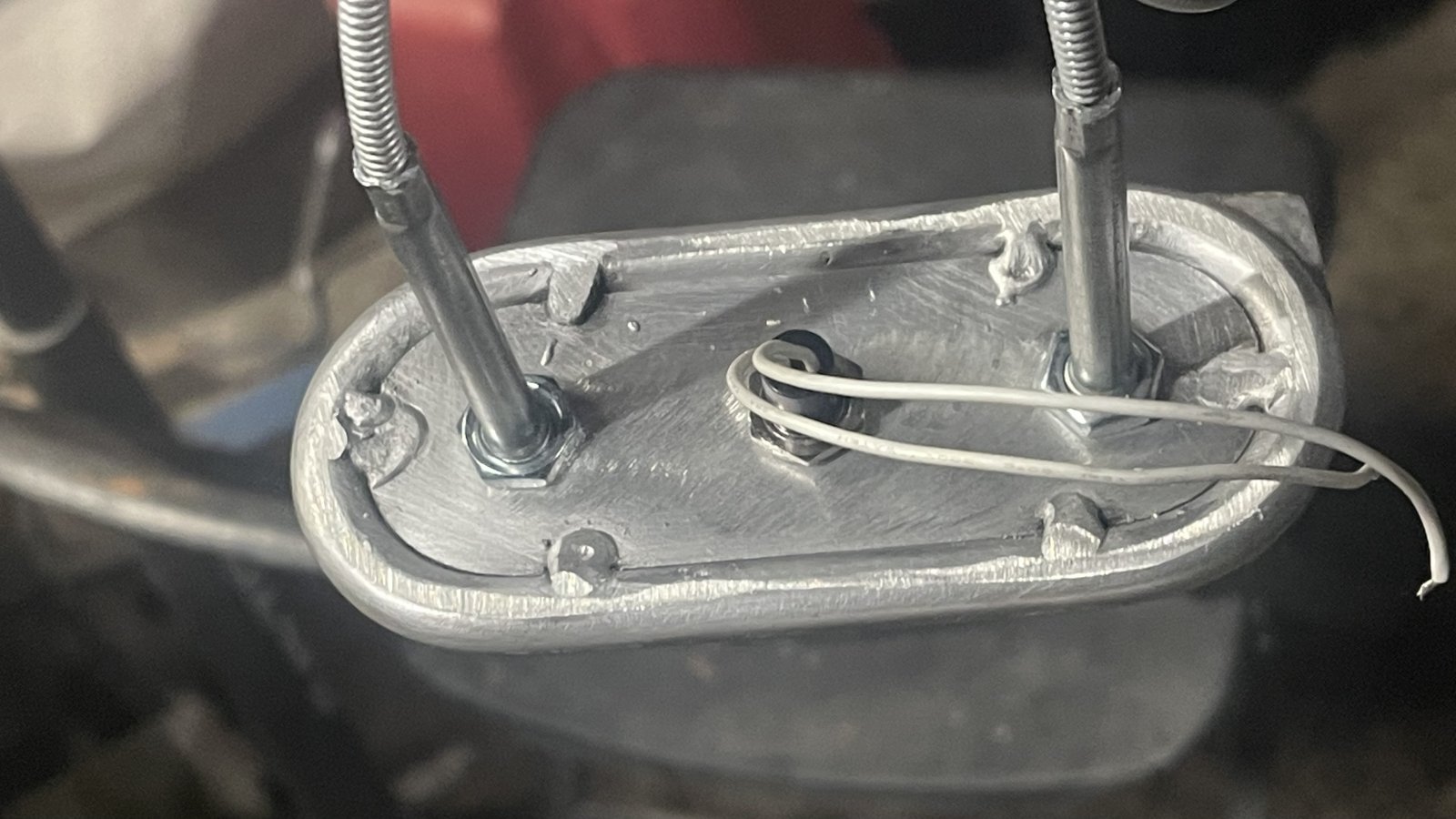

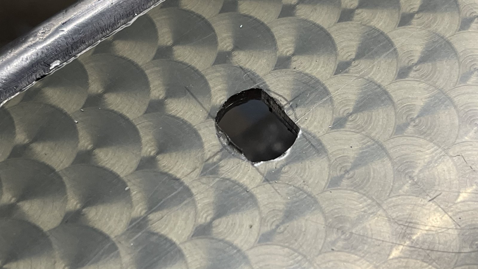

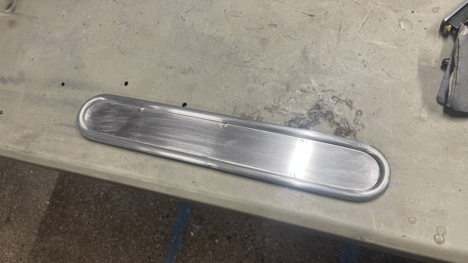

    Unfortunately, not a lot of weekend progress as far as pictures go. I managed to reach a few dead ends, which I won’t get into, but I also made a couple revelations in wiring strategy and switch locations, but also still, managed to destroy the majority of the switch bezels and knobs attempting to remove the fading anodizing…. So that was neat - I was successful on two bezels though lol. Hopefully some more progress this week to make up for the backward progress of the weekend.
    A few in-process pics:

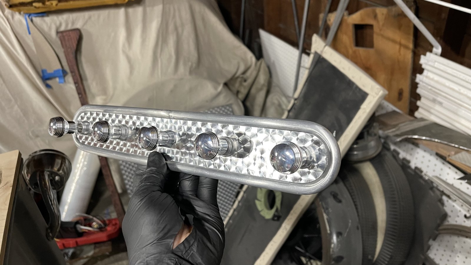

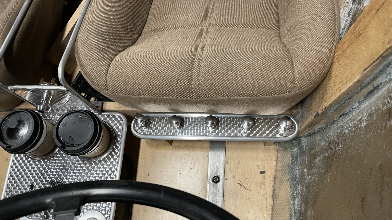

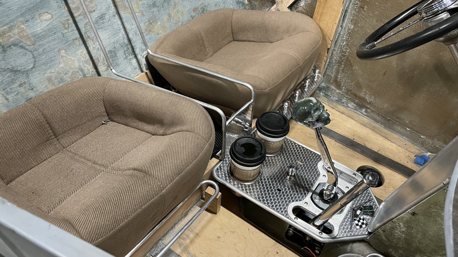

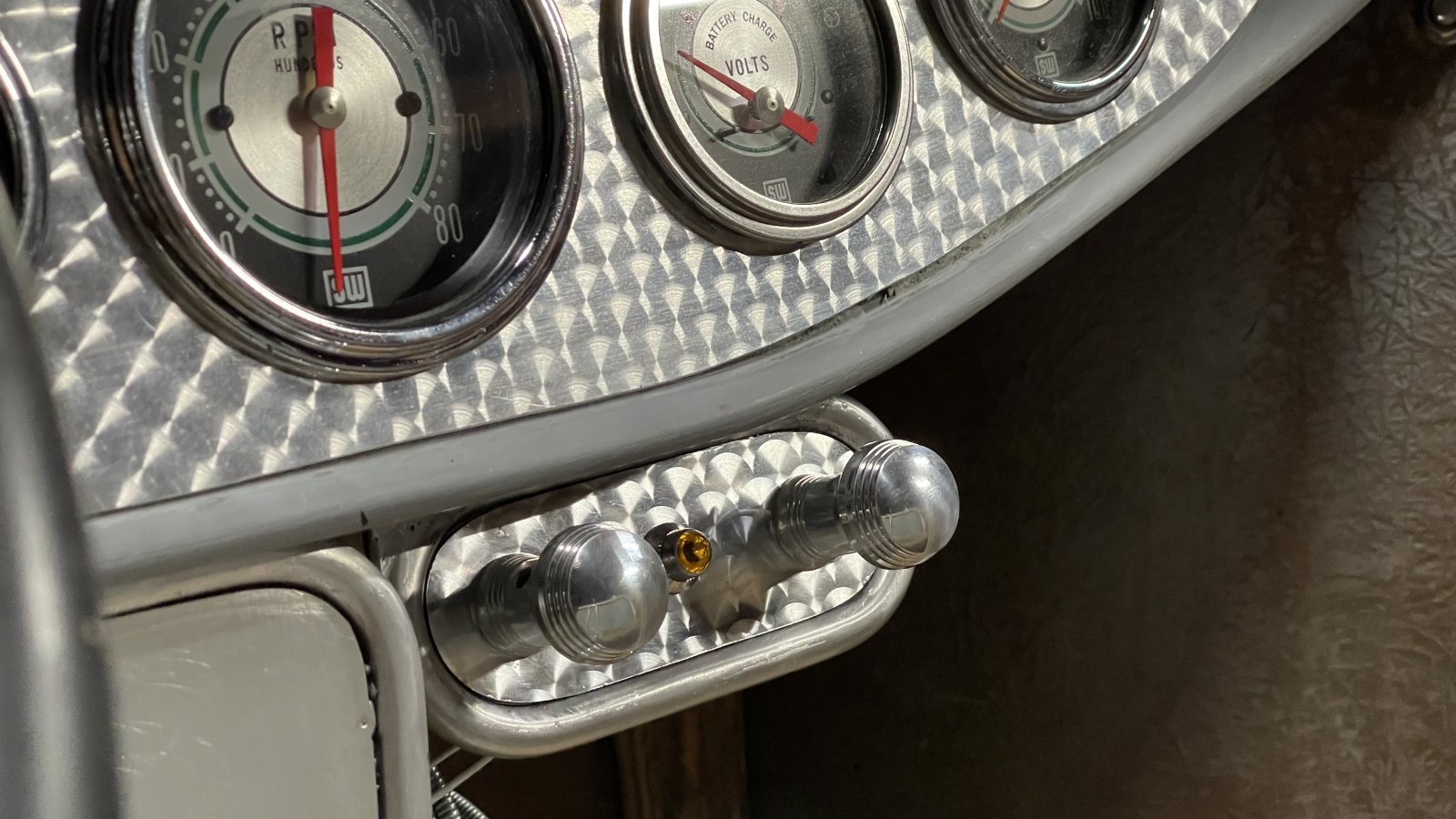

    More progress on some interior details:
    brEad, Tim, vtx1800 and 9 others like this.

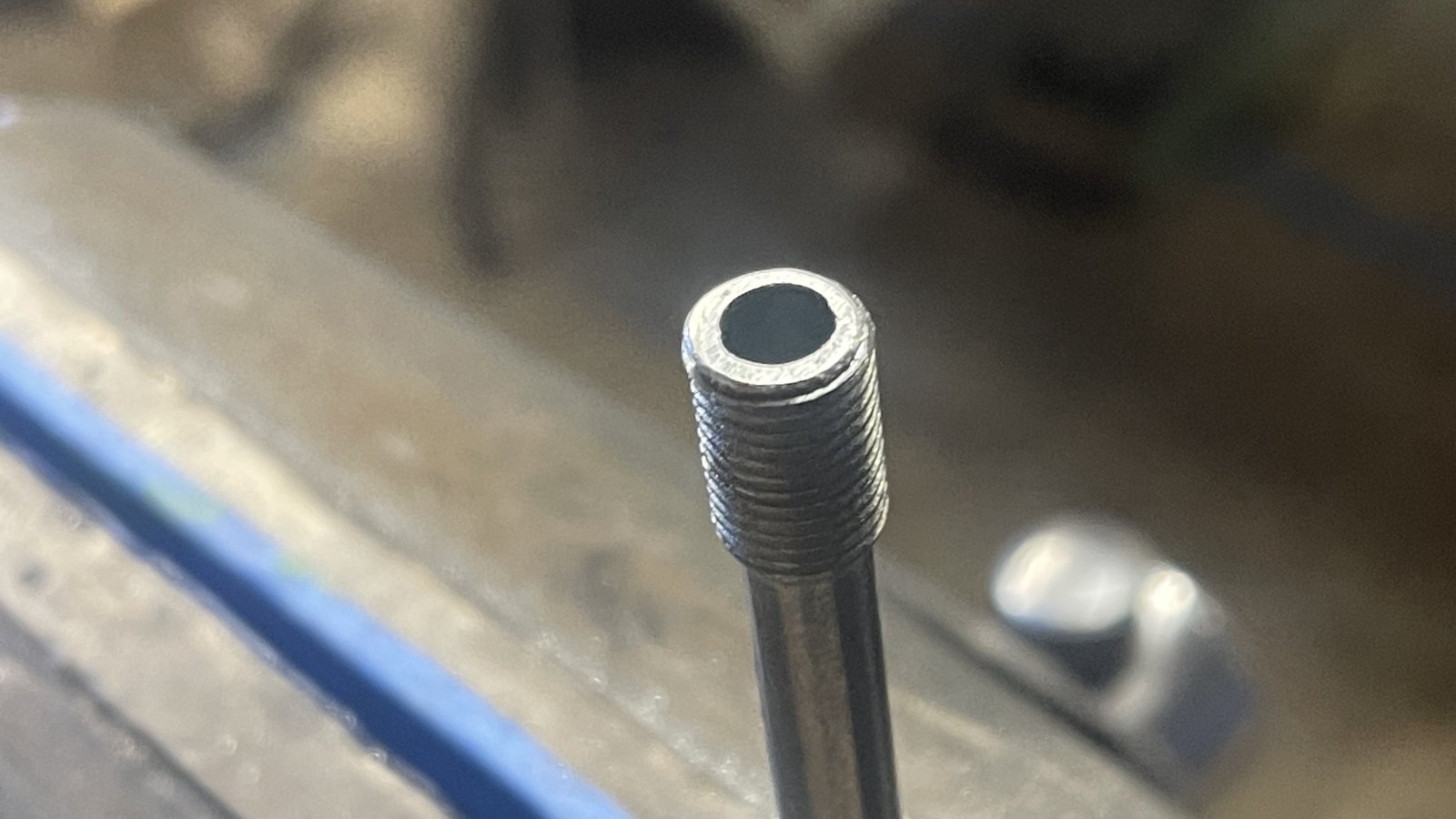

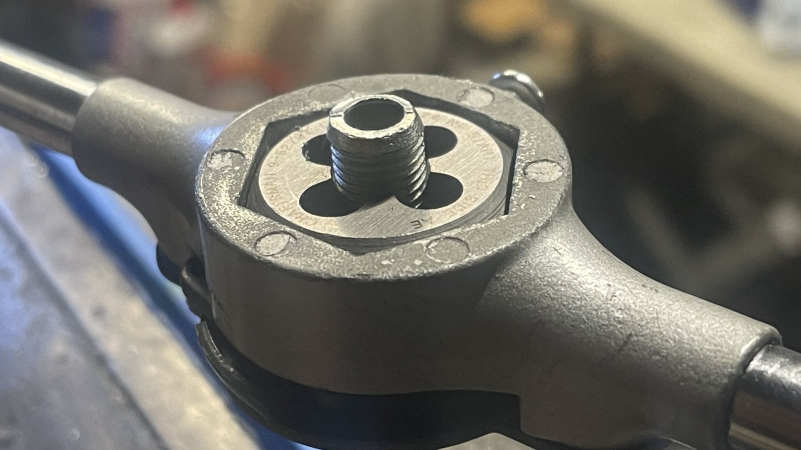

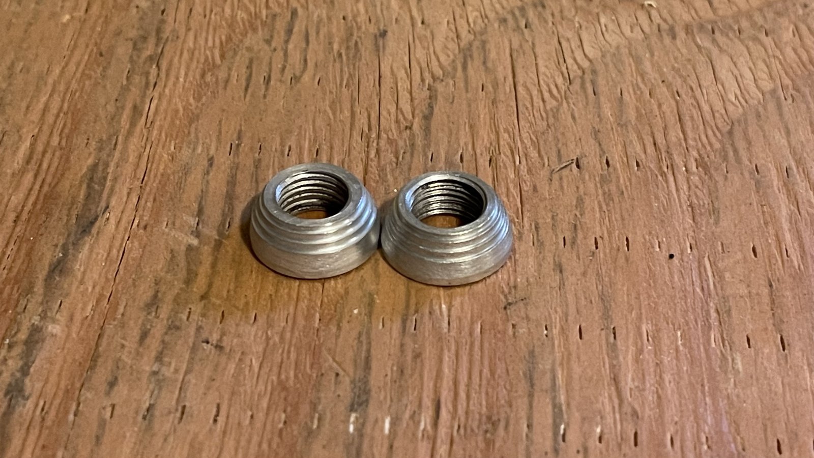

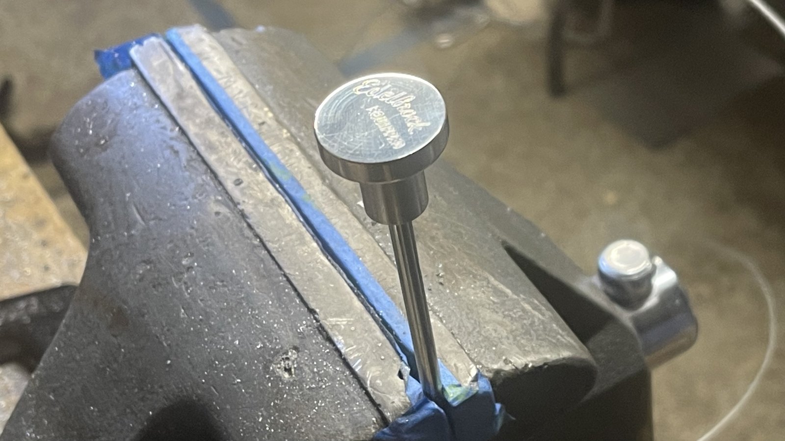

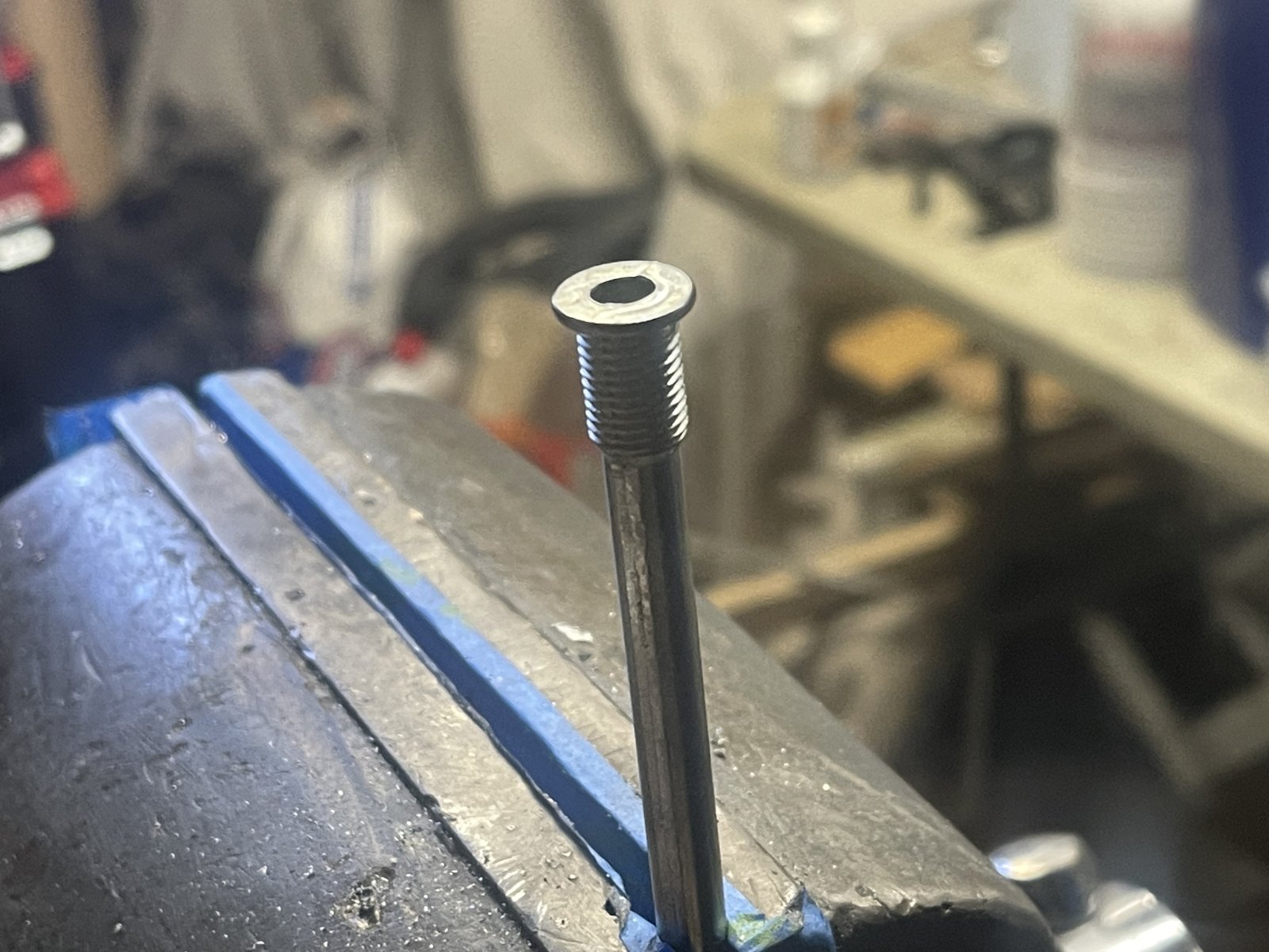

    One of the things I can post on is control cables. To accomplish what I have in mind, I’ll need 2-3 control cables under the dash. That’s not completely figured out yet, and that’s not important right now!
    Looking around at the various cable options, there’s quite a selection to choose from and quite a price range. I chose to go low-middle of the road, using these Edelbrock choke cables. I need to be able to adapt the cable to my knobs and bezels, and I’ve been successful in doing so in the past. The cool thing about this is you get a neat little “Edelbrock Equipped” knob out of the deal with 10-32 threads to use for something else.

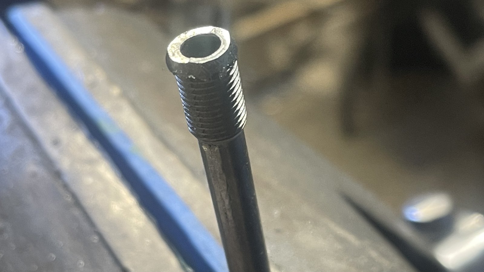

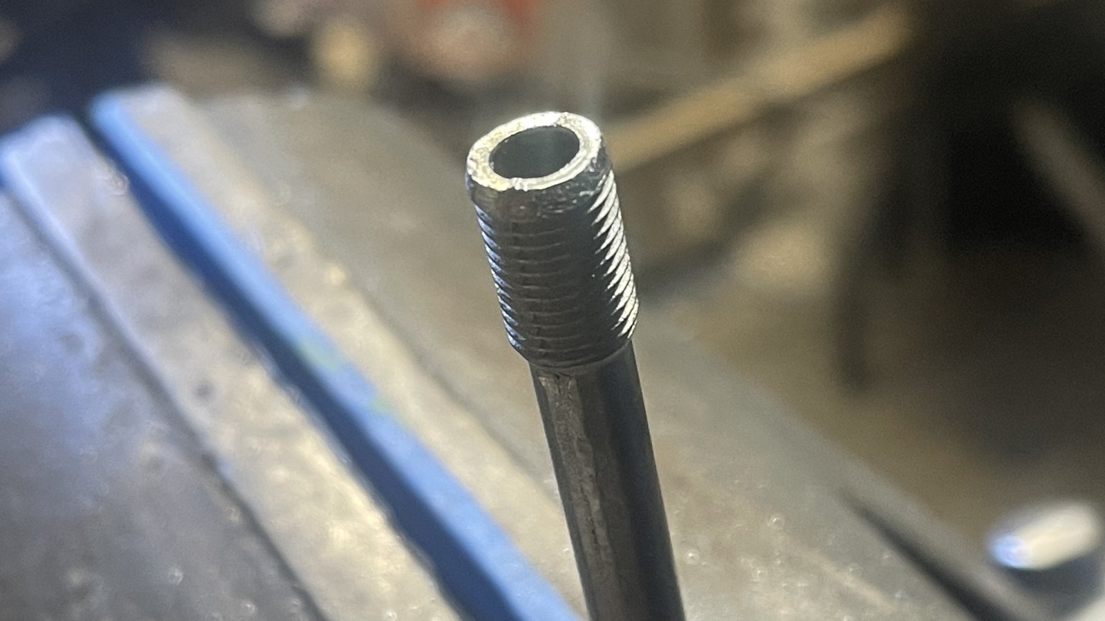

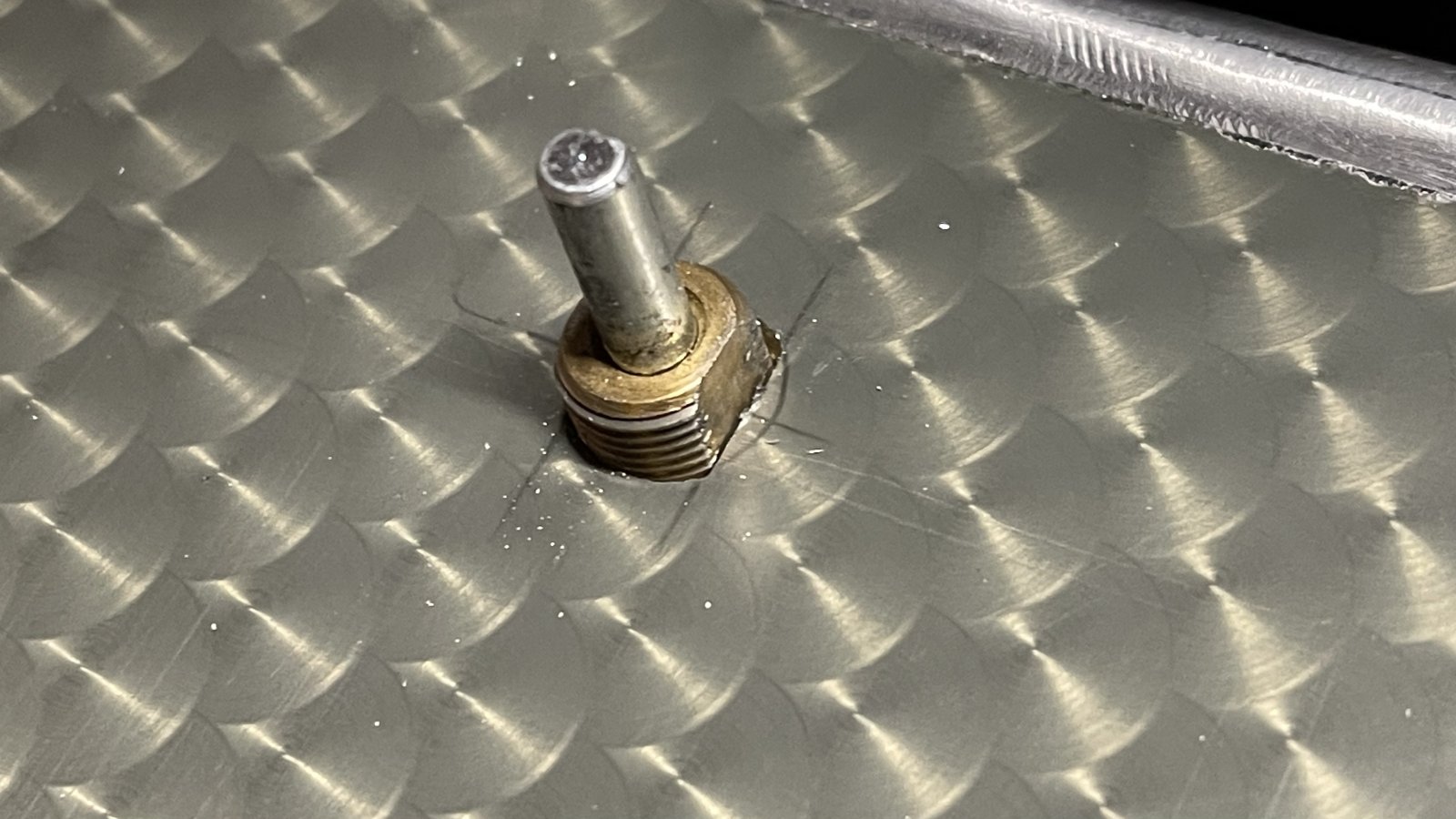

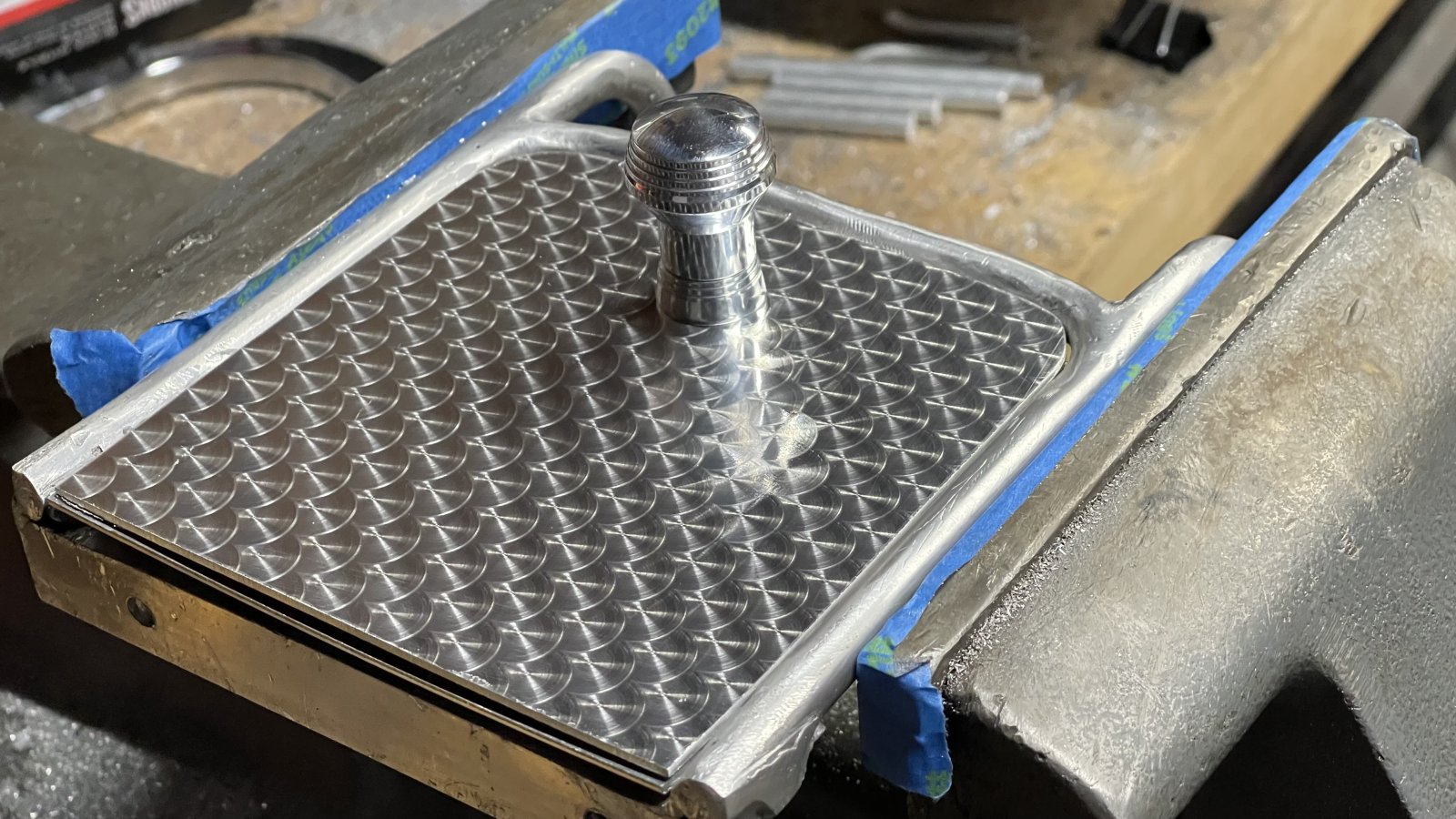

    I start by separating the inner and outer cable, then chuck the inner cable up in my vise. They used red thread locker on these knobs, so put some heat to it, grab ahold with a leather glove and it will thread right off.
    Next, set this aside and chuck the outer sleeve in the vise. Use a sander to roughly knock off the flanged end, then use a file to clean it up. After that, grab a die and thread it from the backside, to clean up the flanged area into a threaded area.
    Now you can use the jam nut as a backer, and use the fancy bezel on the front side, then re-***emble with inner/outer sleeve and new knob. I also took this opportunity to update the sheet metal thickness of small switch/control pod to 1/16”. Now I gotta do the other side, but basically rinse and repeat. You can use this method to other switches if you’re careful- I included a plastic momentary switch that had what I believe to be metric threads that I was able to carefully re-thread to use one of the bezels.

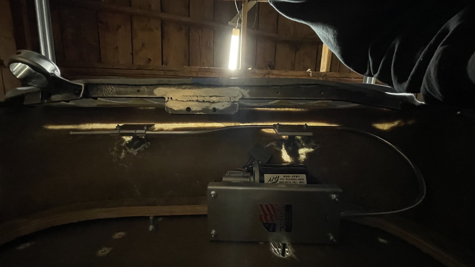

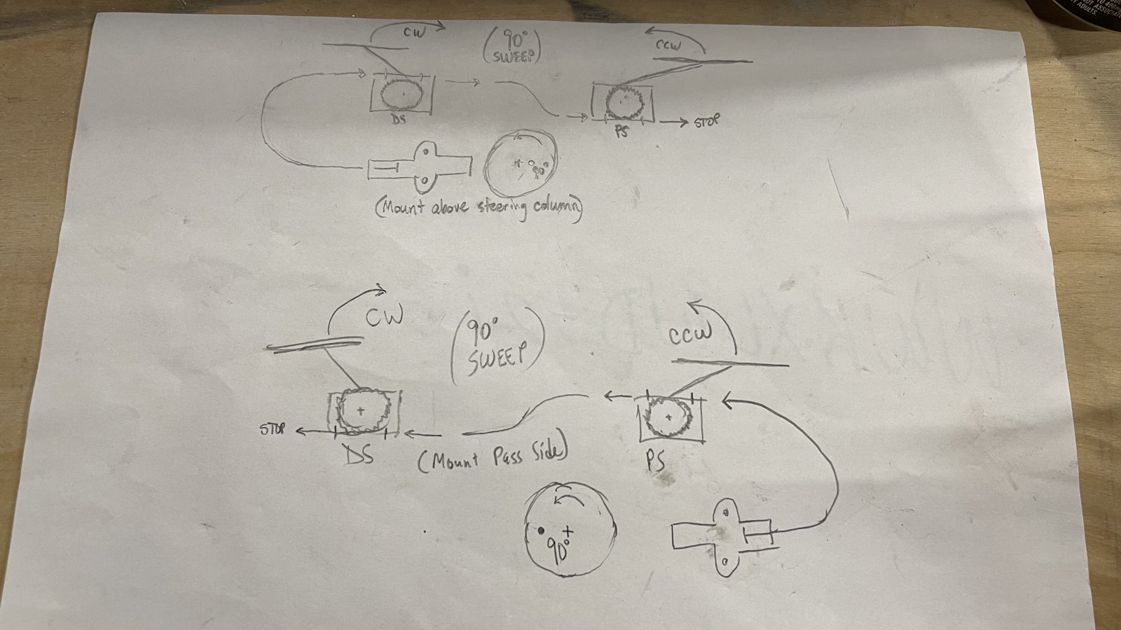

    Well I am happy to report the windshield wiper system is mostly complete - just gotta cut the cable to length and grease everything - don’t wanna do that now with all the sanding dust I foresee in my future.
    I am using a universal cable operated kit from Specialty Power Windows, and I gotta say, minus some confusion in the transmission/linkage diagrams, I am really happy with it (I drew my own diagram after bench running the motor to verify rotation… is it too much to ask to put that in the instructions?… apparently so….)
    Of the several options I explored, this is the most compact, most customizable, and comparable cost. I am able to get a 90* sweep of the wiper blades (kit allows up to 160* sweep, depending on blade length and windshield real estate), which park opposite each other and wipe towards center. I explored mounting the motor on both driver and p***enger side, but opted for p***enger to allow enough room for the throttle pedal. I still have a few things to sort out under the dash, but so far so good.
