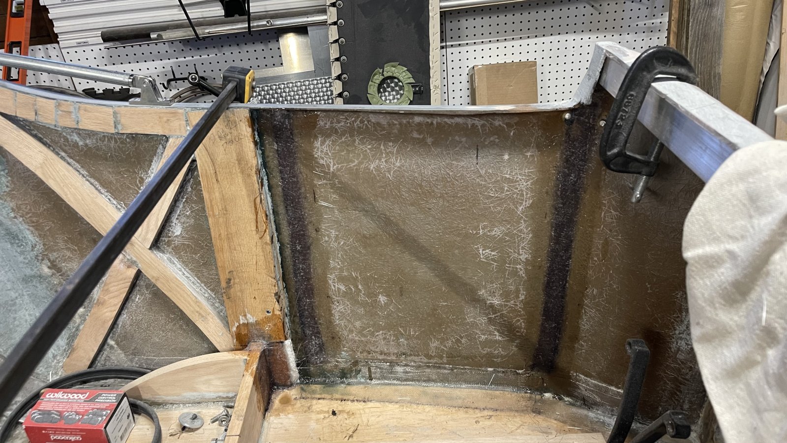

    Treading water further into the deep end with no life guard on duty…. The driver side door reveal is effed up and in the wrong location- going through the windshield post instead of being a couple inches back like the p***enger side. My “plan”, if you want to call it that, is to make a mold/tool to recreate the door reveal from the p***enger side, fill the reveal on the driver side from the inside with fibergl*** matte strips, sand it smooth from the outside, repeat all the door construction steps from p***enger side, then once door is cut out, use the tool to re-create the door reveal on the driver side door. Today, I started with the fibergl*** of the inside, as that will take some time to cure.
    This evening if I haven’t melted from heat, I’ll make the door reveal tool and test it out on something to make sure it’s a working process.

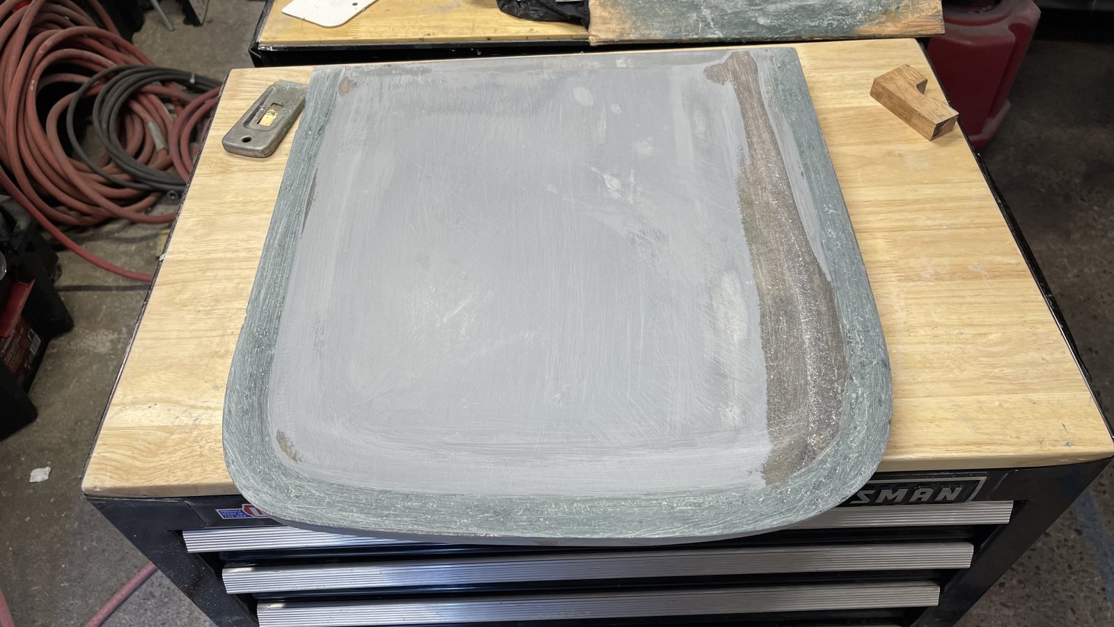

    Made some decent progress considering the temperatures.
    I made a couple templates for the door reveal- seems to be different front to rear so might as well carry that over to the other side.
    I also managed to sand the door reveal smooth, as much as I could anyway. I’ve got some low spots and a couple areas to address- that’s a problem for tomorrow. First pic shows the process of removing via sanding block at the rear reveal. Second pic is about as far as I wanna go.

  20. Tim_with_a_T
    Joined: Apr 30, 2011
    Posts: 1,816
    Tim_with_a_T
    Looks like my door bead tools will work- will probably take a couple sanding sessions to get it perfect, but so far so good!

  24. Tim_with_a_T
    Posts: 1,816
    Tim_with_a_T
    I’ve been off caffeine since March, and significantly reduced my sugar consumption - sugar is my weakness. I basically need to have none of it or all of it- no balance.
    I’m also a metal head, so that’s where the energy comes from. Insomnium and Amon Amarth fueled me to dig out ~1,000 cubic yards of dirt by hand and put down 2,000sq ft of pavers over a 2yr span… Winter’s Gate and Twilight of the Thunder God are two of the greatest albums of all time in my very biased opinion. I know the majority of this audience is my parents’ age or older, so I don’t expect to connect on a musical level lol.
    First round of sanding on the door bead went well. Gonna put on another coat of filler, then take a break to go get some more gloves and cool beverages (sadly sparkling water is as hard as I’m going today haha).

  28. Tim_with_a_T
    Posts: 1,816
    Tim_with_a_T
    Second round of sanding done. Gonna do one more round then call it good enough for now.

  29. Tim_with_a_T
    Posts: 1,816
    Tim_with_a_T
    Will need some more sanding to fit nice, but getting closer:
