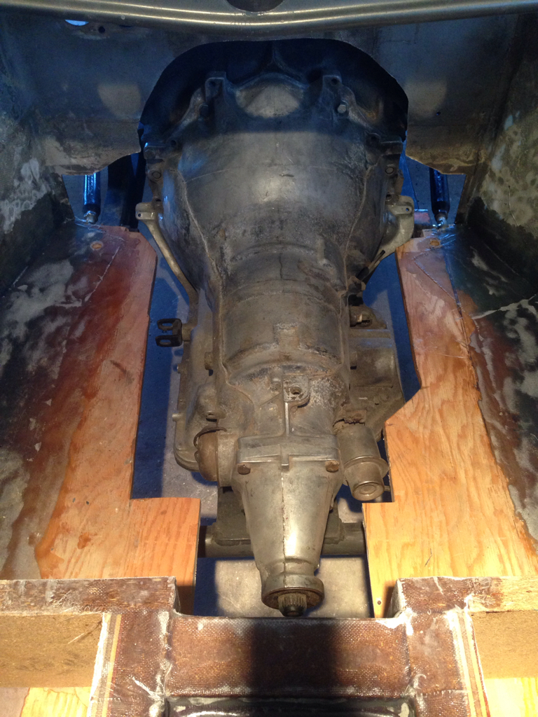

    What did you do for over the transmission? Did you built a brace and then wrap with fibergl***?
    Tim_with_a_T likes this.

    Tim_with_a_T
    Josh,
    Good question! I have been putting this off as the transmission to be used was up in the air. I will be sure to post this as I complete that portion of the build.
  19. Josh rosaaen
    Joined: Jan 23, 2016
    Posts: 16
    Josh rosaaen
    Mines in the same position not sure if I am going to use oak 1by to frame around then wrap or what yet.
  20. Tim_with_a_T
    Joined: Apr 30, 2011
    Posts: 1,816
    Tim_with_a_T
    What I was planning to do is lay some s**** carpet over the trans loop down so the glue side is up. Wax the **** out of it so the resin won't stick, then lay the gl*** mat over that. It gives you a clearance barrier between the trans and the tunnel, and it's pretty simple to lay up. I learned that little nugget of knowledge from Kiwi Tinbender on here. Thanks Paul!

  21. Josh rosaaen
    Posts: 16
    Josh rosaaen
    Sounds good I may have to try that would like to save as much floor room as possible

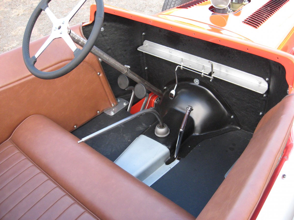

  24. Marty Strode
    Joined: Apr 28, 2011
    Posts: 9,850
    Marty Strode
    Tim,
    On your trans cover, this is how I did mine, I wanted it to be removable, and did it in 2 sections. The rear section is 18 ga steel, a friend of mine is a master with fibergl***, built the front section, to give me maximum room around the pedals. IMG_0756.JPG

  25. 2OLD2FAST
    Joined: Feb 3, 2010
    Posts: 6,067
    2OLD2FAST
    from illinois
    A couple layers of 1/2" carpet foam wrapped w/ tape [I like the 2" clear packing tape] makes a good reasonably smooth form for the trans. tunnel..

  28. Josh rosaaen
    Posts: 16
    Josh rosaaen
    I did the foam wrap just waxed it good. Worked great did two layers got the body off and and foam pulled off. Going to run another layer on top and one on bottom.
