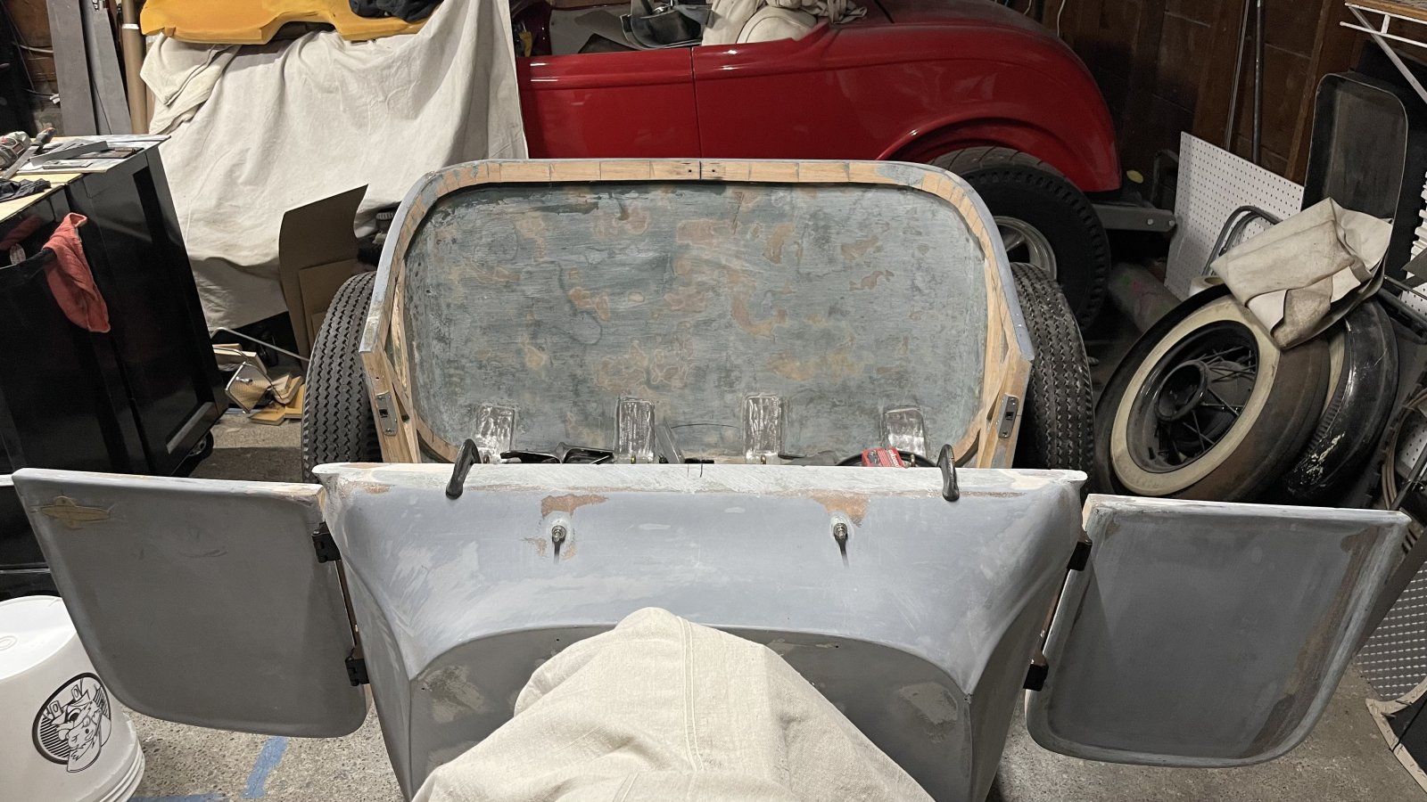

    Got both doors fitting really nice, but for some reason my striker pins on both sides need to be lower to work smoothly. I’ll take a look at that early this week. Overall a pretty productive weekend!

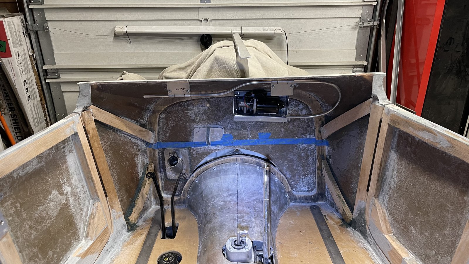

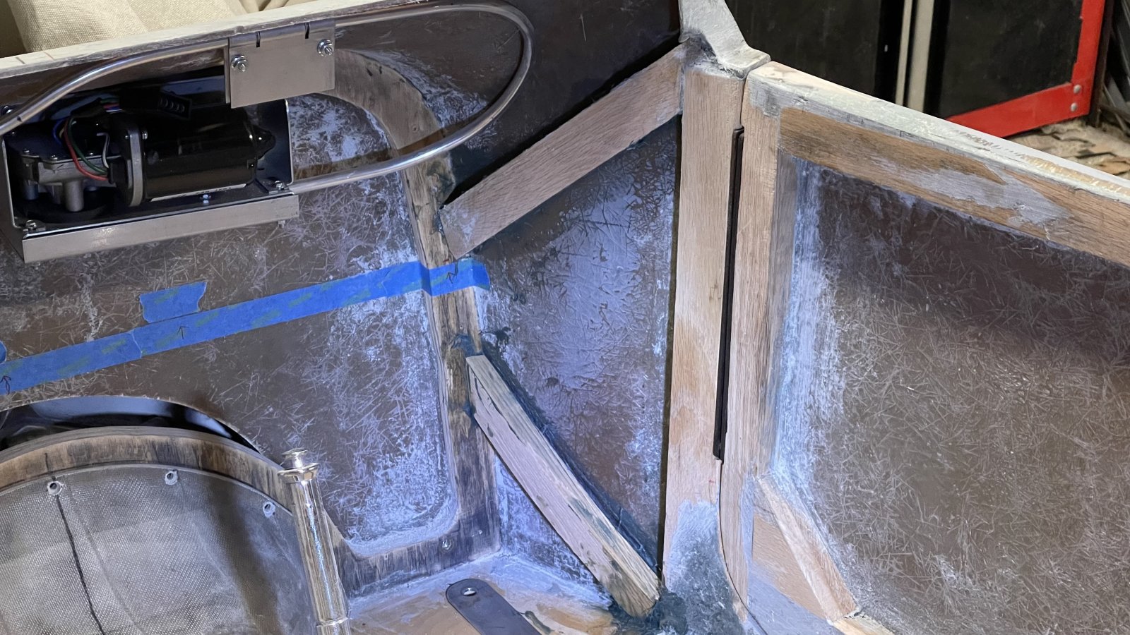

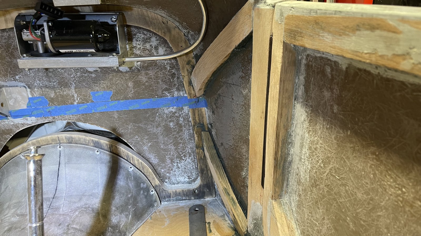

    Update time. Been fiddling around with some bits and pieces not worthy of pictures yet, but I did manage to get the cowl nice and braced up by making some diagonal braces from door hinge pillar to firewall. You’d be surprised how much more solid the car feels with those little pieces glued in. The lower ones will serve as mounting locations for the toe boards, when I get that far. Lots to do still!

    I know it's overkill, but it saved me from having to learn: a-woodworking, b-fibergl***ing, and c-how to get that stuff off of my hands, tools, floor, workbench, etc.

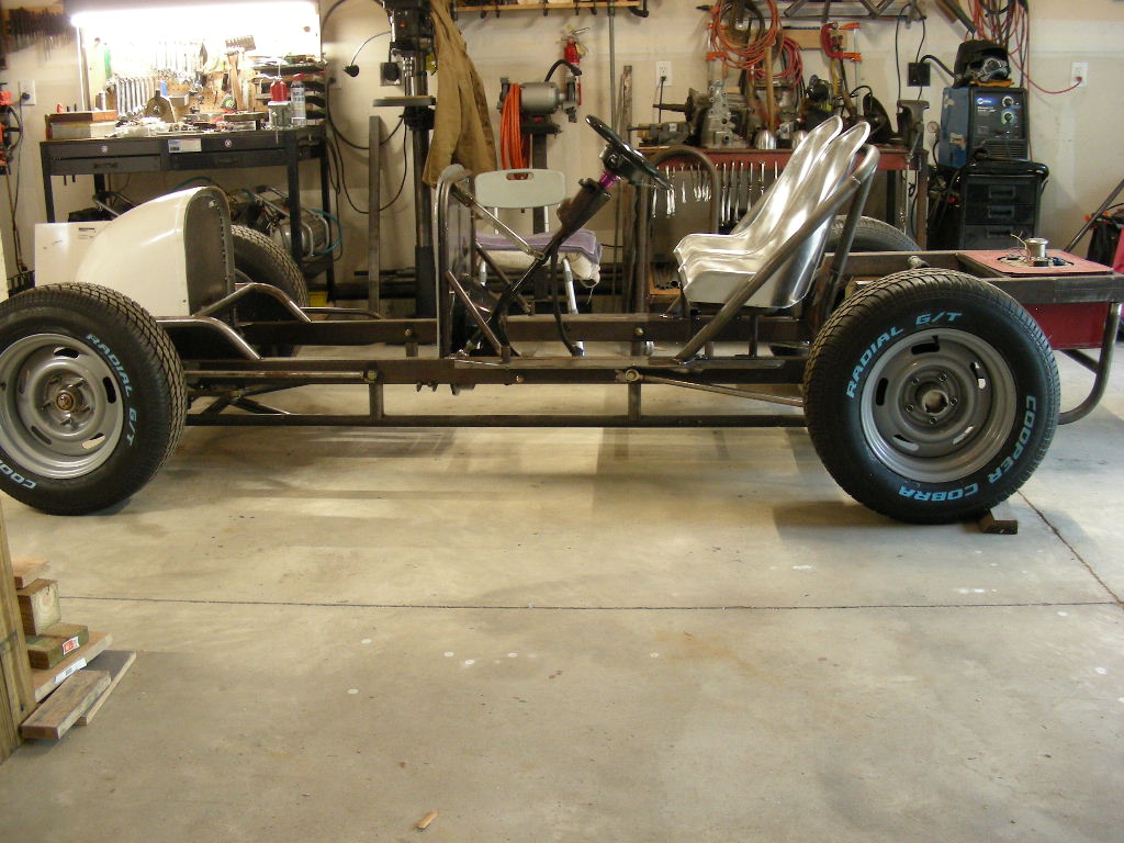

    DSCN1441.JPG The firewall is sandwiched between 2---1/4 inch thick aluminum tooling plates, and supported by the 1 inch tubing bracing. And I plaigerized Marty's floor flange concept to bolt the bottom of the body to. There's no flex in any of the body. And yes, I am an engineer who overthinks everything! And I make myself more work because of it!

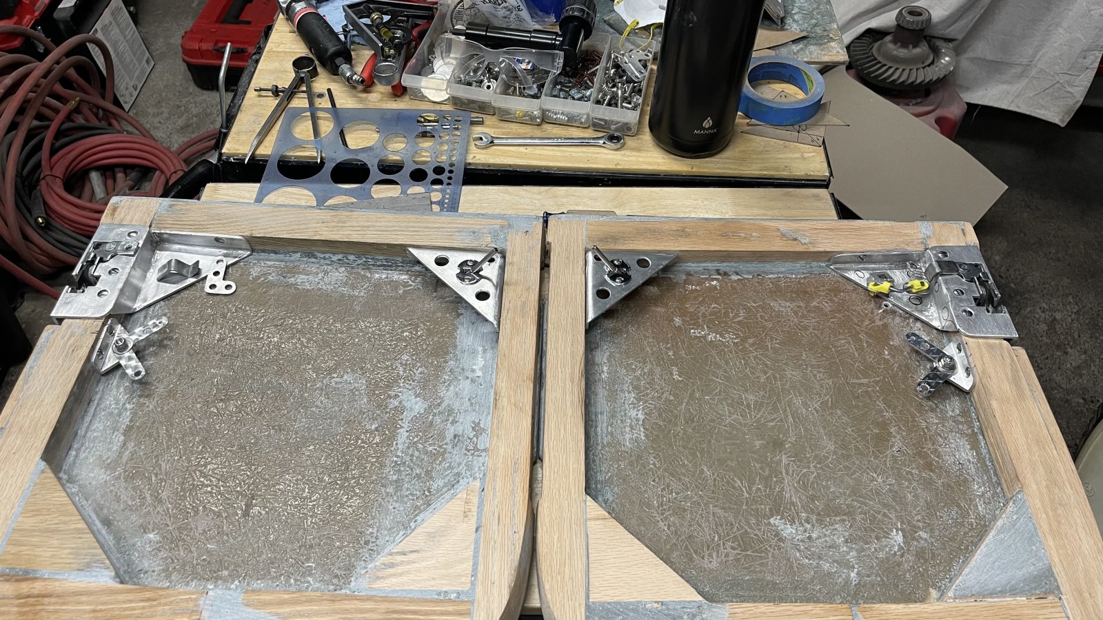

    Time for a text update, mainly to motivate myself to get moving again, partially to update you guys as I was reading the "build thread etiquette" thread, and that seemed to be a common request/complaint. Last weekend, I spent some time fumbling about, working to get the door latch/striker pin ***embly more compact. It's a balancing act as each piece of the ***embly needs to be in a specific location, and held to a pretty tight tolerance, to accomplish what I'm hoping to achieve. I ended up re-making the striker pin bracket on the p***enger side 4x.... finally got to where I was happy with that. So far I'm on the second p***enger side door latch bracket, and I'll likely need to move onto the third as it's not quite what it needs to be. I'll post an update, with progress pictures and thought process, once there's something to show off.

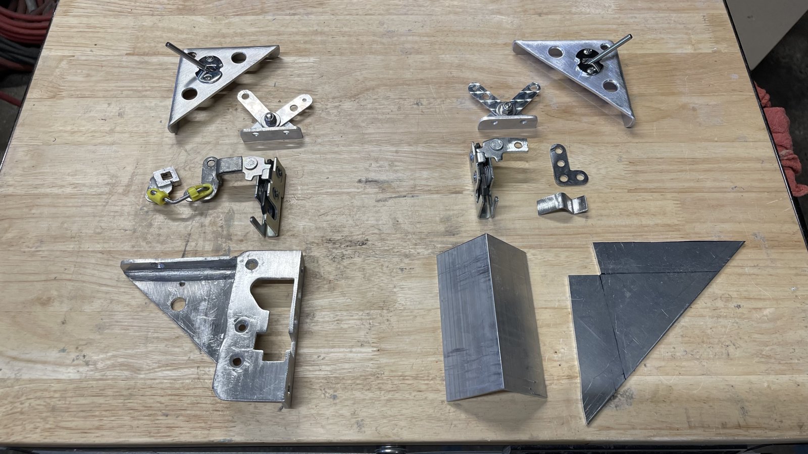

    I had to run some errands today and roll around under the daily for awhile, but I managed to get a few things done. I had a goal of getting all the driver’s side brackets and linkage cut out- I got close but I’ll have to pick it up again tomorrow.
