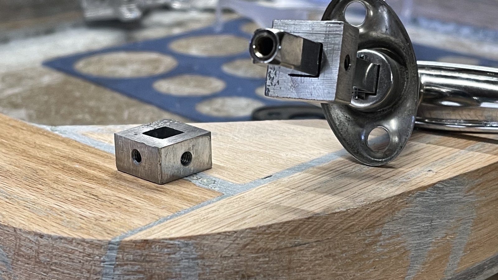

    Sabbatical, Day seven.

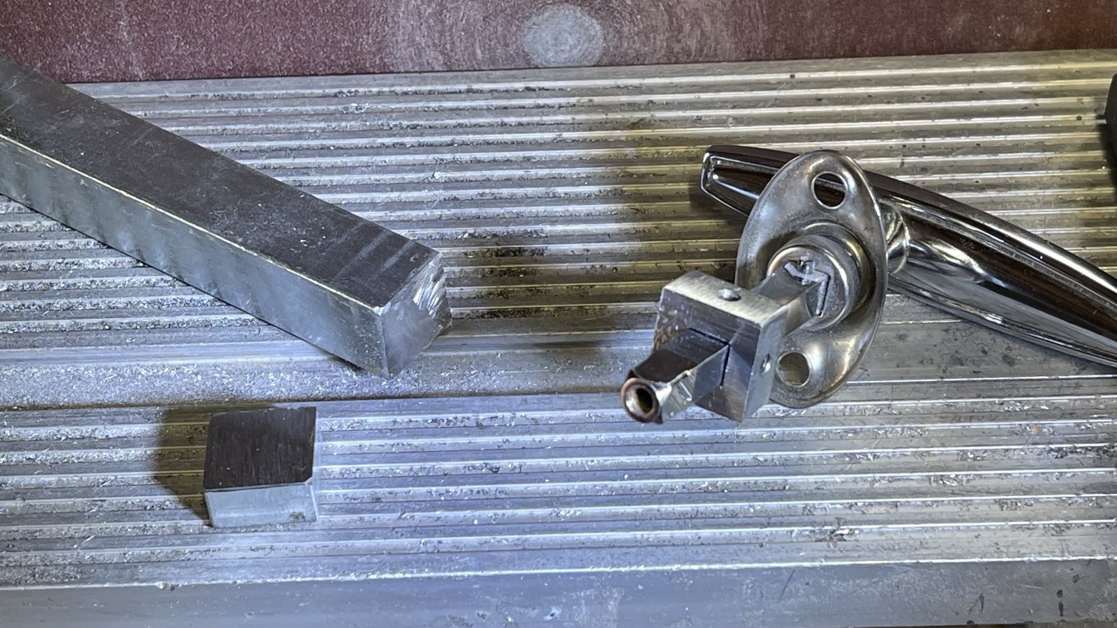

    Today is gonna be a short update as my girlfriend will be in town for the weekend in about 10 mins- leaving me enough time to make a quick update and take a shower.

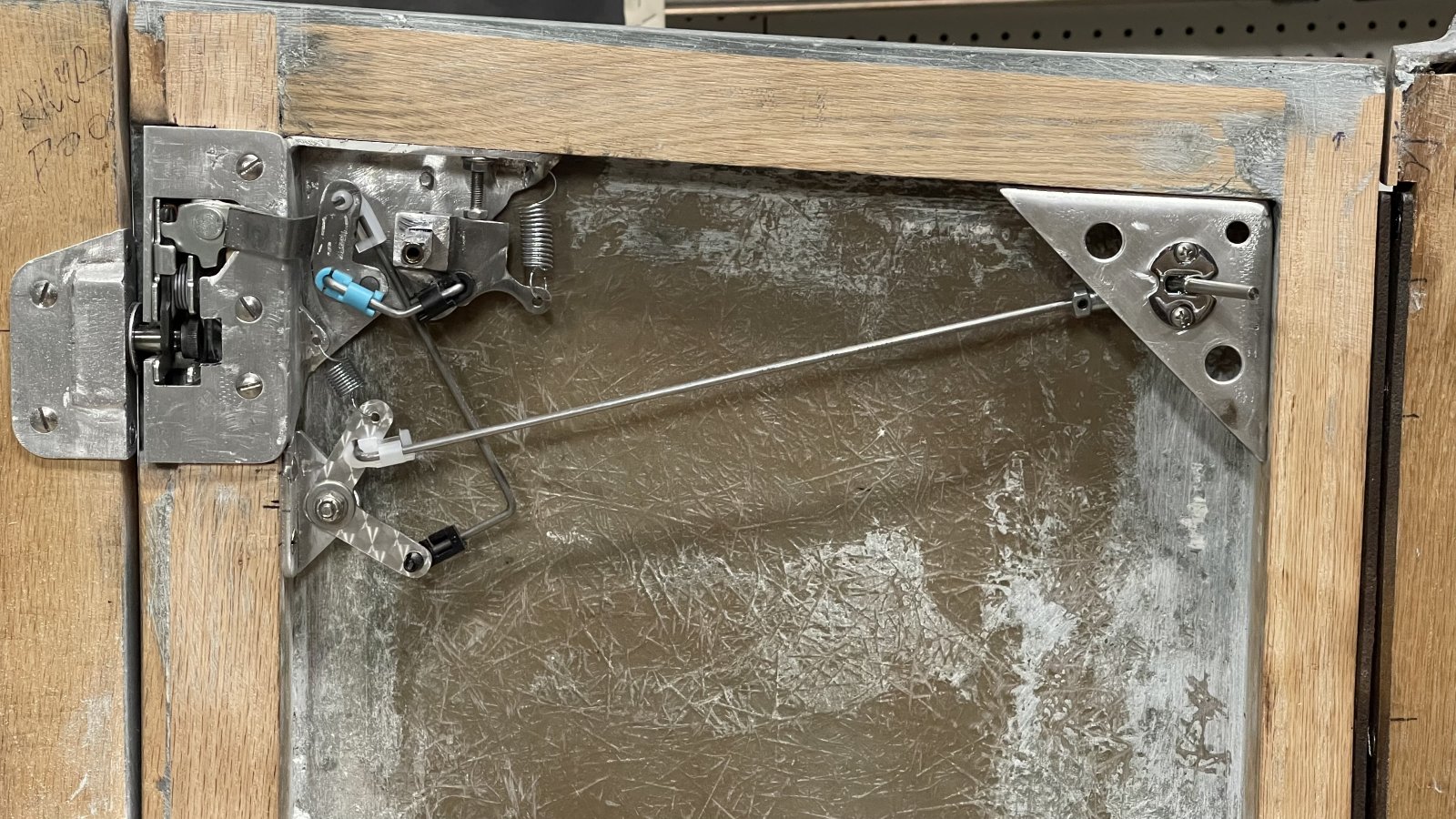

    After getting the door handle installed and watch it function, I saw a need to add some sort of return spring and return stop, to return and keep the handle in the neutral position. This should serve as a return spring for the whole system, hopefully anyway. So, I set about re-working the square shaft lever arm, incorporating a stop and return spring provision. If you squint, you can see what I’m going for. As an aside, today my brackets end up looking like dinosaurs instead of pee pees- not sure if that’s good or bad. Just an observation.

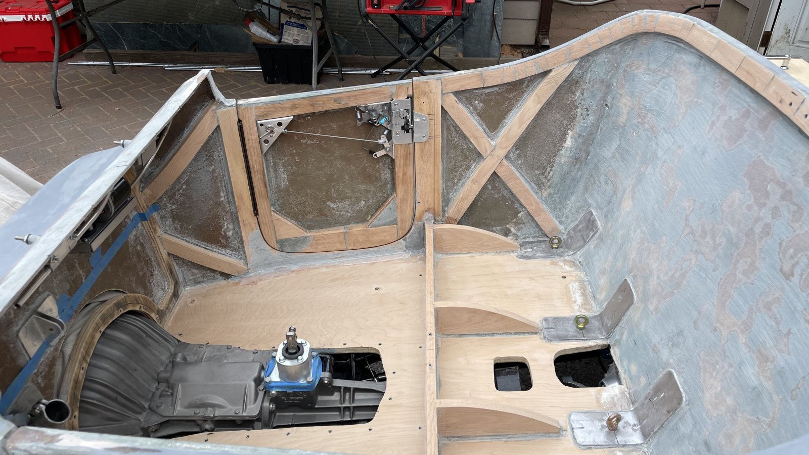

    Sabbatical, Day nine.

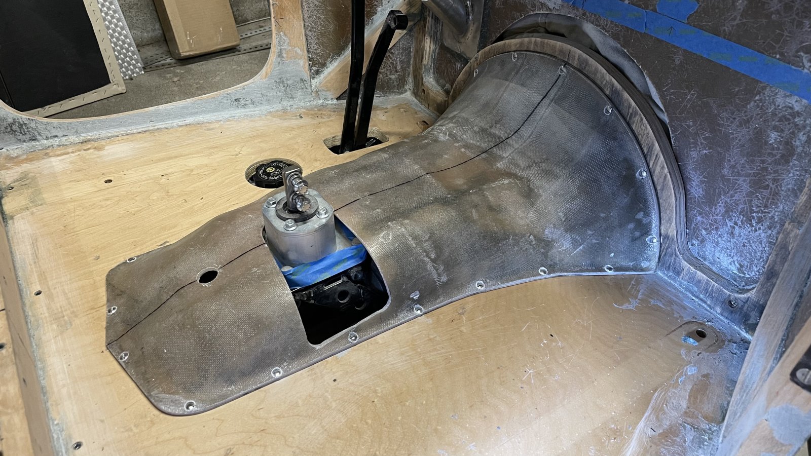

    Got the daily back together, but boy was that a fight. Took a break this afternoon and got back on the T this evening. I was able to incorporate the return spring and return stop on the p***enger door handle, and it works GREAT using the exterior handle- interior handle it’s a bit of a fight overcoming the spring. I’m gonna try a couple things tomorrow, but for now, pictures.

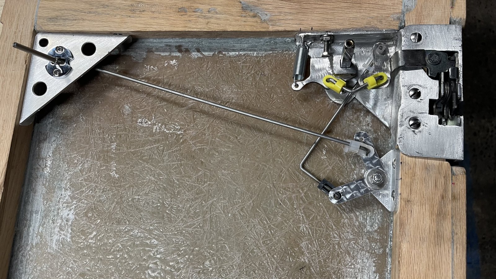

  6. Tim_with_a_T
    Joined: Apr 30, 2011
    Posts: 1,816
    Tim_with_a_T

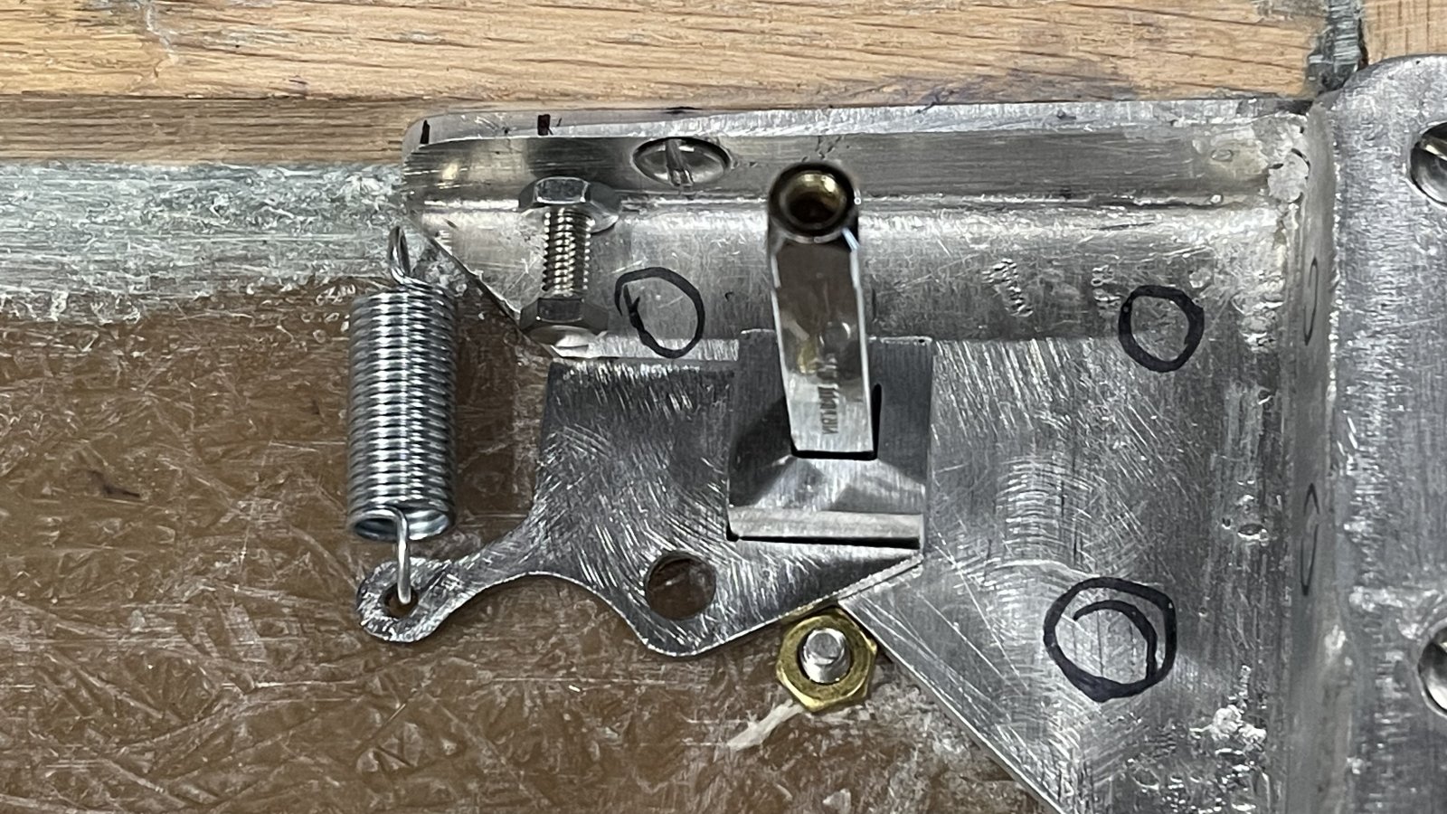

    Sabbatical, Day ten.
    Today I focused on getting the driver side door caught up to the p***enger side. I also managed to tweak a softer return spring so the handle returns to its stop when either inside or outside opening is used. I’m getting close to being able to move past the doors, which is a good feeling lol.
    BigJoeArt, swade41, AndersF and 8 others like this.

  9. Tim_with_a_T
    Posts: 1,816
    Tim_with_a_T

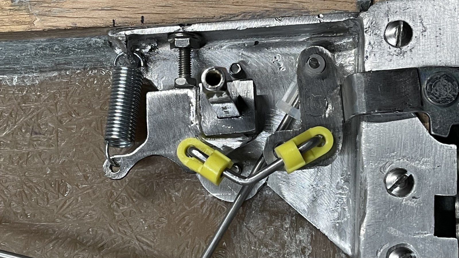

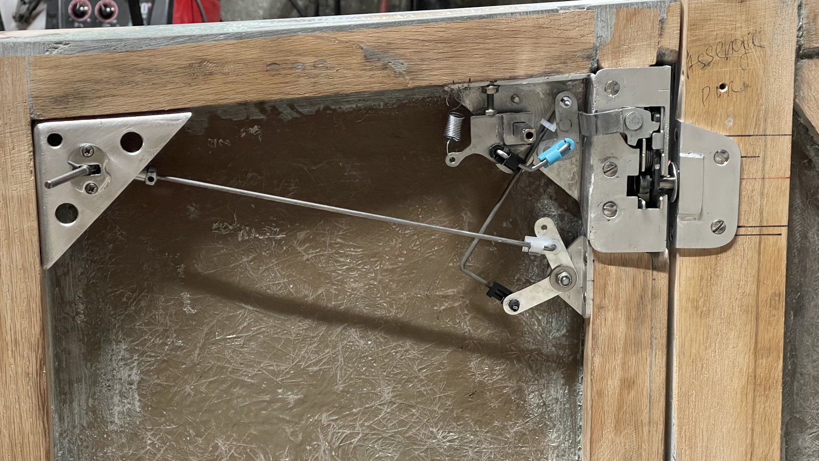

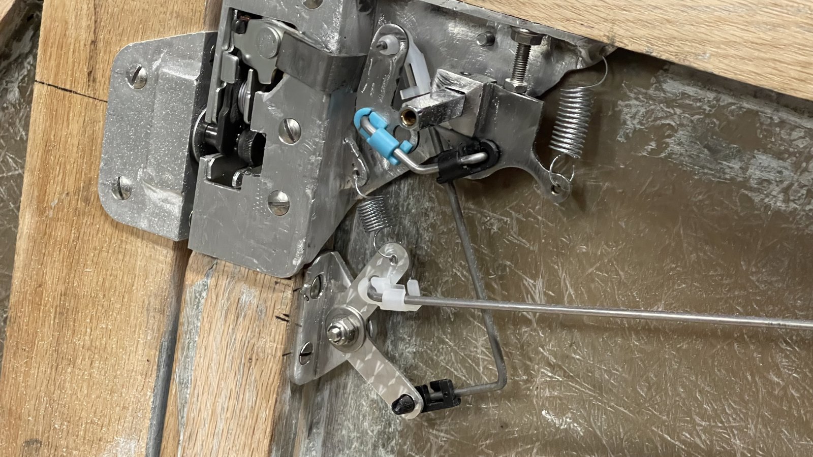

    Sabbatical, Day eleven.

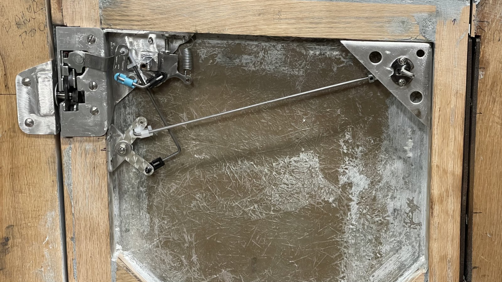

    I finished the door linkage for both doors, incorporating a second return spring to keep the interior door pull linkage in its neutral position as well. I believe I can move on from the doors for now, although I will have some work ahead of me figuring out door gaps while also adding a layer of fibergl*** to the jambs and to the doors as well, to seal in the wood and add strength. First though, I will be working on sealing up the floor, as that finished surface will be the mounting surface for the steel structure I have in mind. That’s what I’m planning on getting into tomorrow.
    Here’s a short video of the door linkage in action, and a couple pictures of the return springs and stop.

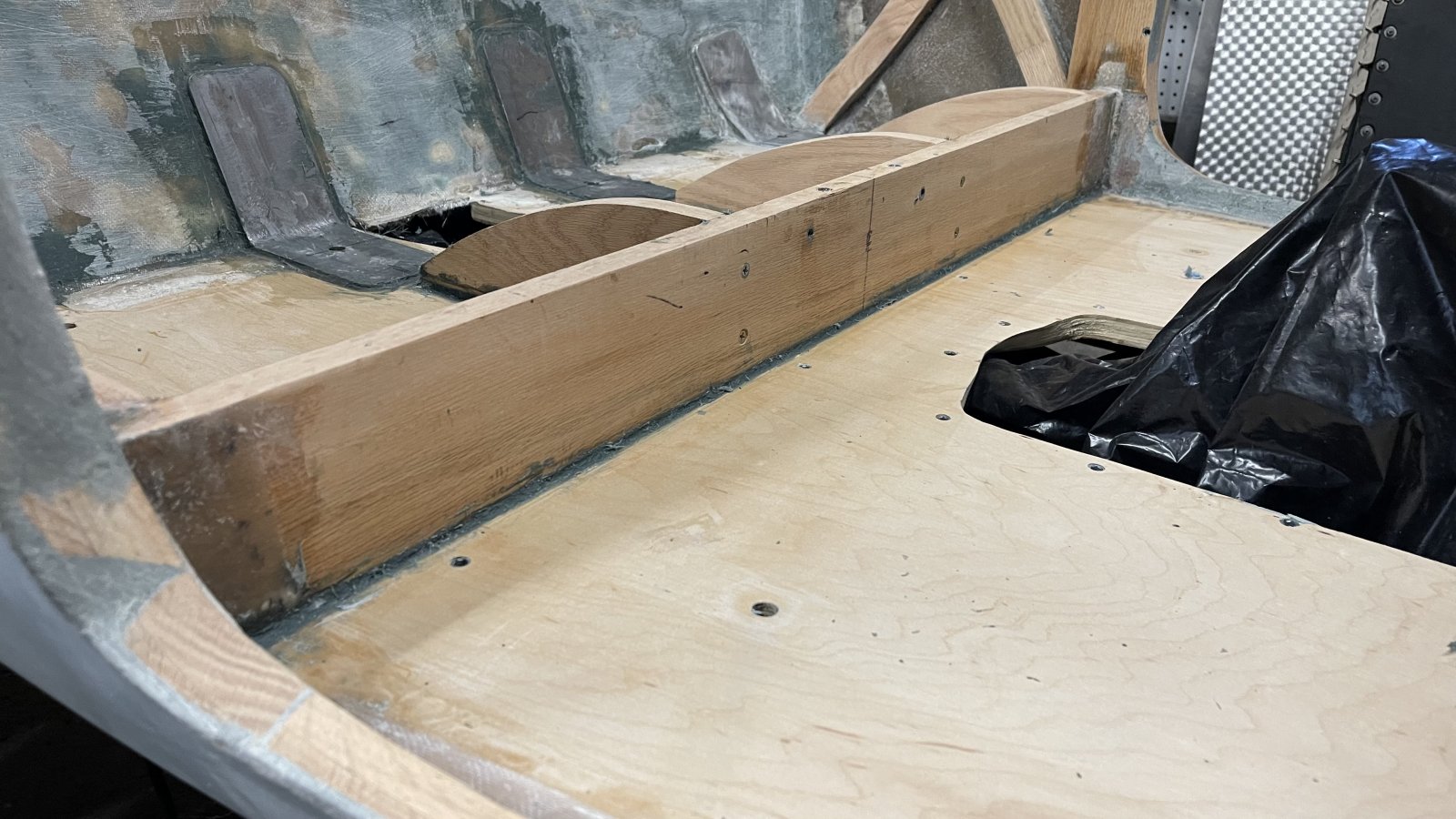

  16. Tim_with_a_T
    Posts: 1,816
    Tim_with_a_T

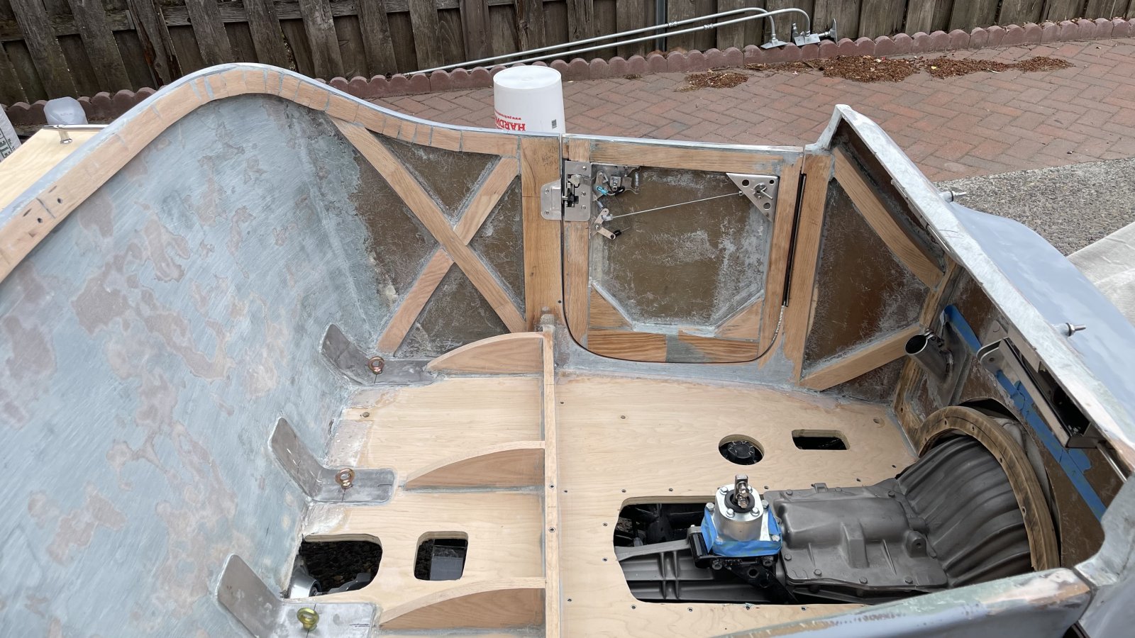

    Sabbatical, Day twelve.

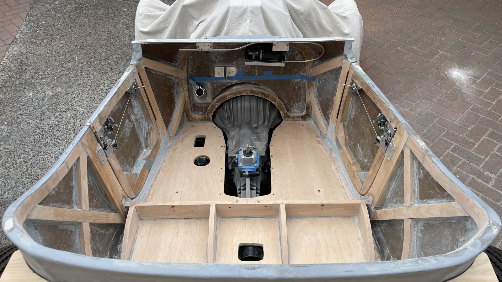

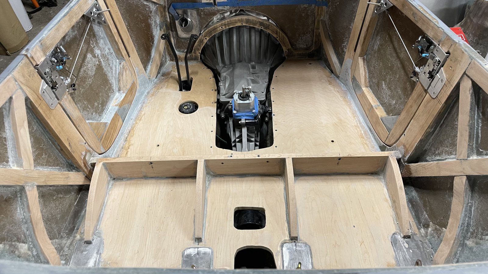

    Today I started prepping for sealing up the wood with fibergl***.
    The first thing I had to do was to carefully cut out the steel straps I was using as giant washers holding the body to the frame. I’m planning to add them back in after the fibergl*** is done, with a few modifications.
    The second thing I did was to measure, drill, and install threaded inserts to hold the transmission tunnel to the floor.
    The last thing I did was push the car out in the driveway and begin to sand all the wooden surfaces in prep for fibergl***. I ran out of daylight and still have some more to go, but so far so good.
    I took an afternoon break that ended up being a short nap- didn’t want to be up till 3am so I walked down to my favorite spot on the Columbia (favorite because of convenience mostly). On the walk down, I get to p*** by the Washington school for the blind, a beautiful brick building with art deco masonry details above the windows and door frames. After that, it’s down Officer’s row, a historic street of homes from the mid 1800s. Further down, a cut through Fort Vancouver, an old trading post from the early settlers. After that, a sketchy walk through a tunnel under some railroad tracks and boom- you’re at the shore of the Columbia, with Portland, Oregon across the bridge. I enjoy doing this walk at night because of the creatures that come out- both human and animal. I’ve seen rac****s, possums, owls, bats, and a regular otter sighting. During the day, I’ve seen bald eagles, fish jumping, snakes, and a beehive in the trunk of a rotting tree.
    Tonight I saw the beehive- they were all grouped together keeping warm. I saw the bats skimming the water and flying erratically through the sky in the moonlight, and I saw the otter! The otter is the perfect way to close out the night. He/she likes to hug the shore on the Washington side, somewhere around 10-11p heading east, and 2-3a heading back west. At least from what I’ve observed.
    Now the sketchy 3 mile walk back through the tunnel, past the fort, over to Pearson field, an active airstrip dating back to 1905, and historic use during WW1 and WW2, through the old cemetery, and back home. Back at it again tomorrow!
    BigJoeArt, Outback, rjgideon and 11 others like this.

  19. Tim_with_a_T
    Posts: 1,816
    Tim_with_a_T
    Sabbatical, Day thirteen.
    I spent the day sanding, mostly. My lower back is on fire, so that ate into the productivity a little bit. After dinner, I came back out and put the front suspension back together. At some point when I’m more motivated, I need to touch up the polishing on the hardware. I hate polishing nuts and bolts, but the difference is noticeable enough to be worth it. Tomorrow I hope to get into some fibergl***ing, although I’m still working out the order of operations in my head.

    Do not believe you need to cover all the wood in fibergl***. You already have it supporting the body. Doubt will sit out in rain. I vote for wood sealer paint & be done. Next interior

    I would use Waterlox to seal all of the wood, they do have a marine sealer that would definitely protect it! I don't have any connection with Waterlox other than I used it on our butcher block countertops and it works better than I expected.

  22. Tim_with_a_T
    Posts: 1,816
    Tim_with_a_T
    I hear what you guys are saying, but for example- when I bonded the floor to the body, that was the first thing that gave the body any resemblance of structure. When my dad and I tabbed the floor in, m***ive improvement in stiffness. So I intend to tab in the structural members and gl*** in the floor, for both strength and durability. Remember- I live in the PNW where it rains alllllllll the time. I’m planning on seeing some drizzly days and don’t want to be coming back later to cut out rotten wood. I have no doubt that a wood sealant product would prevent that, but so will the fibergl***, with an added benefit of additional strength. Heading out shortly to get started.

    A lot of racing/cruising sailboats were built with fibergl*** hulls and then wooden bulkheads held in place with fibergl*** tabs and fillets made from epoxy with micro balloon’s and/or chopped gl*** fiber to the consistency of peanut ****er and shaped with wooden tongue depressors. It added a tremendous amount of strength and also resistance from twist and water resistance into the bulkheads. Important to squeegee out resin for max strength and minimize weight gain. Following this thread I’m sure it will be done right as well as look good.

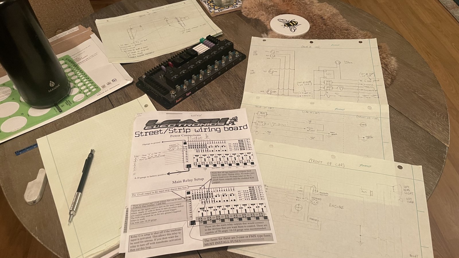

    Sabbatical, Day fifteen.
    I brought some homework with me up to Olympia. At one time, I started scheming out the wiring diagram for this car, and after the first p***, decided I needed a way to simplify controls. I ended up stumbling across a Leash Electronics wiring board, which should make things a lot more compact and a lot simpler. Today I just started to wrap my head around the various electrical loads and comparing my old notes/drawings to the Leash paperwork. So far, I like what I see! When I feel more confident about what I’m planning to do, I’ll post in more detail.

    from Alabama
    Ron Francis has great wiring packages. Not necessarily cheap but very high quan***y. For your roadster you probably need less circuits then your probably planning. They also offer a printed catalog which is a rarity these days. The catalog in addition to the products they sell has a lot of good information about do’s and don’t and answers a lot of questions and is worth reading. They can be reached and request catalog at: https://www.ronfrancis.com/ I used one of there packages. Very easy to install with a lot of wire, proper gauge, each wire has ID and good instructions as well as techs to answer questions. I’m rather electrically challenged so it was a wise choice for me. Your mileage may vary depending on electrical knowledge.
