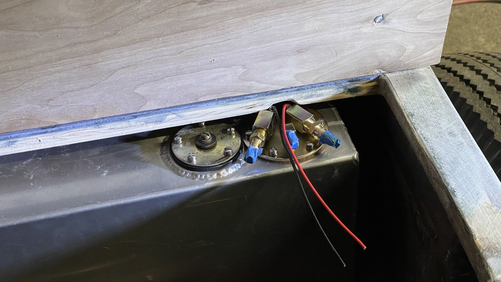

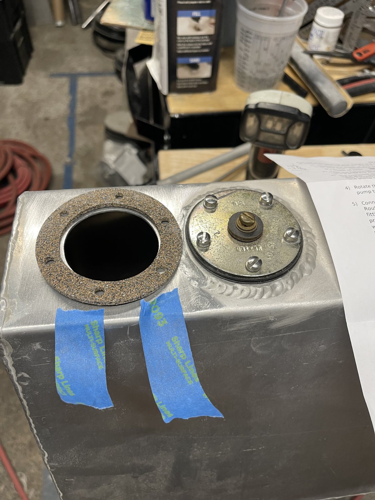

    One of the things I didn’t like and wanted to change was the frame mounted fuel pump. The 880 Vortec blocks are not drilled for a mechanical fuel pump, so I’m stuck with some sort of electric pump. At one time I had purchased a Holley Sniper in-tank pump intended for carbureted applications, but it was physically too big to make it work, and as per usual I missed the return window, so I kinda lost some steam in this part of the project. Btw if anyone needs that pump setup, I’ll make you a deal lol.
    Anyway, at the Portland swap meet this year, I picked up a Tanks fuel tank for the ‘32, and it has provisions for an in-tank pump. I was looking at it and noticing it is physically much smaller than the Holley one, so I thought hmmmm… if I gotta buy it for the ‘32 anyway, might as well see if I can make it work for the T. So I bought the GPA-4, which comes with a 255lph Walbro (I believe) pump. I’ll swap out my regulator for a return style (which I already bought quite awhile ago), and should be good to go. I like this better since it will be easier to swap out, should last longer, should help keep the fuel cool, and should be quieter.
    I didn’t take the best pictures, but at one point, there was a weld bung in my tank to the right of the fuel sender (that’s why the wood is notched in the 3rd photo)- after some measurements, I determined I could squeeze the pump in there, so I cut a hole and made it happen. Second picture is before I cut the tubes down. The instructions made it pretty easy to knock out. I’m stoked.

    I run that in-tank Walbro pump in three of my current cars, excellent choice IMO. Correct, it does require a return line the same diameter as the delivery line and a return style regulator.

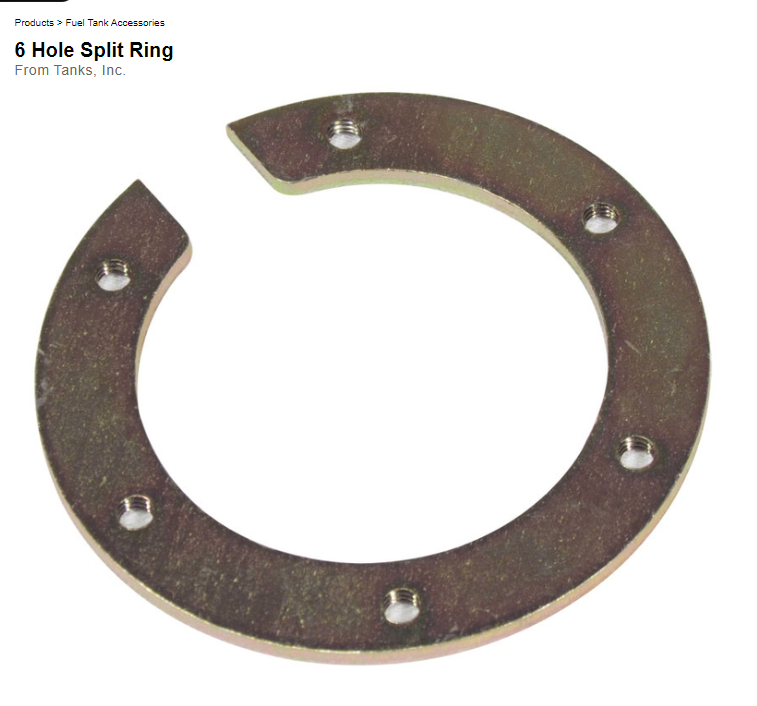

    I believe it will work - it comes with a split ring like shown below - you just slide that into your tank and bolt the ***embly to it. I imagine if you used a return style regulator, set to 6psi, you could fill the front mount tank through the Holley bowls, and the extra just gets byp***ed to the rear tank.

    That ring will be easy to get inside the fuel cell. There's an oval shaped hole for the fuel fill and the ATL installed fuel pickup lines. I can get my hands into it thru that.

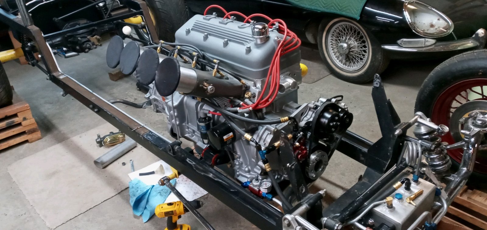

    Mine has a EFI pump in the tank, plumbed up to a byp*** regulator near the injector pump. Then into a small tank at the front to feed the injector pump. It has two Holley float bowls and three return lines for the injection. 1/2 line from tank to regulator, 3/8 return line back to tank.

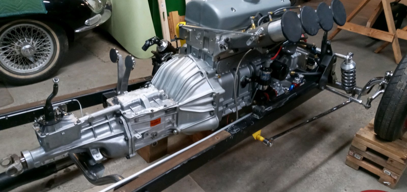

    Not to plug up Tim's thread, but here's a few. I could not find a tank pic. Ch***is pic, you can see the regulator and lines and barely the front tank.
    another pic
    with nose on
  17. Dave G in Gansevoort

    @Flatrod17 very nice. I like the OT one too.

    More about the engine please. Looks very at home in that ch***is and body!
    Tim_with_a_T likes this.
  24. Flatrod17
    Joined: Apr 25, 2017
    Posts: 844
    Flatrod17
    Its just a 3.7 Mercruiser marine engine. The Boss 429 head bolts on, but from there its pretty much all custom. It 242 ci now. There is more on it on The elusive 224/3.7 MerCruiser banger thread starting about page 80.

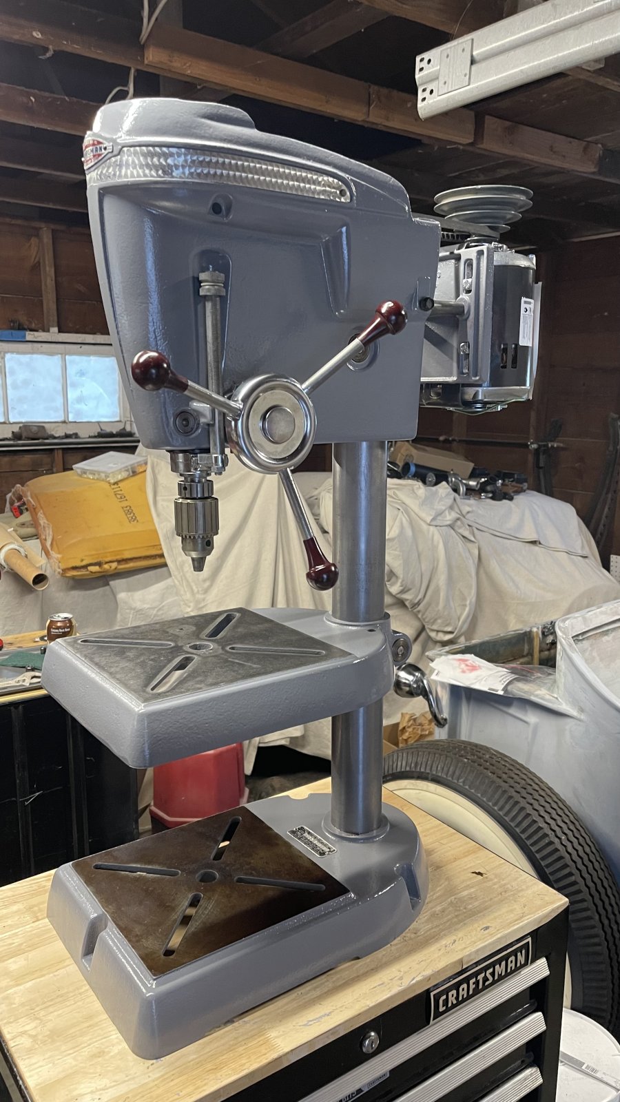

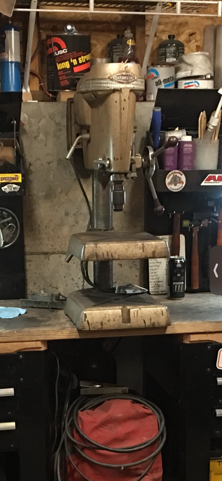

    Been a couple weeks. Got lots going on in the background, but nothing completed enough for a post. Gonna be busy the next week or so doing non-car stuff, so figured I’d at least let you all know I’m still chipping away.

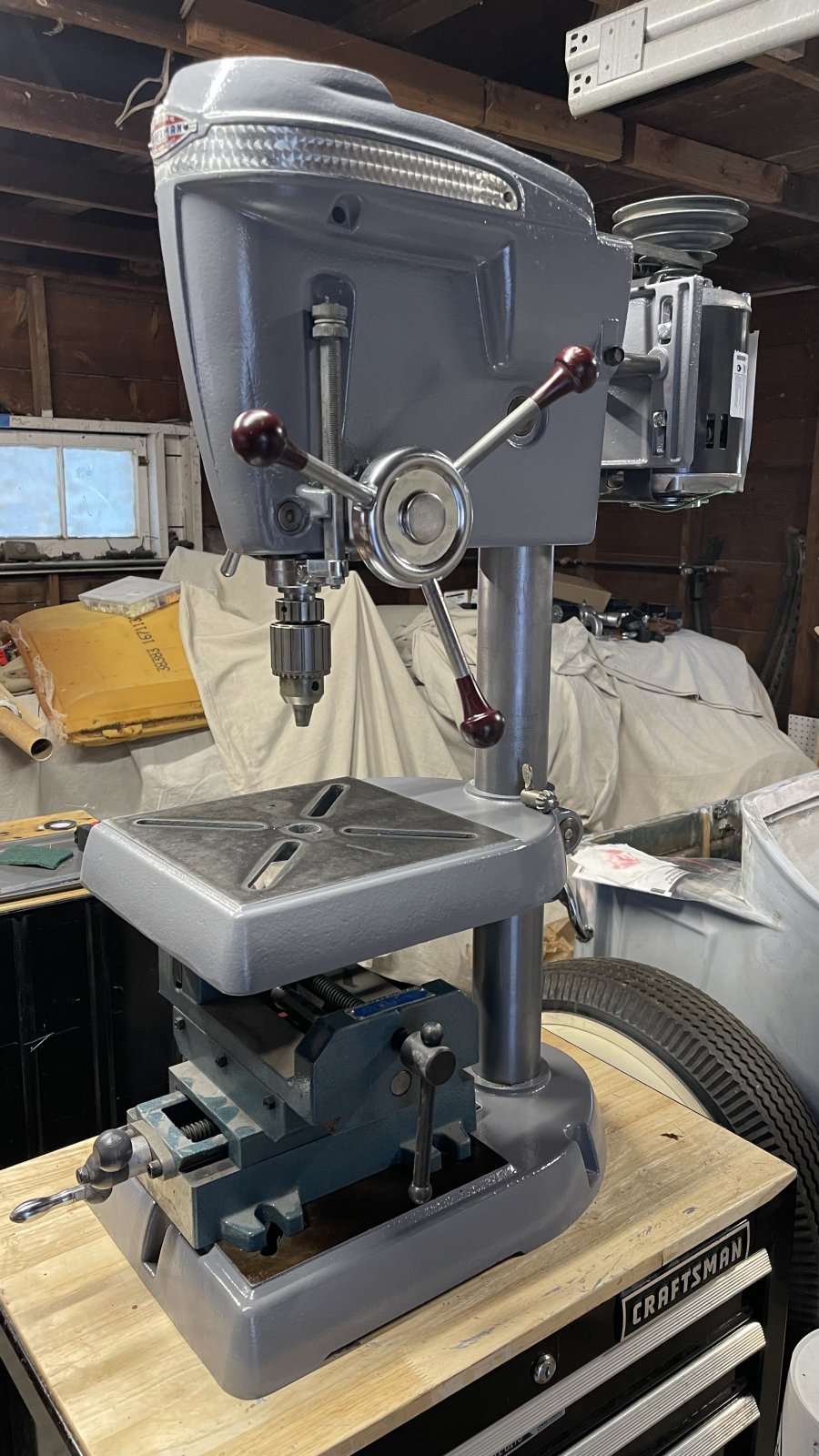

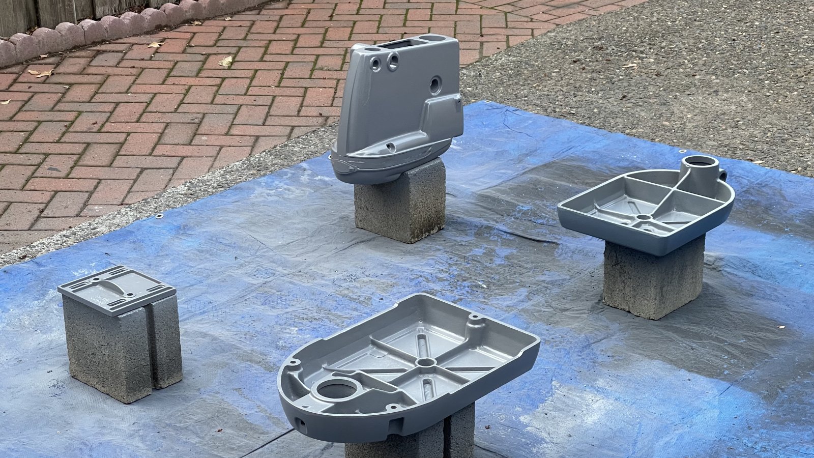

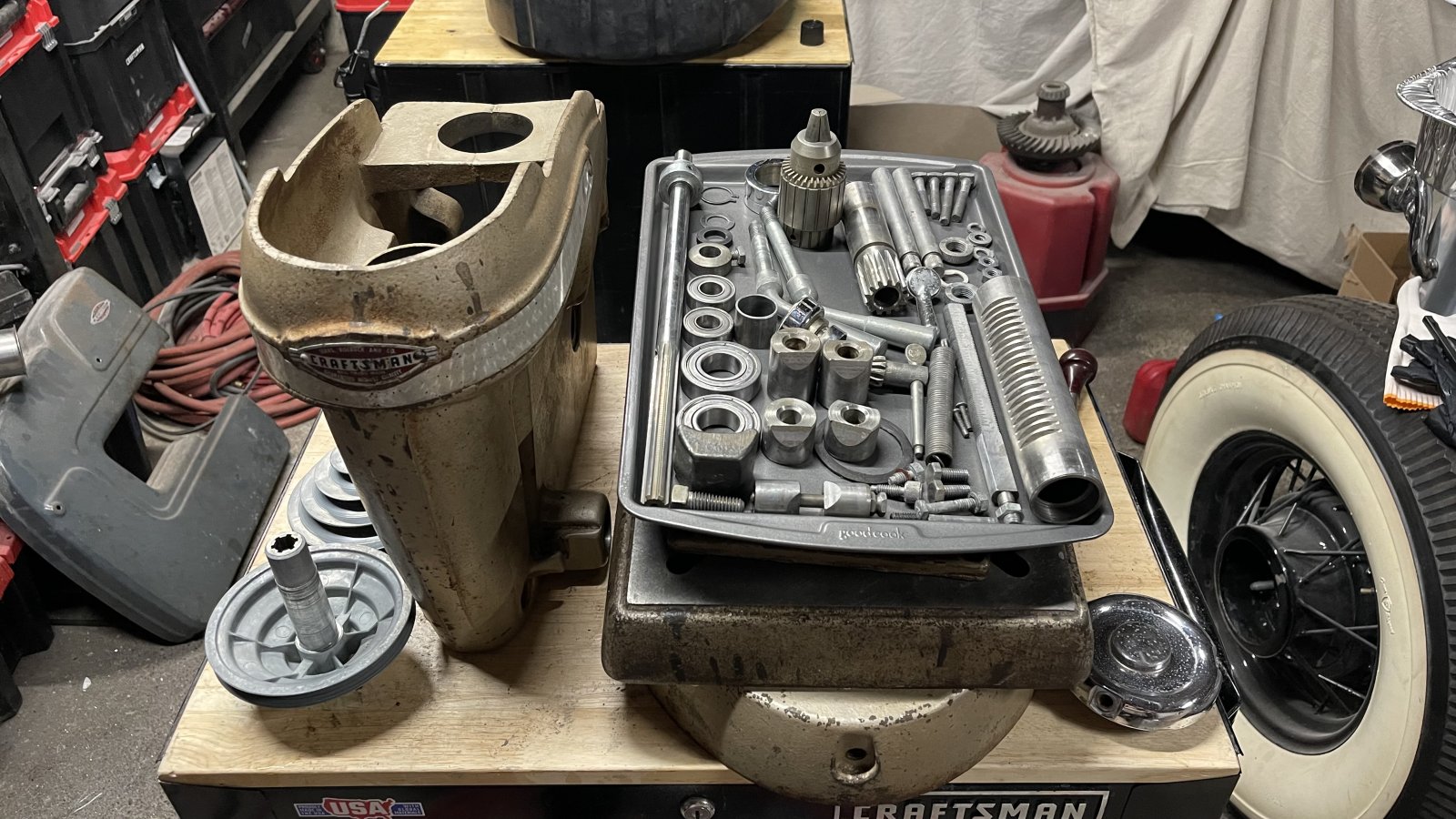

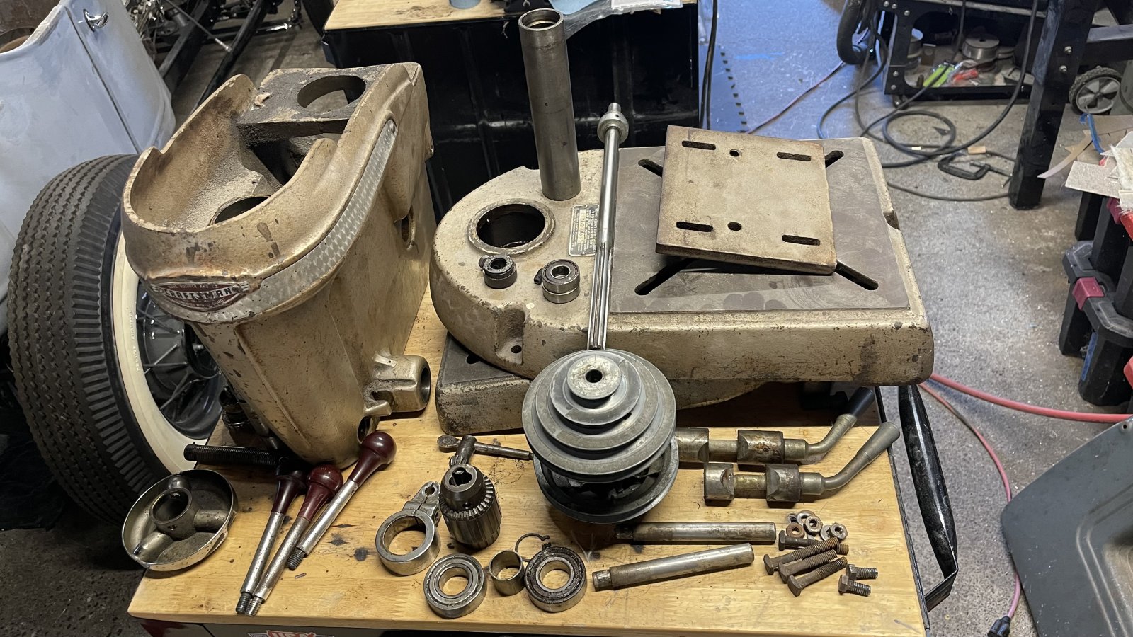

    Somewhat related to the car, as it has helped me fab quite a bit, the $50 drill press I picked up in 2015 got pulled apart and rebuilt this weekend. I got tired of drilling holes with a battery powered hand drill lol. I still need to wire the new motor and add a switch (possibly a built-in light), but it was a productive weekend. A few pictures from the past, and of the rebuild:

  28. RodStRace
    Joined: Dec 7, 2007
    Posts: 10,866
    RodStRace
    Very nice, Tim. Get a good vice for the table. Makes all the setup much easier and repeatable.
    Tim_with_a_T and porkshop like this.
  29. Tim_with_a_T
    Joined: Apr 30, 2011
    Posts: 1,816
    Tim_with_a_T
    Didn’t include it in the post, but I bought a Wilton that has x and y adjustments - you can see it tucked under the table below:
    brEad, Tim, RodStRace and 4 others like this.
  30. DDDenny
    Posts: 23,424
    Wilton, wise choice, I have a small Chinese version, what a POS!
