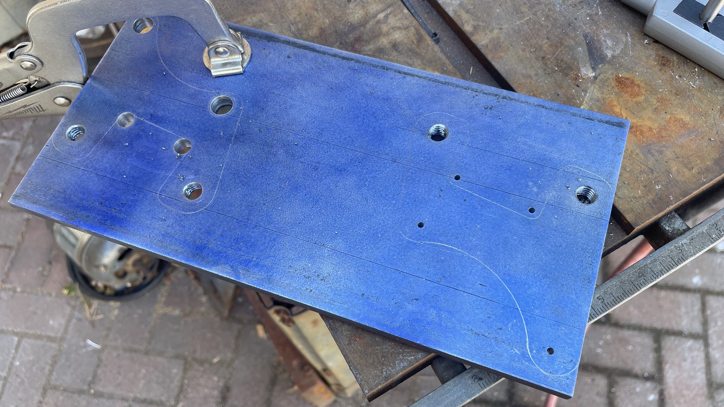

    Small update- had some glazed pads that were producing a horrible squeal, so my dad and I took them off, scuffed them and the rotors, back on - same squeal. I had some different compound pads in the attic, so I put those on after they left. Went down to an industrial area to bed the pads…. And managed to rip a caliper bracket off the car. That was interesting. I was by myself in an empty parking lot, so no harm done. Got the caliper tucked behind the headlight and limped it home on the emergency brake. After thinking about it for a couple days, I bet I never had that tight from when I put the brakes on the car however many years ago.
    Fast forward to today, last day of local cruise in for the year. My brother and I had planned to go in the T, but I needed to fix the brakes to get there. Not the best do***entation, but new bracket was made and we made it to the show! This car is a riot to drive, and I’m glad I got to go to the show with my brother today. I let him drive home from dinner- he was pretty stoked when we pulled into the driveway. Driving hot rods is pretty fun!

    That caliper bracket is scary as hell! You got extremely lucky. There just wasn't nearly enough edge distance around those holes, needs more meat! Please be careful out there learning how to drive this thing. My first hot rod at 18 weighed 2000 pounds, had a 454 and an 84 inch wheelbase. I drove it 2 weeks and wrecked it. A wise man told me, "That throttle works both ways, doesn't it?"
