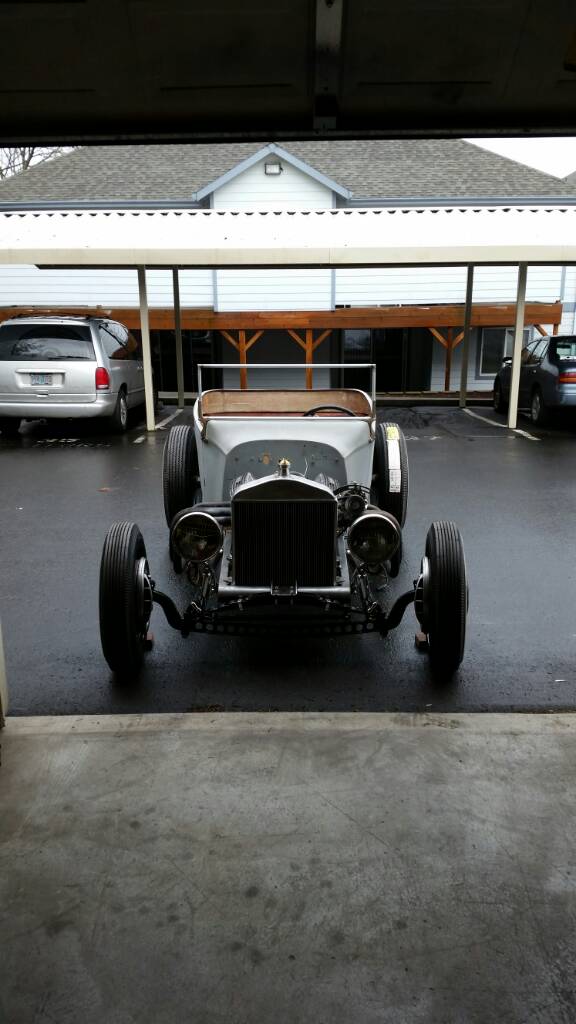

    Figured I would post a pic so you guys know I haven't given up on this thing. I got all 4 brakes sanded, coated, and ***embled; I got the pedals and clutch linkage sorted out; I got a few small things knocked out; then I started considering some changes- mainly the engine, headlights, and gauges to better fit the era I'm trying to represent. Most of the stuff I had laying around so I figure it needs to go to good use. Anyway, as I get things more solidified and completed, I'll update. Sorry for letting this drop off for so long!

    Thanks guys. Here's one more picture from about 50yds out- the two modern vehicles are @ about the same distance. It's hilarious to me to see how much smaller the T is in comparison.
