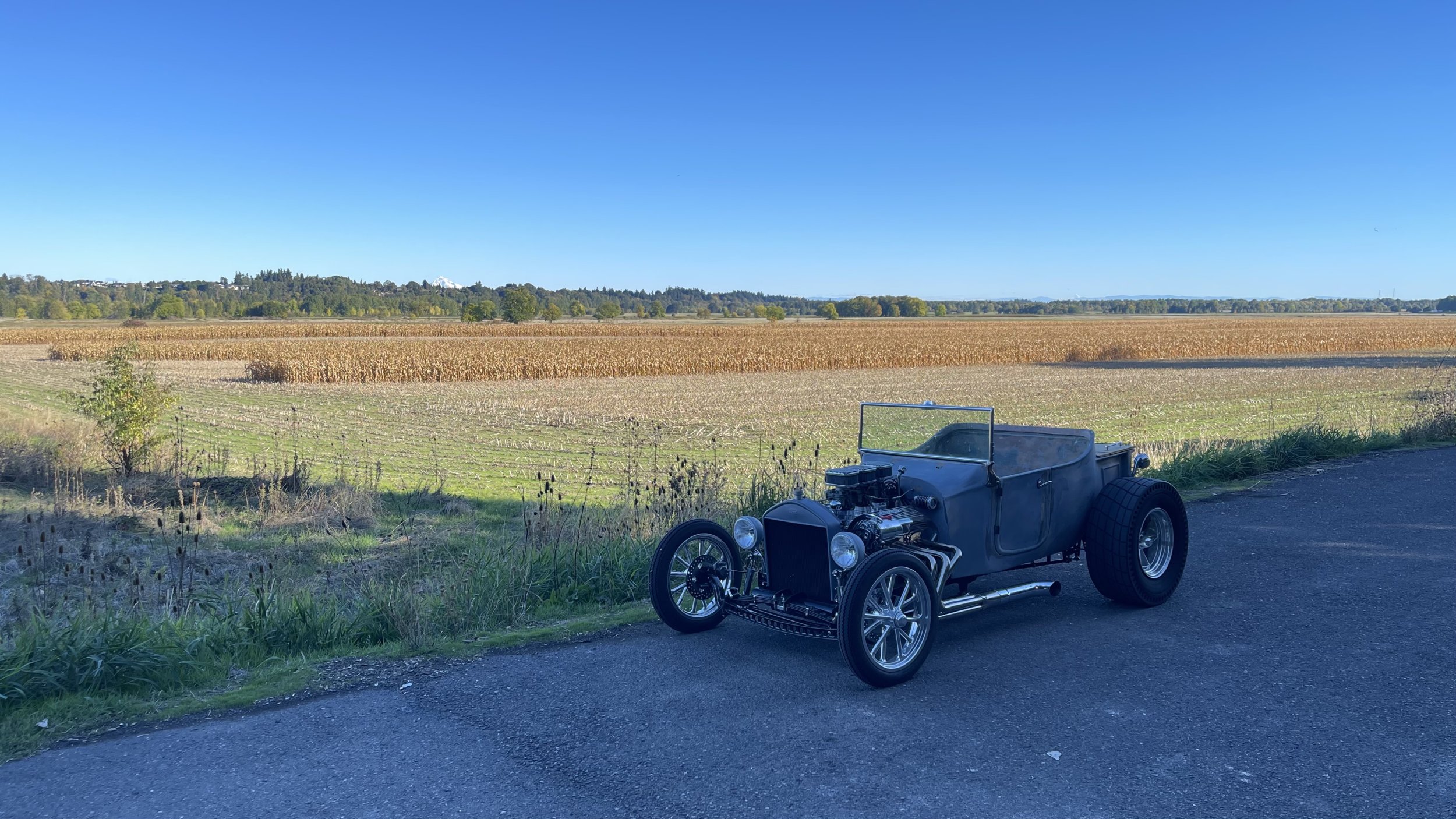

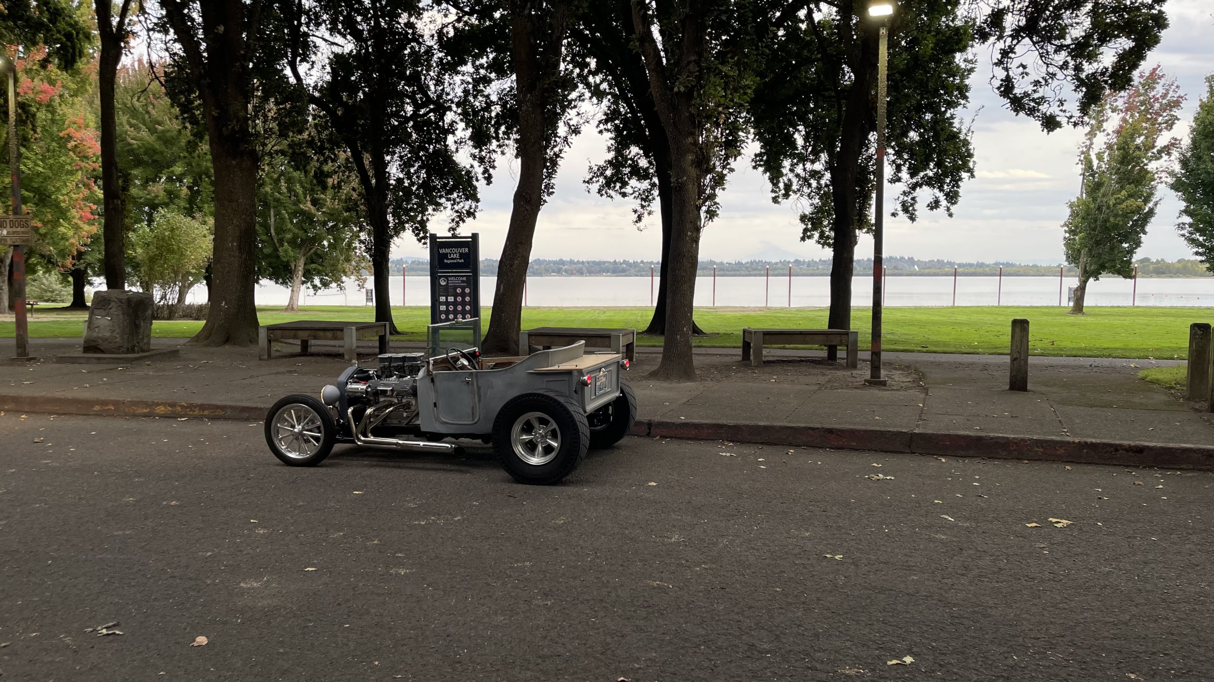

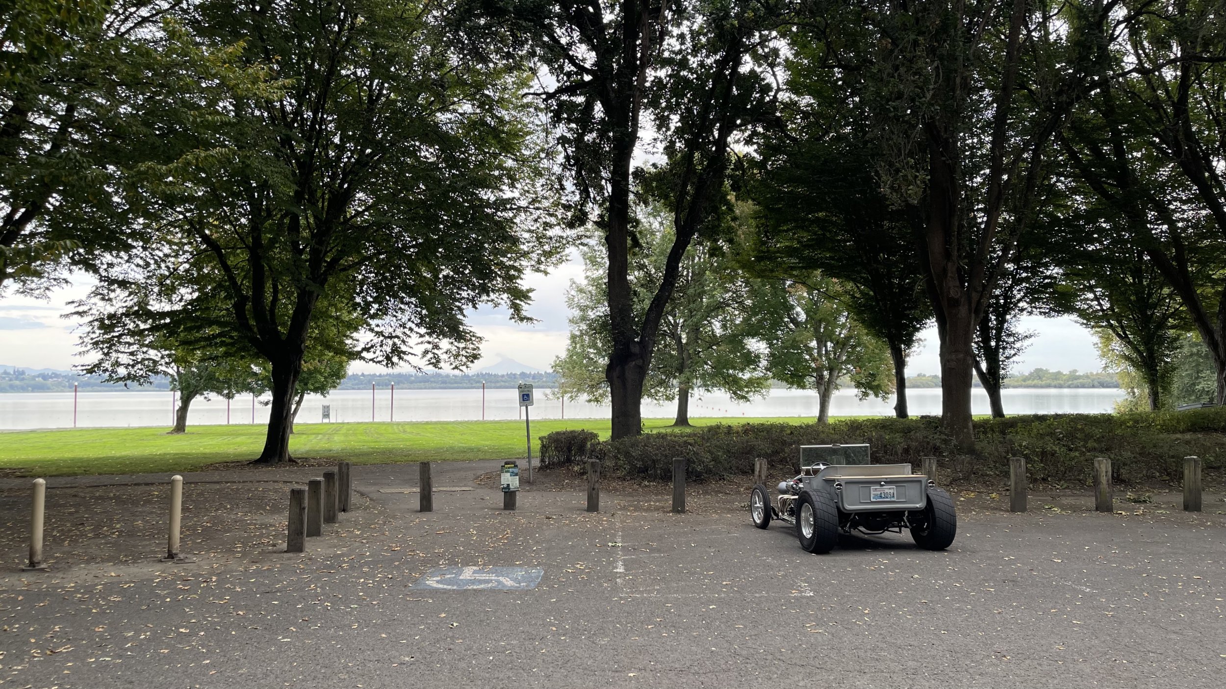

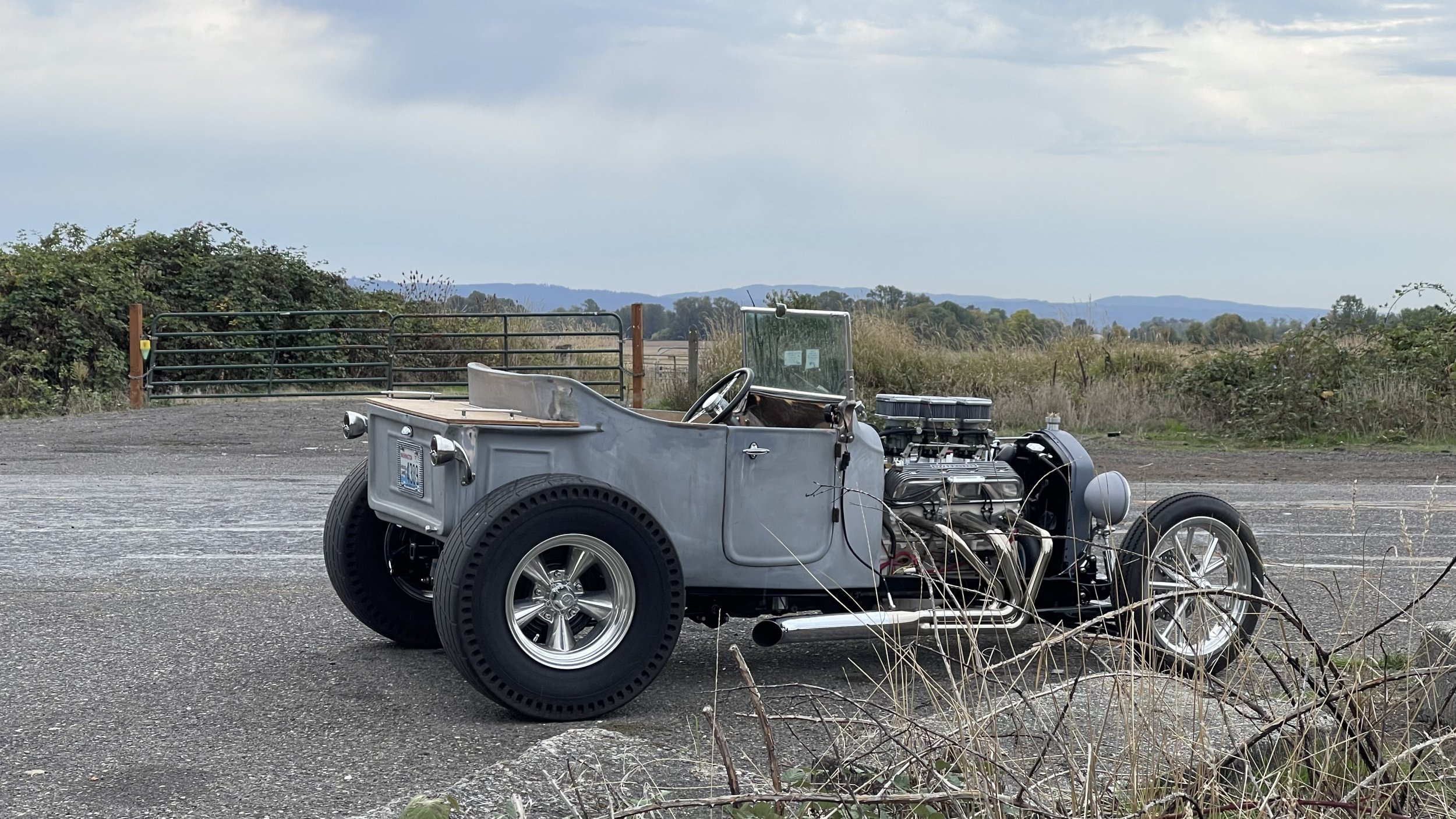

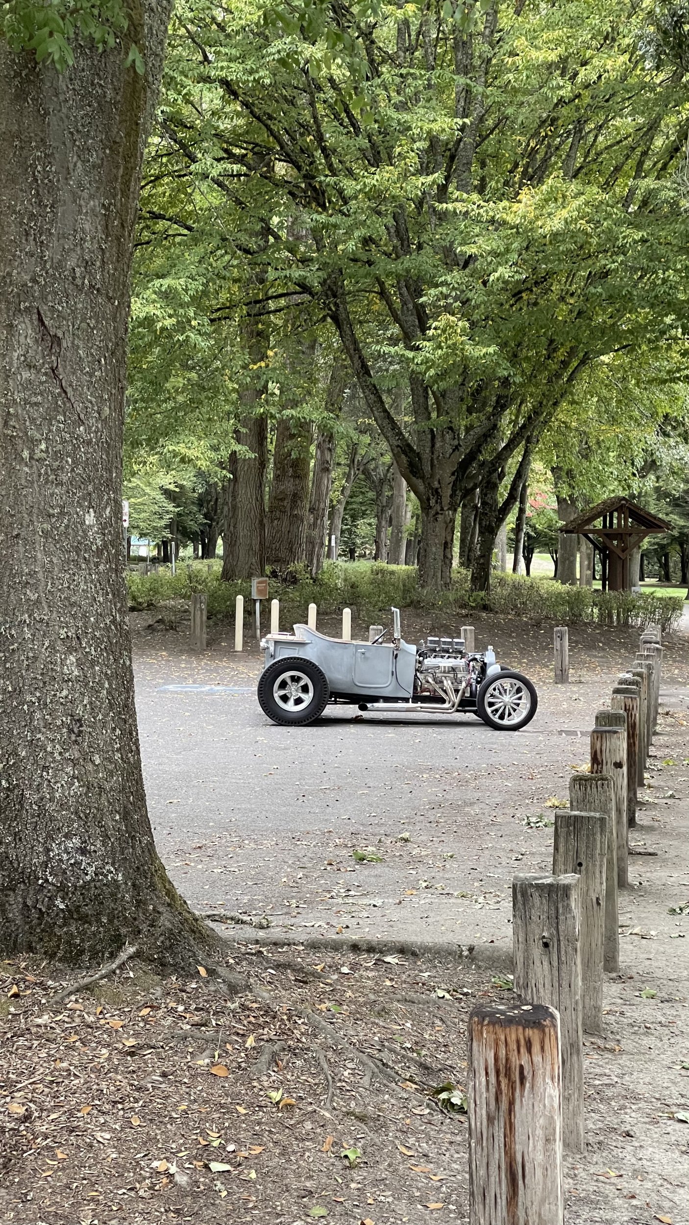

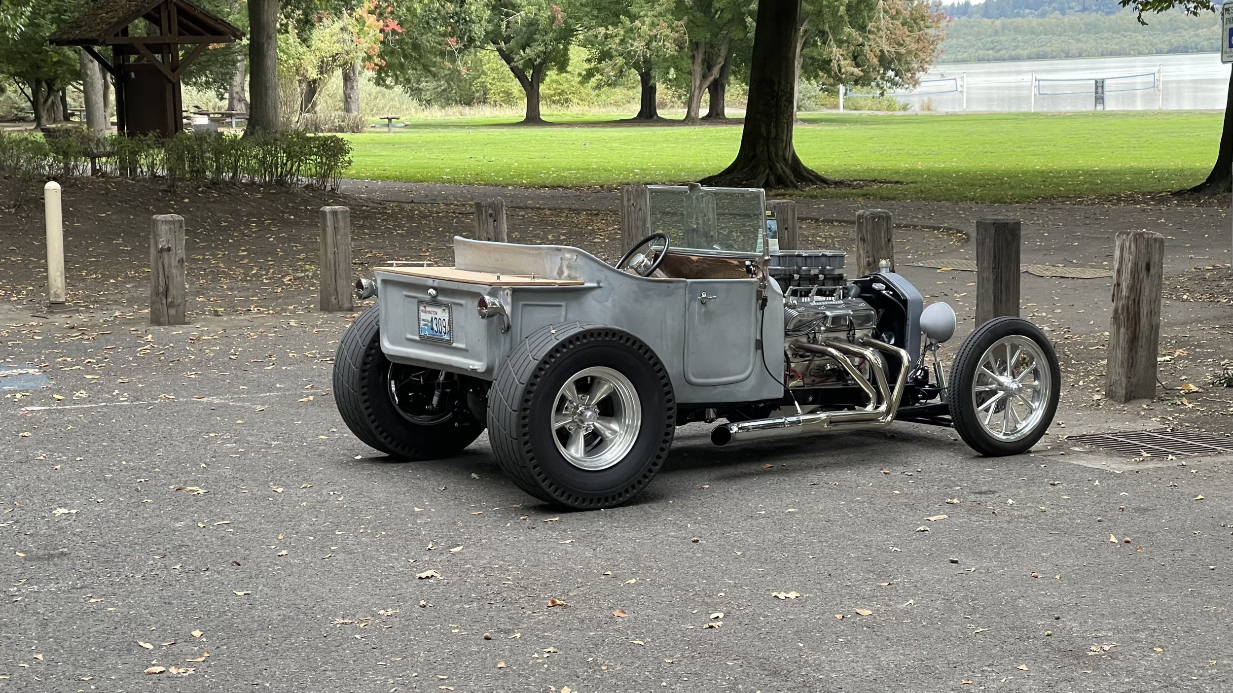

    This morning, I leaned all 3 carbs by 1 jet size, so now I’ve got 62 pri and 61 sec.
    Did some driving today- it was supposed to rain but the forecast shifted …
    The AFR readout today was not consistent with previous testing, also not consistent throughout the test, so I’m not going to make any changes. If anything, after confirmation of some more driving, I may go back to the previous jetting. The drive out, after the car was warmed up, was what I expected to see, although the weather should have made a richer condition. On the drive back, I was lean everywhere like back before I started tuning. Like I said, invalid test session. Plugs are a golden brown and it looks like I could probably tickle a couple more degrees of timing into it, but I’ll wait for better weather and more testing.
    I drove out to the lake and to a spot where I like to look at birds. As soon as I got there… pouring rain. Managed to get home without issues, and took some decent pictures of the outing.

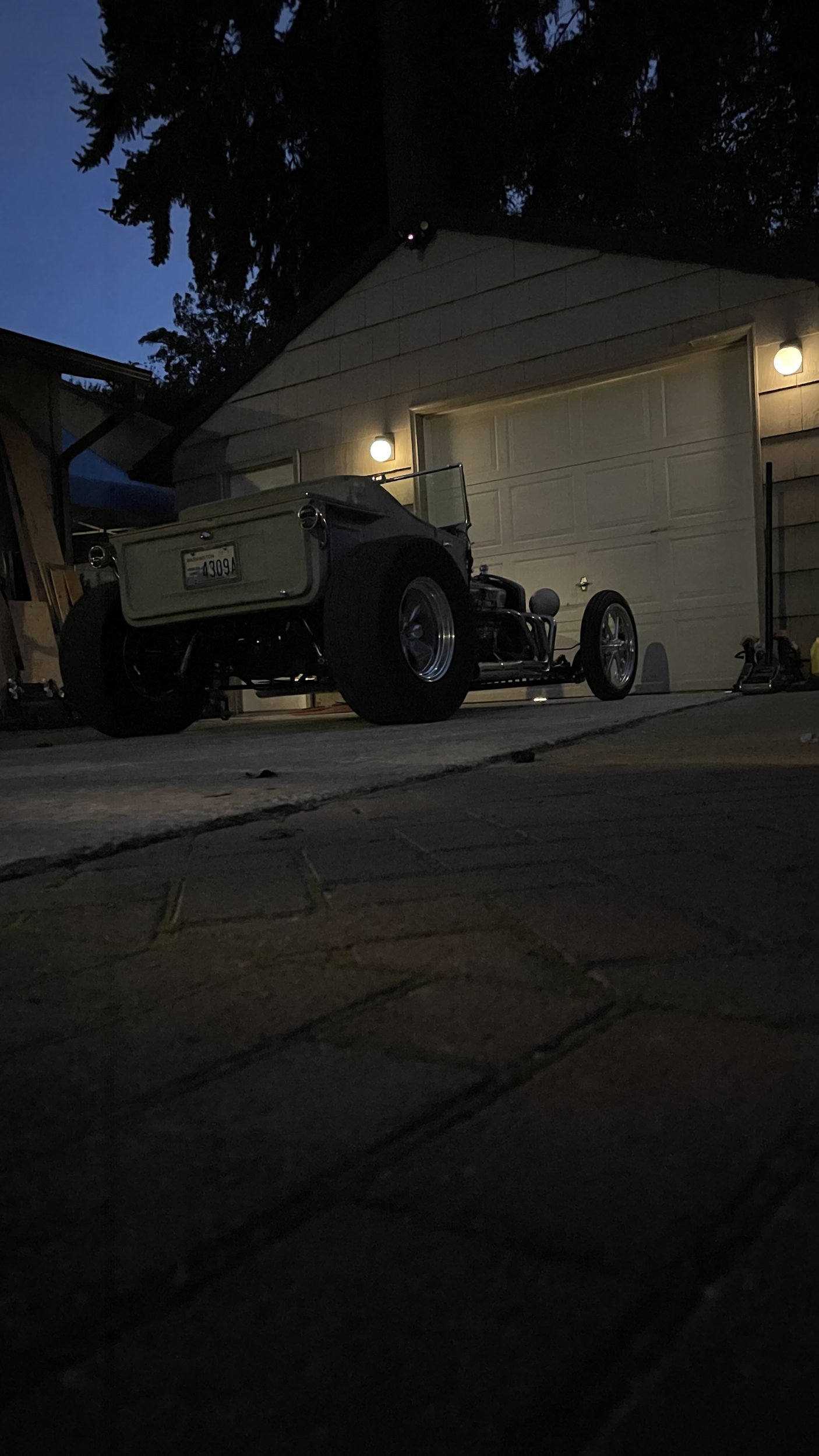

    Happy late Thanksgiving peeps. This weekend, my brother asked for some help hanging Christmas lights, so I went over there today. I fixed my tail light / brake light issue - I had them wired backwards. I drilled the secondary squirters, but I will need to do what I did on the primary to get it to not stutter. I still haven’t shown that, because I was hoping to solve the secondary stumble first. I also need a stiffer rear leaf spring and bump stops, and I sorta have a plan for all that when the time comes. Anyway, great COLD drive today aside from those issues.
