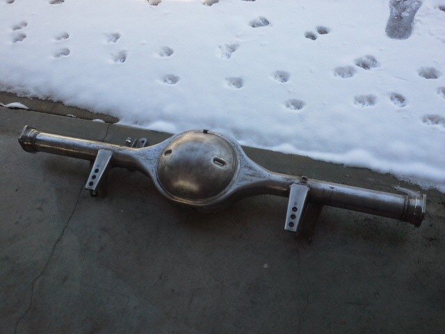

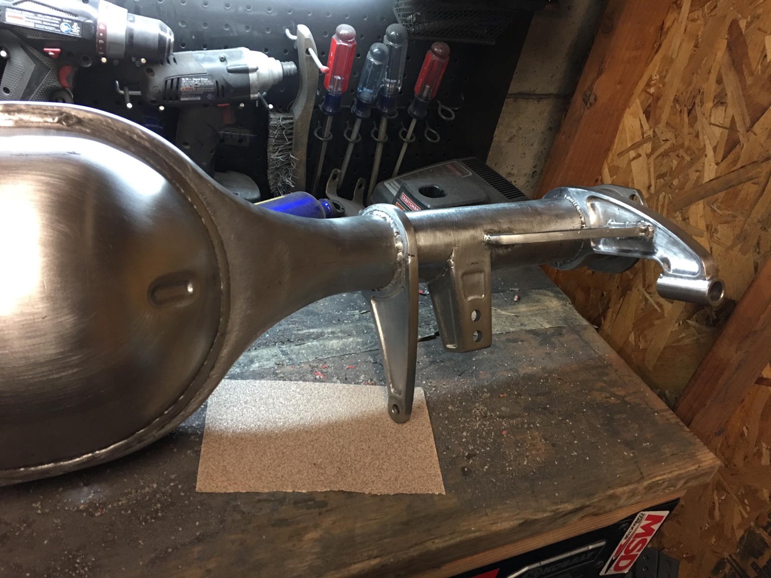

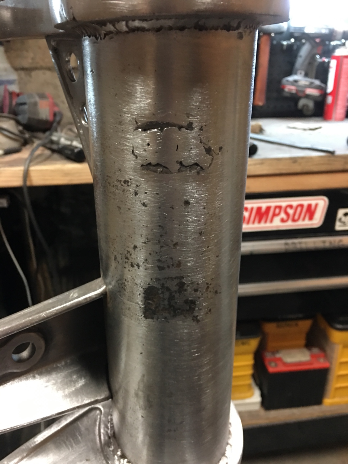

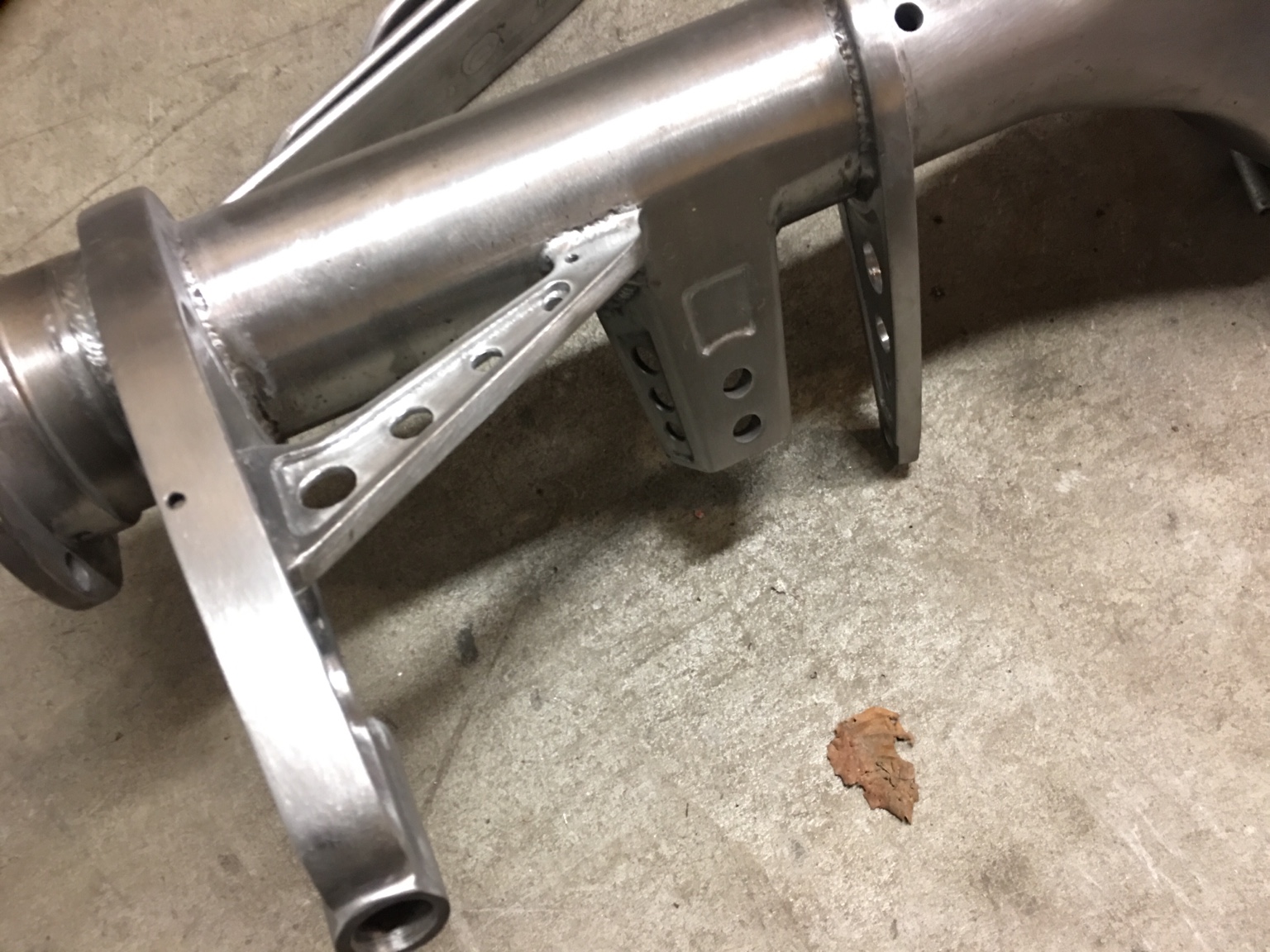

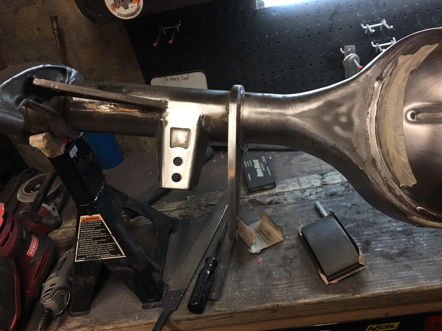

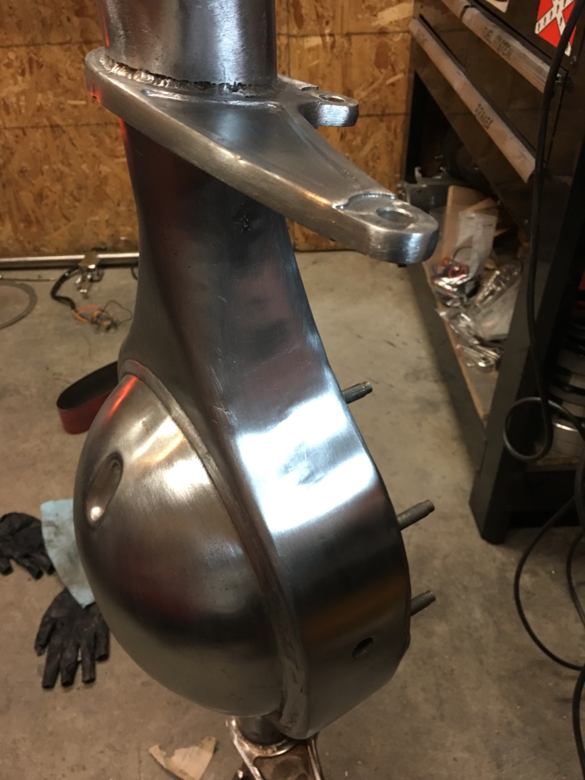

    Well, it's my Friday at work, and I'm itching for the weekend... Here's a couple more fun-filled photos to go along with my metal dust-filled lungs...
    Going from this...
    To this (not the same area, but you get the idea- I was delirious, give me a break!)
    To this...
    And this...
    To this...
    And getting to the point where I'm happy enough to proceed to the other side....

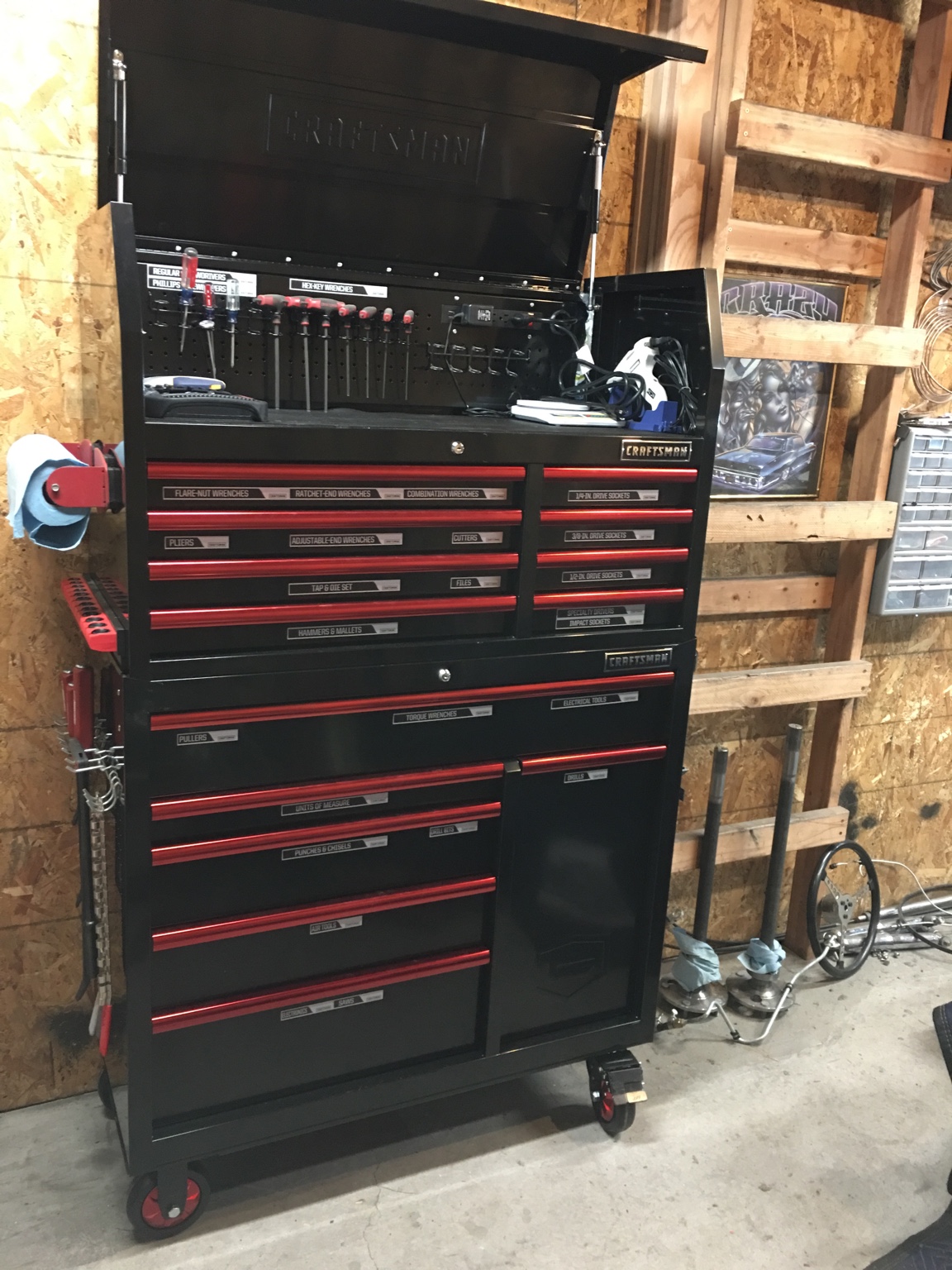

    I got a new toy, which was distracting for a bit... but now all my tools are in one spot, which makes me really happy - yes; my male modeling career was over a long time ago.

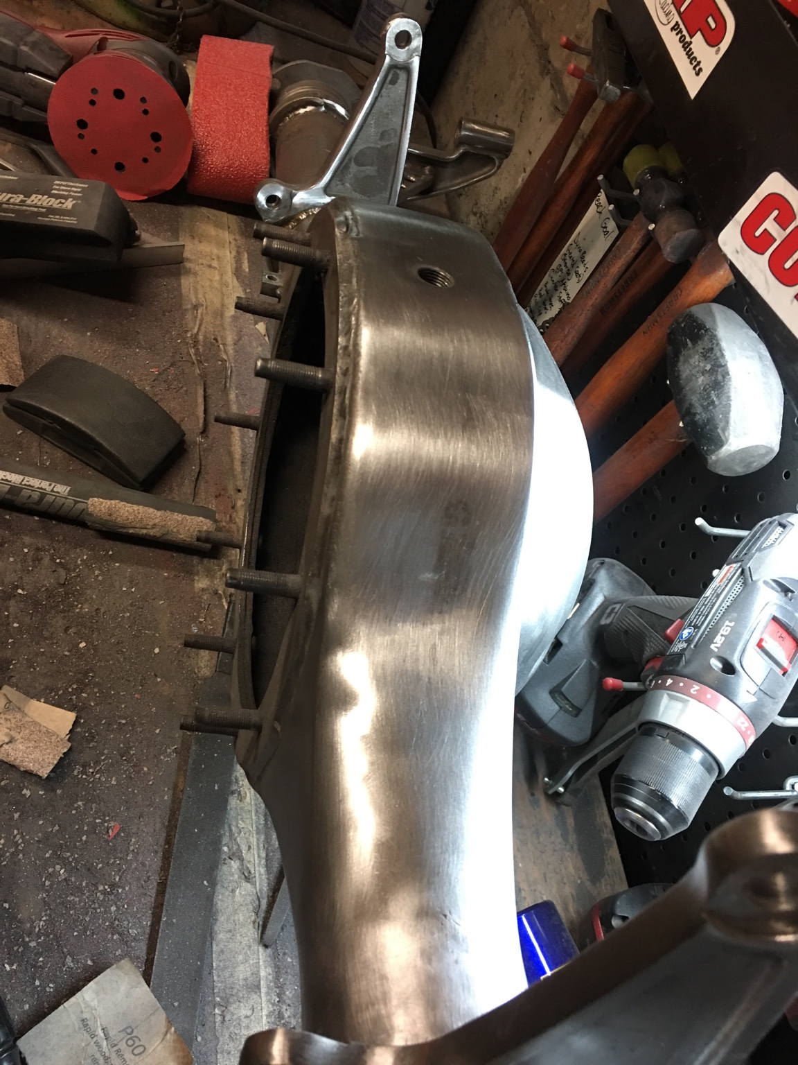

    And onto the other side....
    Derek Zoolander scene after he spends a day in the coal mines....

    The nickel plating on your suspension pieces - yes; I have seen and yes; I like a lot. Where did you get this done? I actually have been meaning to get in touch with you on that as I was considering sending out a small batch for chrome.....but that scares me ($$$), and I like the look of nickel just as well. Was that a local shop, and were they reasonable?
    If at all possible, I want to plate all brake lines, all fuel lines, my windshield posts, my dash insert (***uming I can't get it to clean up - it looks pretty cloudy), my tail-light brackets, my door latch/handle ***embly, and I think that's it...
    The color of all suspension pieces will be black to match what I've got going on with the front. I used all polished stainless fasteners wherever possible to make it pop, and I still may/may not do all webs of the brackets and the web of the front axle with a Wimbledon White - what I'm worried about is a raised parting line between the white and black. I was thinking I could have a the parting line pinstriped, but like I said, I'm not sure I want to go there. All of that depends on what color I go for the engine because I don't want too many colors jumping out at you.
    Your rear axle - is it in pretty decent shape? Mine was actually pretty rough. It took quite a bit of work to get it smoothed out, and it's still not perfect by any means. With the '32 tank out back, it wouldn't be super noticeable under there... I'd almost just go with a satin/gloss black depending on where you were going with the rest. Post some pics if you want - I'd like to compare your rear to mine.... lol.

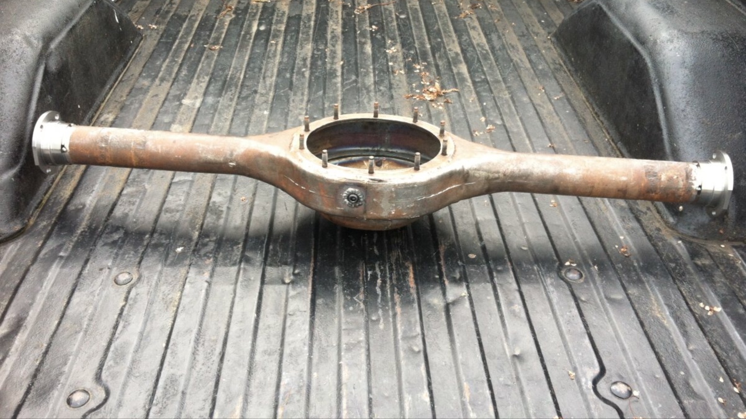

    Posts: 23,425
    Just your basic old truck housing.
    swade41, Tim_with_a_T and loudbang like this.

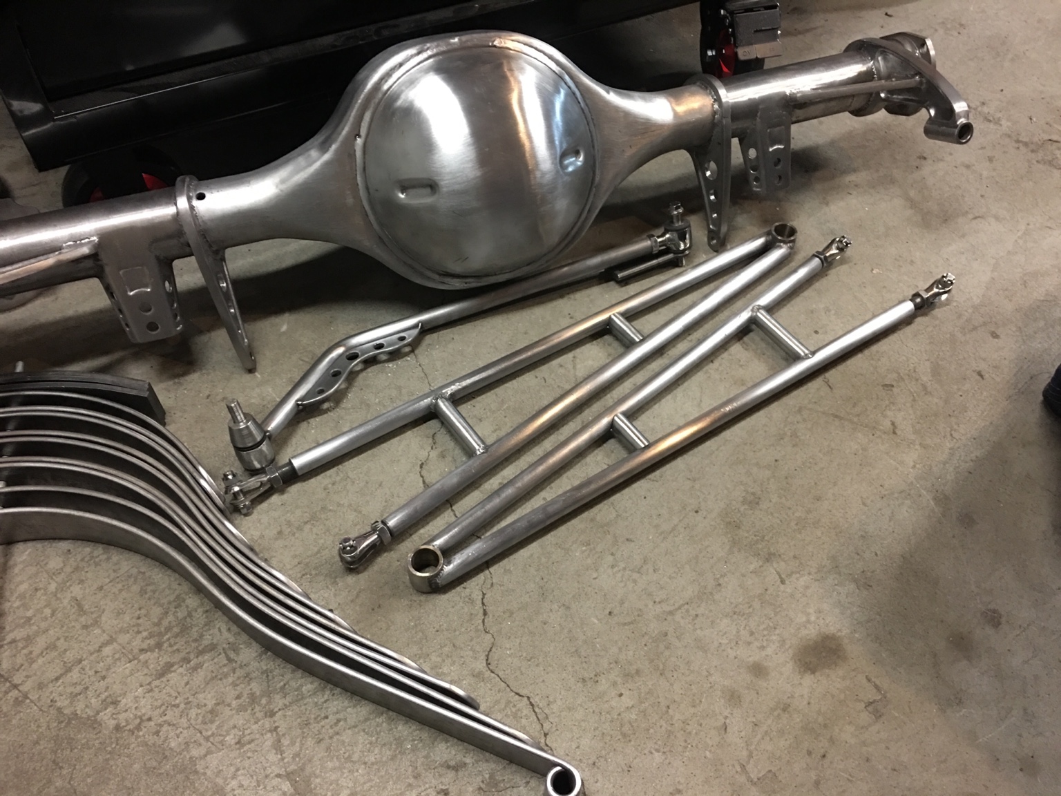

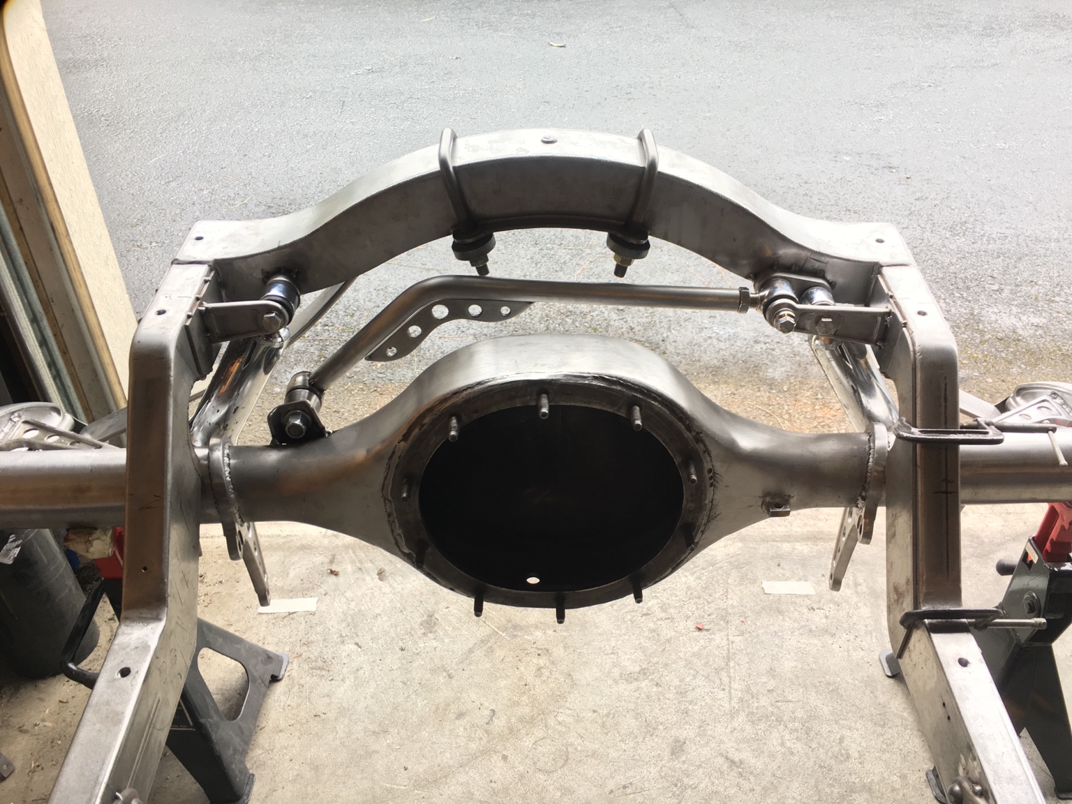

    Monumental progress this morning. The rev. Z panhard bar was the last thing I needed to finish before the rear suspension can be powdercoated. I only have the main leaf in there, so the bar should be pretty close to level once fully ***embled and loaded.
    [​IMG][​IMG]
    Also this makes me really happy. Frame is dead nuts square despite me cutting it apart on jack stands and having little to no clue what I was getting into. I only have a few small things to tidy up on the frame before I can send it off to TIG weld all my tacks. Very very happy and thankful I made it this far!

  22. gimpyshotrods
    Joined: May 20, 2009
    Posts: 24,630
    gimpyshotrods
    Prepare for a lot of frame shift on bumps, and during weight transfer under braking.
    Tim_with_a_T likes this.
  23. Tim_with_a_T
    Joined: Apr 30, 2011
    Posts: 1,816
    Tim_with_a_T
    Elaborate?
  24. Baumi
    Joined: Jan 28, 2003
    Posts: 3,478
    Baumi
    I think what Gimpsy means is that your panhard bar mounting points are not level horizonaly. When your rearend moves up ( suspension travel) the rear stays set but pushes the frame sideways via the panhard bar. You usually want a panhard bar as long and as horizonal as possible to keep the sideways movement at a minimum. All depends on how stiff your rear spring is, if there is not much suspension travel, there will be not a lot of swinging, but it´ll be a harsh ride. I think with a heavy rearend in an otherwise light car a soft suspenion and good shocks are the goal...
    But I´m just a barber, what do I know, just my 2 cents.:)
  25. Tim_with_a_T
    Posts: 1,816
    Tim_with_a_T
    Roger that. I can ***ure you this is the only plausible configuration I have been able to come up with given the narrow width of the frame and size constraints in general. I can also ***ure you that I have multiple leafs I have cut down from two springs to tailor ride quality, and I'm not afraid to change shocks, socks, and underwear after a bumpy ride, then crawl back underneath and rip out the panhard bar to add to my art-projects-gone-wrong s**** pile. I am facetiously estimating my suspension travel to be somewhere in the neighborhood of 1/8" to 8"..... in other words I have no seat time, no data, no bumps to hit and rip my frame into a twisted pretzel. Time will tell, and I am just the messenger.
    loudbang and OFT like this.
  26. gimpyshotrods
    Posts: 24,630
    gimpyshotrods
    Your panhard bar should be horizontal, and preferably as low as possible, in relationship to the axle housing.
    The lateral shift on the the ch***is on suspension cycling is a factor of the bar length, and the installed angle.
    The shorter the bar, the tighter the arc that it swings in. You have a fairly short bar. It swings in a fairly tight arc. This alone will will shift the ch***is over the axle by an excessive amount.
    To make matters worse, you have the bar installed at a very steep angle. This amplifies the shift under cycling and weight transfer.
    This configuration will also cause the ch***is to rise above the axle in a hard left hand turn. It is hard to day how bad this will be, but the first time you find out the hard way could be an unfortunate experience.
    The bigger the e distance, the bigger the s distance. Your bar is installed with a positive s offset, as it is built. A horizontal bar has zero s offset, as built. Look at the red bar above, and imagine it moving up and down by the width of the red dot at the end of the line. See how small the s offset is?
    Now do the same, imagining the bar on the r line. The s offset is rather remarkably larger.
    Also, as has been mentioned, since you are also using a cross spring, you will have the bar fighting the spring. This will make for a harsh ride, biased to one side. If you can maintain control of the vehicle, it won't be a pleasant ride.
    Finally, the panhard bar sets the roll center. Lower is almost always better. Vehicles with multi-link suspension soften have theoretical roll center (front/rear) that are below the surface of the ground.
    loudbang and Tim_with_a_T like this.
  27. Tim_with_a_T
    Posts: 1,816
    Tim_with_a_T
    I understand, and thank you for the demonstration because it is helpful. I can only say that straight bar no workie in this case. Low bar no workie either. Current bar comes out with two bolts. I have shown disastrous attempts of previous panhard bars, and those are only the ones I was willing to photograph and share. Out back the shocks are in the way. In front the kick up is in the way. On top the axle is near the floor of the pickup bed in height as it is, without having a bar on top with additional clearance as well. This is a compromise, and, if needed, it can be repurposed as a hood ornament after seeing the "rat rod" display at the Portland Roadster Show a couple weeks ago.

    I could cut out the bend and have my axle mount near the top of axle off to the p***enger side slightly. It would be fairly horizontal then but shorter by about 6" laterally. Thoughts?

    Do you even need a panhard bar?
    You have a buggy spring. Is it set up to require spreading to attach to the shackles?
    Tim_with_a_T, loudbang and JOYFLEA like this.
  30. I was thinking the same thing, Hackerbilt. I thought the Panhard bar was more for coil over deals, because with the leaf spring mounted securely to the center of the frame and the ends of the rear end, side to side motion is virtually nil. The metal in the spring isn't going to stretch and contract, so the ends of the spring are going to remain pretty darn close to a set distance from the center mount. What can be an issue with a buggy spring is body roll, and you could use a sway bar to prevent that (if it's a problem). Tim, my Total Performanxe car has a Watt's link on it with coil overs, This eliminates the side to side push of a Panhard bar, but as you say, it IS tight in there (it sits directly behind the pumpkin, gotta look at your pics again to see if that'd even feasible for your car). I can try to shoot some pics if your interested in seeing how they did it. Your car is looking really good, just not sure you need a panhard bar at all. I'd probably leave it off till I got the car running (leaving the mounts for now), then put it back and work out all the engineering only if you find you need it.
