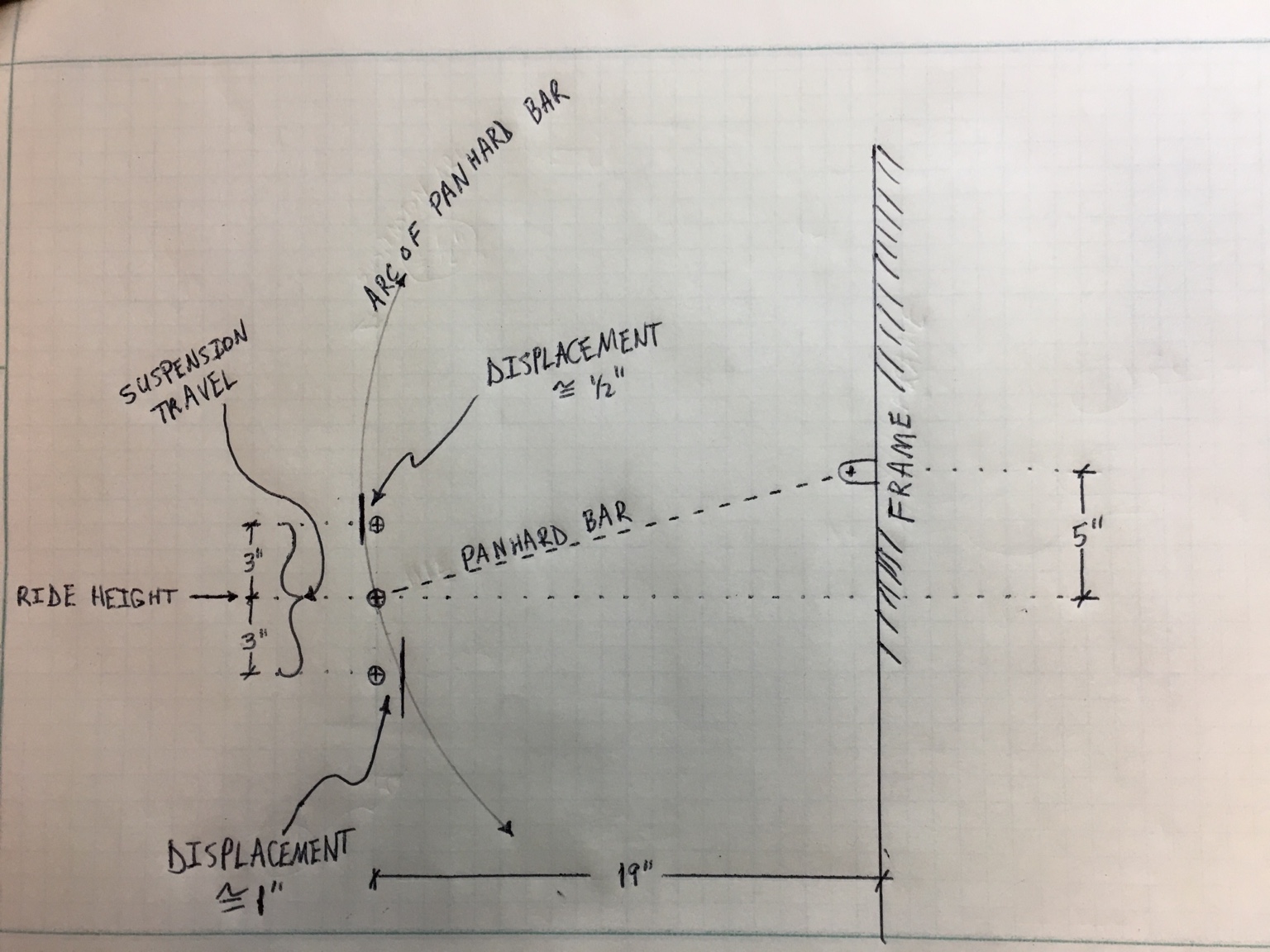

  2. Longer is better with Panhard bars for the same reason, the shorter bar goes through a bigger radius at the loose end, causing more side to side push.

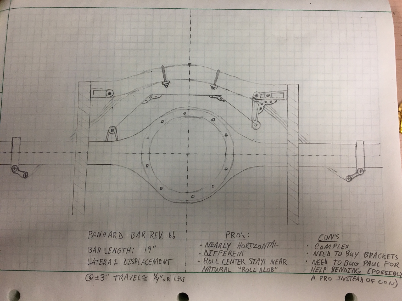

    Blue One
    from Alberta

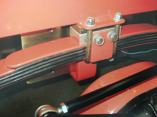

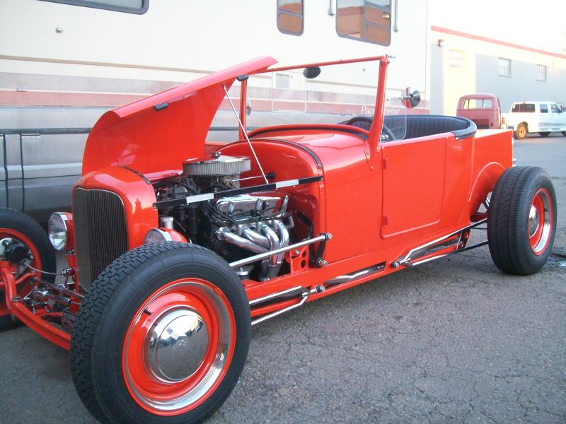

    My buddy has a buggy sprung 27 T RPU, it's been built and on the road for over 20 years now.
    These pictures are of the original 20+ year old ch***is ( Glasurit 22 line ) paint sprayed all those years ago Same with the body paint.
    Anyway, I'm thinking that you may get 3" of suspension travel, that's typical.
    He has a rear kick up in the frame and it's tight as in no room which is typical.
    The rear end is an 8" Maverick.
    He originally built with no rear panhard bar but quickly found that he had to add one to a finished car.

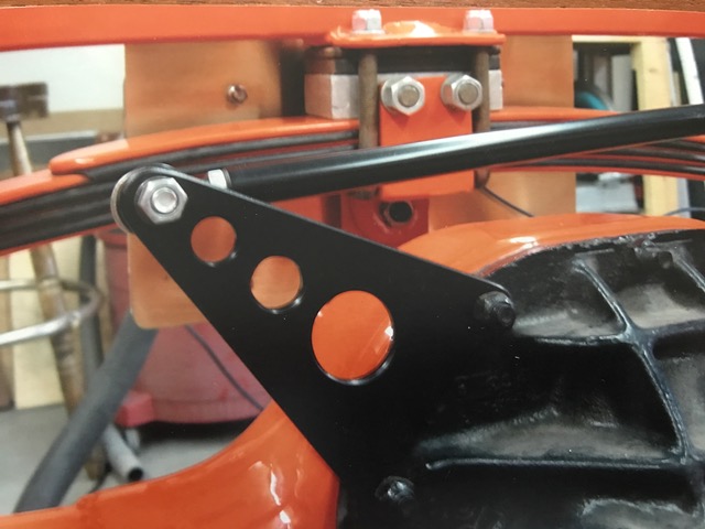

    The car would shift sideways due to swing of the shackles as the car reacted to bumps and turns.
    This is what he did, it's pretty simple and it works really well.
    Maybe this will help?
    Larry.
    Tim_with_a_T and loudbang like this.

    Posts: 1,816
    Tim_with_a_T

    A few pics to show what i mean.
