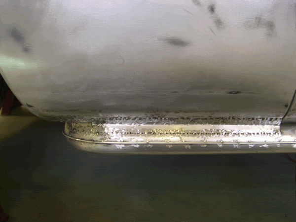

    As most of you have seen in this thread, the p***enger's side got done a few weeks ago and put in primer...so we moved the car over and started on the driver's side. In the pic below, there's the last of the original green paint going away.
    When that was done, I sprayed some sealer on it (note the expensive masking paper) and proceeded to take care of some small dents...
    and of course, match the Lakes Pipe shroud to the p***enger's side...doing one is easy, matching the other side is always the hard part.

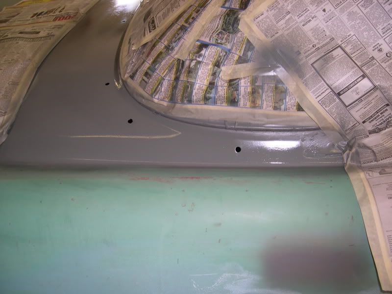

    Once the body was done, I sprayed the final coat of sealer on it and then proceeded to start spraying primer...
    Note that it's still up on wheel stands, I've found that it's extremely hard to spray primer on the bottoms of the wheel wells and rockers when the car is only 4 inches above the ground...the spray gun won't even fit under it and it's hard to maneuver it back and forth while it s****es the concrete.
    And here it is, in it's final coat for the summer (below). Note also that the Lakes Pipes and skirts are not on it in this shot and I've yet to take it down off the wheel stands...also note that I do not have the park light housings built, they'll go in that big hole above the front bumper...also note the stainless around the front windshield is off the car...

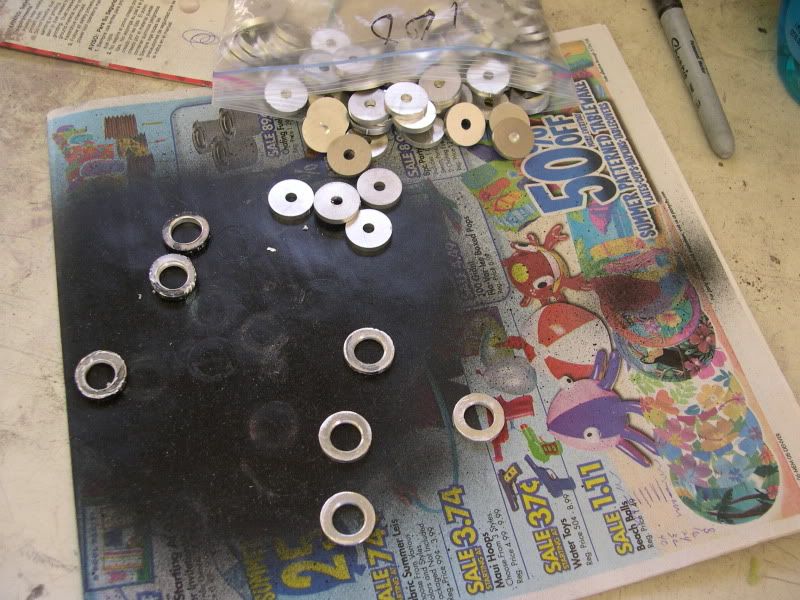

    The first thing I had to do was to paint all the washers black so they’d “go away” inside the grille, I also had to drill some out so the nuts that held it all together would fit inside the washers.
    Once they were painted/drilled, I began ***embling the grille…in this pic you can see the seven “rods” I used to hold the grille together and how the spacers worked in between each bar.
