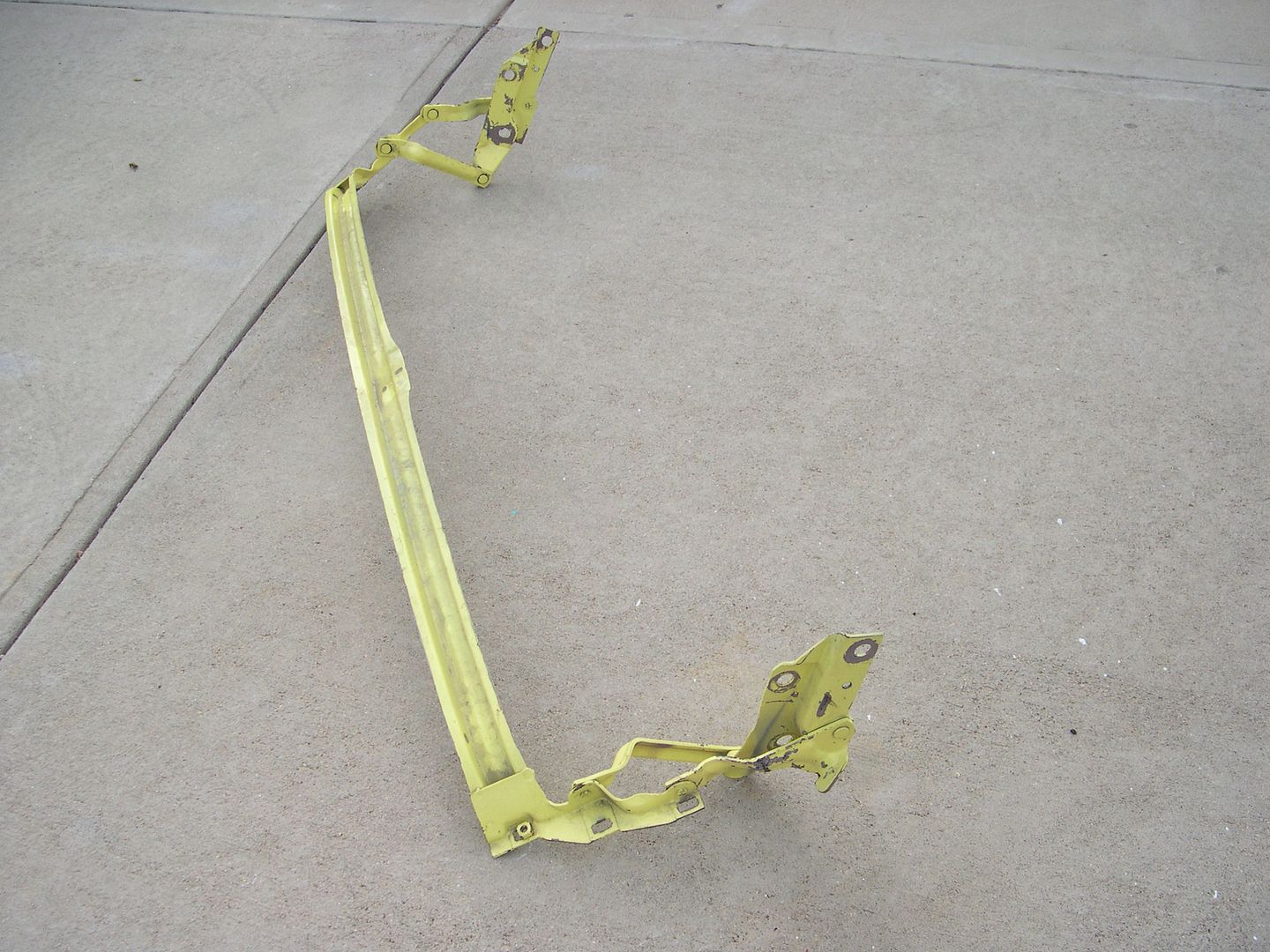

    Since you all kicked this one back to the top , I'll do a mini update...we'll call this update:
    I HAD to seek professional help...!!!
    Lots of things have been happening to the Caddy since it made its last trip in mid-September...the most important thing was to get the hood hinge ***embly taken care of...the p***enger's side arms were bent so bad that the hood would not lay flat against the cowl...so, much to my chagrin, I had to seek professional help. I happen to know a very proficient rod builder, have known him for over 25 years...when I have a problem, of any kind, he's the first guy I go to. Quenton Sonnenfeld (Sonnenfeld Enterprises) can figure anything out...and I mean that...at one time he was on the cutting edge of building hydrogen powered city buses...needless to say, any small thing I have is child's play to him. Anyway, I took my Caddy up to him, he studied the hinge ***embly as I opened and closed it about 20 times...then asked if I'd remove it from the car...
    The affected hinge ***embly in the ugly yellow color...
    I said no, I'd bought 3 ***emblies hoping to find one good one (which was not to be), cuz each of them had one side bent, which apparently is the weak spot in a Caddy hood, so I'll bring you two of them.
    Right at the first of October, Quent called and said he'd dis***embled the hinges, machined several shoulder bolts, straightened one of the arms and put it all back together...adding, "It should work like it's supposed to." When I went to pick it up, it certainly looked better than the one I already had on the car...
    It took four hours to remove the springs and the old yellow ***embly simply becuz I didn't want to remove the fenders to access the bolt that was on the bottom of the hinge...but we got it...and it took all of 15 minutes to slide the new one into place and bolt it down. The rebuilt ***embly looked like it laid flat and even with the cowl...but the final test was putting the hood back on and getting it bolted on, which, at one point when I was building the car, a real pain in the *** simply becuz the mounting portion of the hood was hard to get at. Well, my bro went and purchased some new cage nuts for me, we put them in place and slid the hood on and it lined up perfectly with the new cage nuts...the new bolts slid in like they were supposed to and it went together so smooth I thot something was wrong...
    I gently lowered the hood and it closed and latched like it was new...I checked the rear of the hood at the cowl...and voila, we didn't even need to adjust it. It fit perfectly. I'm still amazed at Quent's skills...to be able to figure out what was bent, dis***emble it, straighten it and put it all back together without the car even being at his shop...I'm flabbergasted. Maybe that's why he's a pro and I'm not.
