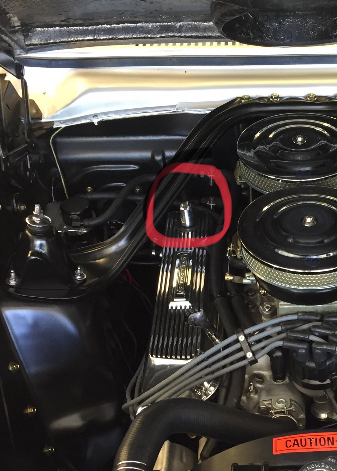

    Installed one on the Comet, works perfectly. The customer support is top notch, something that is rare these days.

    I just installed a ME Wagner on my engine. There are videos on YouTube about these for larger big block engine installations. I watched 3 including the one from the company. With rocker cover style no additional parts are needed and it’s pretty easy. They are a very well made machined part. Might be expensive to some but to me it was not @ $130.
    They are made to tune for lower vacuum engines. The instructions are on line to read on their website and all that’s needed is a good vacuum test gauge. I bought a kit at Harbor Freight.
    I could not use the rocker cover grommet and bought their hose adapter.
    As a test: with your engine running remove the breather from the opposite side rocker cover from the PCV valve. There should be enough vacuum to hold a piece of paper on the grommet where the breather was.
    There are also explanations on how a PCV valve goes from idle mode to cruise mode letting in more engine vapor to the intake for combustion. Also the factory breather was not out in open air but plumbed to the air cleaner; if yours is open it’s why your smelling your engine.
