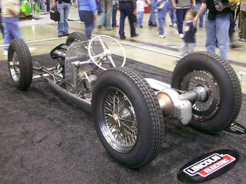

    The car will be complete at this years sema show along with a complete frame.. and they will sit beside eachother.. so u can see all the work that is in the frame, as well as the complete golden sub...

    What is the make of these tires???

    Excelsior Tire reproductions --> made by Coker tire. Used mainly by the vintage racecar crowd.
    Brakes are an offshoot of what has been going on in the motorcycle world for awhile. Glad to see someone picking up the idea and using it on an automobile.
    If someone has some hi-res pictures or addition pictures of Dan Webb's project, please post! I've spent quite a bit of time looking at the bracketry, brake handle, frame design, hubs, axles, etc -- there are a LOT of unique and original (or modern interpretation of classic) ideas incorporated into this project.

    Awesome! Thank you! So these are rated for higher speeds then... cool! I love tall-skinnys!

    Golden Submarine. Interesting to see this brake setup on this car. Looking at the way the disc(disk) is fitted to the rim does this mean the caliper bolts inside the rotor,that would be a different setup.I've noticed that Buell uses this type of brake on some of their models. It would of been even cooler to see an Offenhauser motor in the chassis,at least that's as close to a Miller as you would get these days.Anyway great to see a rodders perspective of a classic 'teens racecar.Keep on roddin'

    Can someone tell me about the rearend & brake setup? I understand the underlying brake setup, its the hub and mounting that is puzzling. It appears to be running a full floating hub setup, but I don't see a caliper mount on the hub nor a connection to the housing. I would very intersted in a schematic.

    the calipers are being machined as we speak.. thats why they are missing in action...

    Ashley -- Please keep us updated on the project through the "bare metal" stages if you would/could. (I fully realize it needs to be hidden until the painted/finished debut at SEMA) Is there any plans for a rollcage within the bodywork structure itself? I like the tie-in ala the grille / stance and other items per your own project -- was this intentional via Dan / Thom?
    note: I've seen the recreation of the Miller Golden Sub many years ago when it debuted at the Monterey Historics and Pebble Beach. I've also seen it go down the road and around the dirt track also since. Hopefully this iteration of the Golden Sub will be the same -- I think it would be awesome to see it on the asphalt and also flat tracking on a dirt track all crossed up before powering down the straight away! (The skinny narrow tires would make this easy to do)
