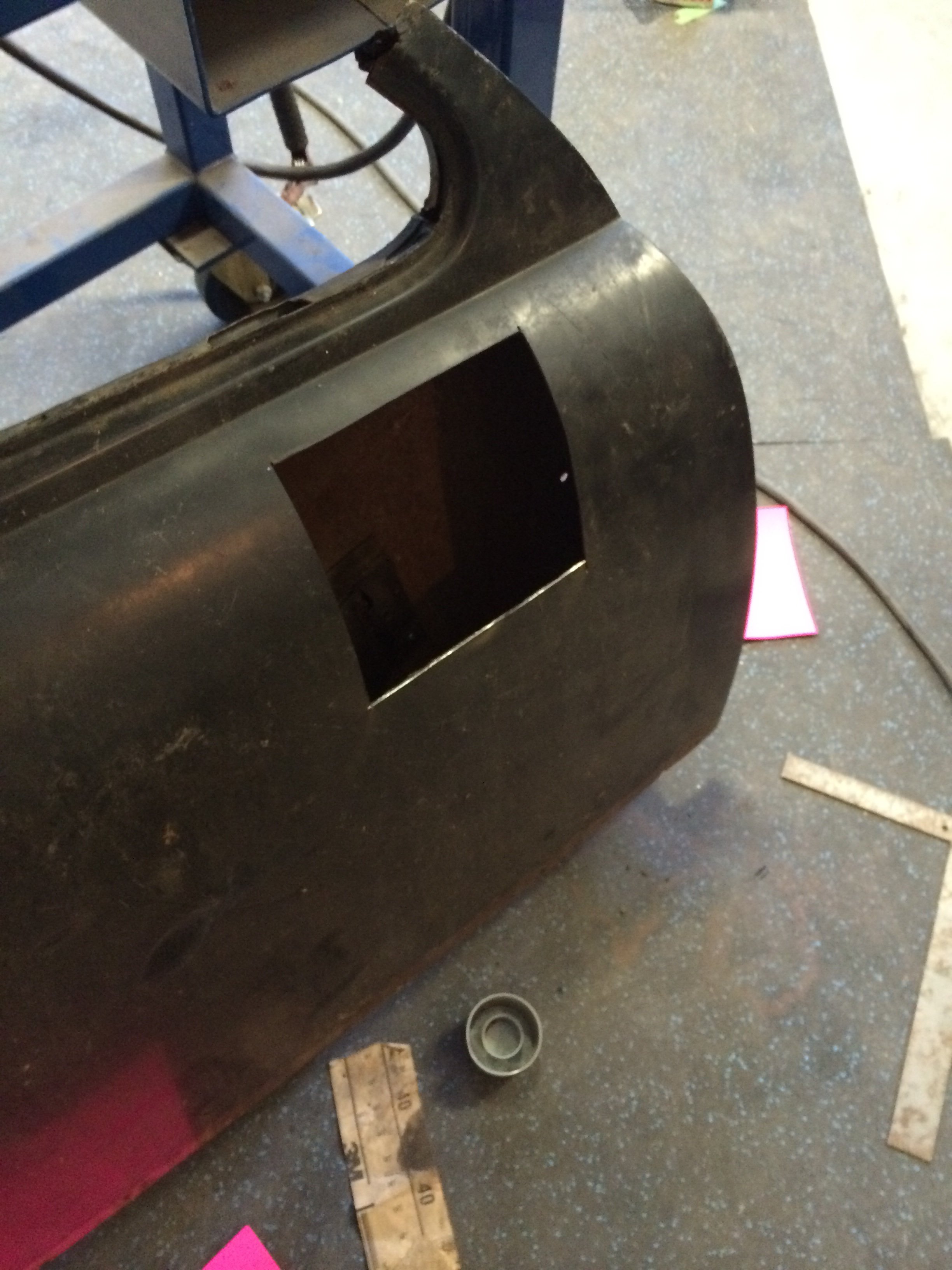

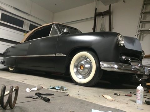

    image.jpg image.jpg image.jpg Lots of body work to do but I took it out and put the top down for the first time since most the mods began. Carson style top will be next on the agenda once I figure out what kind of $$$ I'm looking at.

  5. Finnrodder
    Joined: Oct 18, 2009
    Posts: 2,971
    Finnrodder
    from Finland
    Looks good again!
    Just wondering,are you going to get rid off the quarter top beads?
    I guess it could look like a smoother without it.

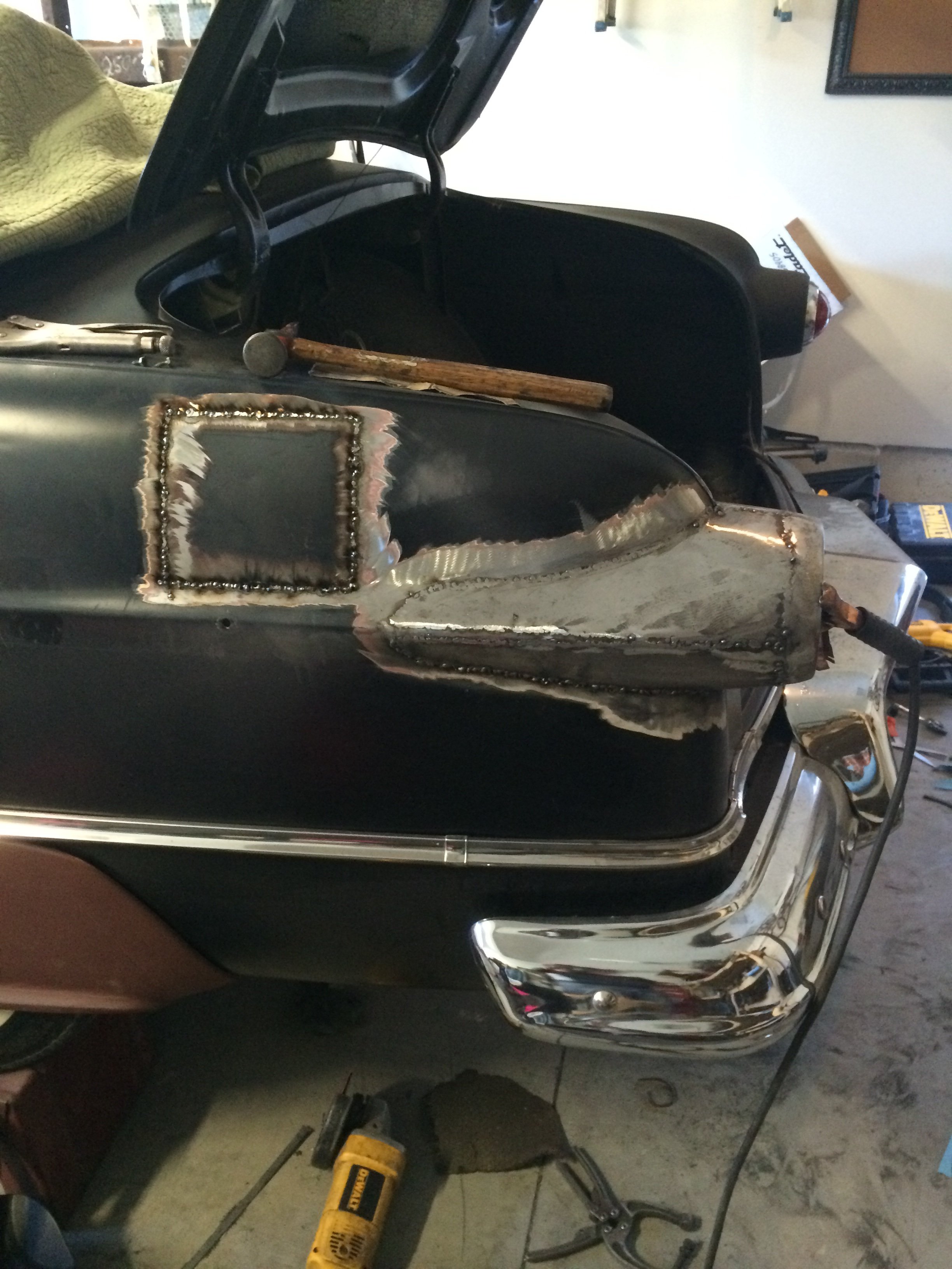

  18. Eric H
    Joined: Apr 2, 2006
    Posts: 975
    Eric H

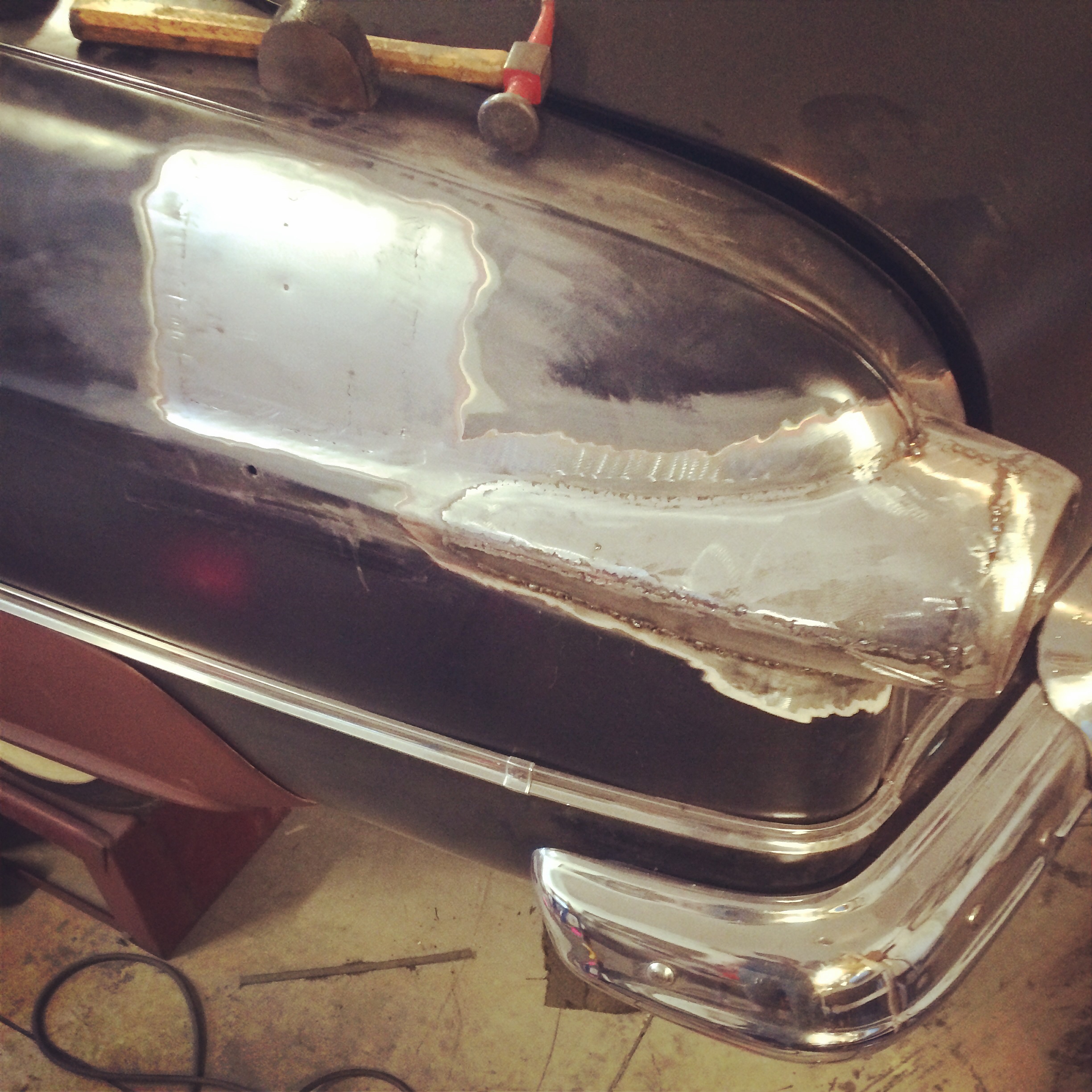

    image.jpg image.jpg Not very exiting but it's one step closer to wrapping up this quarter.
  19. Eric H
    Joined: Apr 2, 2006
    Posts: 975
    Eric H
    image.jpg Getting there

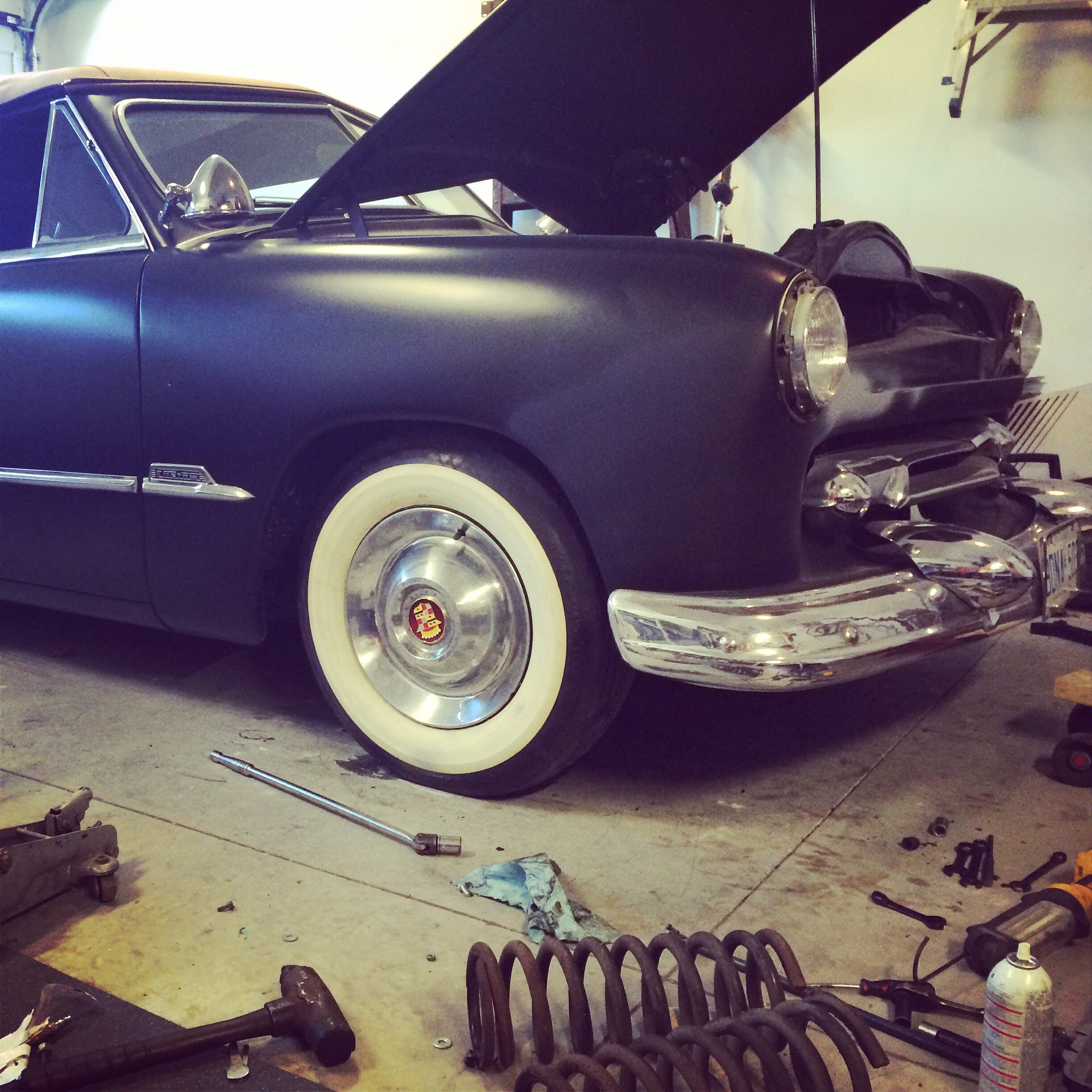

    image.jpg I finished converting my sombreros to fit the Ford style wheels and installed some Aerostar coils to lower the front a bit.
  24. 'Mo
    Joined: Sep 26, 2007
    Posts: 7,419
    'Mo
    All the right moves, Eric! (As always!)
    Those new springs will really settle in (down) with a little driving.
    Jumping up and down on the bumper just doesn't do it.
    (Speaking of the bumper, I've forgotten... What are those great Dagmars from?)
    Dual pipes in the hopper?
    (P.S., I can't wait to see the gas filler installed in the door!:D)
    Eric H likes this.

    Thanks Mo, the new right and left door gas tanks are going to by sweet. Lol. The Dagmars are NOS 53 merc ***s. Duel pipes in the spring probably. I lopped 8" off the tail pipe for now.

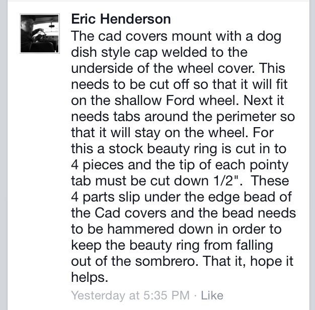

  29. Finnrodder
    Posts: 2,971
    Finnrodder
    from Finland
    Those sombreros looks great!
    I like to see how did you made the conversion for them,got any pics?
