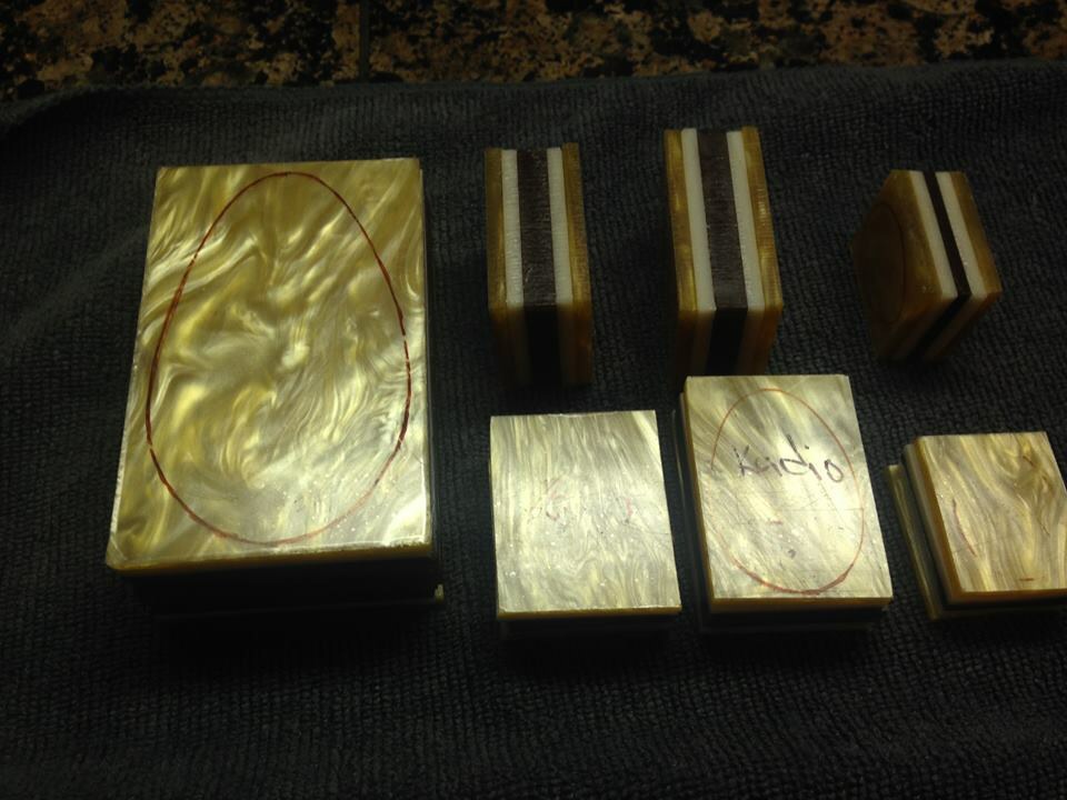

    Steering wheel and dash knobs are gonna look nice

    Thanks, he is making window crank knobs as well.

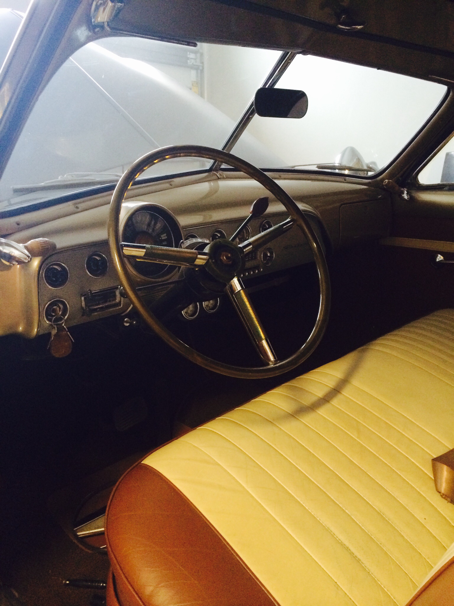

    Eric how do you get your legs under the steering wheel, looks like it's awful close to the seat. Did you change the keyed hub for the splined one and what was involved in doing so?

    Lol, I think that is an illusion. Yes we changed the hubs. We destroyed an old Ford wheel and removed the hub from the centre. We then set the Lincoln wheel up on a CNC machine and bored the centre out to match the Ford size. We pressed it in and TIG welded it from the back side. This could be done on a Bridgeport as well by dropping an end mill down through the Lincoln wheel.

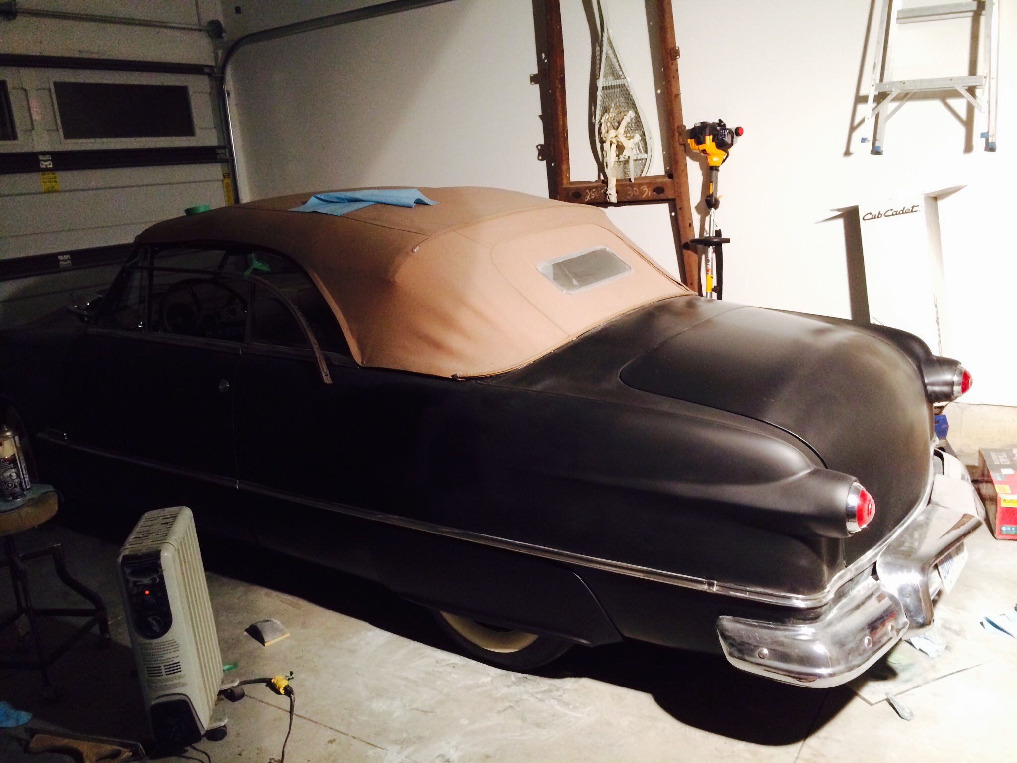

    image.jpg The trunk is back on and almost done.

    I also popped in some NOS lenses without blue dots. It looks a little cleaner I think?

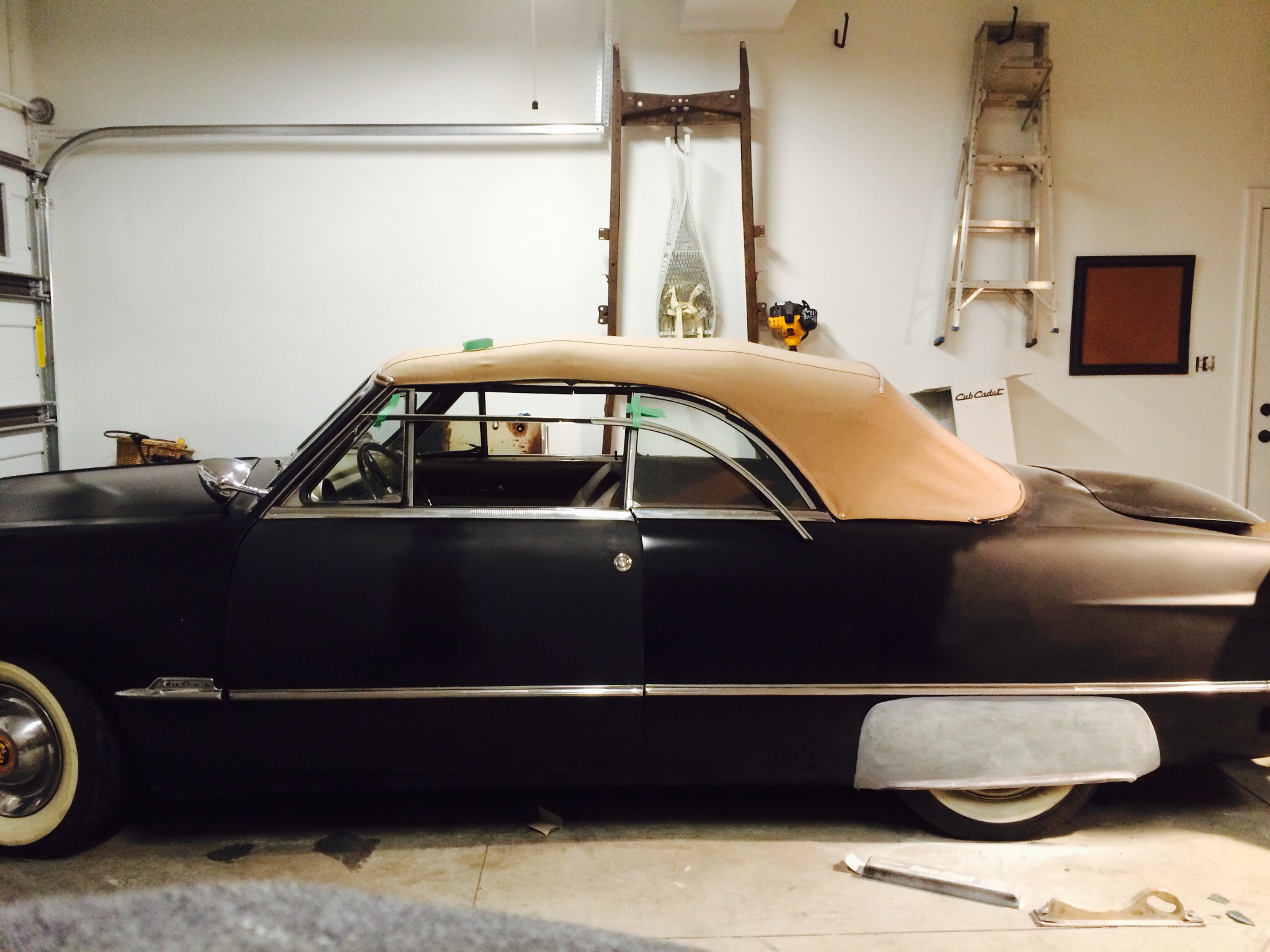

    image.jpg Getting the rear wrapped up.
