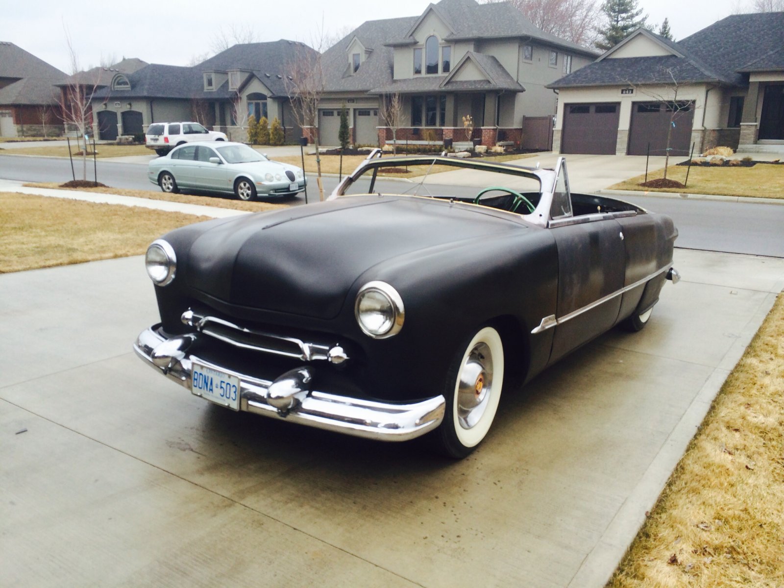

    image.jpg image.jpg Almost time.

    So here is the big question guys, pie cut to corners or lengthen the top of the frame?
  17. alchemy
    Joined: Sep 27, 2002
    Posts: 23,467
    alchemy
    Which is easier, tilt the door windows and wingwindows, or widen the top's header?
  18. Eric H
    Joined: Apr 2, 2006
    Posts: 975
    Eric H
    I need to cut up the header to get the dents out. Barn landed on it.
  19. Torchie
    Joined: Apr 17, 2011
    Posts: 1,099
    Torchie
    How much would you have to widen it?
    One of the things that I look at with a chopped top is to look at the windshield and see if the shape of the outline looks good.
    Some times when people relief cut the corners and then move the posts in or out it looks funky. At least to me.
    If you widened the top of the frame the corners will remain in their stock shape.
    And you have to cut up the header anyways......
    Hope this makes sense.
    Torchie
    Eric H likes this.

  21. T-DeWitt
    Joined: Aug 16, 2012
    Posts: 293
    T-DeWitt
    If it were me I would probably widen the top of the header then u won't have to **** with side window angels.
    hacknwhack and Eric H like this.

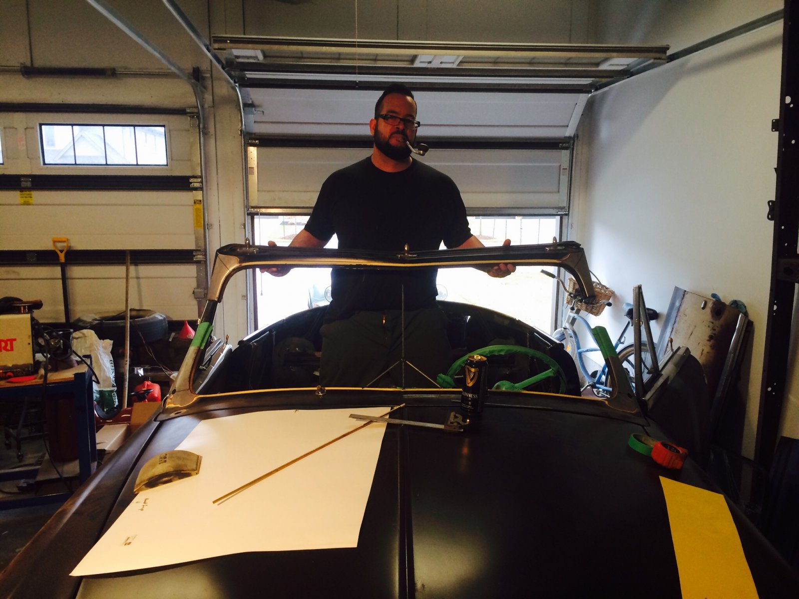

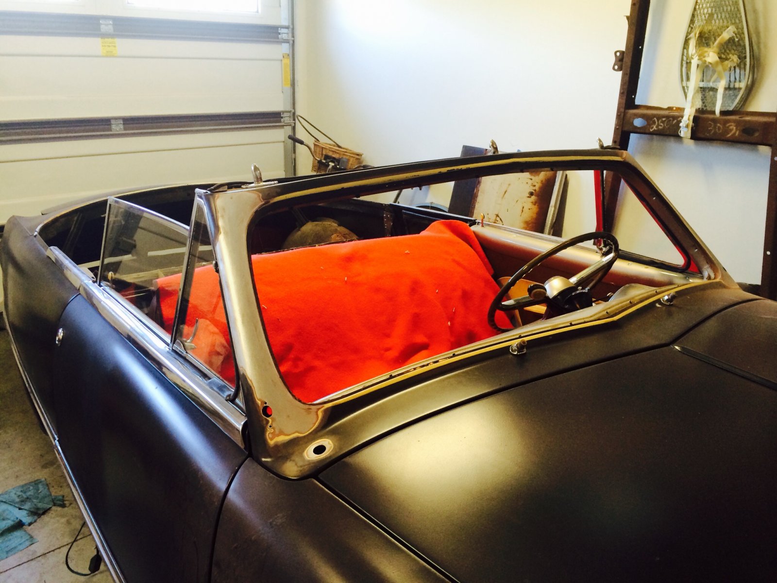

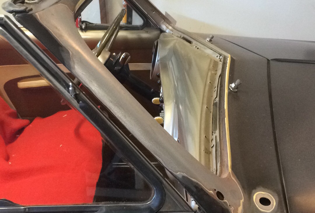

    image.jpg image.jpg image.jpg Well we took four inches out of the A pillars that worked out to a 3.5 vertical drop.

  29. Eric H
    Joined: Apr 2, 2006
    Posts: 975
    Eric H
    image.jpg I was basing mine roughly on Chuck Dewitt's car James. Do you think it's more than his?
