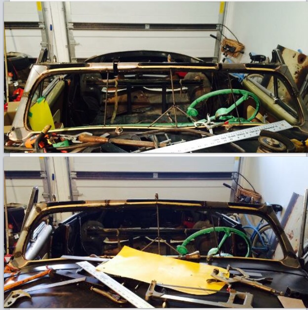

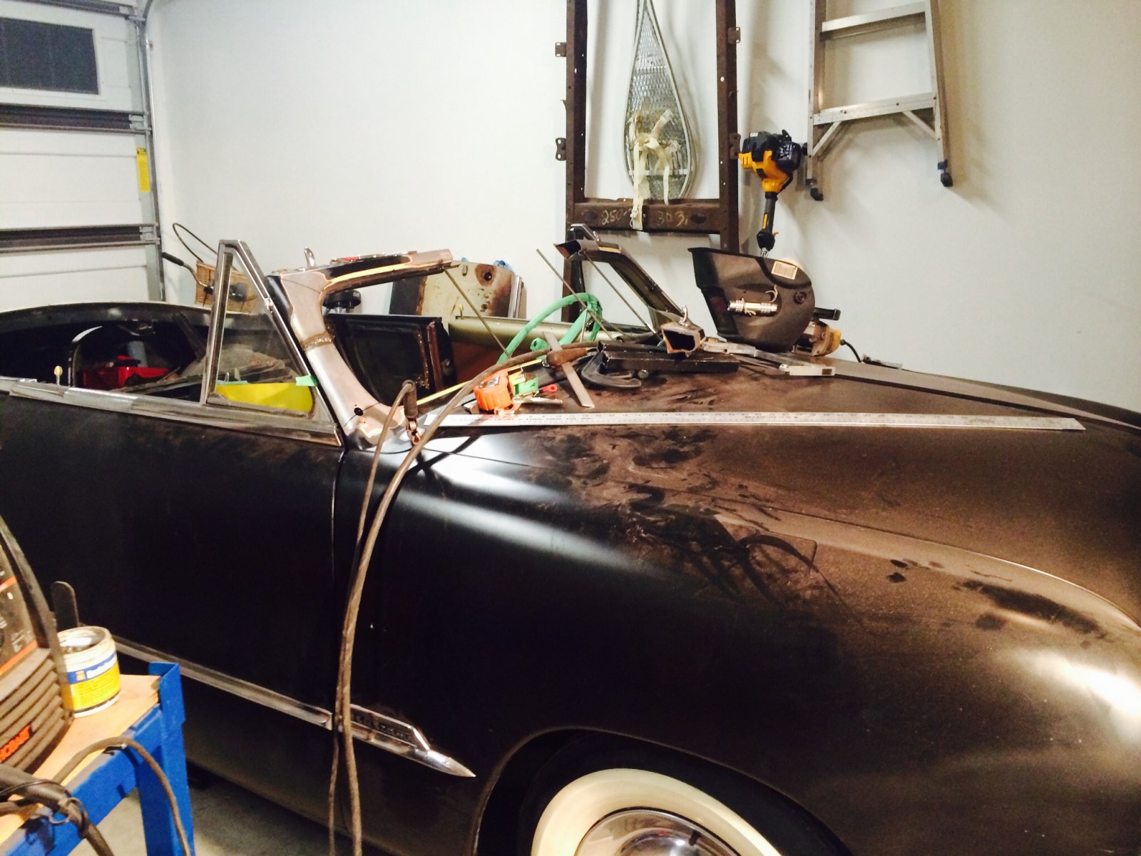

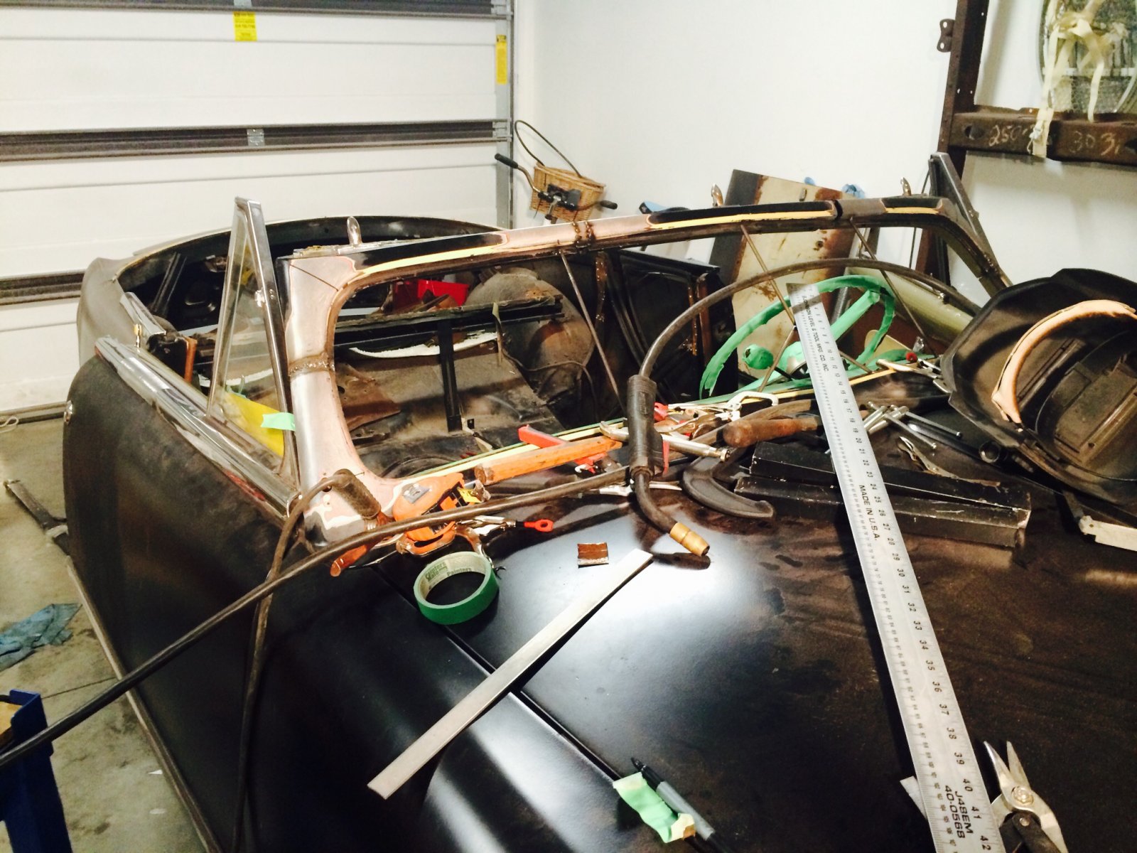

    image.jpg image.jpg image.jpg image.jpg So I decided to widen the frame 1.5" in order to drop it 4" strait down. It's starting to shape up.

    After some good advice from Rik warning me that this approach may leave my roof looking too fat and flat up top I will be cutting this up again lol. Back at it tonight I hope.

    I saw his post about this on the CCC forum. All the respect in the world for Rik and his great eye for chops but having seen this type of chop done both ways I feel that it is all in the eyes of the beholder.
    What is equally important in weather or not your top looks Fat and Flat will be the shape of the top it's self..

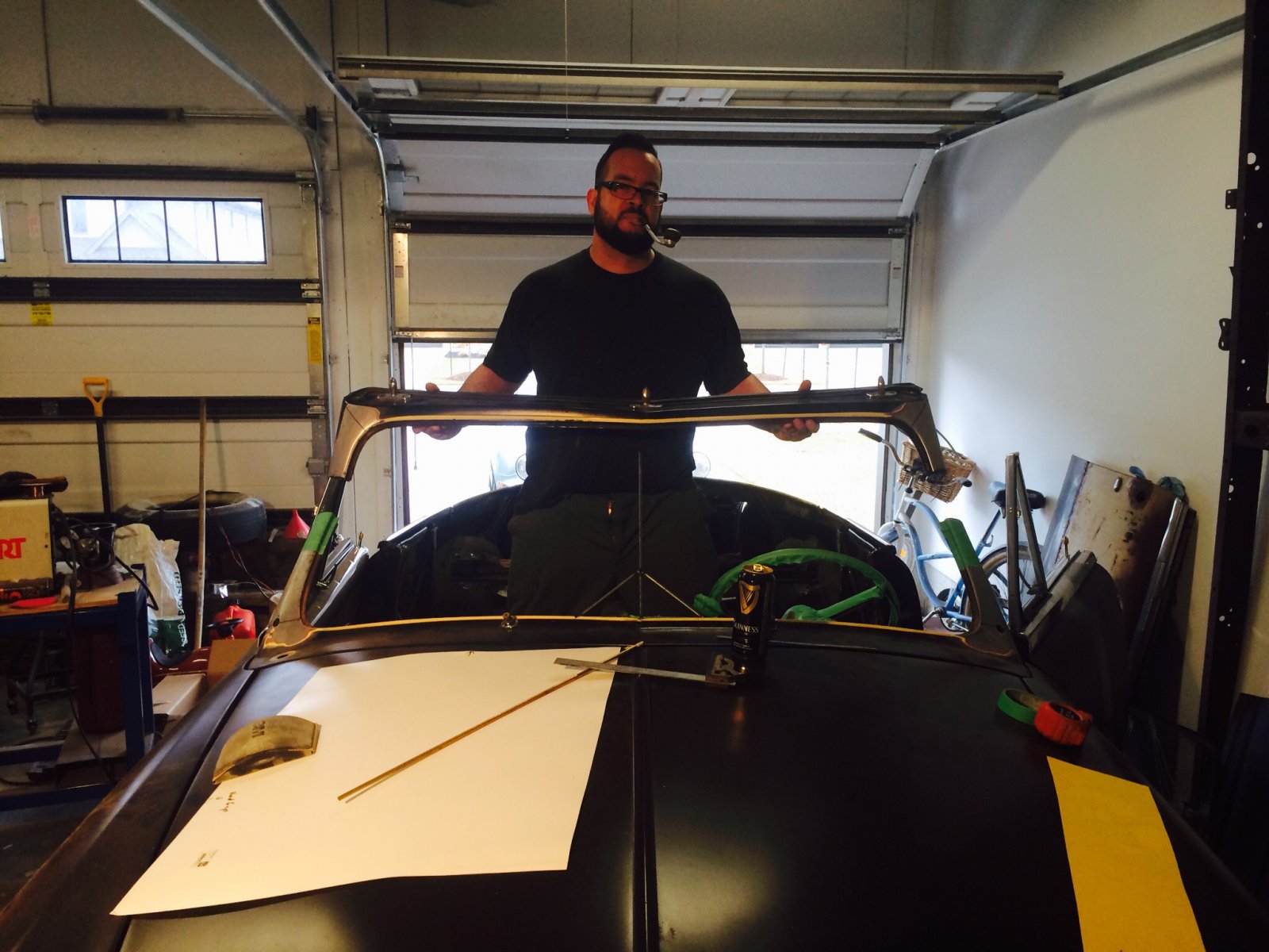

    I think that before I went to cutting and redoing the frame I would get some wooden strips or metal rods and do a quick mock up of the top to really get a good idea.
    Just my 2 cents....

    Good advice Torchie. I've been thinking bout this all morning and put my thoughts on the CCC. Prior to undoing what has been done . . .

    It can be hard to see from photos taken at some strange angles due to lack of space in the garage.Best thing is to mock it up and take it outside and look at it from a distance of 30 feet or so. Walk around it and have a look from every angle and don´t rush. Let the wiev sink in.This is a tricky part of the build but oh so important that it gets right and right in this case are in the eyes of the beholder so I will say follow your gut. As I said over at CCC there´s a risk it might look fat but it´s your choice .

    ^^^ Exactly. Standing well back and eyeballing is the only way to make it look right. Make up your side bows, then start mocking up cross bows with conduit until you get the crown of the roof to look right. My '56 Caddy had a 4" chop, and I widened the w/s frame. While I had a folding top instead of a lift off, it took a lot of re-arching the '68 Catalina top bows to make it look like it hadn't been "stepped on". Conduit and lots of masking tape are your friends when making a top!
