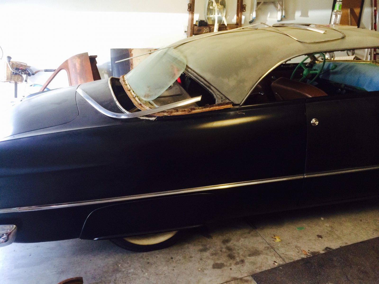

  9. Eric H
    Joined: Apr 2, 2006
    Posts: 975
    Eric H

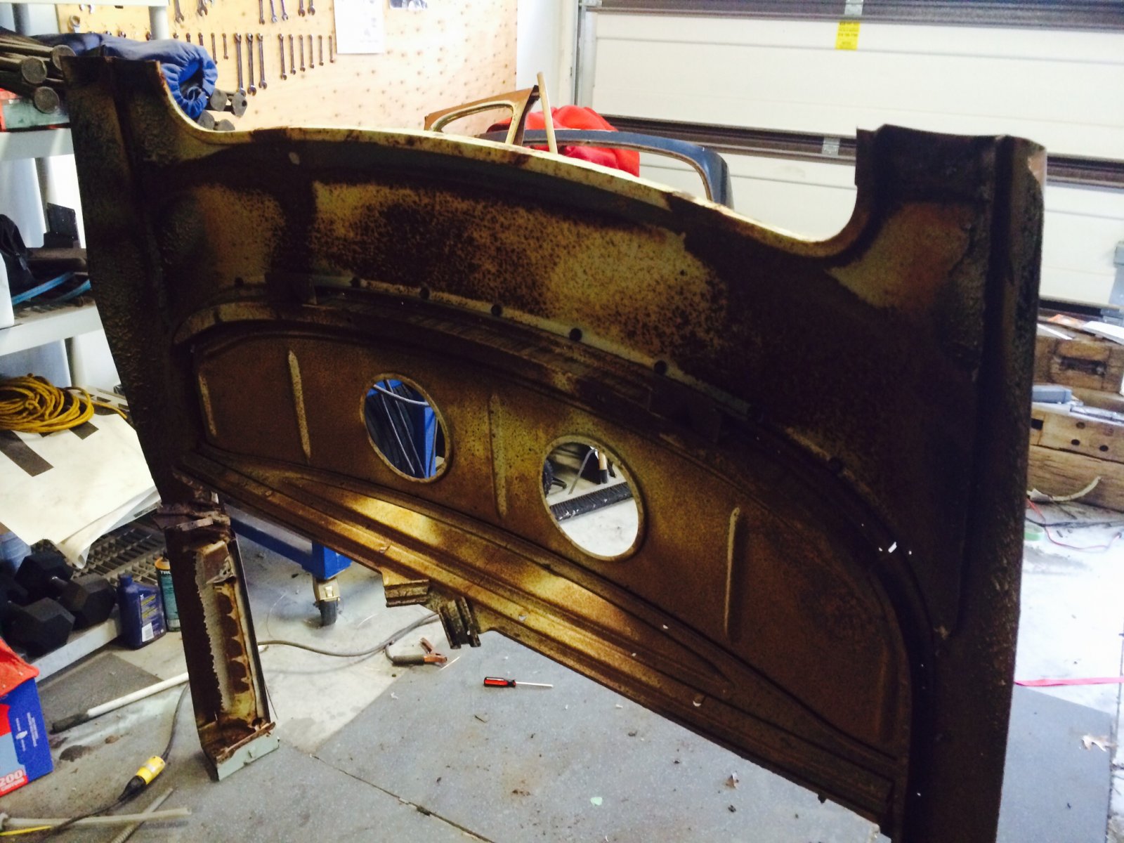

    image.jpg image.jpg Cutting and fitting the 51 convertible to fit in to the hardtop.
    dlandberg and vwdave30 like this.
  10. Eric H
    Joined: Apr 2, 2006
    Posts: 975
    Eric H

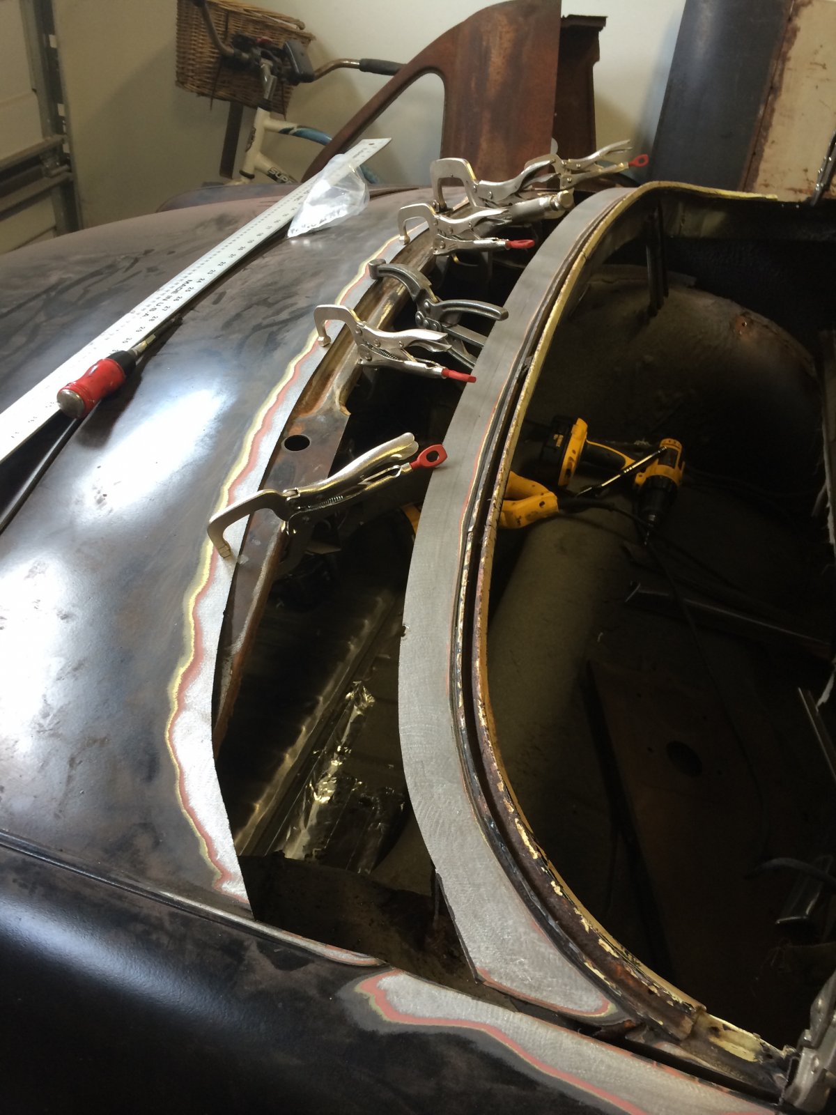

    image.jpg Trial fit
    dlandberg likes this.

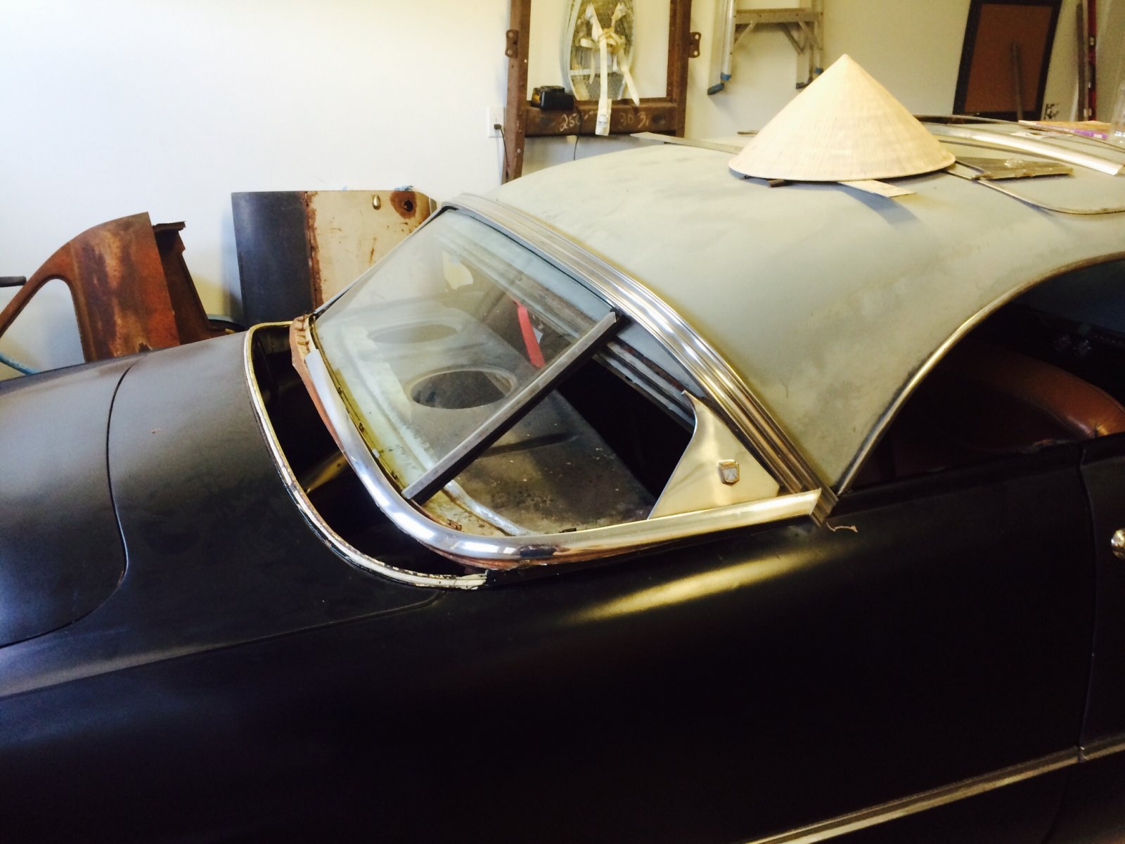

  11. Eric H
    Joined: Apr 2, 2006
    Posts: 975
    Eric H

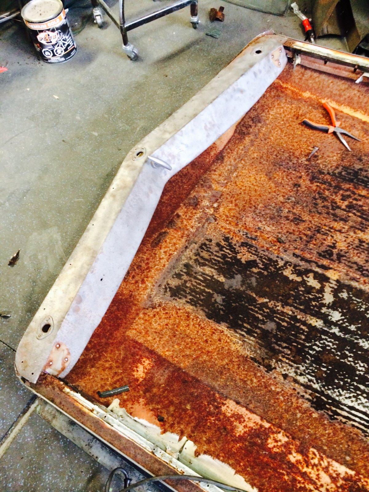

    image.jpg Now it's time to trim and integrate this beast.
  12. Eric H
    Joined: Apr 2, 2006
    Posts: 975
    Eric H

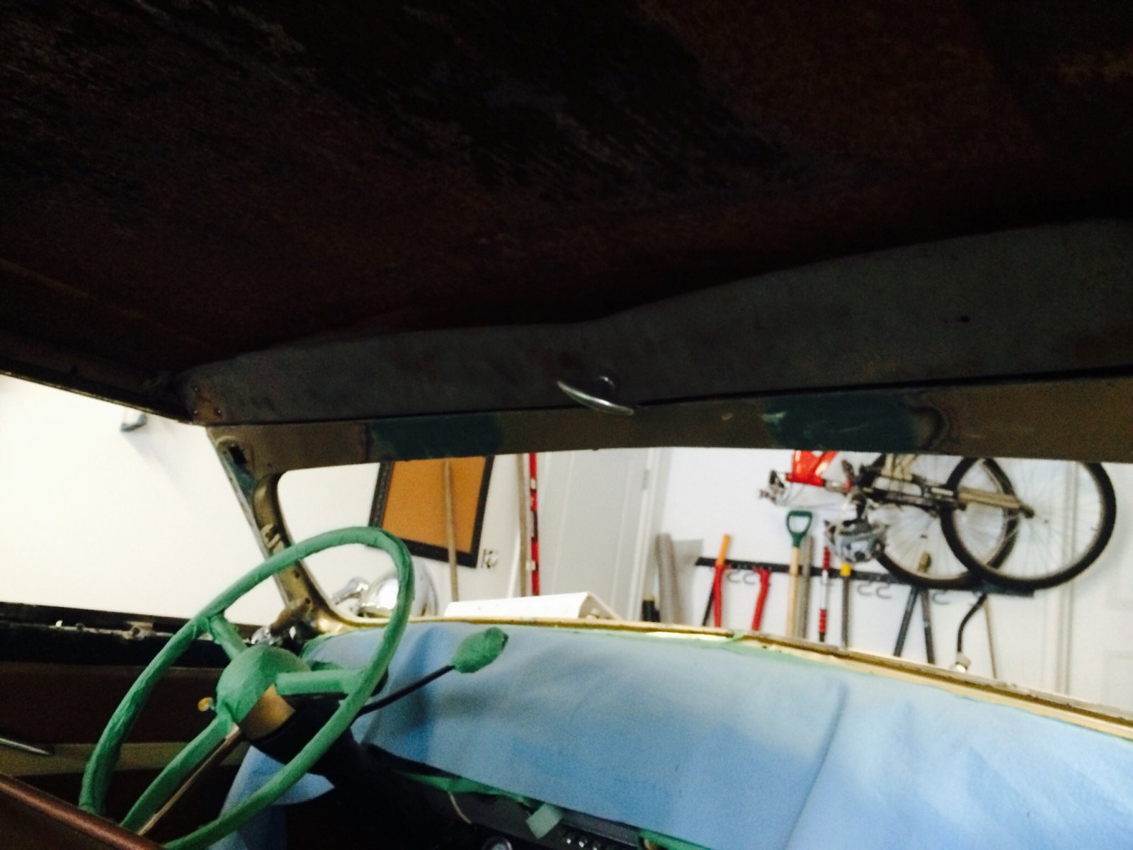

    image.jpg image.jpg The great debate wages on in my mind.
    daddio211, dlandberg and vwdave30 like this.
  13. CHOPMERC
    Joined: May 11, 2001
    Posts: 992
    CHOPMERC
    I personally think the sedan window looks wrong on a Vic roof. I'm a big fan of the style and the stainless trim which you can't use without that window. The car looks gorgeous though. Great work. ImageUploadedByH.A.M.B.1432931516.026335.jpg
    Thulsa Doom, vwdave30 and Eric H like this.
  14. Eric H
    Joined: Apr 2, 2006
    Posts: 975
    Eric H
    Thanks!! Your car is great!! Is your window gl***?
  15. James D
    Joined: Feb 8, 2007
    Posts: 5,132
    James D
    Another vote to go for the Vic wrap around window. As shown in the last photo there /\ where the B pillars go to a point, it would look great.
    ynottayblock and Eric H like this.

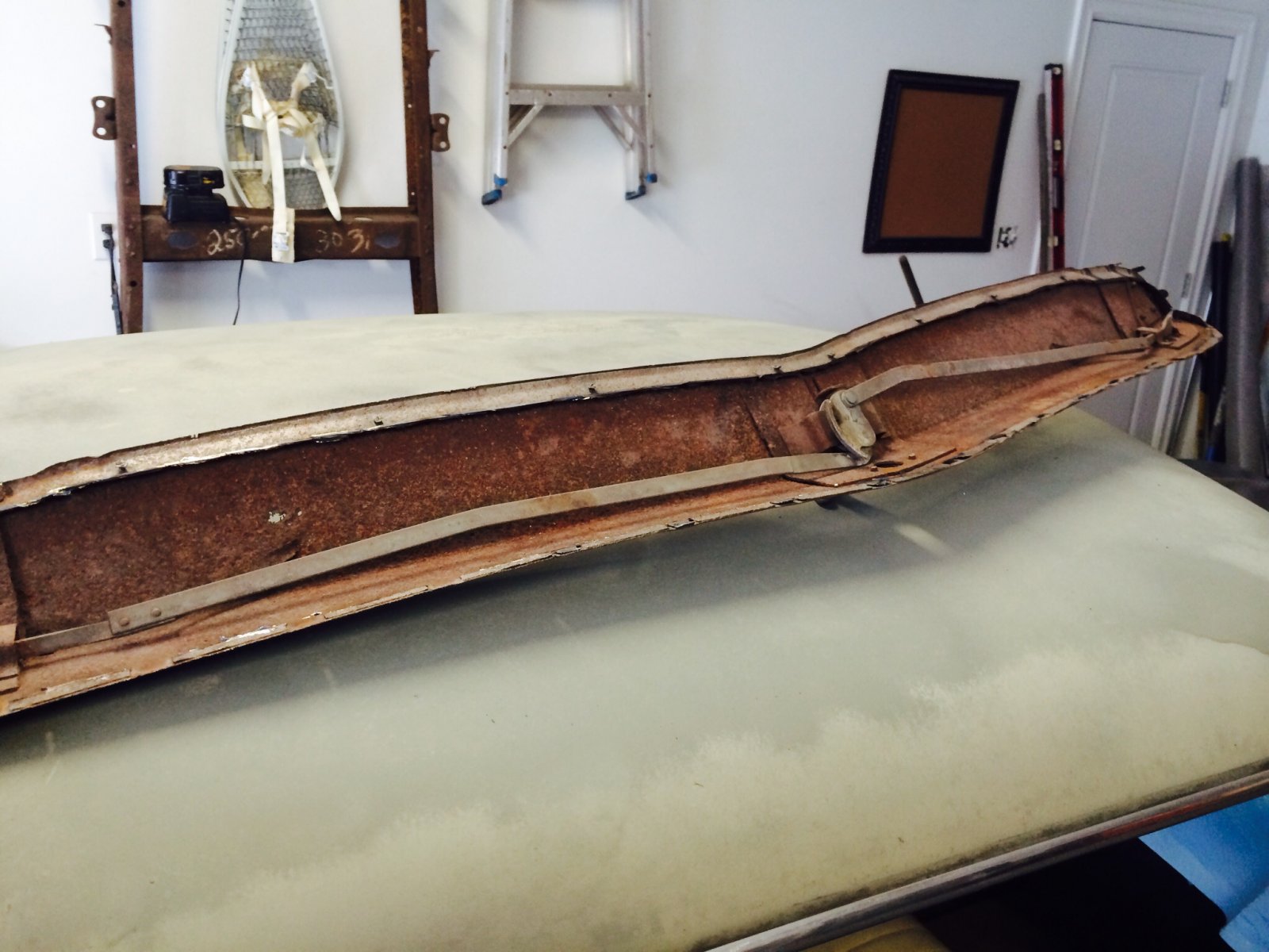

  17. Eric H
    Joined: Apr 2, 2006
    Posts: 975
    Eric H
    image.jpg image.jpg 5" stretch on the catwalk. I have an extra Victoria catwalk brace that I'm using to support the trunk hinges.

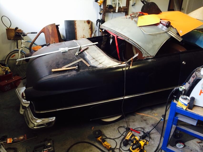

  23. Eric H
    Joined: Apr 2, 2006
    Posts: 975
    Eric H

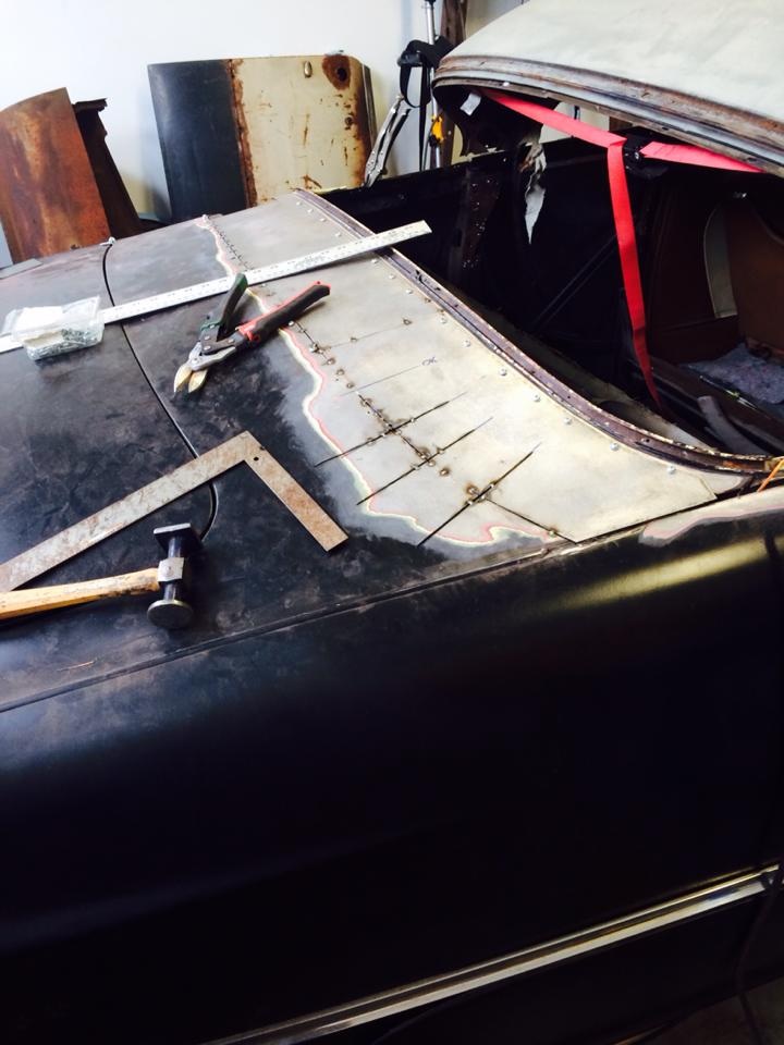

    After rebuilding the structure below the skin I began to fill the catwalk. image.jpg image.jpg
    1952B3b23, dlandberg and vwdave30 like this.
  24. CHOPMERC
    Posts: 992
    CHOPMERC
    Very very nice. Can I ***ume you're leaving the wrap around gl***?
    Eric H likes this.
