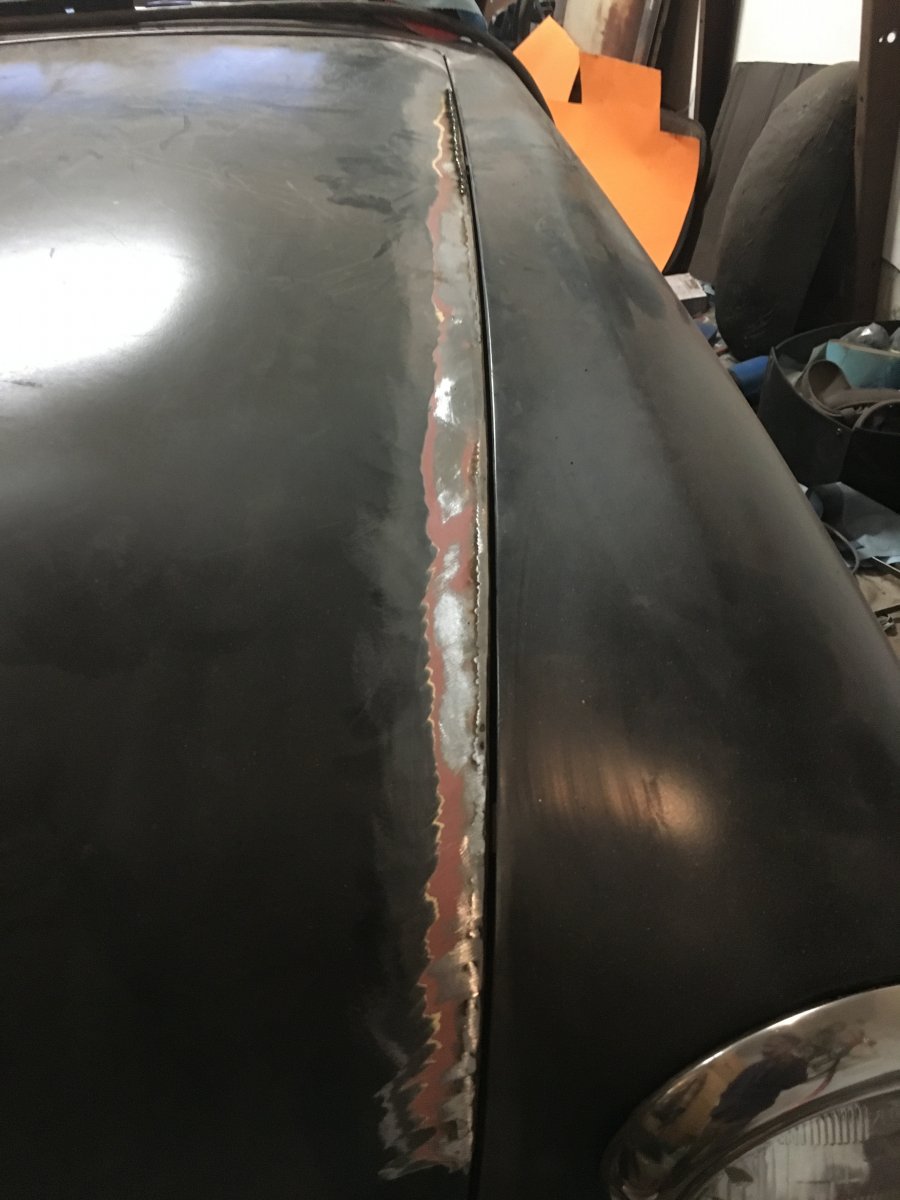

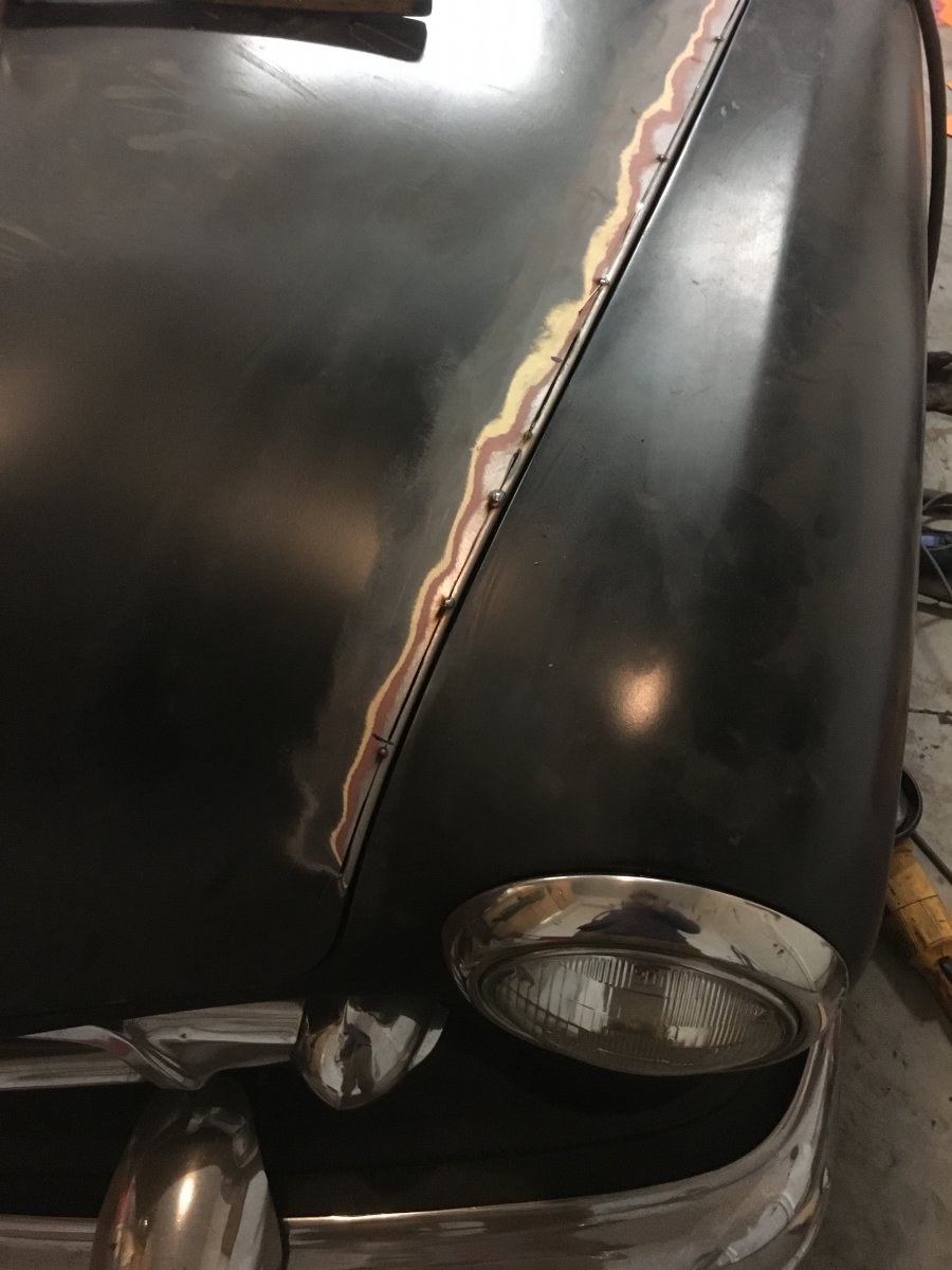

    He is widening the hood gaps by cutting out a thin strip (the width of the cut off wheel) hammering the outside flange in to eliminate the gap created by the cut off wheel and then welding it back together again. Conversely if he was trying to reduce the hood gap he could do the same thing but push the flange out and put a filler strip of metal in the gap created and again weld it back up.

    Ok that's what I thought was going on. Thank you for explaining it. Is there a good tutorial somewhere on here I could get some more pointers on before trying it on my car?
