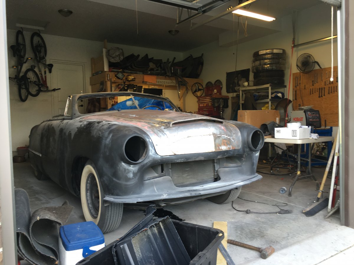

  8. Eric H
    Joined: Apr 2, 2006
    Posts: 975
    Eric H
    Split the banana shaped rocker and added some metal in order to get everything on the same plane prior to molding the fender to the rocker and rounding the door corners. image.jpeg image.jpeg image.jpeg

  9. Eric H
    Joined: Apr 2, 2006
    Posts: 975
    Eric H
    image.jpeg Corners turned out nice.

  10. Eric H
    Joined: Apr 2, 2006
    Posts: 975
    Eric H
    image.jpeg Started to strip the hood of its Mercury and Ford paint. I should have it finished this week and back on for finishing.
  11. dlandberg
    Joined: Mar 14, 2012
    Posts: 364
    dlandberg
    from Sweden
    Amazing job! Going to be one of the historys most well built shoeboxes!
    Eric H likes this.

  13. Eric H
    Joined: Apr 2, 2006
    Posts: 975
    Eric H
  14. dlandberg
    Posts: 364
    dlandberg
    from Sweden
  15. Eric H
    Joined: Apr 2, 2006
    Posts: 975
    Eric H
    Thanks. The hood wound up pancaked an inch or two so the car feels a little wider.
    dlandberg likes this.

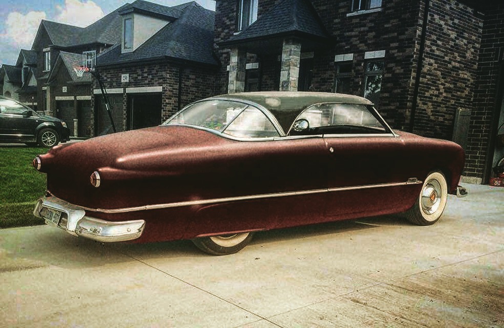

  19. Eric H
    Joined: Apr 2, 2006
    Posts: 975
    Eric H
    I think it's going to end up in hot rod flatz for now. Similar to this.
  20. dlandberg
    Posts: 364
    dlandberg
    from Sweden
    Eric H likes this.
  21. Eric H
    Joined: Apr 2, 2006
    Posts: 975
    Eric H
    Thanks man. I can't wait to get it back together.
