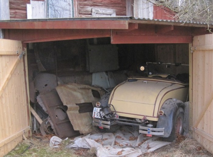

    This is what i picked up 2005.

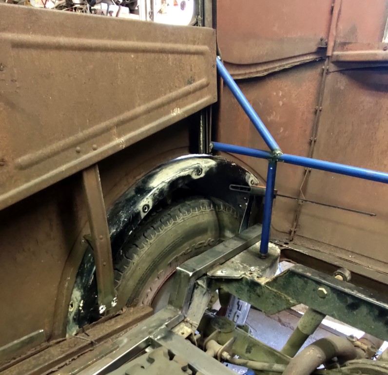

    When i had the car i the garage, i positioned the body so that the hood fitted to the radiator and the Tudor body. And made my first two body mounts, since i have a 50x100x3 mm square profile home built frame with a fibergl*** body fitted. The original body mounts did not fit, o i made my own.
    Then i had to strengthening the rear, with some 20x40mm tubes.
    Fitted my 10.50x31 x 15 rear tires and they hit the original fender well and i could not use the Tudor rear fender mounts, so i cut them out before i strengthened the rear (mistake).
    The tire will grind against the original rear fender mounts.

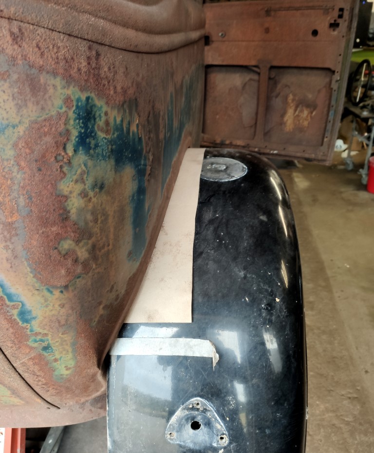

    So i used my Roadster fenders instead.
    Since paper is cheaper than steel i made my paper patterns.
    Transfered to to my 1mm sheet on steel.[​IMG]

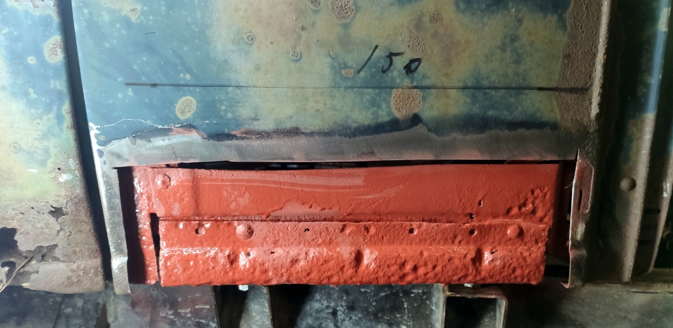

    Now it was time to repace som rust.
    Marked 150mm from the bottom, so i should know where to place the new part.
    Took a peice of cardboard, scribed the radius from the rusted part, with the back-end of a screwdriver.
    Bent a 90 degree peice in the bottom.

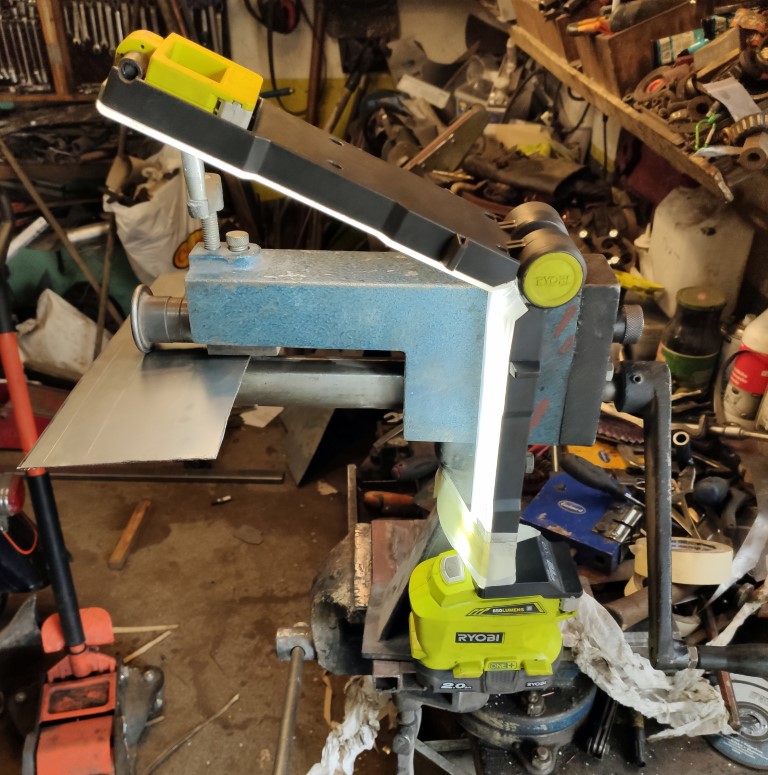

    Used my cheap China bead roller to make a bead in the bottom
    Tried on the body.
    Had to do some minor rust repair on the inside.
    Then i welded it in place.
    A small start.

    Since this part was straight, i made it myself in the bead roller, and since i am an old fart i need LIGHT :)
    Bended the bottom in my homemade angle iron "bender", and checked against the original part.

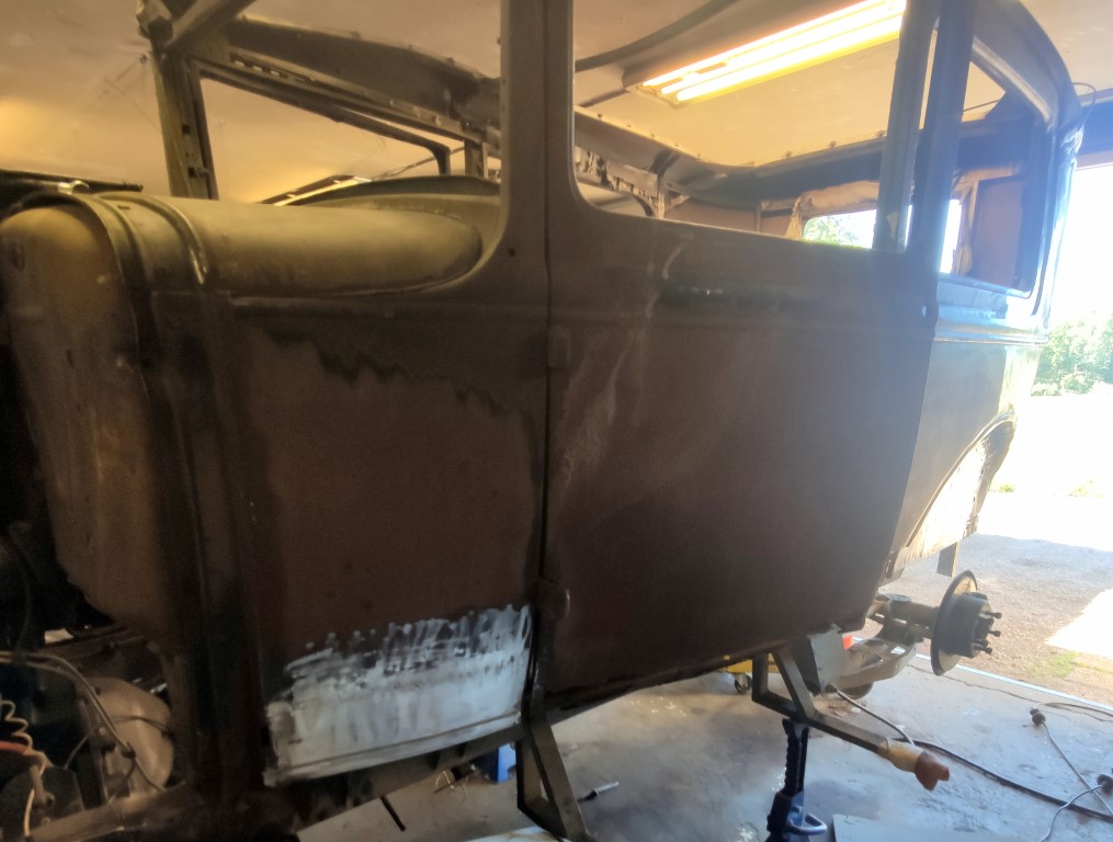

    Cleaned and primed the inner parts.
    Fitted the panel on the inside of the body, so i could scribe a line where to cut.
    And welded it into place, guess i need a small amount of mud.
    Since the right door is the worst one, I went over to the left side.
    Remove the bad.
