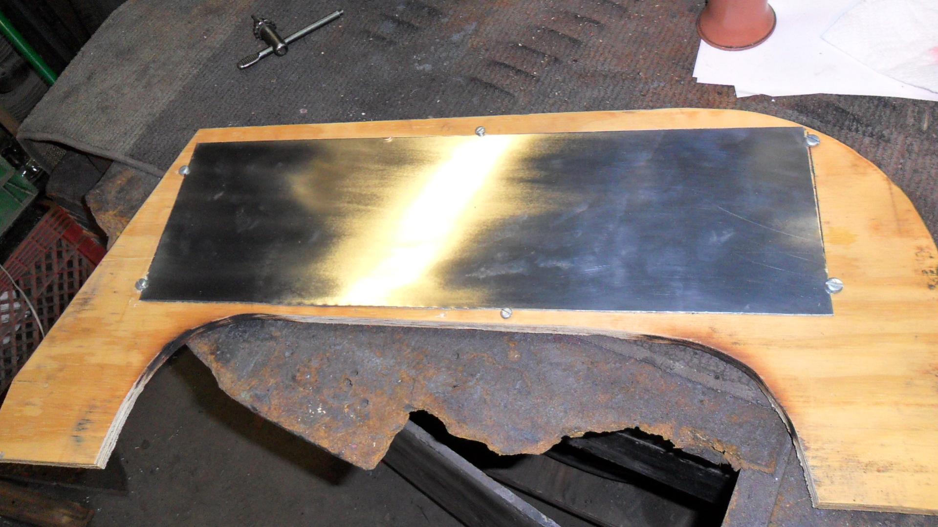

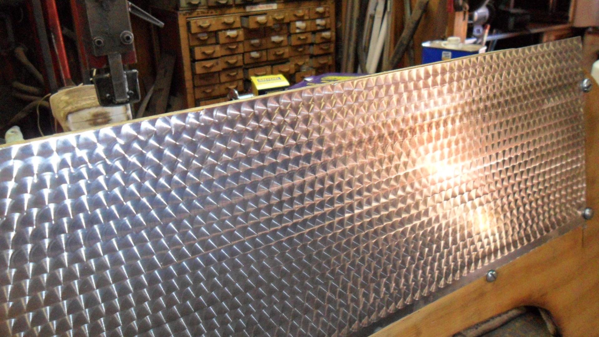

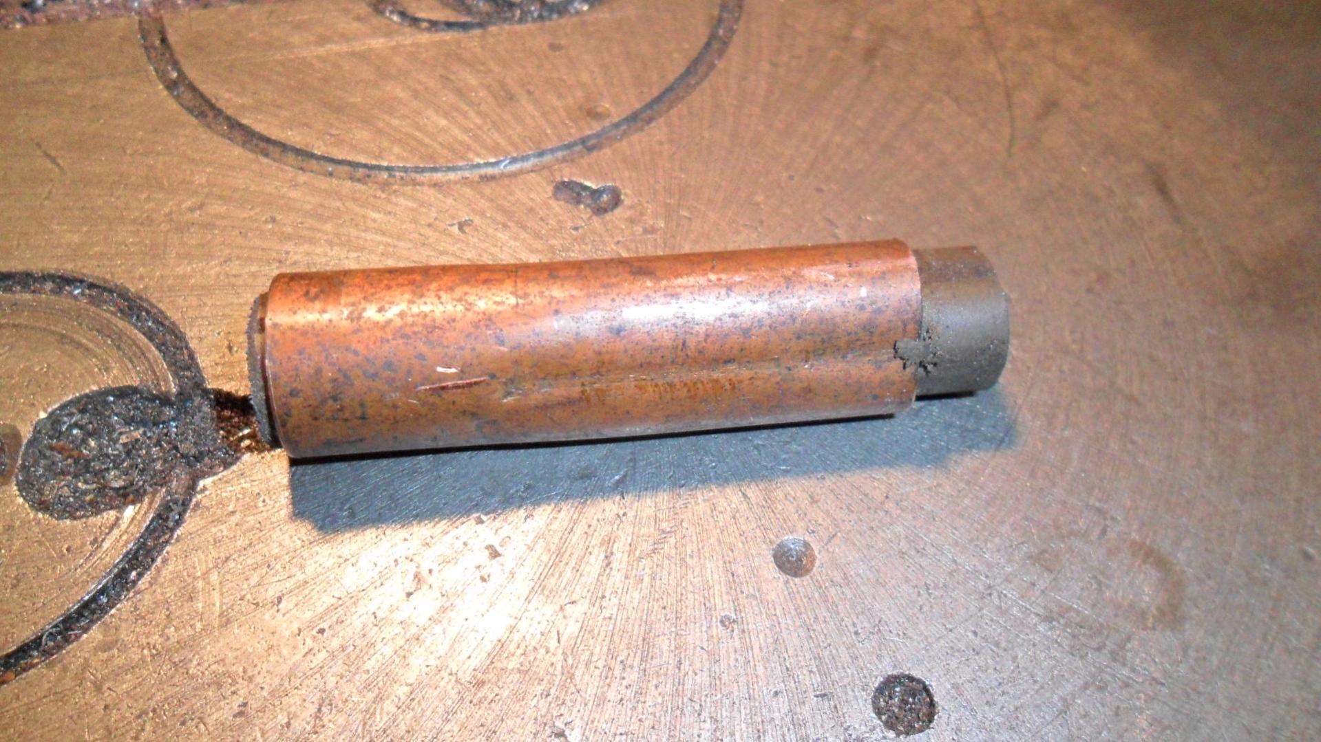

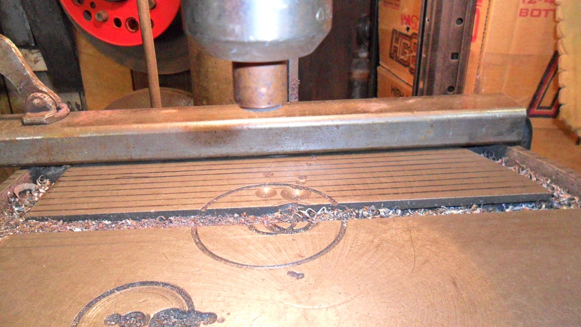

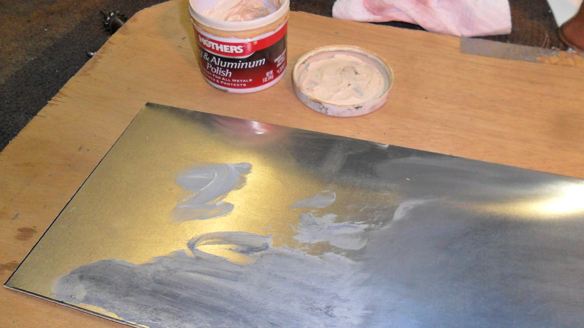

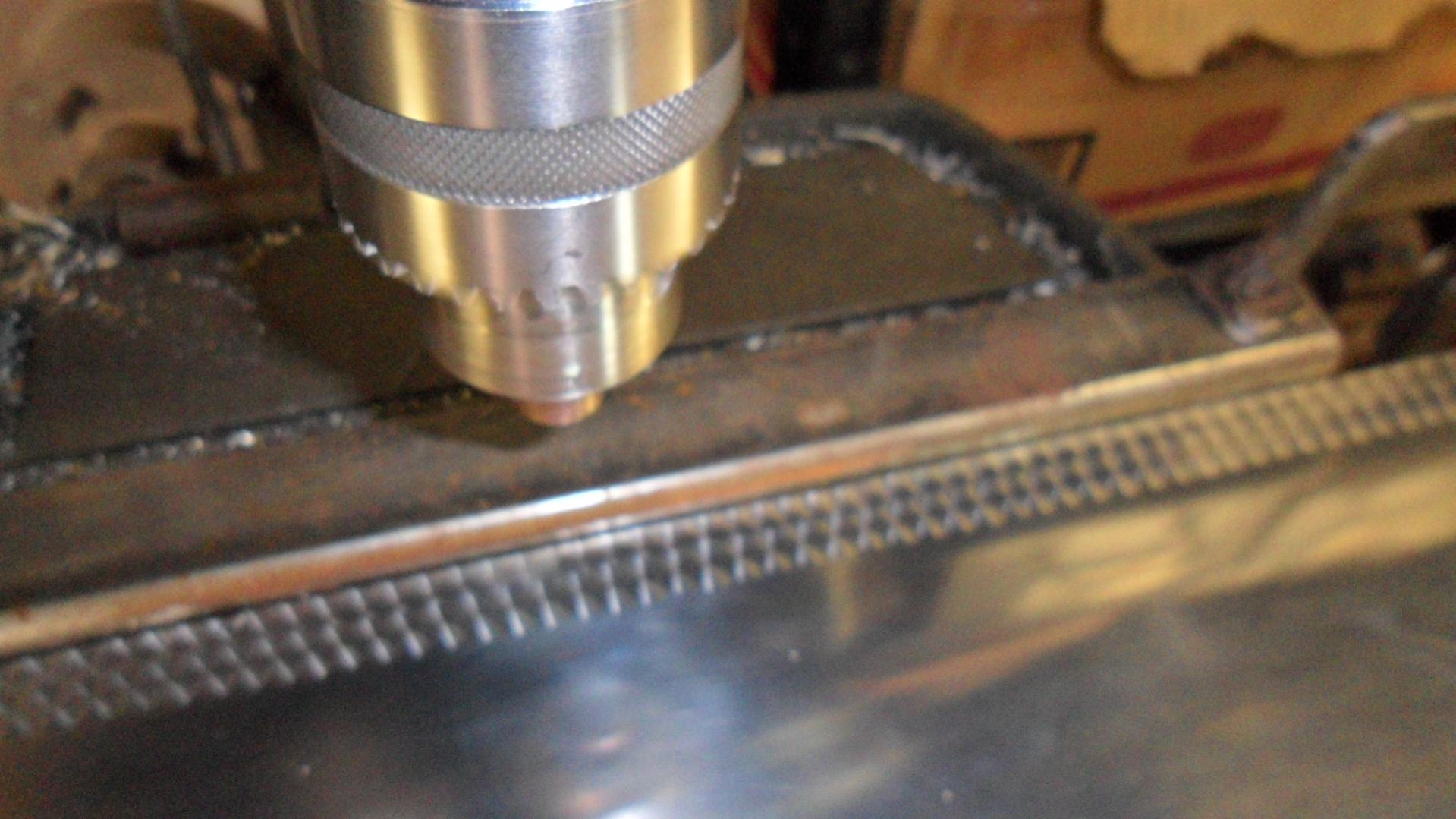

    Thanks Rob! Glad to here your pleased with your hood sides.
    Because you asked, I'll give the quickie on engine turning.
    The very first step on this stuff is too polish what ever material your working with. Engine turning can be done on damn near any metal out there, but I find polished aluminum of a high number grade (this is a s**** of 7071 .050 stock) is easiest to manage. Besides, that's what I had. You will need a drill press, a Craytex stick (or of several other abrasive means), a piece of s**** wood to fasten your work piece too that is a bit larger than the piece itself with at least one square edge, a marker and a ruler.
    You fasten your work down to the section of board stock so that you have a handle of sorts to work with. I used the long straight square edge of an old hammer form I used to build a belly pan for a customers '32 Ford truck for a bit a go, proving once again, I throw nothing away.
    I have in years past simply free-handed my pattern as I worked, but with Judy doing some of this, and my eyesight slipping a bit, I decided a guide system of sorts was truly in order. I made this with two clamps and a chunk of 1"X 1 1/4" steel tubing.
    Finding Craytex products these days can get a bit hard locally, but companies like McFadden - Dale Industrial Hardware, and McMaster - Carr always seem to have quite a selection in stock. It is an abrasive imbedded in a rubber stick, much like a course pencil eraser. I have also done this with a wooden dowel and valve grinding compound, a small Scotch Brite abrasive pad, and even a 6" D.A. pad with 180 sandpaper. This particular Craytex stick is 1/2", and since it's a bit flexible, I slid it into a stick of copper tubing I had around the shop the stiffen it up a bit.
    The basic process is simple, the top row you start at the upper left corner, pull the handle and touch the spinning Craytex stick to your material. Holding the board against the guide tubing, move the whole thing over 1/4" so the next swirl overlaps the first by 50%. Repeat! Matter of fact, repeat lots! when you get to the next row, move your tubing guide up 1/4"(that's what the measuring stick and marker are for), and start anew. This time and every other swirl you make will be overlapped by the same 50%, but in moving the guide up only 1/4", you are also overlapping the bottom of the previous row by 50% too. The net effect looks less like scales on a fish where they are each a visable half circle, but more of a 1/4 circle each. This to my eye give more "faceting" for the lack of a better term, and a more "industrial" than "organic" look.
    Very Important! Do not hold the Cratex stick o the material too long in any one place as it will heat the metal a bit and slightly burnish it. Some of Judy's first rows got a bit dark, and it freaked her out a little. It's also a very good idea to take a small chunk of say 180 grit sandpaper, and after each row is completed pull the handle down and clean and square the Cratex's tip before starting the next row. Our burnish spots will be where the gauges go, so I wasn't worried too much about it.
    Just to give a quick idea of how long this takes, this is 18 1/2" inches by 5 1/2", and each row takes about 7 minutes to complete so that's what, 22 rows? 22X7 puts us at 154 minutes, so roughly 2 1/2 hours to do. The same sheet could have been bought from Speedway for about 65.00, but now ours has a story, and cost "0"...
    Unfortunately, 'cause I was dragging her out into the shop at about 5AM (a truly strange, unfamiliar time frame for your average CHANNEL cosmetics rep!) and she wasn't made up yet, Judy refused to let me photograph her working on this project. I really think she might be evil, as even the photographs that I tried to sneak of her came up with no discernible image...
    Click on the images and they will get huge!

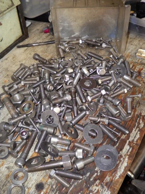

  5. Do a search, there are several good turning threads.
  6. Louvers, this is some of the best advice you can give the young ones!
    Hardware can make or break a project, I've gotten to the point I hardly ever reuse hardware.
    And I've gotten so that I don't even think of H/D or Lowe's anymore. I'll drive twice as far to the Ace across the lake from me to get my hardware.
    They always have what I want, and the people there know which end of the bolt the wrench goes on.
    And, BTW, spend the extra money for grade eight. In the scheme of things it's not that much more.
  7. need louvers ?
    Joined: Nov 20, 2008
    Posts: 12,901
    need louvers ?
    I was going to say something about hardware grading, but stopped because I almost always use strictly grade 8 fasteners in small cars like T-Buckets. The reason I stopped myself with that, is I honestly can't recite load ratings and such for all the different grades, and as I am not an engineer, I am not properly equipped to argue the point with someone who is. I use Grade eight in suspension stuff on T-buckets simply because its tensile strength vastly exceeds even the momentary shock loads the weight of a small vehicle like this can impart. Yes, at extreme loads a grade 8 fastener can become brittle and snap instead of bending, but at what point are you so far beyond what's survivable in a small car like this? I hate to think in terms of that being a possibility, so I prefer the thought ElPlolacko and I came up with about twenty years ago when we were learning this stuff... Build to exceed the need! Or too much is just enough!
  8. Mr48chev
    Joined: Dec 28, 2007
    Posts: 35,969
    Mr48chev
    On a side note Fasteners will sell you however many or few bolts and what not you want. Fastenal on the other hand (here locally anyhow) will only sell by the box quan***y.
    On Grade 8 bolts, Cat Equipment (bulldozer store) has a great selection of grade 8 bolts.
  9. I totally agree! I hear people say stuff about Grade 8 hardware being brittle and I just roll my eyes. IF (and I emphasize IF) you can survive the crash that shears your Grade 8 hardware, than you are a lucky soul that should immediately go out and buy a Lottery ticket and dance in a lightning shower with a golf club.
    I have worked in around aircraft for over 34 years (10yrs in the Air Force on fighters, and 24 years in the Aerospace industry), and every structural fastener we use greatly exceeds a Grade 8. We use lots of exotic fasteners made from ***anium, Cres, Inconel, and other materials. Think about this: Why would any manufacturer use a sub-standard fastener when you could run the risk of losing an airplane or worse yet, the loss of lives? If a lower grade fastener is softer and is less prone to breakage(!), then why don't we use Grade 3 bolts on all of the wing mounts, engine mounts, and flight controls? Because the first time the airplane hit turbulence, it would come apart. Although an automobile rarely sees the stresses that an aircraft undergoes, over the life of a vehicle, it starts to add up greatly.
    I have been around a lot of crash recovery wreckage, and from time to time, you might see a bolt that sheared. You have to remember that the aircraft hit the ground at well over 350mph and then caught fire. If you can survive a crash like that, then you are a super-human.
    I don't want to hijack your thread, but when I hear that bunk about not using "brittle" fasteners in a car, the hair stands up on my neck. Buy the best fasteners you can afford. Grade 5 at a minimum, and only then if you're in a pinch and can't find the size in a Grade 8 or higher.
