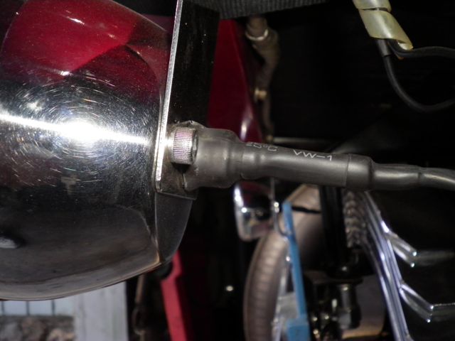

    Okay I'll start. Just before LARS I changed the metric size steel kingpin bolts with ones I turned down to the right size on my old trusty Craftsman lathe form 1/2" S.S. bolts. The kingpin bolt hole size in V8 60 axles is smaller than I-beam axles and for some reason and a metric bolt just fits. 1/2" bolts are just a little big.
    The second thing I did after discovering at LARS that my taillight sockets were severely corroded from Bonn. salt was to tear out the old sockets and epoxy in new ones. When you do that you have to ground the socket to the can. Then I used a lot of shrink tubing to keep out any future junk.

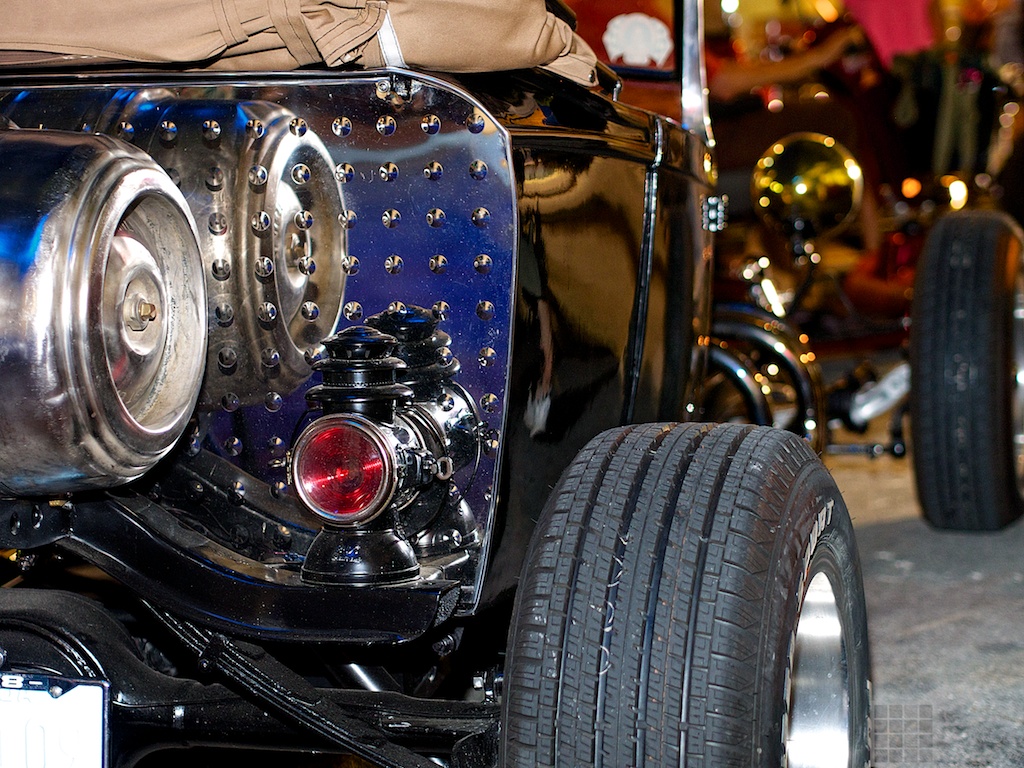

    I did do a kind of update to my old hotrod I built in 1959 that I just restored,I had some alum sheet at first witch I had polished as a firewall n back panel in my bobtail. Frankly it was hard to keep as shiny as I liked. So when a buddy that works out a Miami Intern. Airport saw them tair down one of the old Artdeco buildings,and s**** the artdeco shiny stainless steel wall with industrel rivit design in it. That stuff was so cool to me an FREE,it was a must. Here a photo of the back as it is now{my is not a "T"really but 28 photo 3.JPG IMAG1677.jpg "A" built in a kind of a "T" style

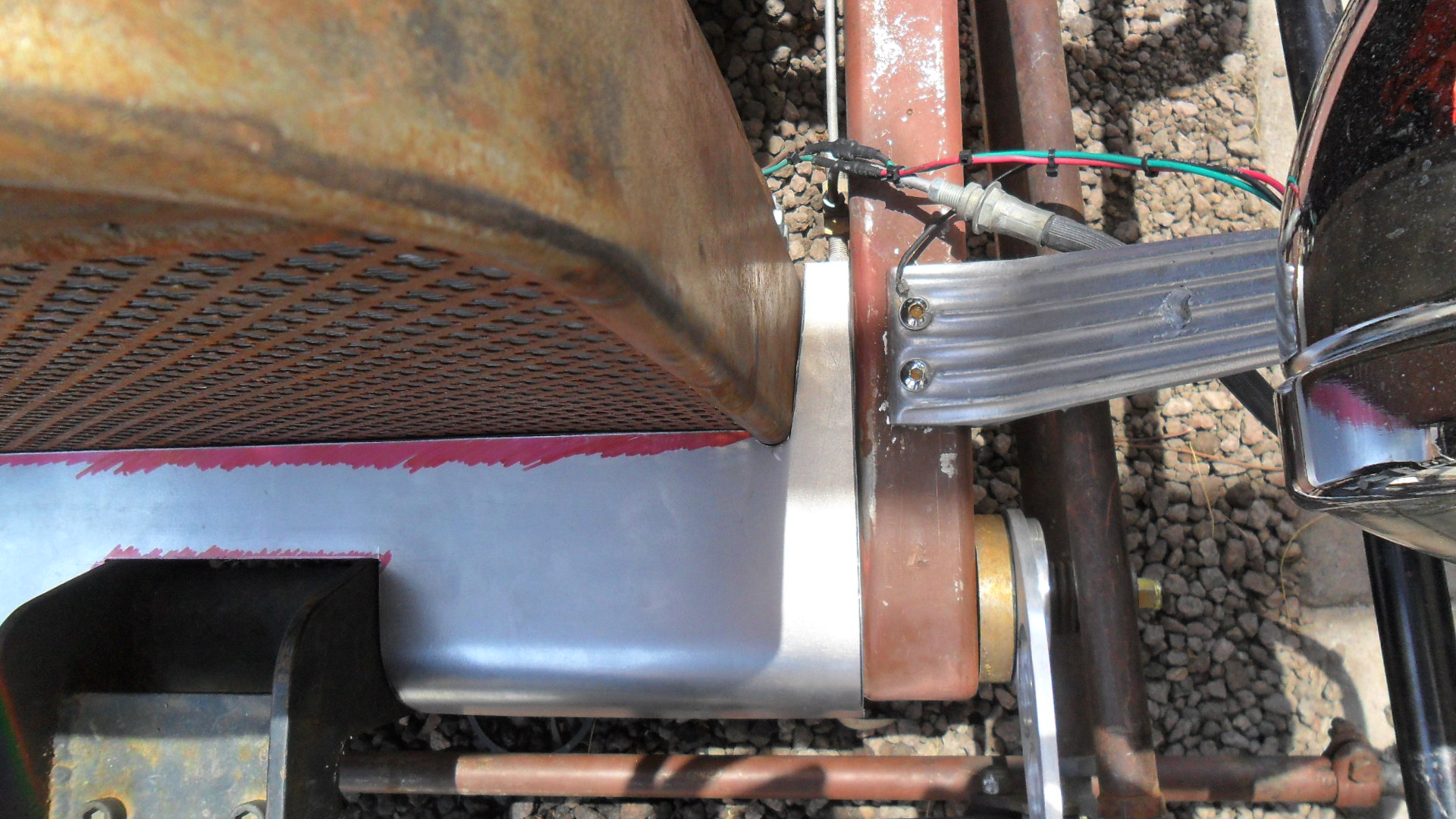

    Some random updates for you guys! The biggie for this week has been the rolled front pan. I did shoot step by step for this one, and if anybody would like to see it I'll do it as tech, nothing earth shaking though. It's literally just 18ga. cut out, filed and shaped over stuff I had. I've even turned hems on my "Playskool My first brake" I.E. Harbor Freight cheapie brake and a hammer and dolly. this will get the lower radius refined a bit more and welded to the grill shell soon. It will also retain the louvered perch cover. SAM_6710.JPG SAM_6711.JPG
    I mentioned the other day engine turning the master cylinder cover... Funny, in the week that has been done it has garnered lots of positive comments. I believe the mats I intend to make for this might feature a cut out so it remains visible... maybe. SAM_6726.JPG

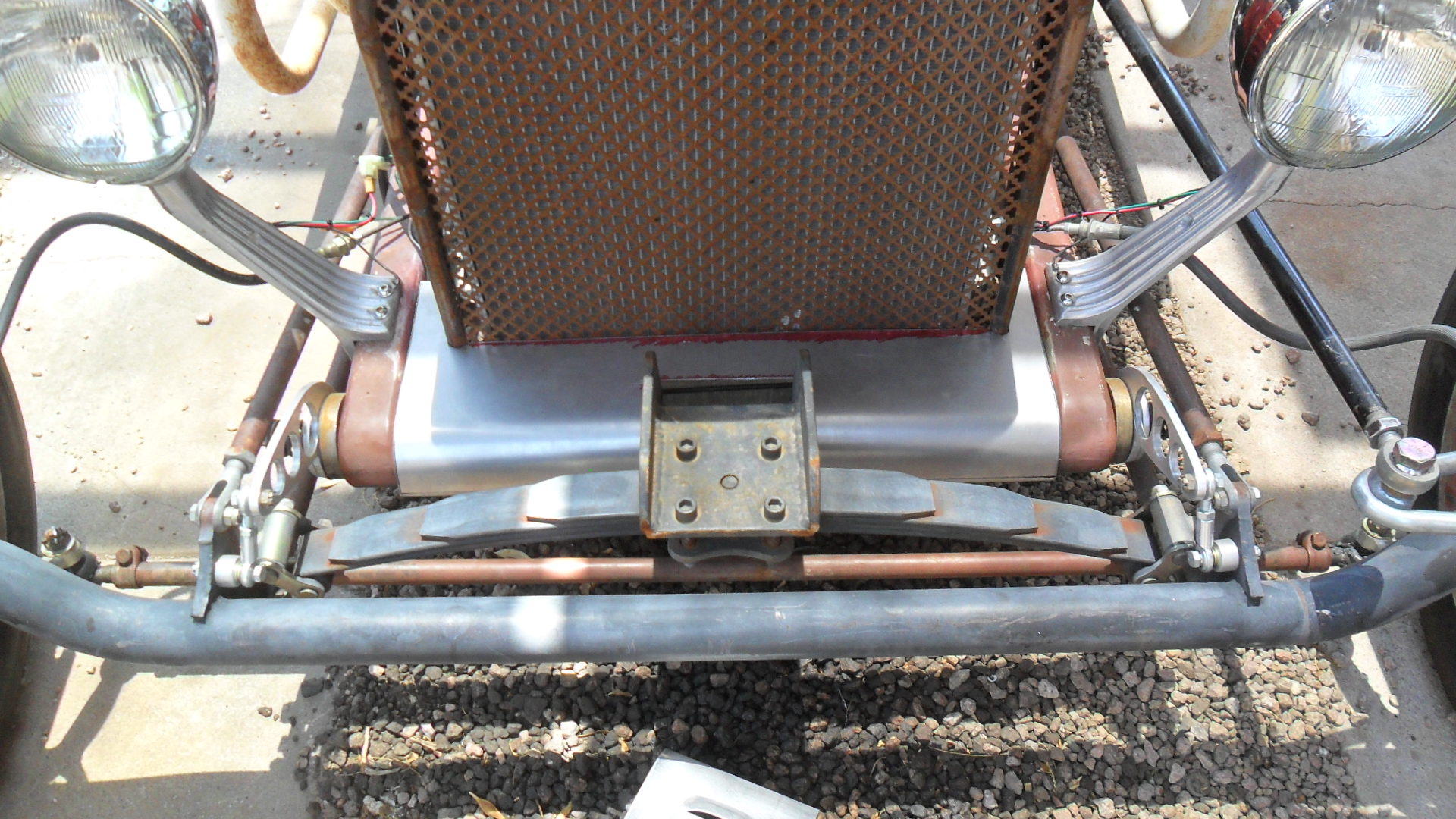

    Got my carb arms, and decided that they could use some improving. The fact that it has been nearly 115 out for the last week has made it easy to do small stuff inside, too. Which arm would you prefer for your three carb deal? SAM_6677.JPG

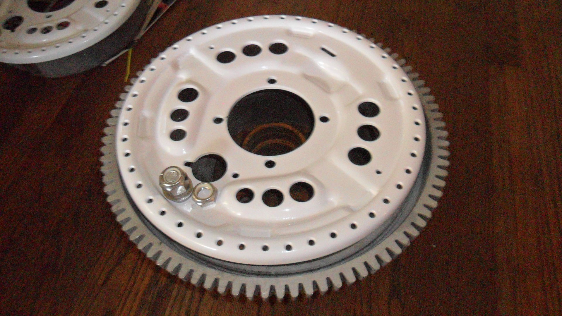

    Also, I have the finned drums and the backing plates ready to fly as we speak! I'm going to hold off on installing them until the week after next, as I have a bit of other stuff to do, like welding on some brake line tabs the P.O. didn't feel were necessary, and re-plumbing some of the lines to go where I want them to. I also was thinking about cutting down the anchors to use the thinner bodied stainless Nylock nuts, but wanted to run it past you guys before I did it. On one hand, my ****ytical mind says it's a brake part and needs the most strength it can get, the the other side of that though says the anchor going through several layers of steel is what does the actual job of anchoring things, not torque of the fastener... SAM_6719.JPG
