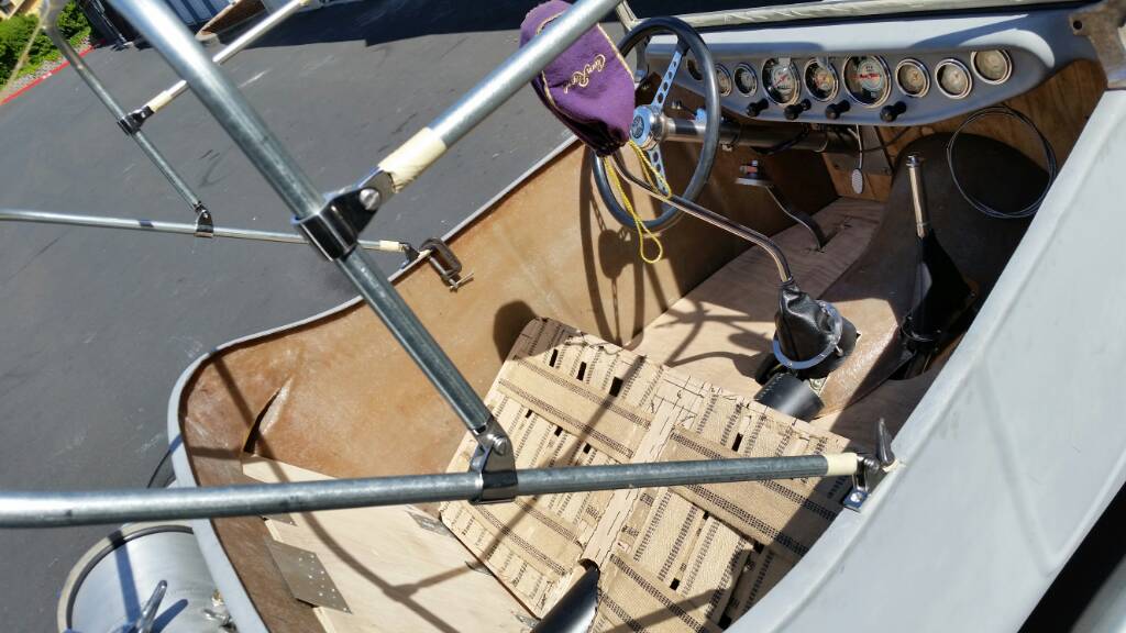

    Here is the beginnings of my top. I looked at many threads before this, but Dana ' s and MrModelT ' s were of the most influential, so thank you! I used 1/2" EMT conduit as I already have a bender and it's really cheap - like $2 for 10'. All of the hardware are boat related (Bimini top pieces). Definitely still in the mock up stages - as in taped and clamped together, but here's an idea:
    And it all folds up nicely:

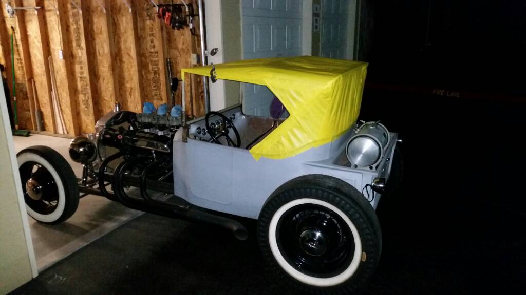

    After playing with the height a bit, I figured I might as well waste 2 rolls of bright yellow tape haha. I have determined my windshield needs about a 2" haircut as the top kinda has a running uphill look... but we're getting there!
    I asked my dad to help me with a header board as I have virtually no wood working tools. Here are a couple progress shots:
    Lastly, the Bimini style "tube hinges" I found are really flimsy and won't remain locked in a horizontal position (hence the clamps in the middle of the top), so I had some aluminum pieces made to remedy this.. still sorting that out and not sure it's the right direction, but anyway, I think you can see where I'm going.

    Looks like your going great guns on that top job Tim. said;
    " I have determined my windshield needs about a 2" haircut "
    Be for lowering the top of windsheild,,I'd do some real checking on how your going to really be setting in your seat and ,how well you can see a stoplight if your first or 2 car at the stop{looking through it not over it,be sure not to have to lean a lot forword,a little lean is fine to see up. As for and down hill look,just run center bow up a in. or so. Too low a windsheild is bad in too many ways to list. How drivible your hotrod is should be befor some idea of what looks cool to ya at the time,nothing is less cool then a hotrod that dose not get driven much cuz it drives badly uncomefortible =5 stars for great driving hotrods,but no stars for undrivible no matter how cool some that dose not know better thinks it looks.

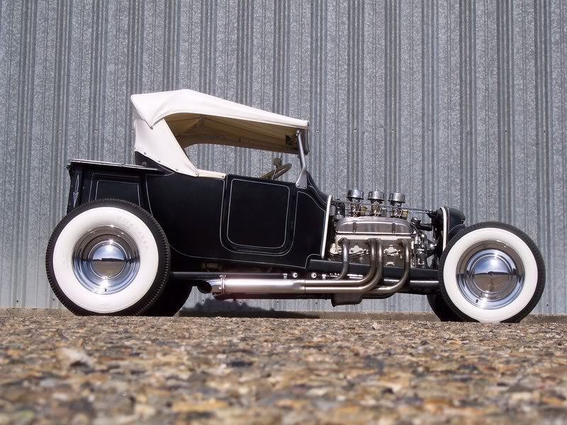

    Have to be careful, most tops you see on buckets now days look pretty cartoonish to me.

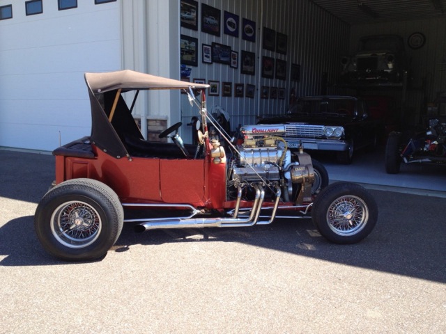

    Here's a top I built 30+ years ago, thought the proportions came out pretty good. 3/8" x 1" steel flat bar frame with oak tack strips. The Haartz cloth is pretty faded; but still hanging in there. Warning! You have to kinda squint your eyes so you miss all the geegaws, wire wheels, etc that have added by misguided subsequent owners.

    Tim with a T and Rich B, Like em' both! I have to admit Tim, when I saw the first picture of yours with just the frame I said - "Oh, boat stuff..." But seeing it with two rolls of yellow tape I really do like the shape and it does hide the interlocking folding ends very well. I can't help but wonder what it might look like with another inch or two of height on the main bow, though rather than chopping the windshield.

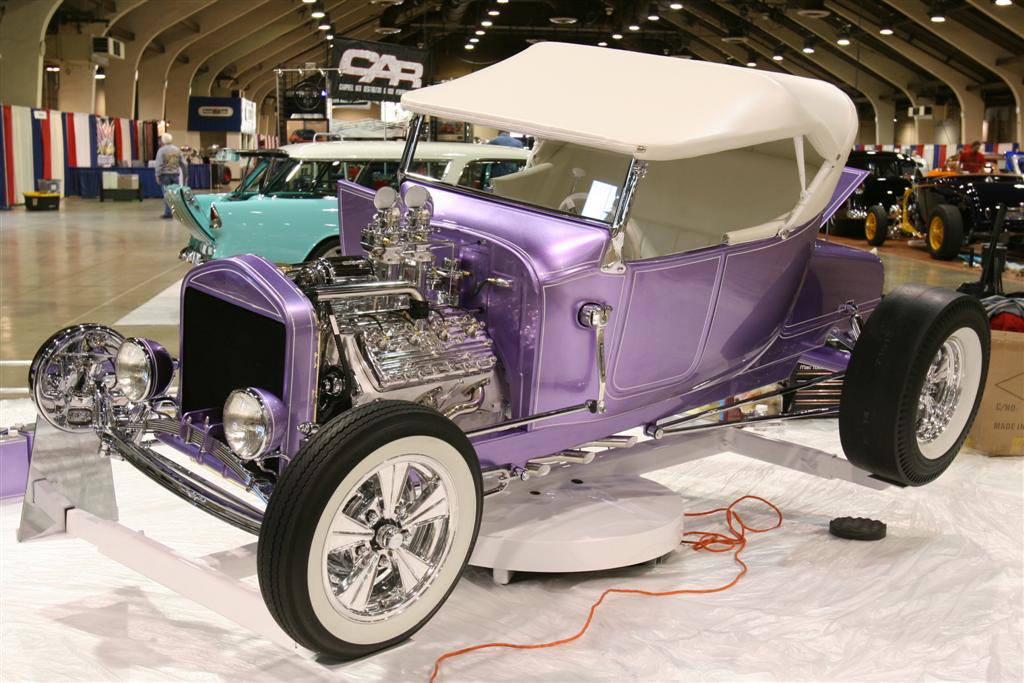

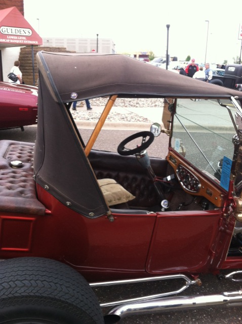

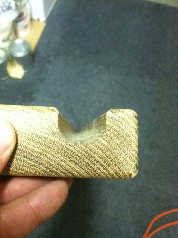

    I'm not a wood worker either, so I cheated. I used 3/4" x 1" oak strips on the main sections and cut the curved sections out of 5/4 oak boards (kinda like the how the wood is shaped around the fenders on woodies, except without the finger joints). The 3/8" steel frame was strong enough to hold the crown when I screwed the oak strips down.

    Dana and Chip, yeah I will agree with you that the top still needs some tuning. I did this in early June and haven't touched it since, simply because I am not sure what I want to do about it lol. I did sit in the car on a few garage sessions for my lunch break, just eating a sandwich and looking through the windshield with the tape top to see if I felt comfortable in there and liked the view.
    I will agree hands down that Royal Shifter's top is the quintessential T bucket top. Pure sex. There is another T I have a photo of that's saved on my laptop that has a really decent looking top. I'll try to remember to post it later tonight after work.

    5/4 boards are just wood that is a full inch thick after it is milled, you know like 1x boards are actually 3/4" thick after milling. Used them so the thickness matched the width of 3/8x1 steel since they were used on edge.

    Royal Shifters T is the only one out there now that I like better than mine. He got it all right. I wouldn't change a thing on it. And believe me I have looked. I haven't seen it except in pictures and have never met him. Looking forward to doing both.

    The top on Royal shifters T is the perfect height. Any taller (like most others) and they look like a cartoon caricature car.
