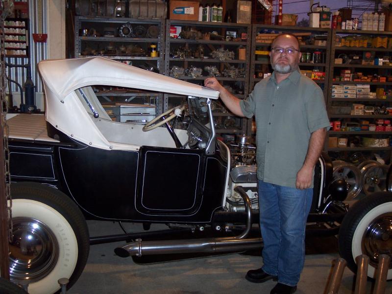

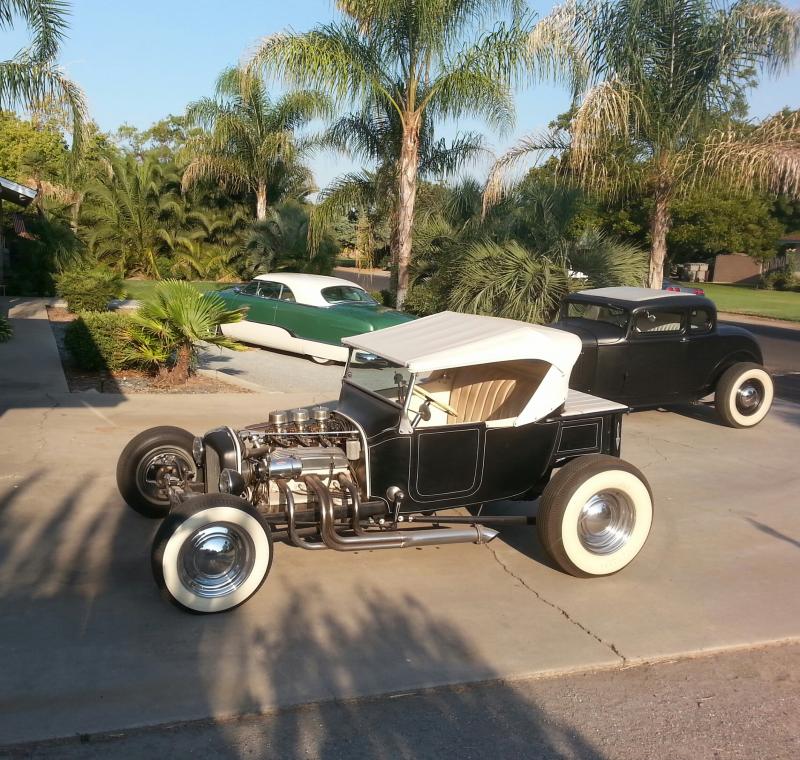

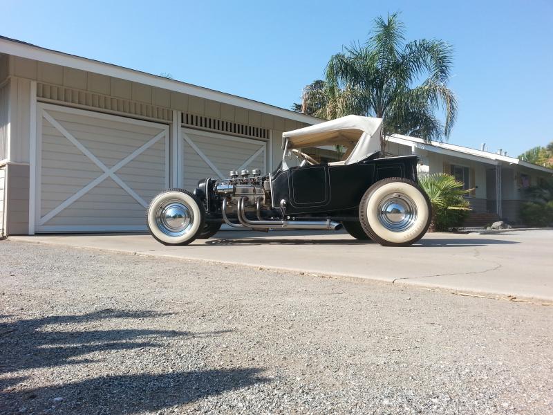

    I still say that the top on Royal Shifters T is a benchmark that others can shoot for.
    Perfection in my eyes, I only hope mine will be as nice when I get there.
    I'm thinking mine will be slightly different just due to windshield height and the year difference etc., however I'll try to get the "right" look.

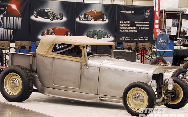

    A few shots of the car and one of a slightly different top approach done by Rod Tops on a Shadow rods build that also looks good IMO. 20130914_082329-1_zpse8937f20.jpg 20130914_095358_zps056d9a16.jpg 2-4-11012_zps787947de.jpg 0912sr_02_z+nsra_street_rod_nationals_louisville+shadow_rods.jpg

    Royal's T is perfect!

    "I think what I don't like is that it is just too short. The back of the top should roughly follow the line of the back of the body as in the B&W mag. drawing."
    I agree. Back of the top should not be forward of the back edge of the bucket.

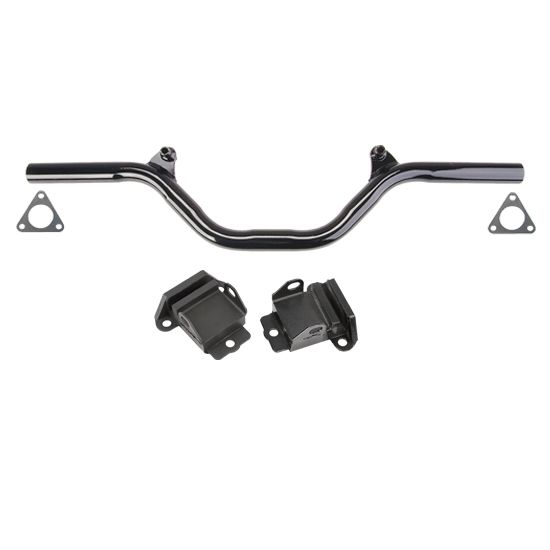

    Now....... a couple days ago, I broke a motor mount. I'd love to say that the torque of my MONSTER engine broke it, but the reality is that it may have been a bad design for this type of car. I was using this:
    See those little "tabs" that secure a high horsepower, 600 lb. engine? THAT is not only a weak link, 1/8" metal, but it means that in order to drop the oil pan, you have to remove it. Counter productive to the DIY Buckethead. So, after doing the needed welding, I went in search of a stronger and better looking solution. I found these:
    They look like a stronger unit that makes dropping the oil pan a question of, "Where's my jack.". As a bonus, my engine guy says that's what was used on older Chevy P/U's. So, they are on my list of upgrades. Yup, I'd seen them forever, but until my mount broke, they were ignored. Traditional or period correct? I'm not sure, but they'll find their way onto my Bucket.
    So, I guess the end of this rant will conclude with what I stated in the first sentences. No offense taken and all thoughts are welcome. whew..........

    Hey Fred,
    I like your idea for updating (or backdating) your motor mounts. I used something very similar to what you've pictured, and although my car isn't out there testing out their strength yet, they seem to be a pretty good and solid design. I got mine from Ch***is Engineering, Inc. If you look at their website, you can get the "frame adapter" brackets, biscuit style motor mount cushions, and SBC motor mount brackets for about $100. They make different width "frame adapter" brackets, so installation is pretty simple. I really like them. Anyway, if that's info you can use, great. Good luck with your motor mount repair.

    The repair was done and I thrashed (tested) them last night. In fact, I'm getting ready to thrash them again, in about 10 minutes. I had to work last Saturday and my employer decided to give us today off. I've got a full tank of gas and a 3 day weekend. Be back in a bit.:D

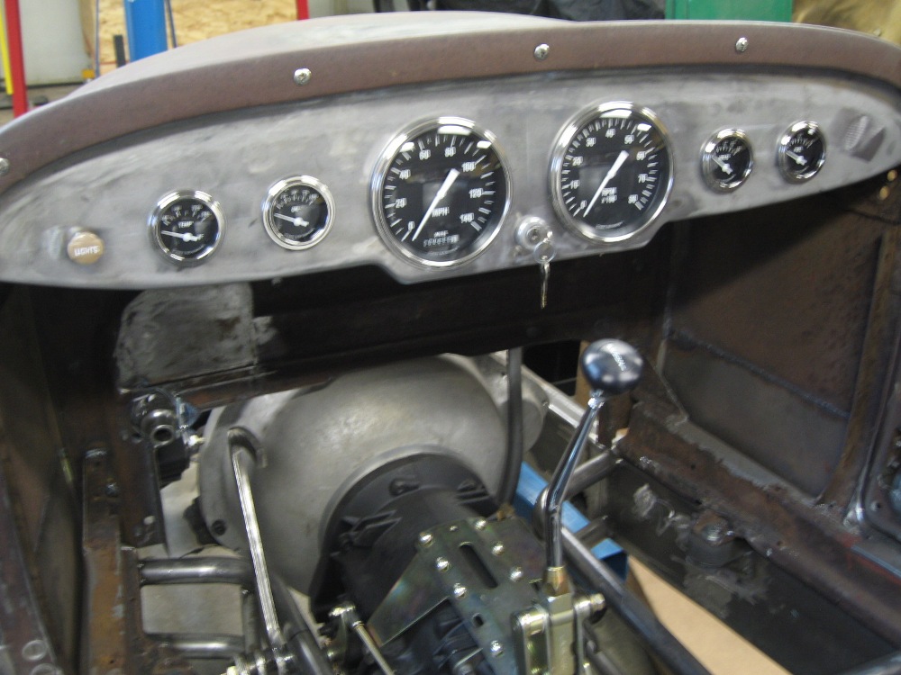

    I agree with the old SW gauges being comparably priced to new Equus ones, but you gotta be a little more patient. It took me 5 years to collect the 9 gauge matching set of Greenline gauges in my T, and I had at least two duplicates of just about every gauge except for a few in order to really match them up nice. Most of them I dropped $20-$30 for, so it wasn't too bad of a price to get what I wanted. Never mind the seat webbing- that was "Rev A" lol.

    Not sure why or how I attached 2 photos of the same thing....

    Gauges for me are still just like I always did them,what ever fit and was cheep,so when they brake I replace the same way. Wow Tim , yours looks like a airliner ****pit compaired to me,I did have a tach,but it finiely failed so gone tell later maybe. photo 4.JPG

    Blue, every time someone says I need a top, or I'm sweating at a stop light, I think about Shifters top. It's perfect, for the height of his windshield. It's form and function living together.
    For now, a top is far into my future. But if I get there, I've got a lot of pics of his to study. Does anyone have thoughts or experiences, on what these tops are like at speed? That's also a reason why I stayed away from them.
