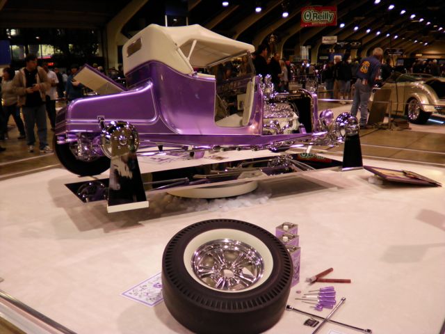

    Think I read somewhere that Royal Shifters T top is pretty much stock Model A. It sure looks right.
  2. need louvers ?
    Joined: Nov 20, 2008
    Posts: 12,901
    need louvers ?
    I noticed too that the top on the purple "T" out of Spokane is stock '30-'31 according to the Rodder's Journal's spec sheet. I do like the look.

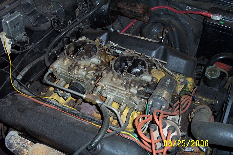

    I already have a matched pair of small-neck afb's. My carbs are probably worth more than the intake, pair of 343HP 383 Mopar carbs, I've been sitting on them for decades. And yes, I'm still pinching myself. I've been hunting for one for a bit now, actually didnt take that long to find one. Now I just need a pair of Cal-Custom 40-40's, and its 1967 all over again!
    Ram log is the proper name for an intake with long runners and two independant plenums, or "logs". Thats what Edelbrock called them in the literature of the time, and that what I called them when I was growing up. Guys call them cross-rams, but cross-rams have long runners crossing under a common plenum, ie hemi, max wedge and Z-28 intakes.
