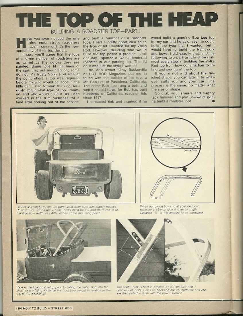

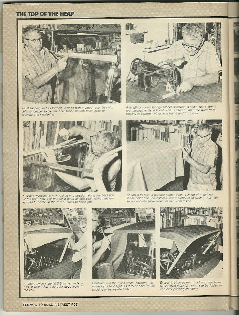

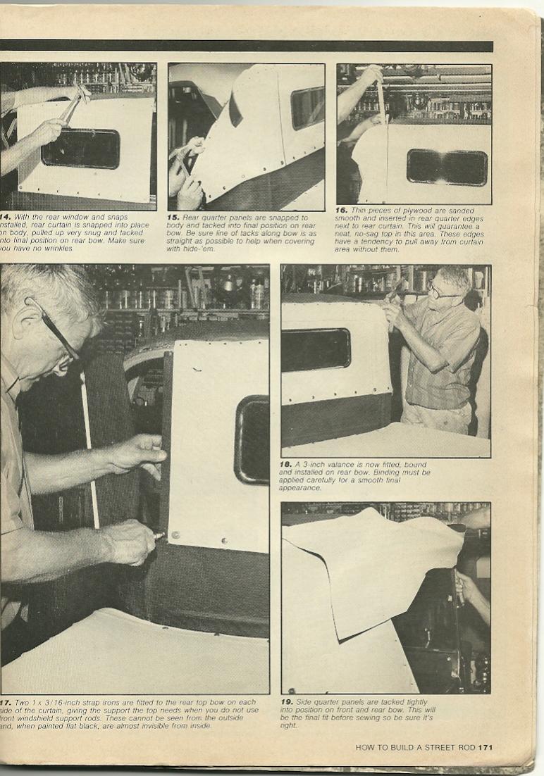

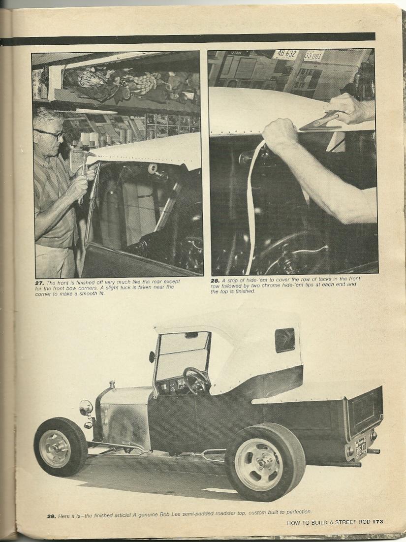

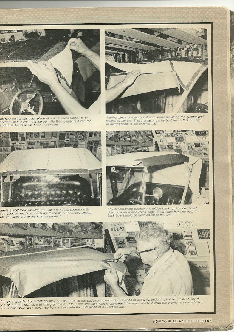

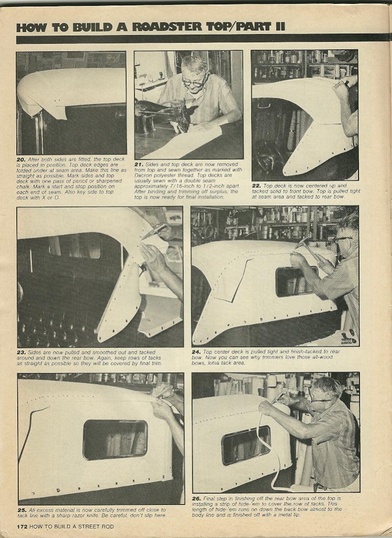

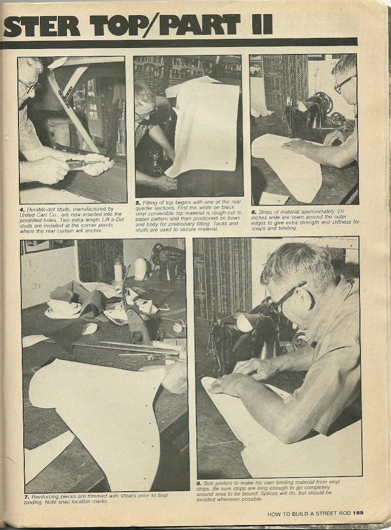

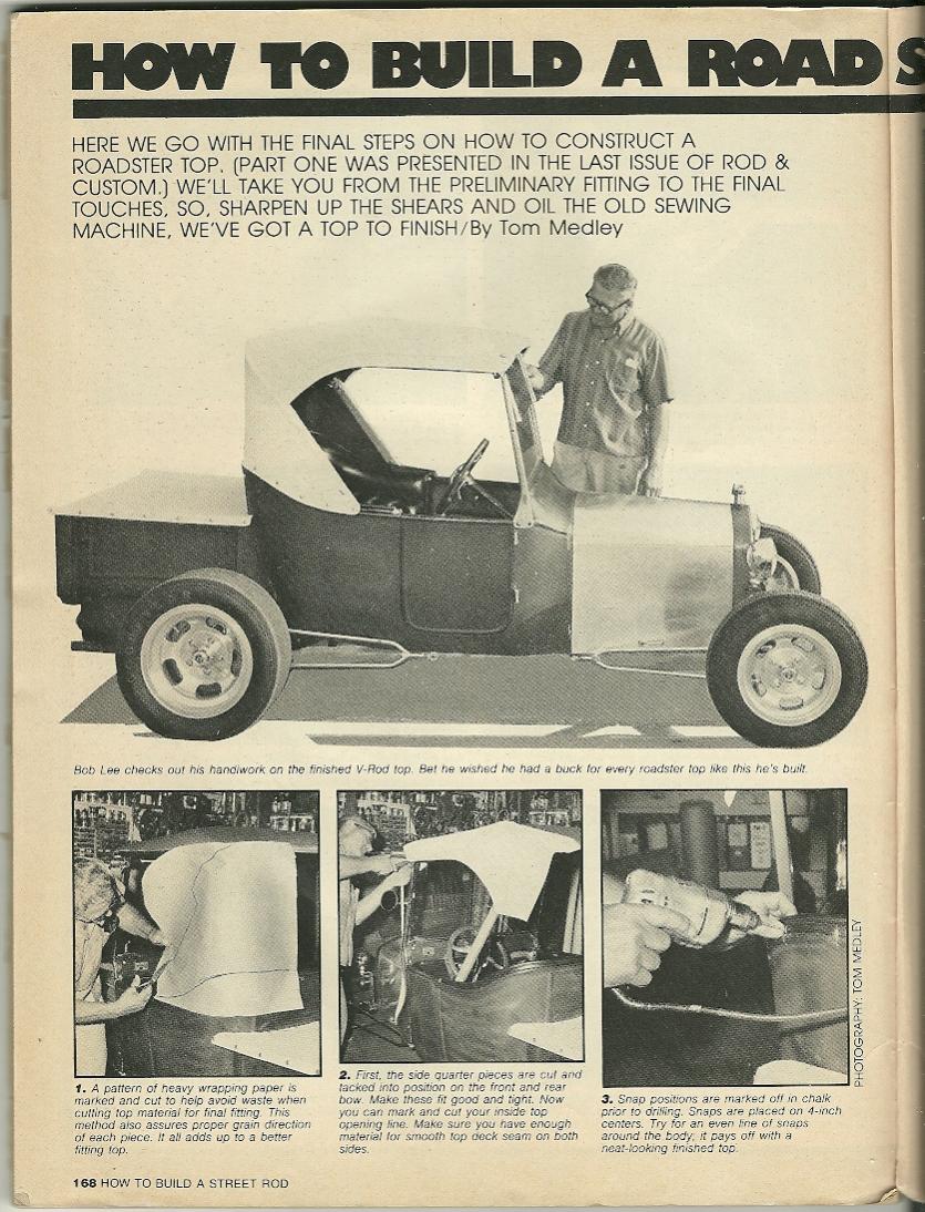

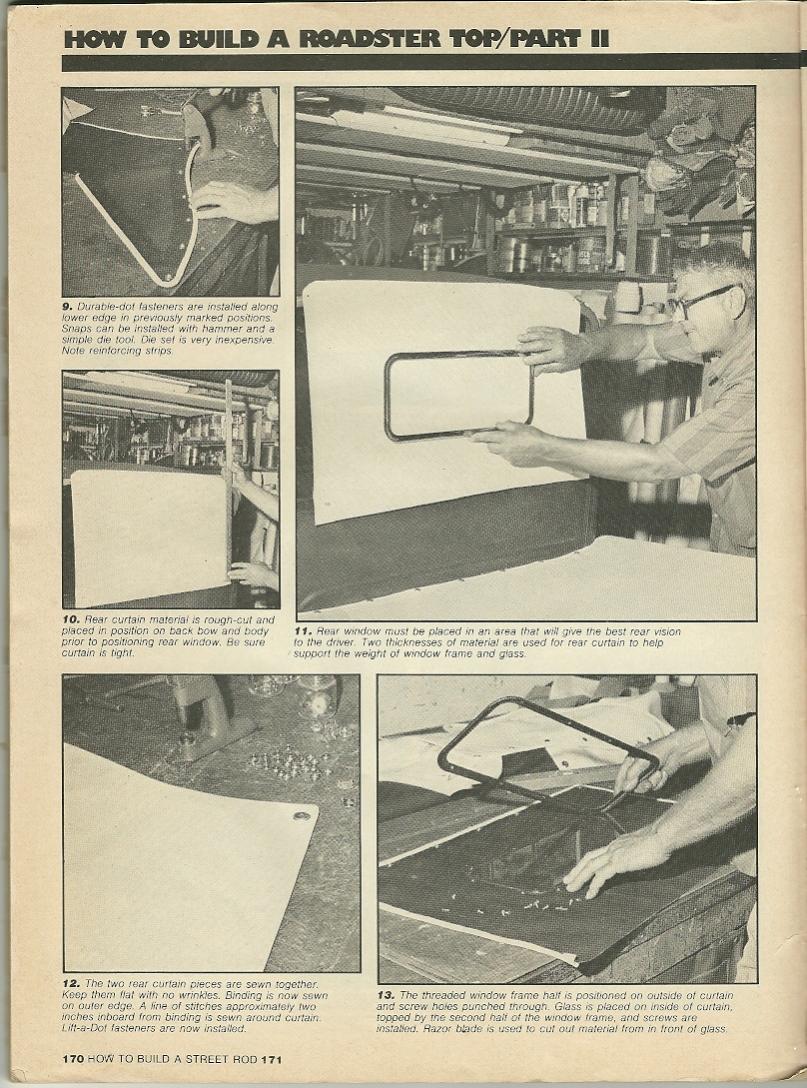

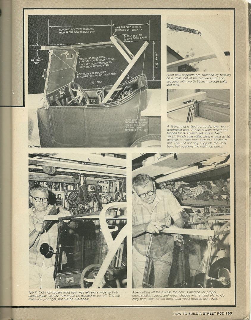

    Now, since we are talking tops, the least I could do is take a few minutes and scan show MY favorite T-Bucket top ever. Tom Medley took some time in the very early seventies and sat and watched and thankfully photographed Bob Lee doin' his deal, just as he had done since about '47 or so. I have never seen one of his tops I didn't like!

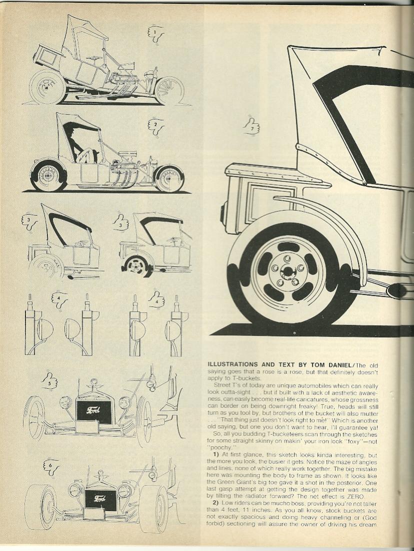

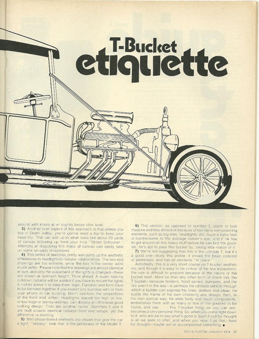

    As long as we are talking aesthetics, and having a scan and show kinda night, I thought I would drop this one on you guys. I bought a copy of this magazine when I was a kid back in January '74, and this particular article helped me make some sense of how these things went together. I find that all the recommendations Tom Daniel mentioned still hold true to this day, and are still great guidelines to a good looking T-Bucket. Read through this and dig out your pictures of your favorite T-Buckets, then dig some up that you find less appealing, and you'll see where these ideas work. I had lost my original copy of this mag at some point in the eighties, and very happily found a mint copy at So-Cal Phoenix's trunk swap a couple of months ago for a couple of bucks. SCORE!!!

    Pretty much the best T bucket article, still have my original R&C mag; but it was pretty tattered so picked up another one at swap meet too.

    Need Louvres, I agree the "Big T" needs some adjustment to its peculiar reverse rake, but the problem with iconic cars is that you arent allowed to change them.
    And going back in time is proving a bit difficult.
    Maybe sometimes, we need to be honest and say that just because its a famous car, or its built by a famous person, it can still have screwed up lines.
    I do remember a certain style of 33/34 that Coddington built that was an affront to the eyeballs, but it won big, and made all manner of magazines, and all manner of people copied it.
    Maybe somebody needed to say "The emperor has no clothes"

    I could make an observation about drawing #1, and a very famous early T, that was not the template for most buckets that followed, and the one that followed right on its heels (and had a more conservative stance) that DID end up being the template for all that followed, but well, I have caused enough trouble around here lately...:D

    Very much agreed! And, as much as I don't believe I'm about to say this, sometimes a "clinker" line on a car isn't the worst thing in the world. Sometimes it adds character, much like a well placed tiny mole on a beautiful face. Not real often mind you, and that damn mole better not have a hair growing out of it!

    I used that copy to lay out my roadster. Before it I didn't know about a formula for what looks good. Sure I still have it somewhere. I recommend it for anybody building a T. If everybody read it there would many fewer UGLY Ts.

    Just a little cute for my tastes but that is probably because the windshield is a couple of inches too tall.

    I used that article as a guide on doing the top on a "T" I built back then, it was still on the car, 30 some years later, when we came across it this summer.
    Those twelve issues of Rod & Custom quarterly were a wealth of tech info, much of which is still good stuff.

    Me too! I loved that series of mags. They started coming out just about the time I got my first car, my '35 five window. They seemed to do better tech to really spell stuff out rather than just show pictures.

    Yup those R&C quarterlies & that T-bucket spl are very well worn in my library. It's sometimes helpful to see "what doesn't work". Hurts the eyes "because what has been see, cannot be unseen" , but at least I remember not to do that. :D . & the Big-T always hurt to look at.
    At the risk of causing unintended trouble , I couldn't help but notice that the how-to top article featured a (THE), ahem, *VolksRod*. :D . Nice way to sneak it back in here. :D . I do love that thing, although I still don't like *all* of the proportions on it, esp after the "rad" shell was pushed forward when the fenders got added. 46 years after I 1st saw that concept, I'm trying to convince myself I *need* one - finally. Since it's hated almost universally, it has to be the right thing to do, esp since the fun factor is off the scale. I did see a foreign-car (small-pages-size) mag cover shot of a really crude volksrod version, dated in 1964. Surprised me.
    I still think you could lop off ~ 3" from the windshield on the X-ugly T, & it'd look better. Just one more thing to do... :D .
